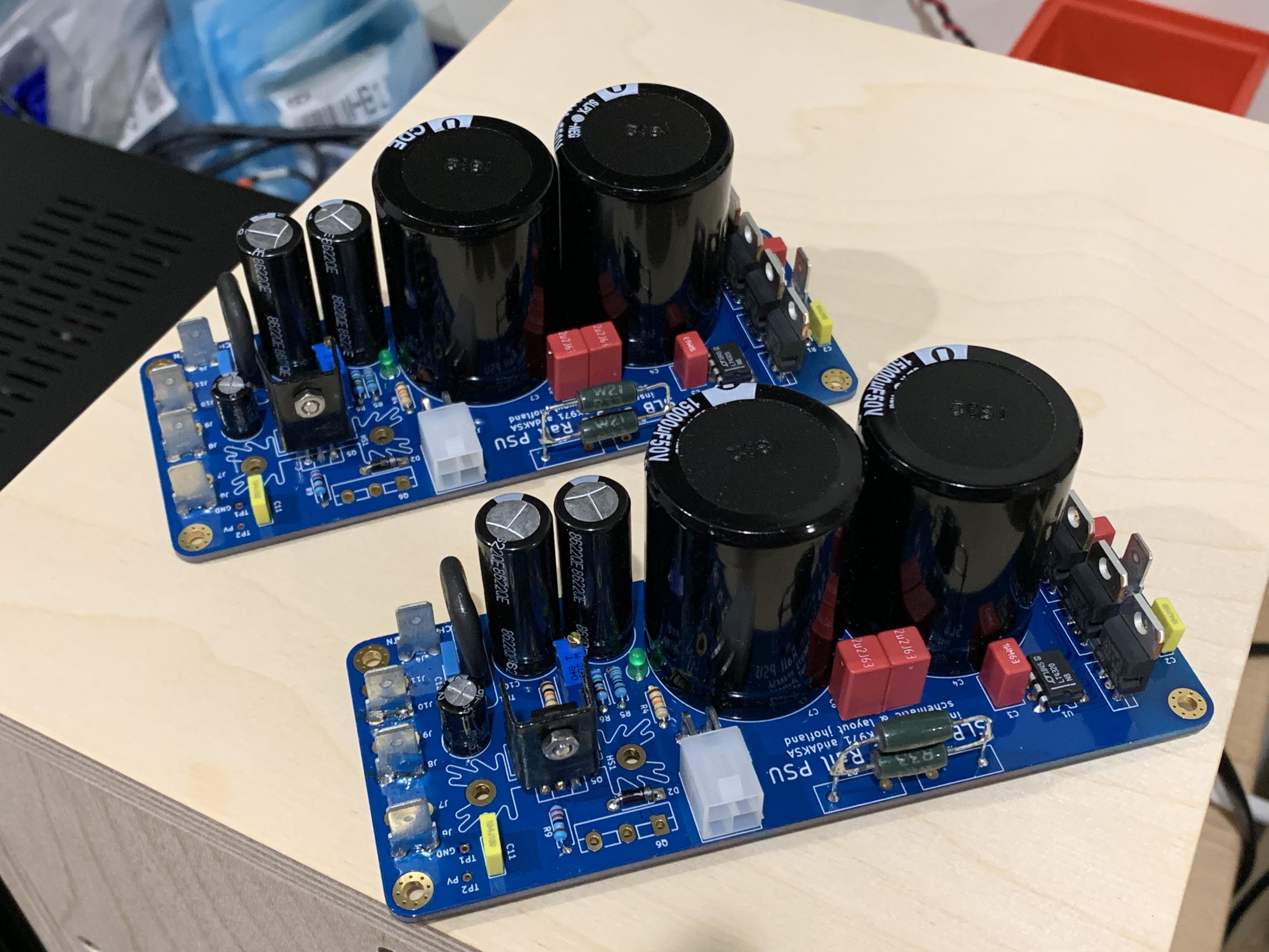

Hey guys, we just discovered a small error with the orientation of Q5, the BD139 used in the SLB SR board. Pin 1 is denoted by the square pad, this will have the part’s front side in contact with heatsink if you use the large Fischer style heatsink. This part really doesn’t need such a large heatsink and a small sheet metal stamped or C channel aluminum one would work fine. Small heatsinks like that can be flipped around to the “back” of the BD139. Alternatively, one can mount a BD139 with its front towards the heatsink. Make sure you use a non conductive shoulder washer or bushing on the mounting screw to prevent it from contacting the metal pad on the back of the BD139.
My apologies for not catching this earlier - but should not be a problem as long as you mount the part with pin 1 on the square pad.
The SLB dual rail does not have this issue.
For those of you who have ordered the SLB SR already, so sorry for not catching this error before producing the boards. If you have heartburn with your BD139 not having its back face the heatsink - let me know via PM and I will order you a v2 replacement board. But the v1 SLB SR boards are fully functional with Q5 orientation following pin 1 to the square pad.

A couple of warnings about constructing and testing the SLBs. Never connect them to a load without the large pass transistors plugged into the Molex jack. If plugged in, make sure the wires are wired correctly (trace each one yourself). If you do connect the load and apply power without the big C5200 or A1943 connected, all the current passes through the smaller TO126 transistor and the R15 resistor (which will smoke and then blow like a fuse). It's a good thing that it blows as it protects the BD139/140 from melting.
Other things to be careful of: make sure the BD139/140's are not installed backwards. The square pad is pin 1.
Make sure your electrolytics are not in backwards.
Both Vunce and myself have melted the 680R resistor leading from the BD139/140 because we forgot to connect the pass transistor (or did not connect it securely).

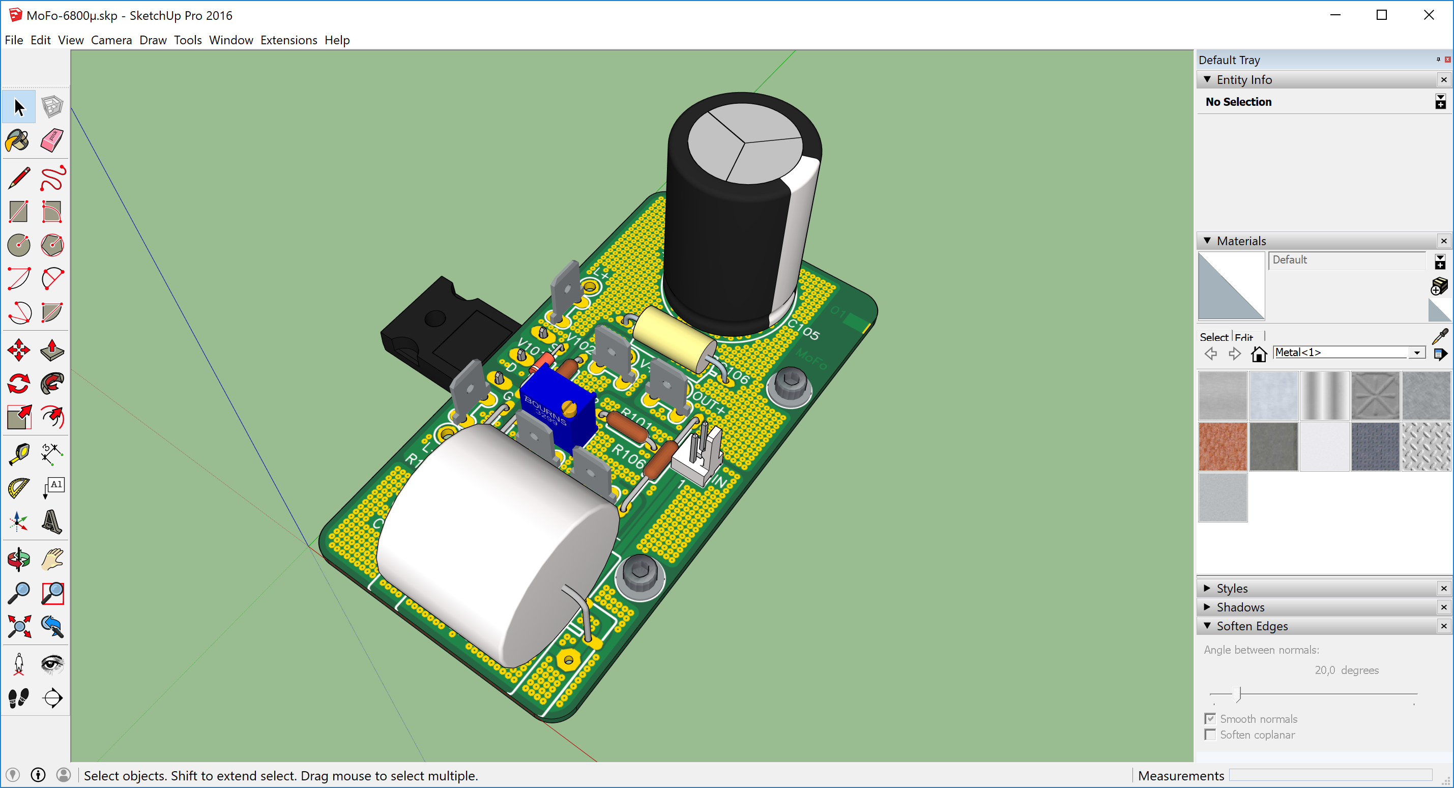

I think I am going to build a pair of the SLB SR's and use them on a fresh set of JPS64 MoFo boards. These will be heavy bias MoFo's running a hot 26v and 2.8A. Should work out very well with both the SLB SR pass-BJT and MoFo MOSFET on same copper pad of a single CPU cooler.
Why not an all-in-one PCB?
We are doing that with ABBB, and these JPS64 MoFo boards I have on hand already, and the SLB SR needs something to power. Well, is there interest in a single board MoFo SLB?
Yes, it was the ABBB stuff that prompted my post.
I would be interested in a single board SLB SR/MoFo but if it doesn't happen it won't be the end of the world as I already have my pairs of SLB SRs and DIY Audo Store MoFo boards.
I built up a pair of the SLB SR’s last night. Still need to connect the pass 2SA1943 BJT to some flying leads and the Molex connector. These are set up to handle any project up to 47vdc output. Will probably use them on some new MoFos next. CPU coolers ones this time with JPS64 PCBs.
Hi X, so your photo here shows Q5 installed 180 deg from screen print on board and using a smaller TO220 heatsink.
Yes, recall v1 SLB SR boards gave error on Q5 orientation relative to heatsink. Pin 1 goes to square pad. Use small local heatsink and orientation doesn’t matter.
