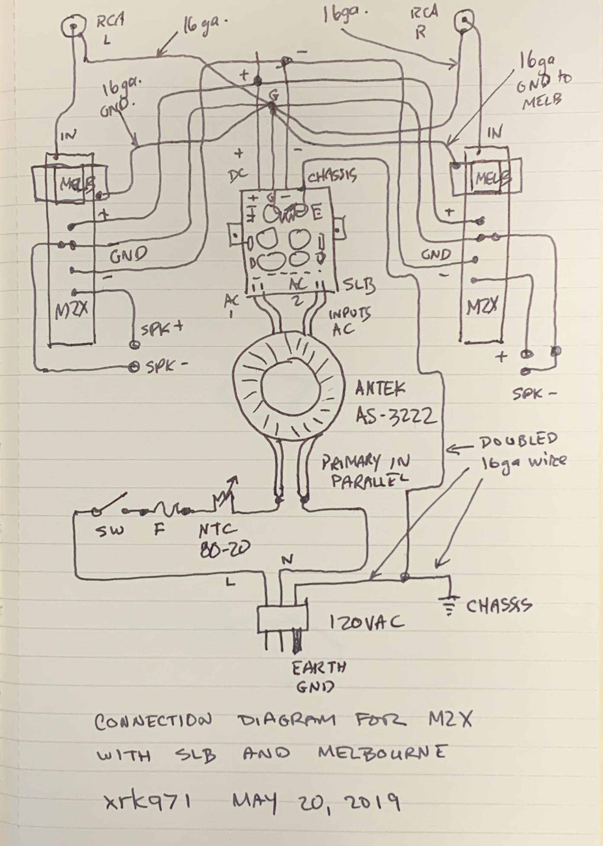

For an M2X build, for example, I understand that's optimal to have a separate PSU for each channel, each with its own transformer and SLB-DR. If I don't go with that approach is there any advantage in using two SLB-DRs with one transformer (e.g. Antek AN-3222) compared to one SLB-DR?
No, you might actually generate more ground loops by connecting two SLBs in parallel from a single set of secondaries. Just use one SLB and it’s GND as the star hub. I am using just one and it works fine on my M2X. Never been quieter. No ground loops. I have Antek AS-3222.
Thanks, good to know. This is my first amplifier build and I've got some questions that are pretty basic. For instance, with one AS-3222 and one SLB, how do the wires from the AS-3222 connect to the SLB? Does one pair of wires from the first xfmr secondary go to AC1 on the SLB and the second pair to AC2? And what about the AS-3222 purple ground wire?
I’ll post a schematic diagram later. For now, connect secondaries of the Antek to the AC input of the SLB. Two pairs (the wires from Antek are grouped blue green per pair by proximity). The purple is a static shield that connects to earth ground/chassis ground - the same as the chassis/return pin on SLB (one separated by NTC 8D-20). From SLB positive and negative those go to amp +ve and -ve spade terminals. The ground from the amp goes to ground of SLB. The speaker return goes to GND of SLB. And I have found that the ground of the RCA input of you send to to GND of SLB, is whiter than letting it go to GND of the M2X board. Basically, all GND connection go radically to the SLB star hub. The star hub then connects to the chassis and earth GND via the NTC 8D-20 and 22nF 2X safety cap. The iEC inlet should have a fuse and GND from there goes to chassis GND and earth GND bus that SLB pin connects to. Chassis GND should never inadvertently touch the clean 0v star hub GND except through the NTC. The mains from IEC should go through an NTC 8D-20 or CL60 NTC before going to the red/black primaries of the Antek. This is to prevent turn in surge and it reduces hum somewhat. That should get you started.
