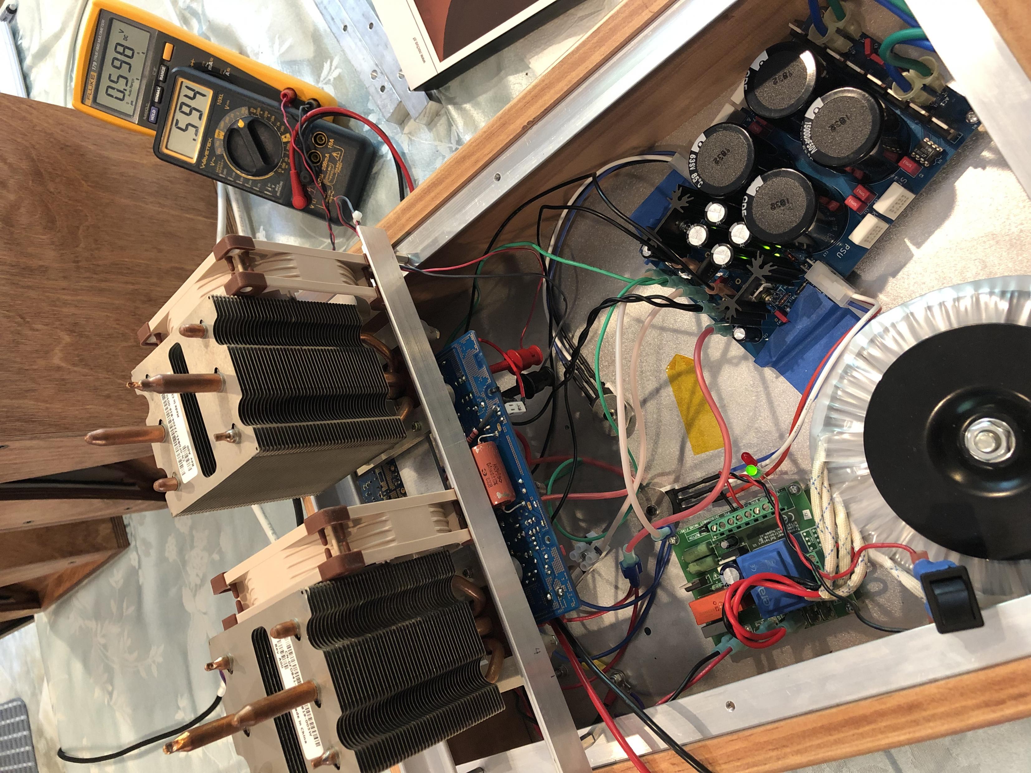

I’ve got a single SLB built powering my Alpha20 amplifier. I removed the conventional bridge rectifiers/CRC psu board and replaced them with the SLB psu. My Alpha20 had a small amount of hum that I could not get rid of, with the SLB in place it’s almost silent! Very nice improvement.
Each amp board is pulling 1.3A bias current, at this current draw the BJT’s do not get hot enough to require a dedicated heatsink. I will remove the flying leads and edge mount them under the SLB board and fasten them to the aluminum base plate.
Nice work, Vunce!
The Alpha 20 is a great matchup. Looks like a single SLB serves it fine then.
That combination is exactly what I will be building next - thanks for the info Vunce, very reassuring.
