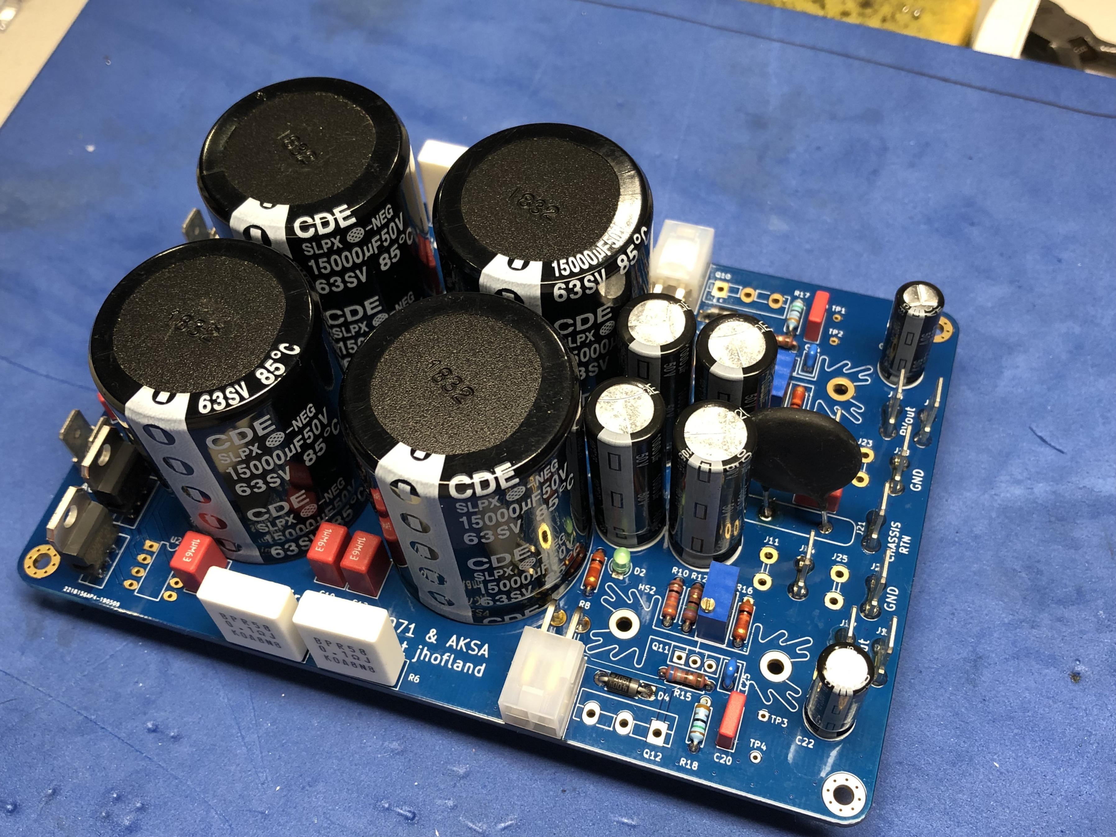

There was a bit of solder slinging going on last night
Just a few parts left to install. I still haven’t decided if I should socket the LT4320’s?

I soldered the 4320’s direct without using sockets. They are reliable chips not expected to burn out like an opamp.

I was thinking of socketing the chips not for fear of failure, but to limit the number of LT4320’s I’d have to buy. They can be removed from a unit not being used and re-installed in a currently used amplifier. At almost $10 per chip, they add up quickly.

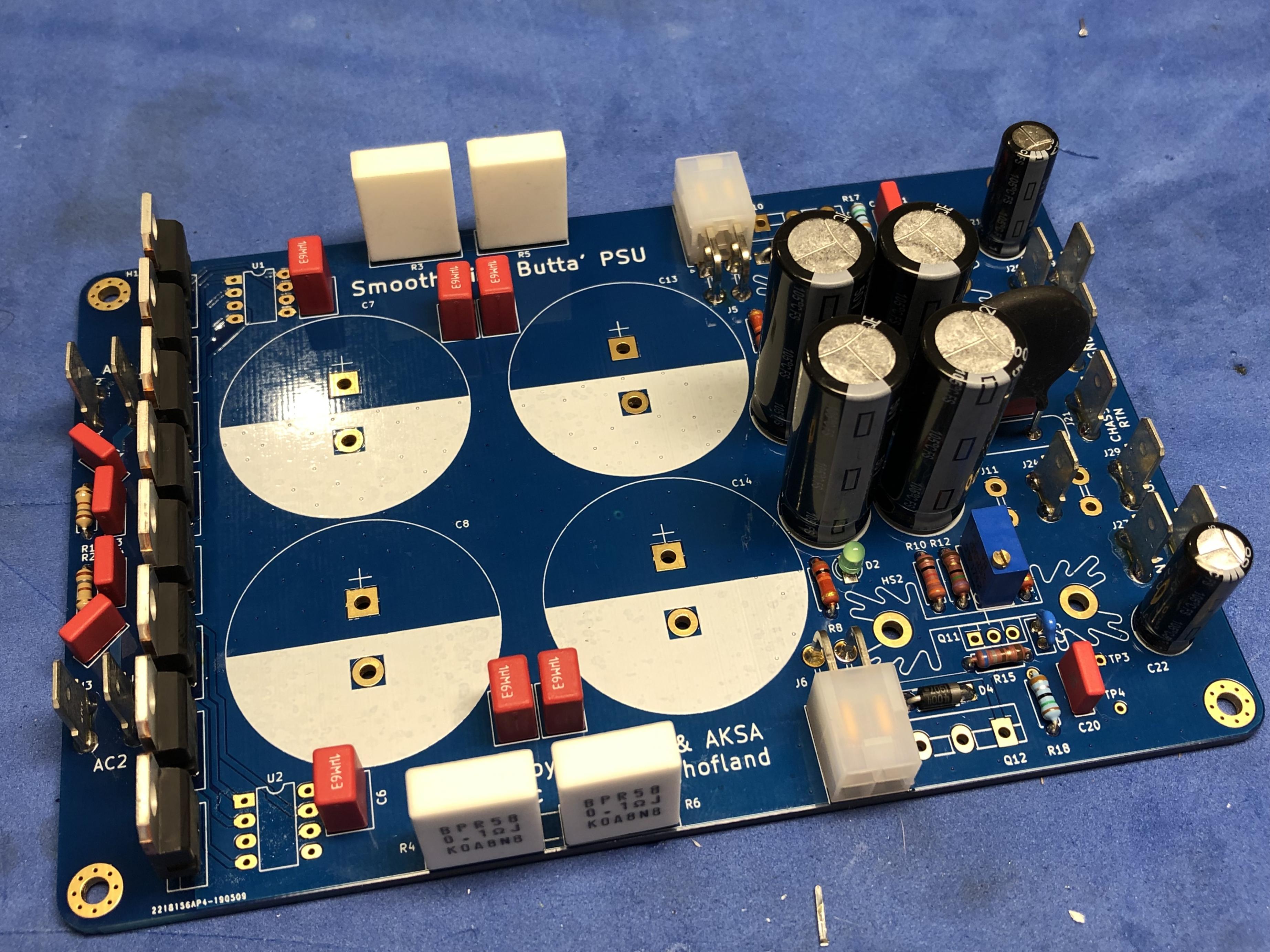

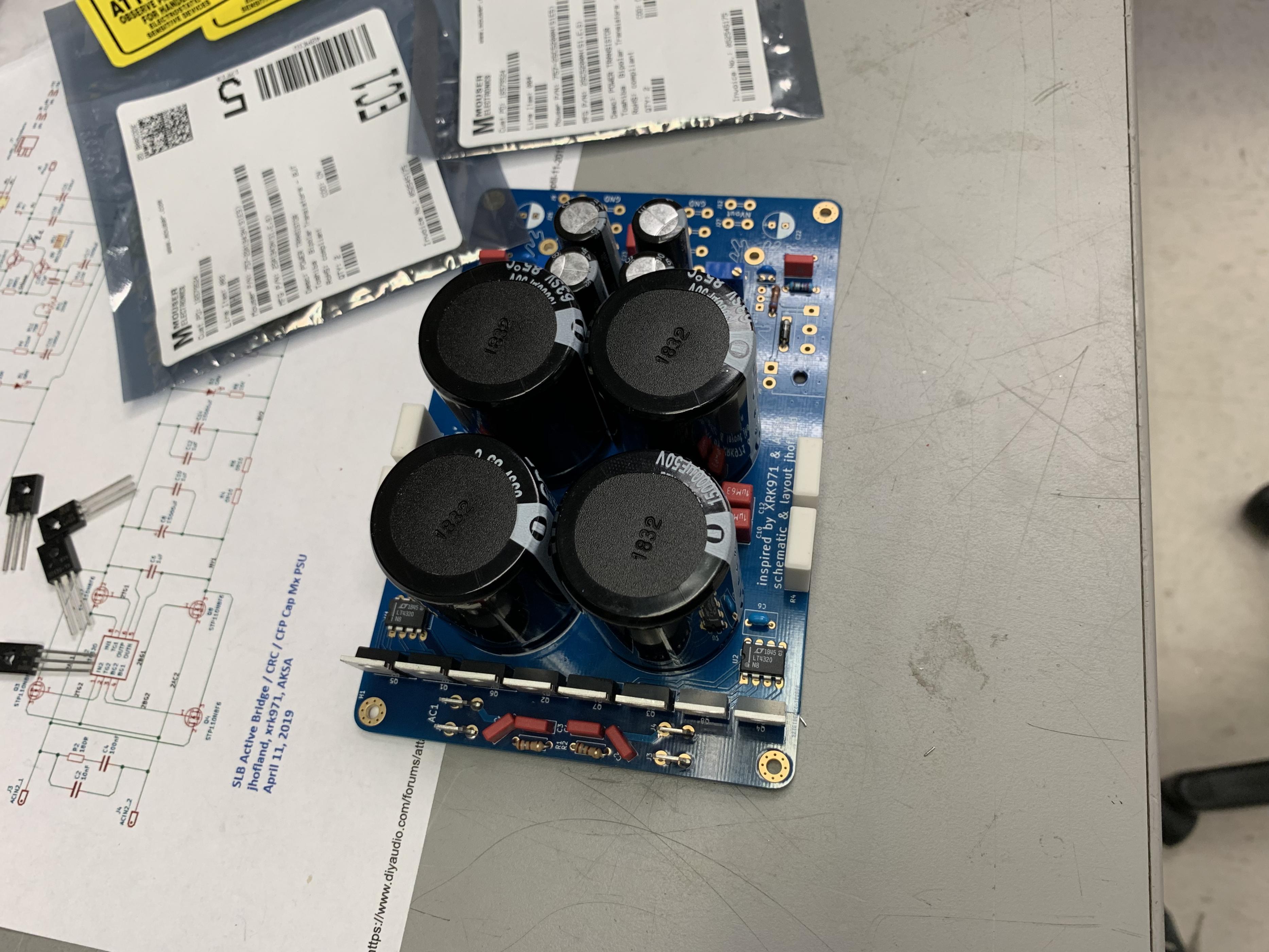

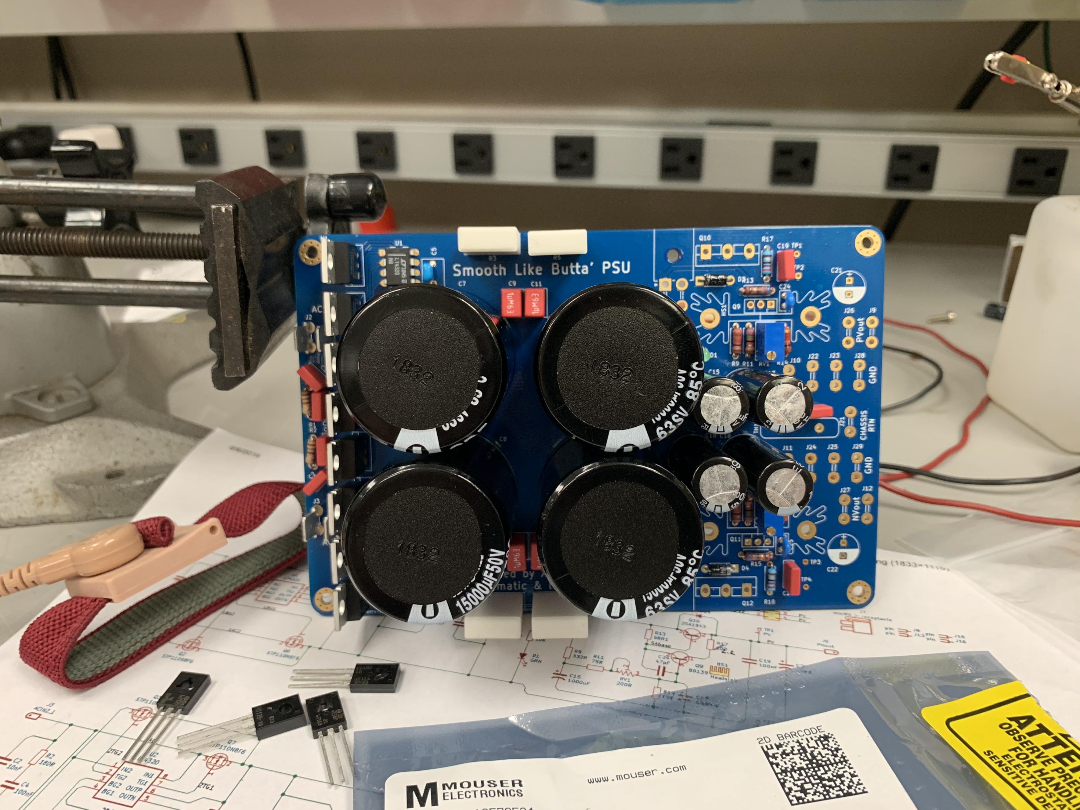

I stayed late at work to start the build. The PCB is beefy! I had to put the big tip on my soldering iron to get the 15kuF caps on because of all the beefy thermal mass.
