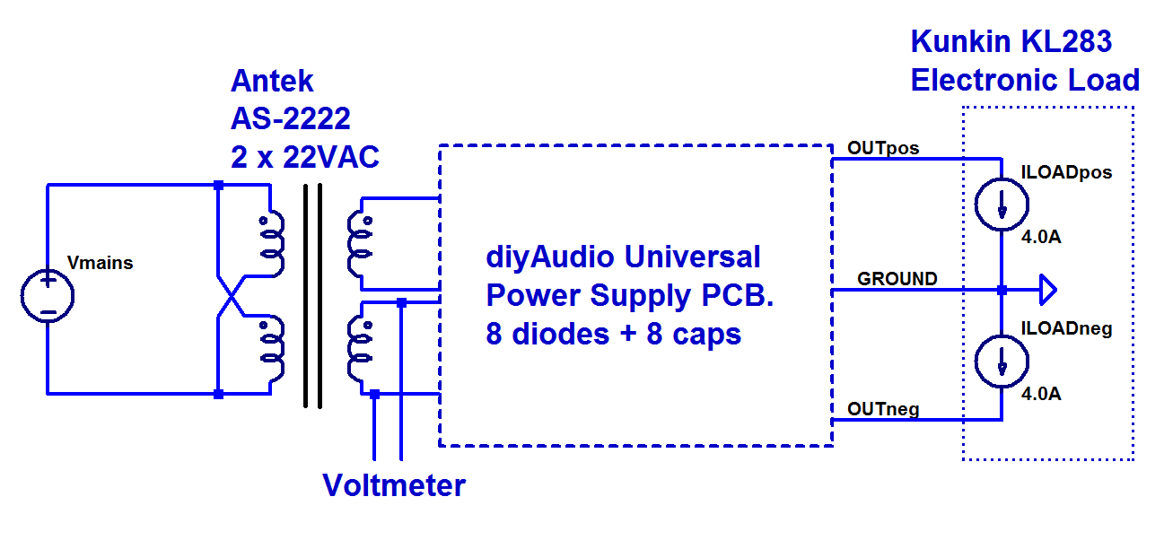

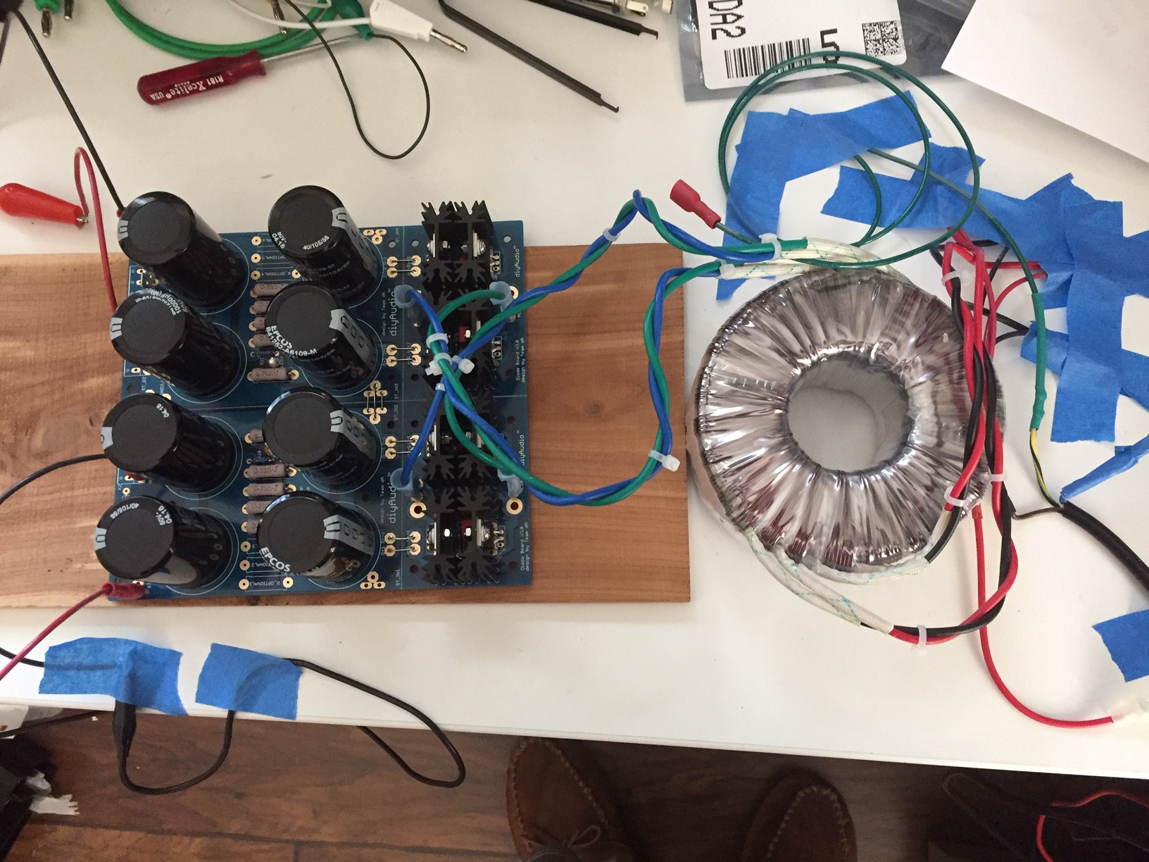

Just now I rigged up the experiment shown below. An Antek AS-2222 transformer (datasheet) operating from US mains, feeds a diyAudio Universal Power Supply PCB (link). The two DC output voltages from the Universal PSU, are connected to a two channel electronic load. I ran the experiment twice: once with the electronic load disconnected from the PSU, and again with the electronic load connected and pulling 4.0 amperes per channel. Here is my measured data, taken just 20 minutes ago:

The transformer's output voltage, going from (no-load) to (2 x 4 amps DC load), exhibited a "sag" of 2.18 volts, right in line with the datasheet numbers.
A few things to note:
  • This is a 200 VA transformer
  • Output DC current is 4.0 amps, about 54% greater than the DC draw of a First Watt 25 watt Class A amplifier (2.6 amps)
  • I am measuring at the transformer secondary, the same way Antek measures

Every Antek I've ever measured, met its datasheet spec. If your post-Antek circuitry needs or wants more input voltage than what Antek guarantees on their datasheet, then either buy a higher voltage transformer or redesign the post-Antek circuitry. But don't blame the lower-than-desired DC voltage final output, upon the transformer failing to meet its spec.
Start with your testbed PSU that includes an Antek and a SLB board and a load resistor. Use a 4.5 digit DVM to measure the Antek AC secondary voltage (a) with no load on the DC outputs; (b) with your standard load on the DC outputs. Subtract these two numbers and voila, you have measured the transformer "sag". The analogous setup to attachment 1 of post #445. You are measuring the Antek and nothing else.

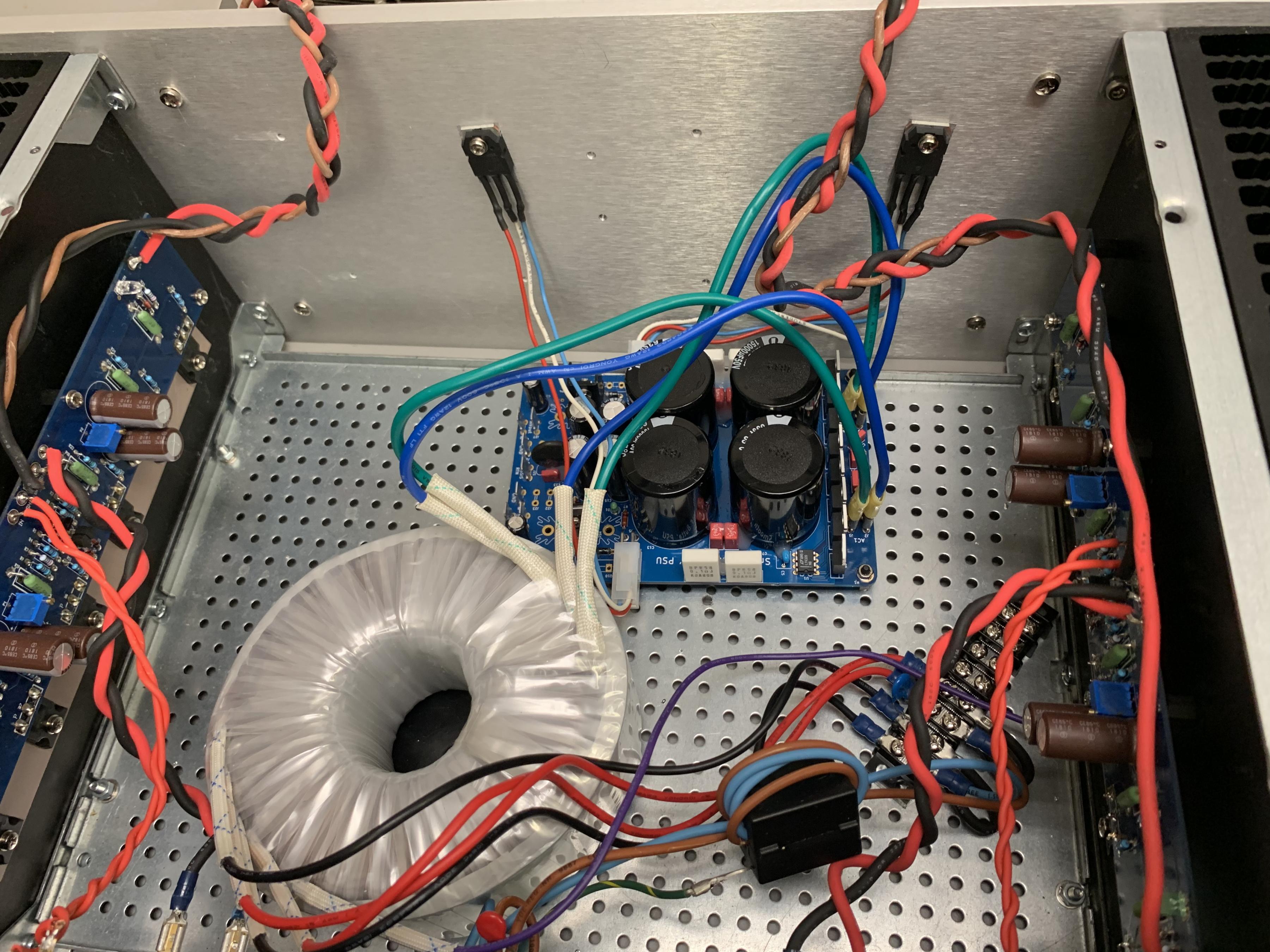

My AS-4222 - 400VA 22V transformer with 119Vac mains gives me +/-27Vdc at input of my F4 drawing ~5.5A total (~1.4A each rail).
What are some recommend methods of mounting the toroid on it's side? I am thinking of just bending some flat stock Al bars 90 and drilling/tapping holes.

Unless you really want to fabricate something the L bracket from toroid.com seems like a good solution.
Originally I made an L bracket from some 0.063" sheet aluminum I happened to have. It was a bit too springy so I made a U bracket from the same material. One thing I didn't anticipate with the U bracket was that the through bolt needs to be insulated from the bracket (I used some nylon bushings). When the bolt was in electrical contact with the bracket it got very hot from induced currents.
Working in IT has its perks. I have collected many old brackets for mounting equipment in 19" cabinets. Most of them are very sturdy - especially the old Nortel/Avaya ones - and work a treat. Holes are all there especially on the short L-base where there are two - bolts solidly to the base.
