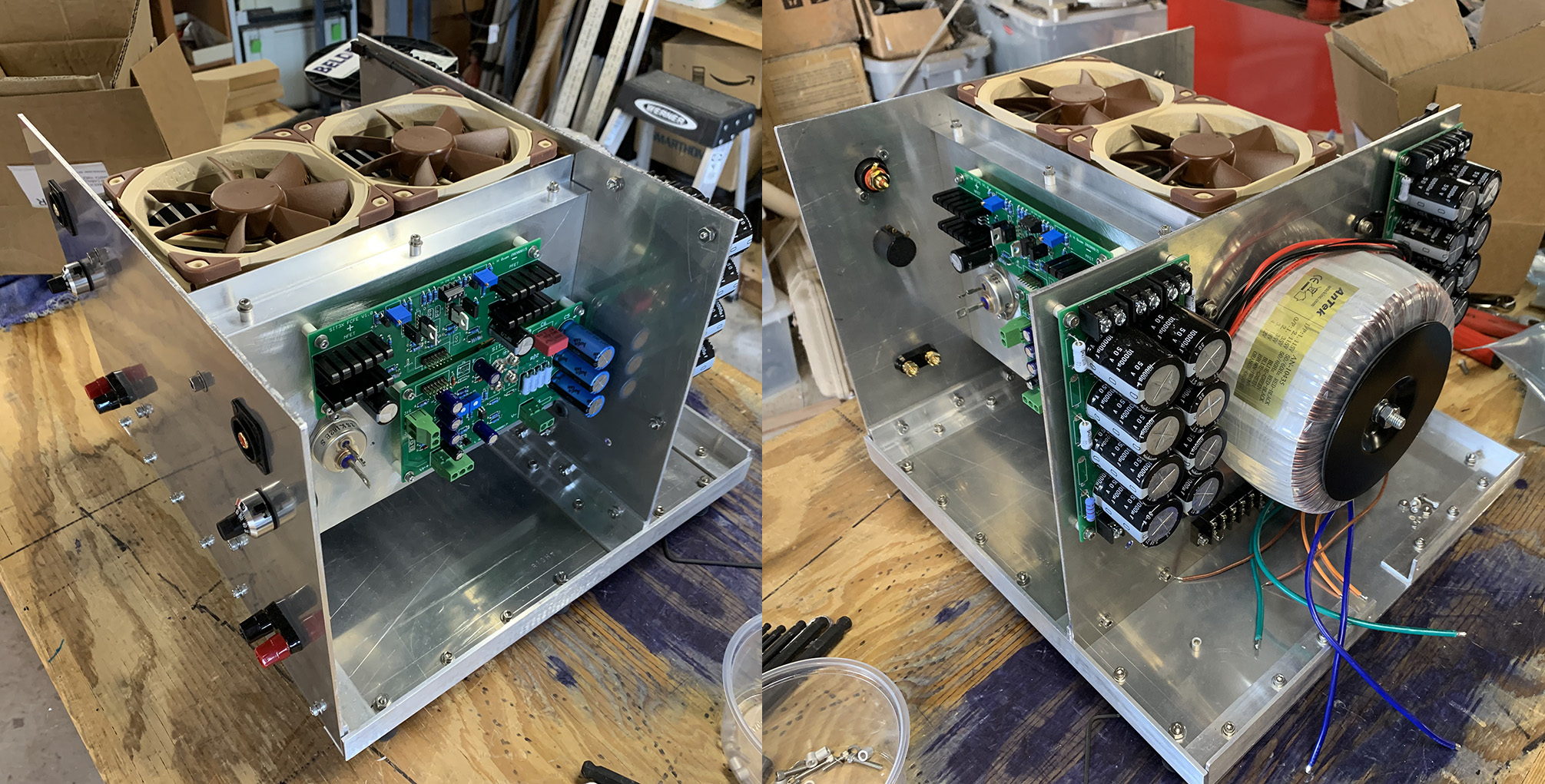

Just about ready to start wiring up my SIT-3X (basically a copy of Lynn's original prototype/transformer/heatsinks/fans). The one outstanding issue is finding the properly sized insulators for the 2SK182ES. Any suggestions as to where I might find such a beast?
I am glad to hear that you are planning to copy to SIT3X prototype. I knw that it works well. D not hesitate to ask questions.
I would like to hear from any others who are planning to copy to prototype.
Look familiar?

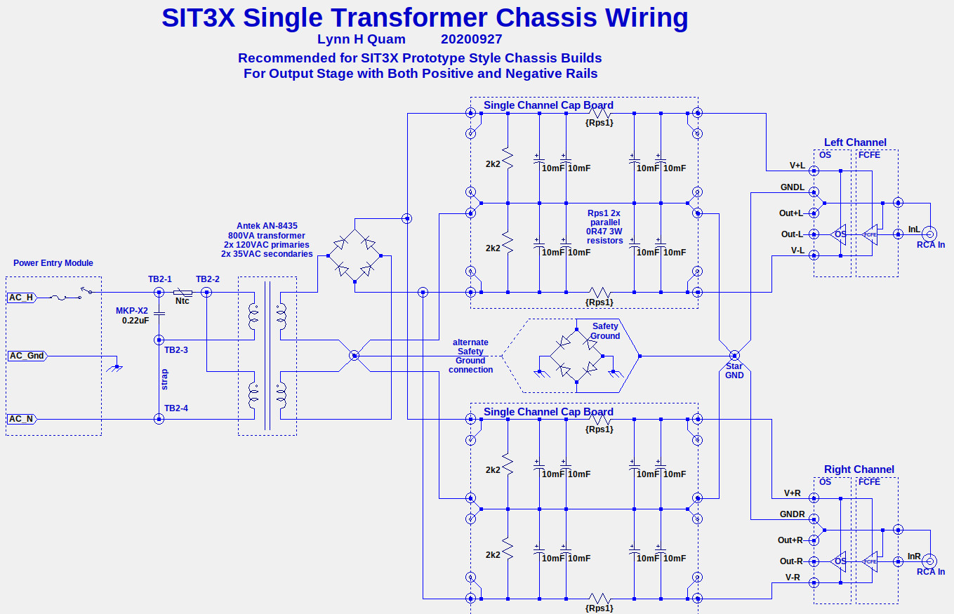

The previous git zip file had problems due to absolute file names in links. I am still learning how to use the Seamonkey HTML composer, and did not realize when it was using relative vs. absolute links. I think it is now fixed in the latest update to the git repository.

Perhaps misunderstood your question. I had been thinking about grounding issues and forgot that I had been seeking an opinion about second harmonic phase involving the choice of inverting vs. non-inverting front-ends.
The plots in posts #249 and #250 are representative of the behavior of the SIT3X with 44V rails and 1.8A bias.
In post #249 the attenuation level is adjusted for the PFET acting as a CCS at low power levels. This where I have done most of my listening.
In post #250 the attenuation level is adjusted into the pull-pull region where the SIT and PFET are fighting each other. I have not done a lot of listening in the region.
