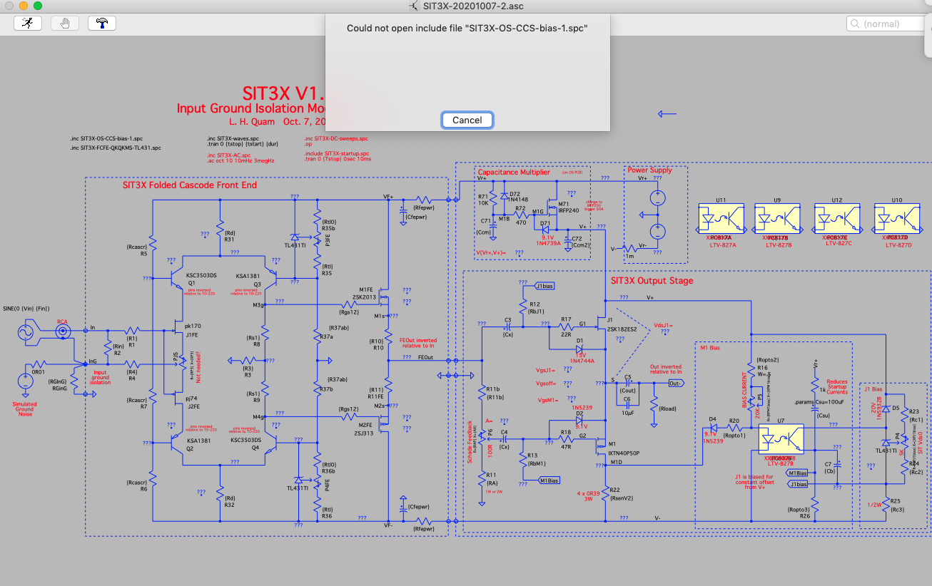

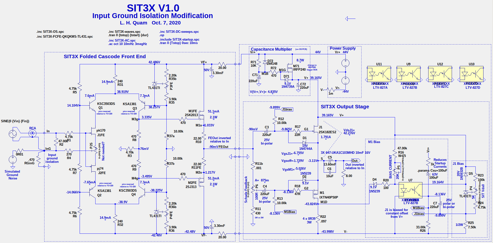

Attached is a zip file containing the LTSpice files for simulating the two major versions of the SIT3X amplifier. Unzip the files into a directory and you should be able to run LTSpice on the .asc files. The file SIT3X-waves.spc contains parameter definitions for the transient response simulation. The file models.spc contains transistor models and a few other models.
I believe that the file collection is self contained, not depending on other files in my environment. Let me know about problems.

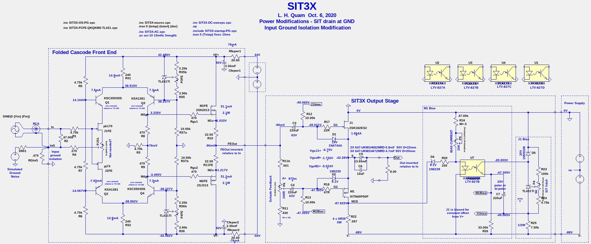

Request to all builders: I need suggestions on how to present the information you need for your builds. There appear to be three variants of the SIT3X:
Give me suggestions about the best way to present the information that you need.
- Fan cooled prototype with +/-44V rails, capacitance multiplier, ...
- 5U 400mm chassis with +/-34V rails, capacitance multiplier, ...
- 5U 400mm chassis with 0V/-88V, NO capacitance multiplier, ...
Lynn - In the Initial Adjustments document, FCFE Adjustment section, second para, I believe the reference to R35a(b) should be R35b/R36b. Thanks!

Hi Lynn, could you clear up my confusion re/ LTV-817B (in the BOM) vs the LTV-827B (in the latest schematics)?
You seem to have changed this on the schematics, together with the value of R16, which was 22K/.5W, and is now 47K/.5W
It looks to me that LTV-827B is just the dual-optocoupler version (and thus would not fit the PCB), so I guess that should just be re-labled in the schematics.
But why the change of R16 to 47K? Thanks!
