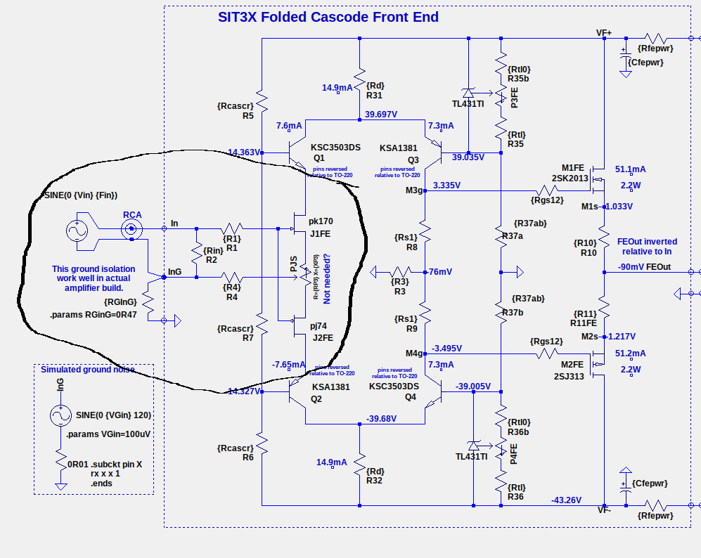

I found a very simple change to the FCFE JFET input that fixes the problem due to transformer fields affecting the wiring paths between the power supply(s) and the FCFE PCBs. Due to the 10X voltage gain of the FCFE, it requires only about 100uV of difference in the induced transformer noise to the FCFE signal grounds to create 1mV noise at the output.
The 1st image shows the circuit modification placing a 0R47 resistor between the RCA ground and the FCFE signal ground, and to tying the ground end of R4 to the RCA ground.

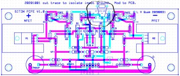

The 2nd image shows the change to the FCFE V1.0 PCBs, cutting one trace and adding one 0R47 resistor between the two ground pins on the input terminal block. The reason that this works is because the JFET input circuit is a differential amplifier with inputs at the gates and the source pins, and can tolerate a common mode signal on the those inputs. In this case, the common mode signal is the difference between the RCA ground and the FCFE signal ground.

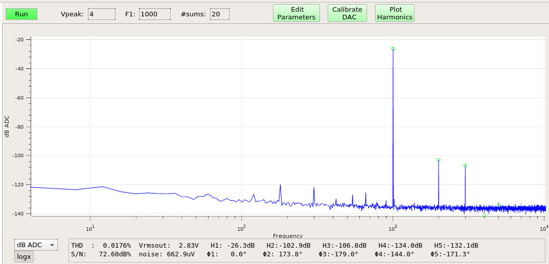

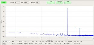

The 3rd image below shows the Output spectrum for 1 Watt into 8R. You can see that the 60Hz harmonics are 94dB or more below the 1 Watt level, or 2.82/10^(94/20)=58uV, and the broadband noise spectrum is very good.
