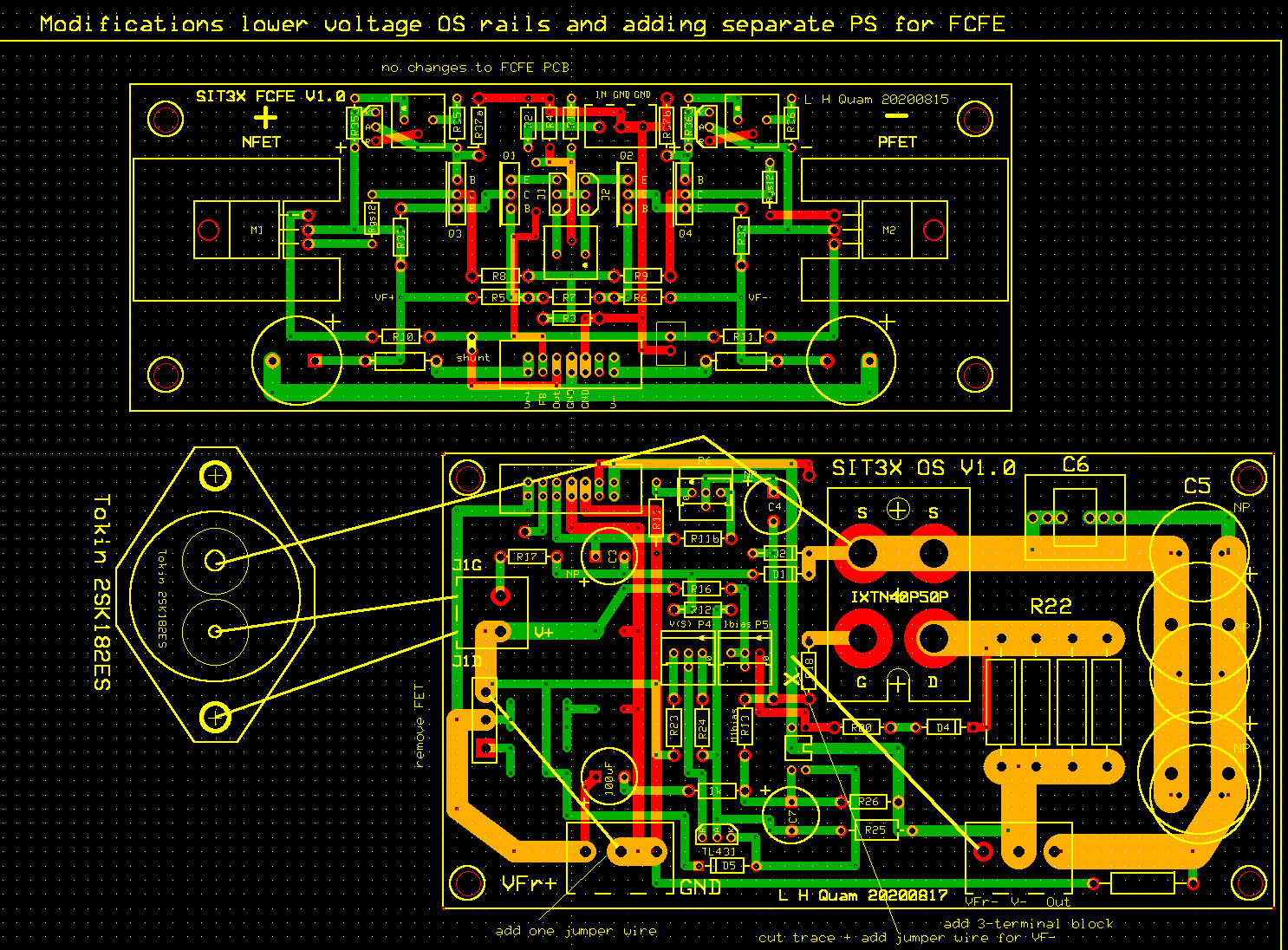

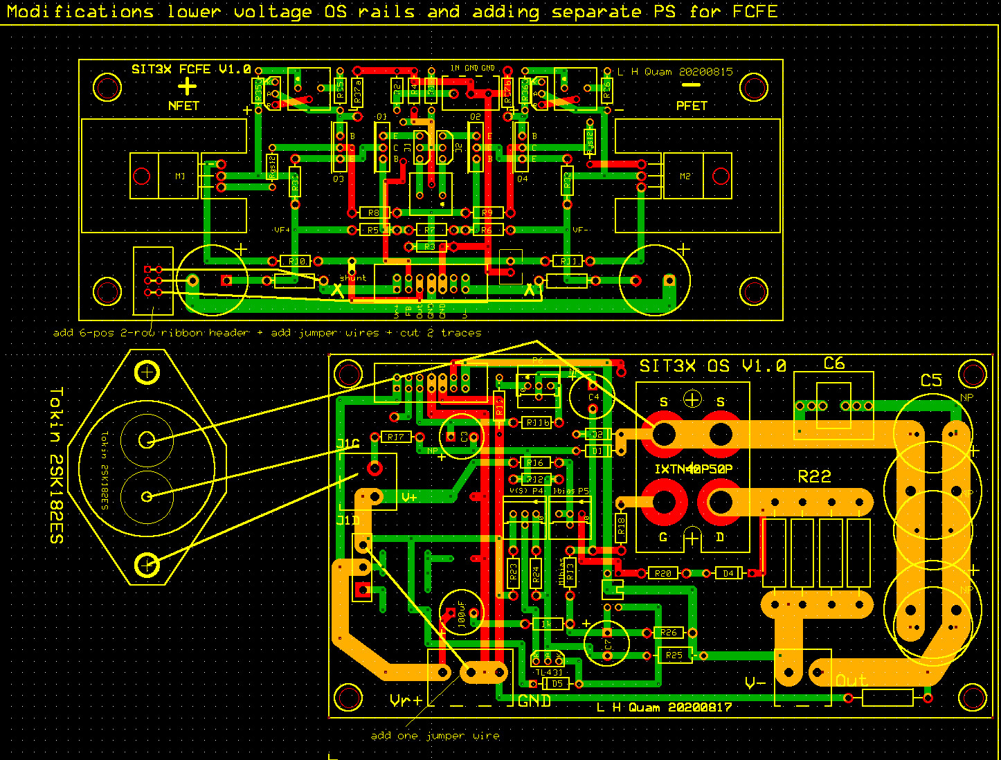

Here is the situation. The rail voltages for the SIT3X prototype were largely determined by my goal for 50W output power into an 8R load (28.28V peak). With fan cooled heatsinks, the idle power dissipated was not an issue. There are two primary factors that necessitate that the rail voltages be more than about 38V to accomplish the 50W goal:
I show below the modified schematic and PCB modifications for such a change.
The major downsides to such a change are:
- The FCFE output voltage swing is about 8 volts less than the rail voltages due to Vgs drops on the Toshiba output FETs, source resistors, and the folded cascode resistors connected to the rails. The voltage swing is further reduced if IRF or Fairchild FETs are used.
- The capacitance multiplier reduces the OS stage maximum output swing by about 5 volts, but that reduction is below the OS rail voltages, and is not dependent on FCFE output swing.
- Modifications to PCB are required.
- Additional small power supplies are required.
Better yet PCB modification.
- No change to FCFE PCBs.
- On OS PCB
- remove IRFP240 NFET
- drill one hole
- replace 2-position terminal block with 3-position block
- cut one trace as shown
- add 2 jumper wires as shown

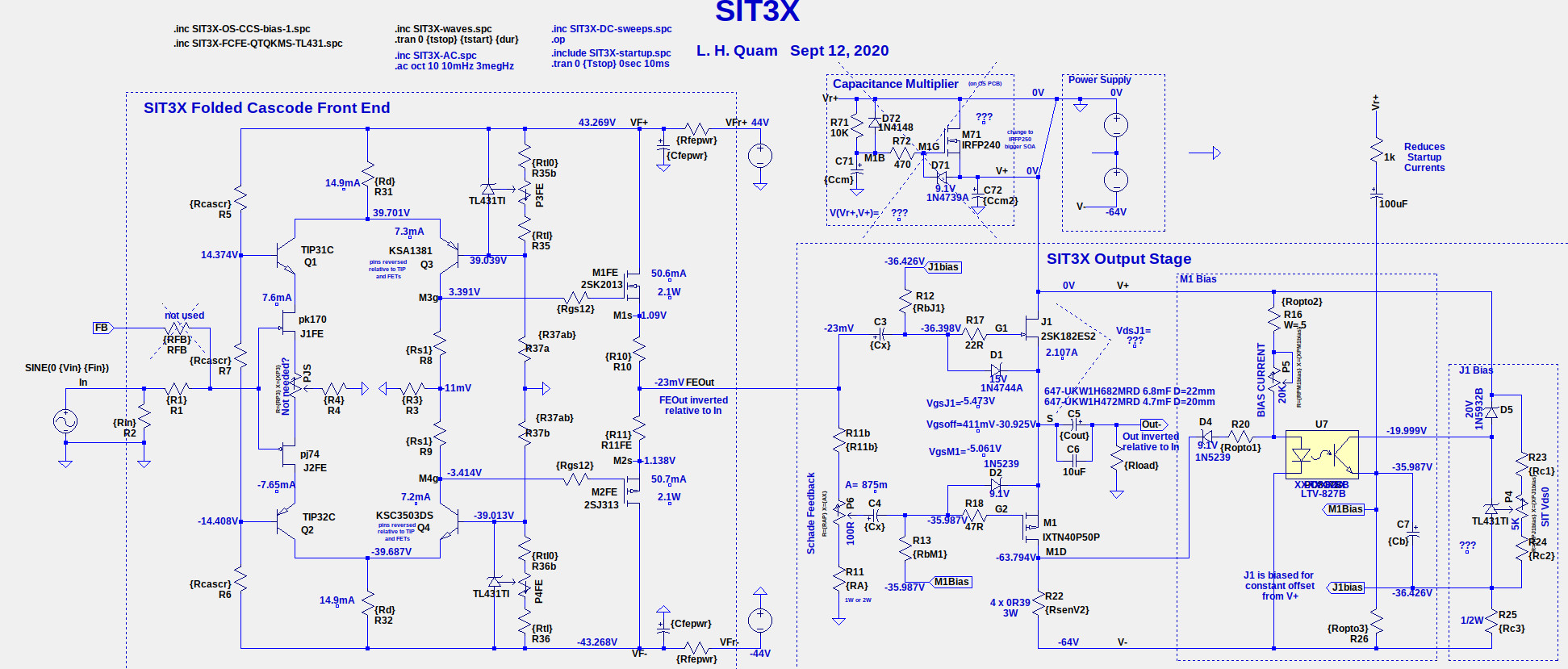

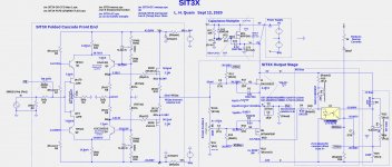

The SIT (2SK182ES) drain current is sensitive to Vds, because of its triode-like character. Thus it is important that the SIT drain be at a constant voltage relative to the input ground reference. That was the reason for the cap. multiplier when using V+/V- rails rather than 0/V- rails. It you look at the FirstWatt SIT-1 and SIT-2 circuits you will see the use of 0/V- rails.What happens with the noise floor when the cap multiplier is removed?
I have verified the ability to obtain 50W@8R output with THD<1.1% using a transformer with 28Vac secondaries, using a Variac with my prototype. The primary power supply output voltages are +/-34V and the OS bias was 1.8A. I did not disable the cap. multiplier. In order avoid clipping in the FCFE, its power inputs (VFr in the table below) must be +/-42V or higher.
Since I did almost no tuning of adjustable parameters, I expect that it is possible to improve the distortion measurements.
- 1W THD=.018 VFr = 33.9V
- 25W THD=.33 VFr = 33.9V
- 25W THD=.334% VFr = 42.9V
- 50W THD=6.6% VFr = 33.9V
- 50W THD=1.35% VFr = 38.9V
- 50W THD=1.1% VFr = 41.9V
- 50W THD=1.1% VFr = 43.9V
