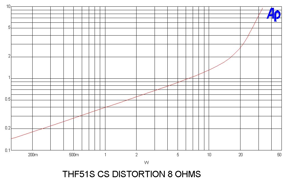

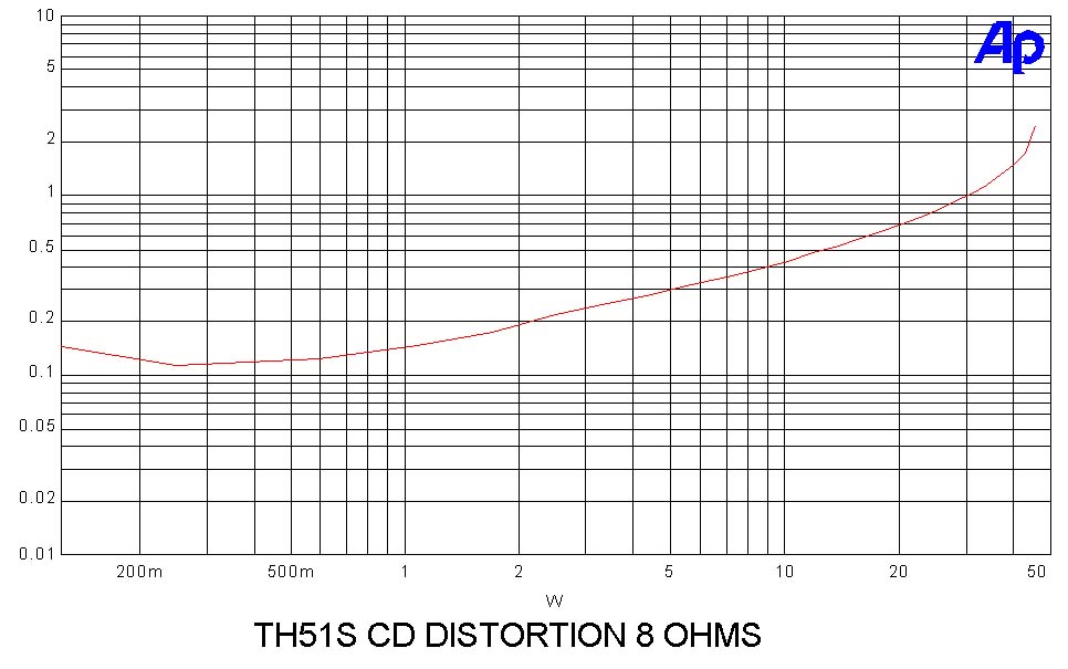

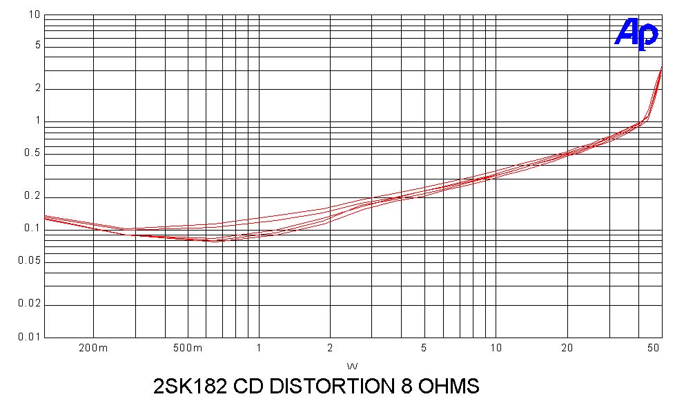

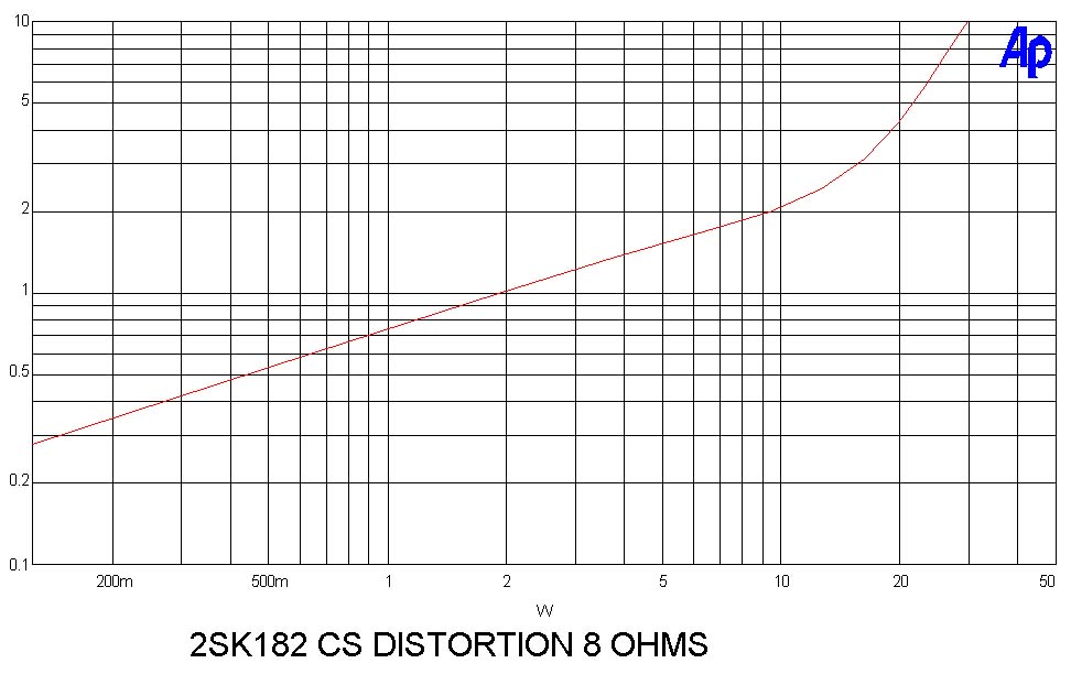

Here's some data on 2SK182 vs THF51S operated Common Source and
Common Drain, biased by a constant current source.

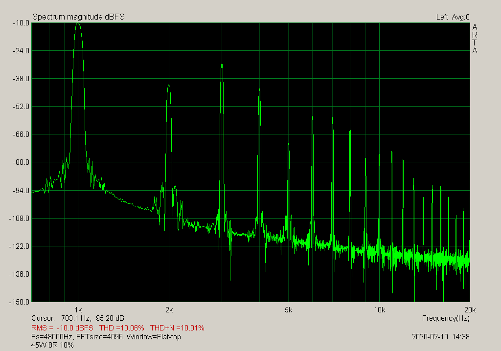

Oh Boy ...... ZM really trying to be systematic ..... twiddle deeeeee

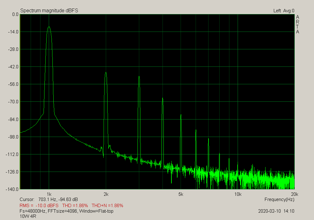

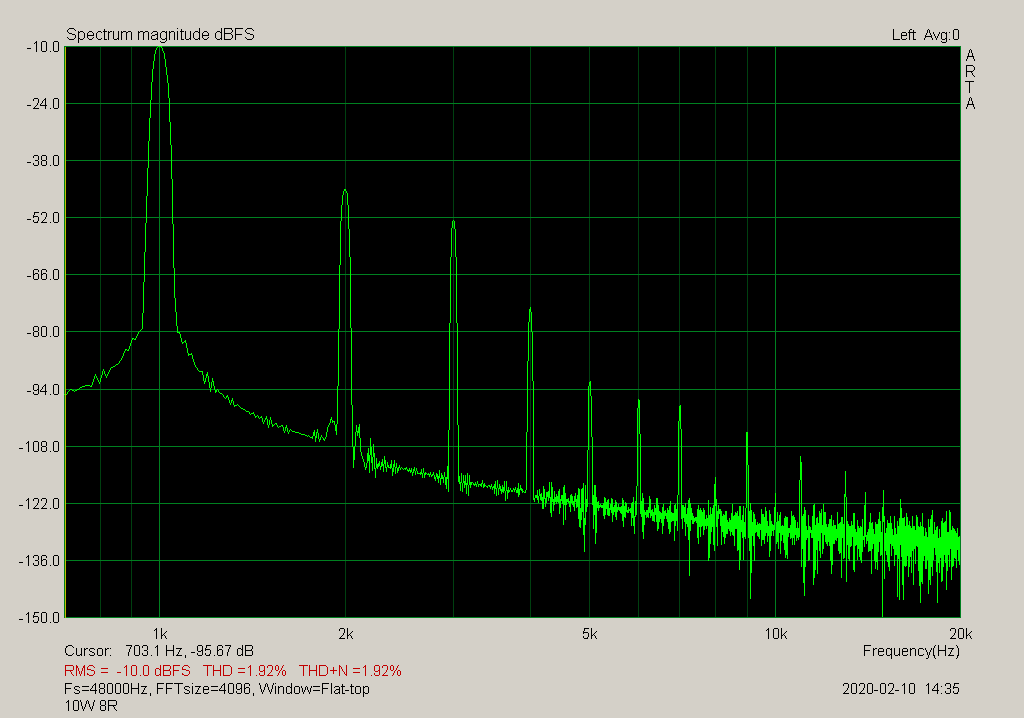

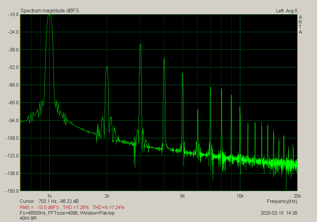

OK , I tried what I could , some refinement both for THF51S and 2SK182ES , to squeeze what I can and know , in Singing Bush format
objectives and goals:
- do not alter schematic , just values and settings
-do not resort to higher voltages , keeping demands for caps at 75-80V bay
-both lowest THD and dominant 2nd, as must
so , what I did , in general :
THF51S - tested one proper pair (matched solely by Ugs) , to confirm similar behavior ; after that tested two more specimens furthest away bu Ugs , being on my disposal
2SK182ES - two of them tested- lowest Ugs and highest Ugs specimens I have
will break posts - one battery of test per post
manage if you can ...... :rofl:

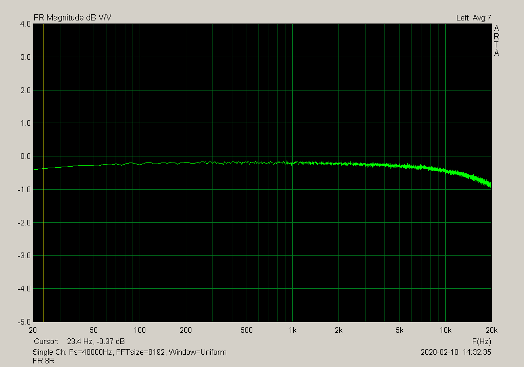

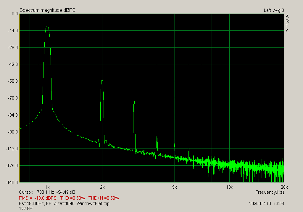

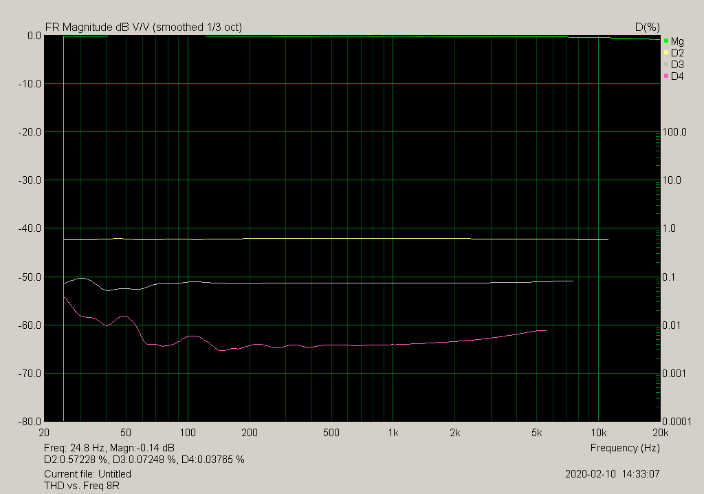

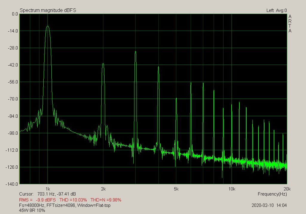

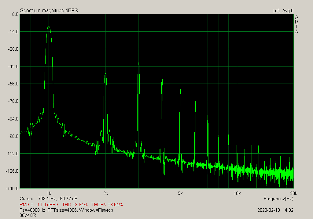

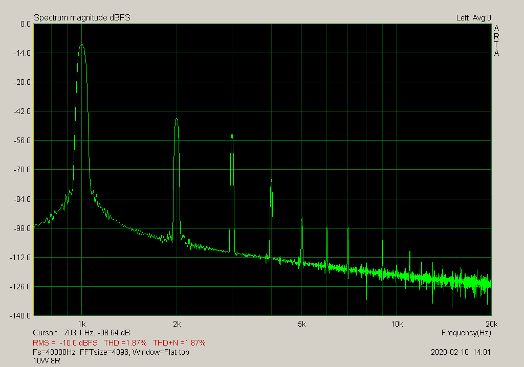

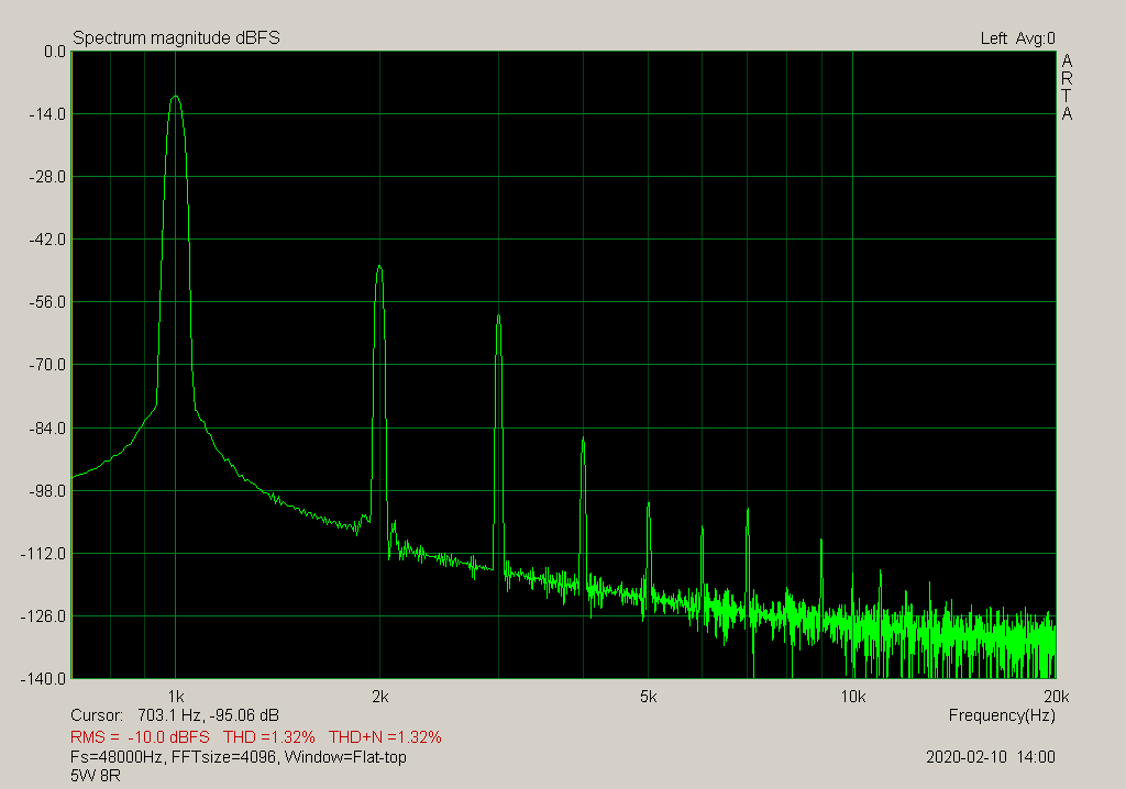

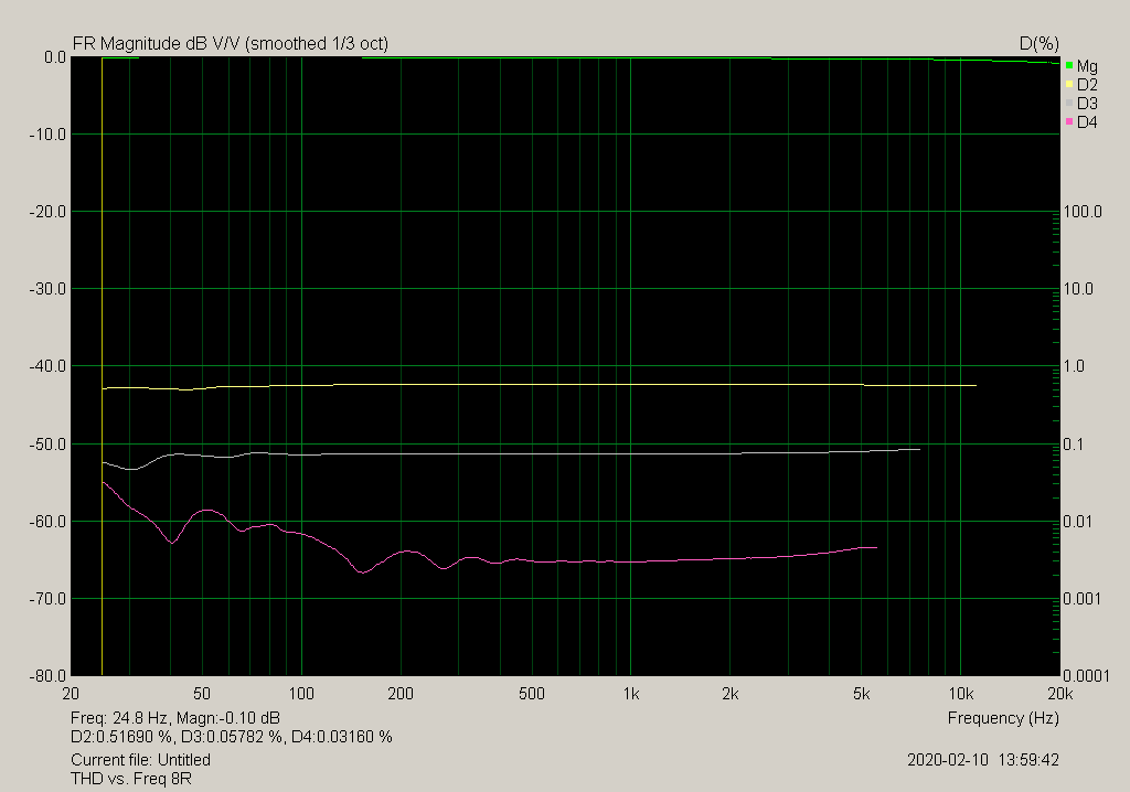

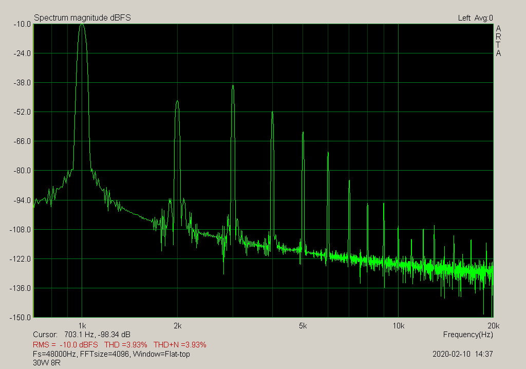

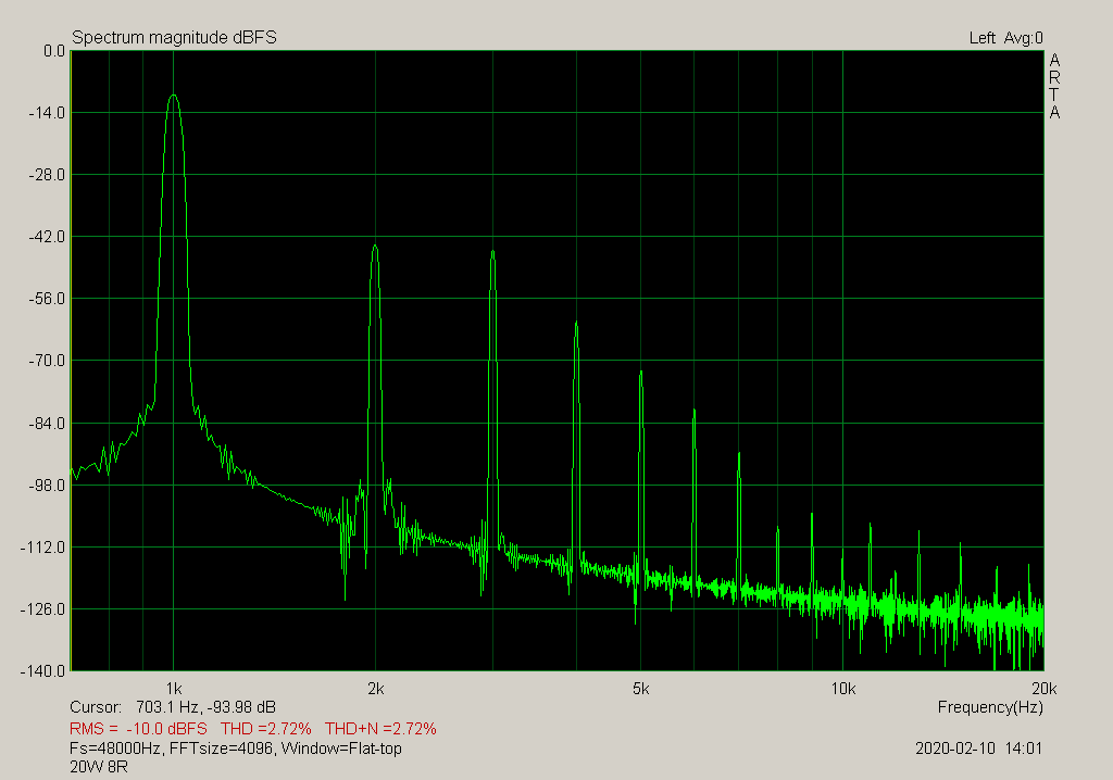

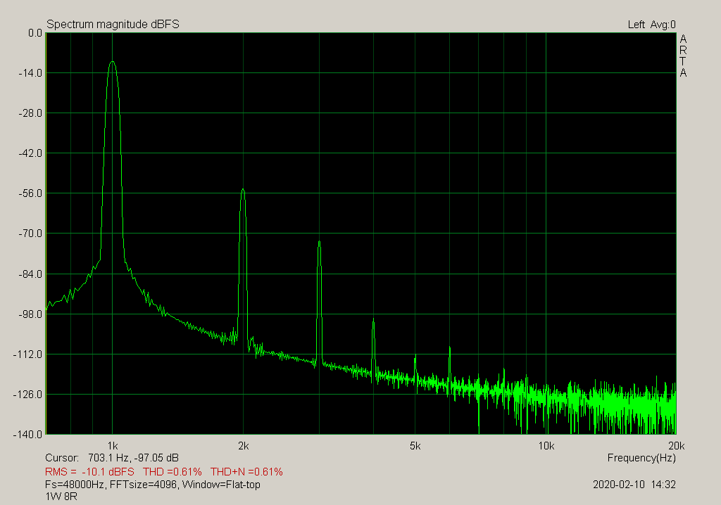

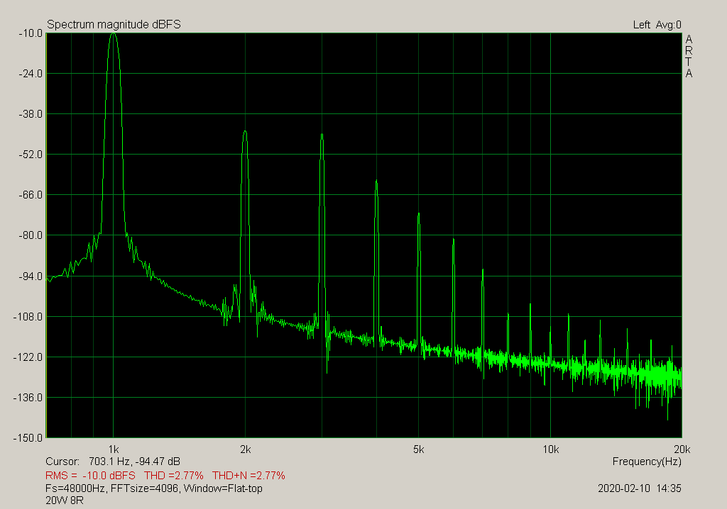

THF51S , Ser. 1Z0081 , first from matched pair, 8R load
Rail 65Vdc
Iq 2A3
output node 37Vdc
Mu resistor string 6 x 0R1
output taken 02R from bottom
this one , Ugs -3V21

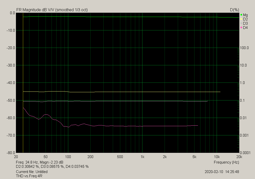

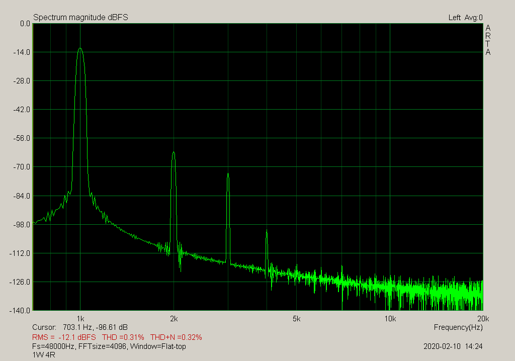

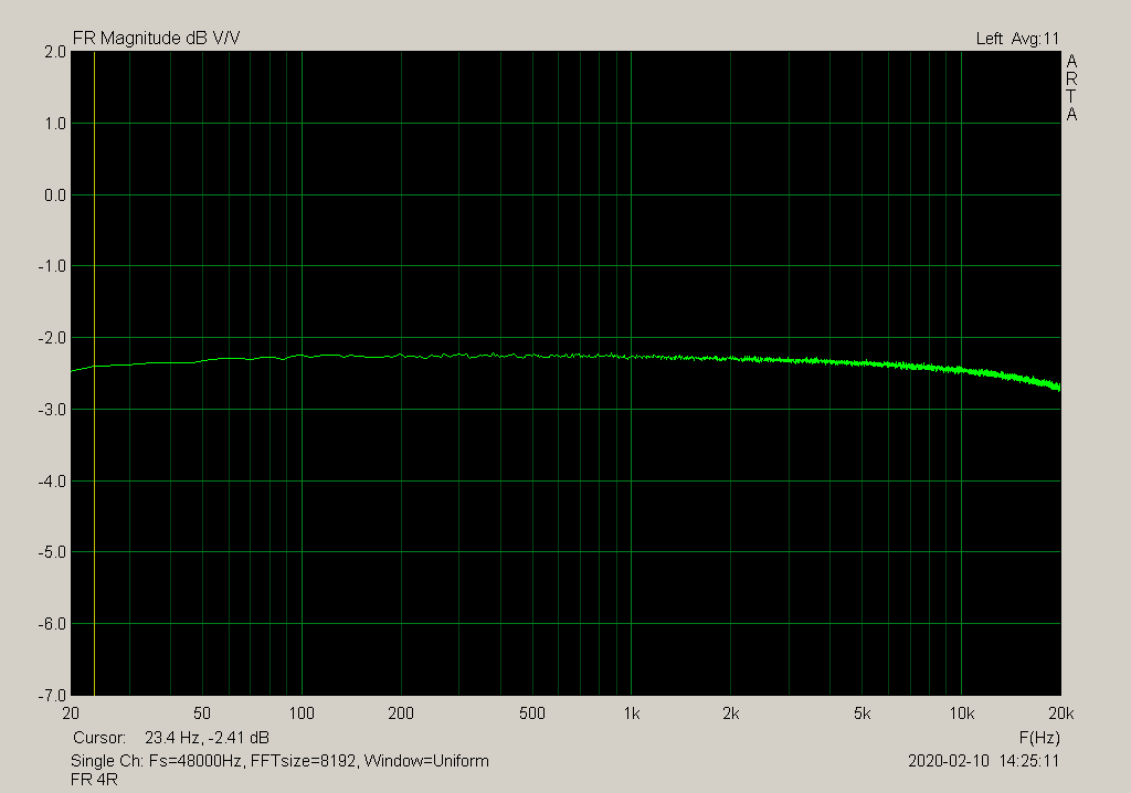

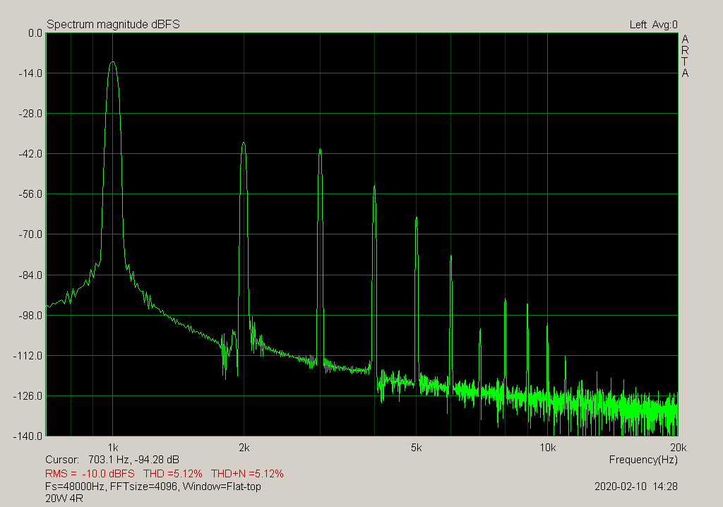

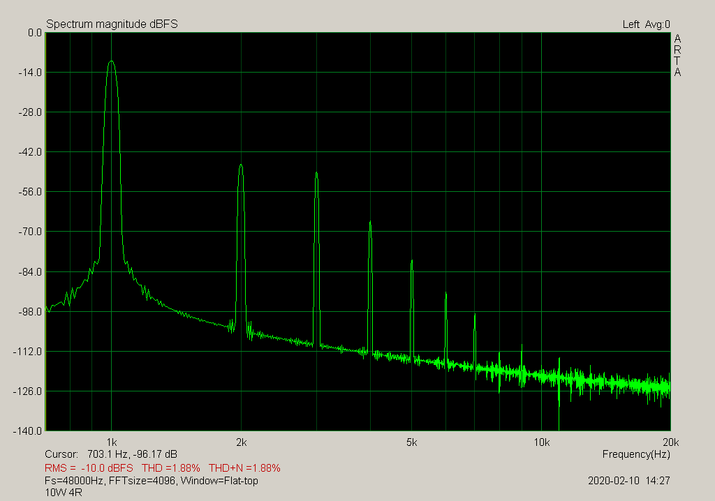

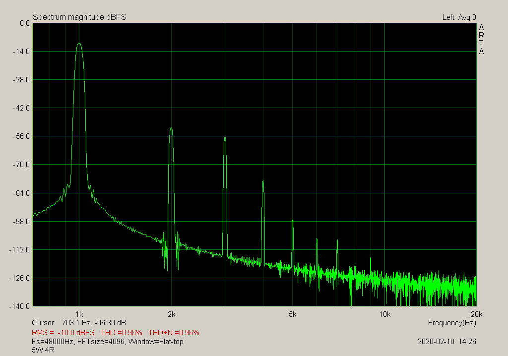

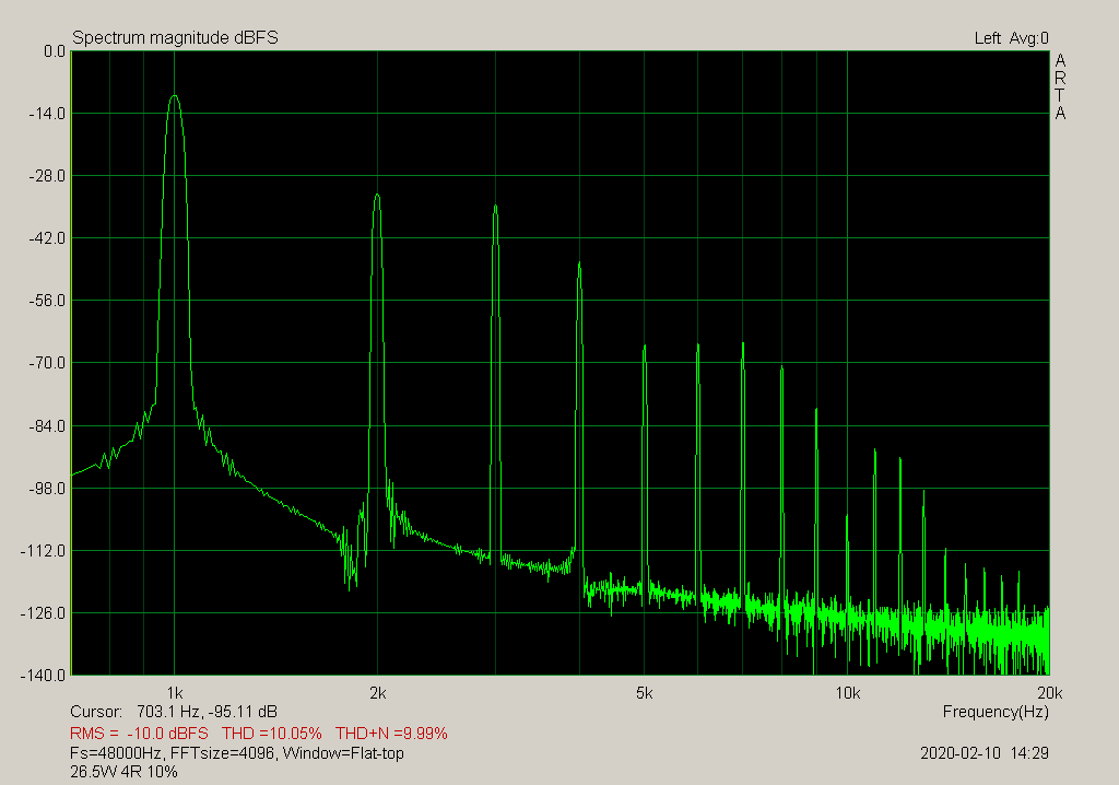

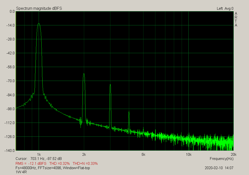

THF51S , Ser. 1Z0081 , first from matched pair, 4R load
same conditions
again , this one , Ugs -3V21

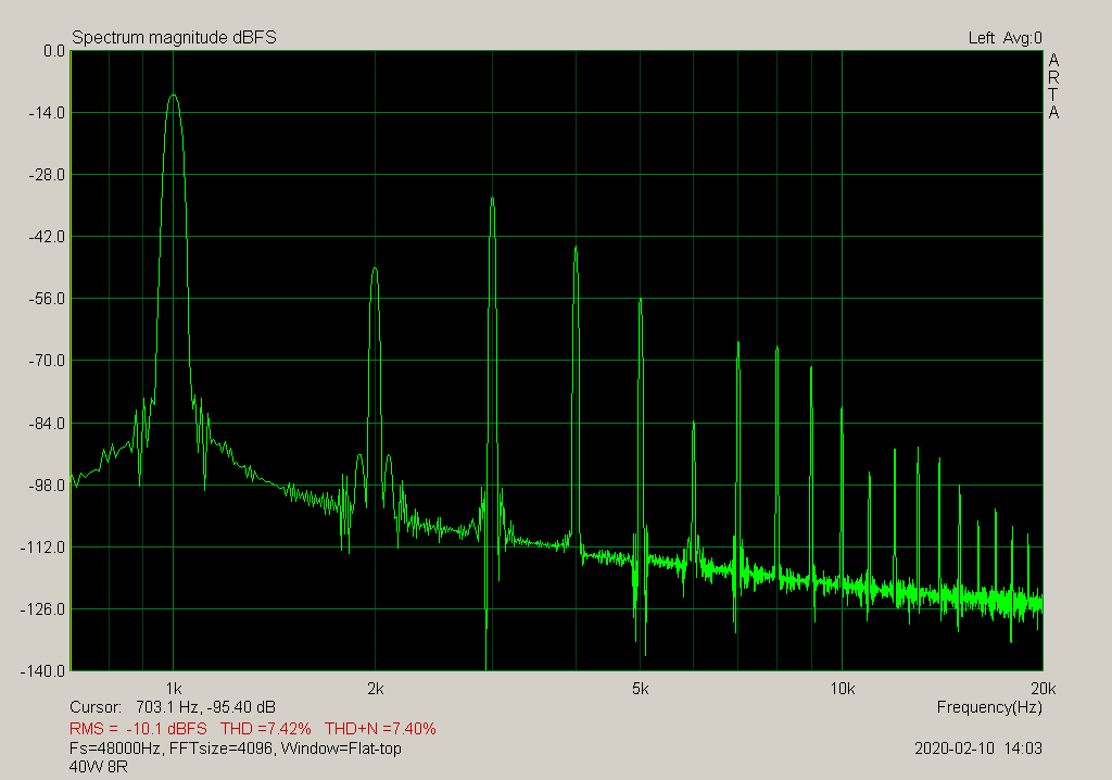

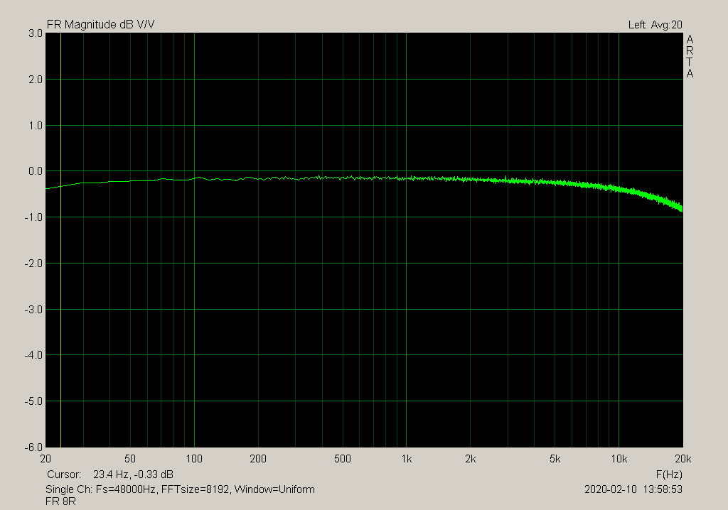

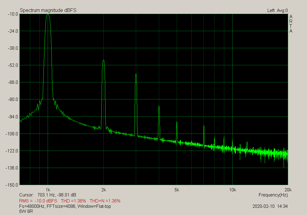

THF51S , Ser. 1Z0115 , second from matched pair, 8R load
same condition
this one , Ugs -3V22

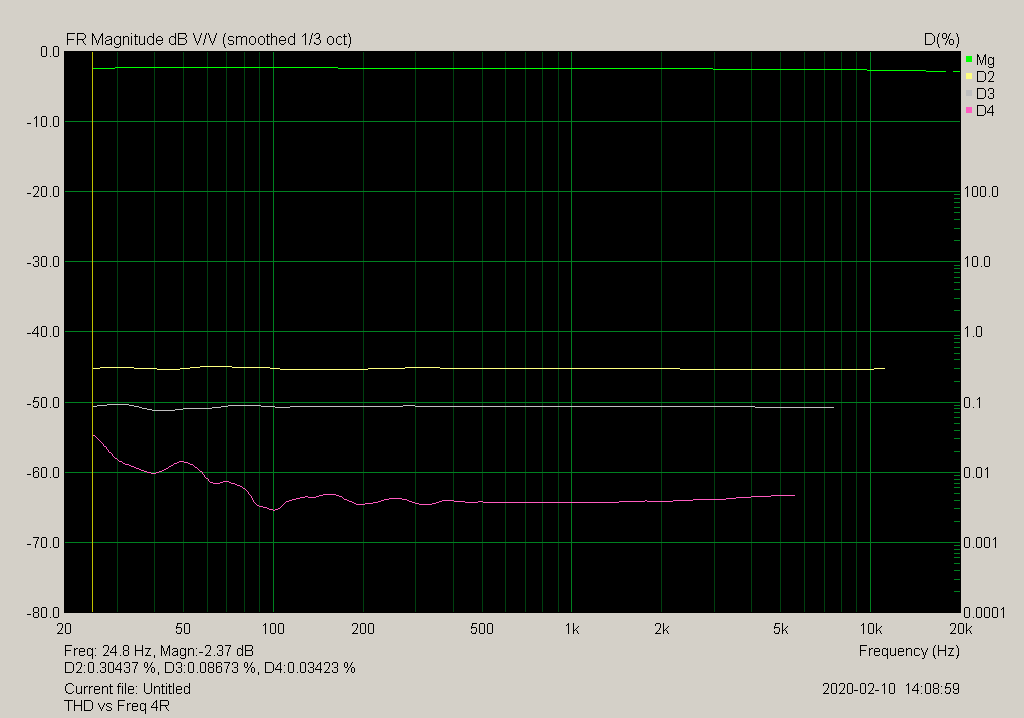

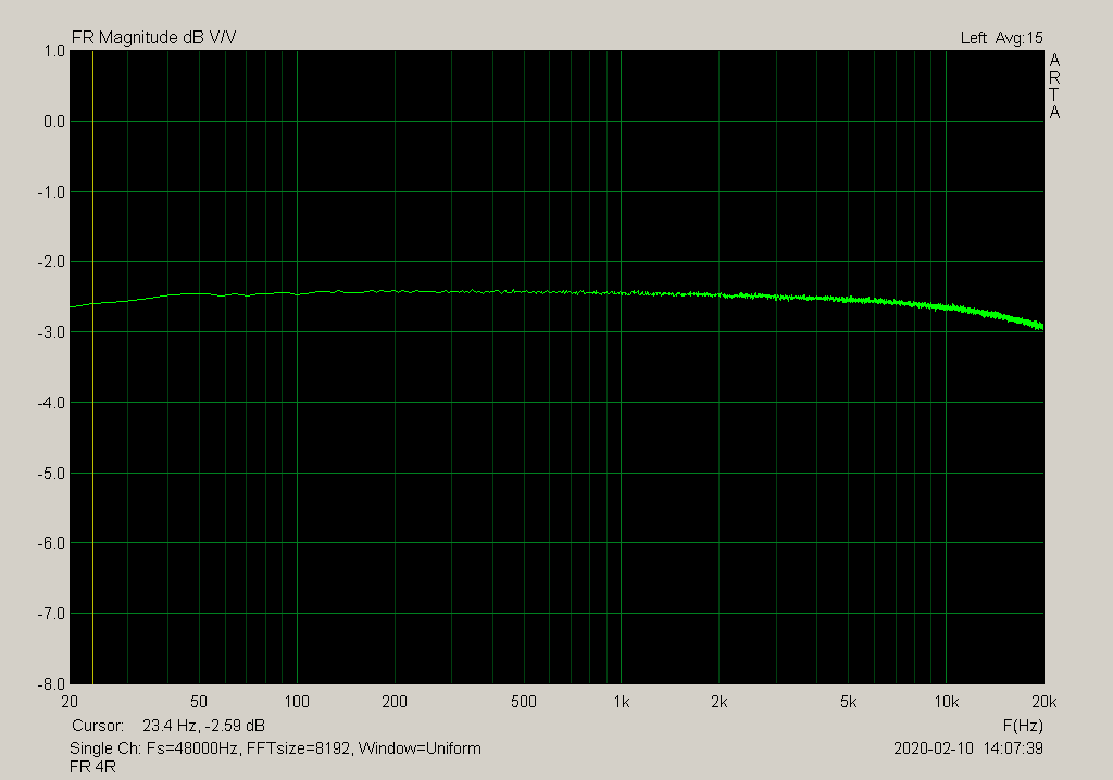

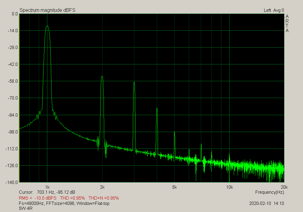

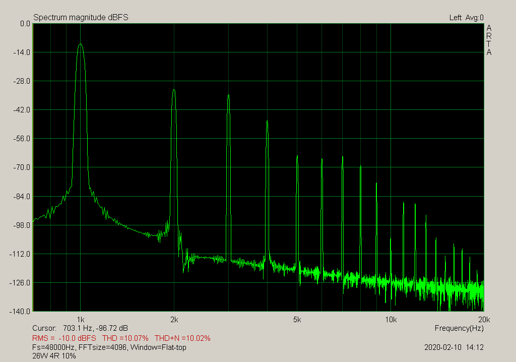

THF51S , Ser. 1Z0115 , second from matched pair, 4R load
same condition
again, this one , Ugs -3V22
