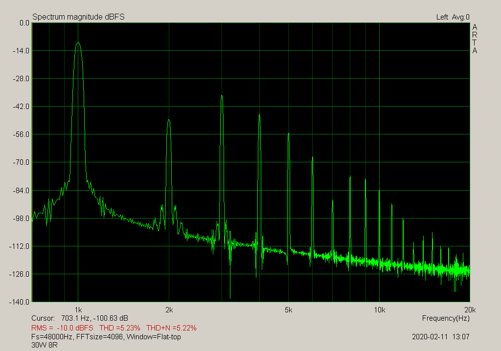

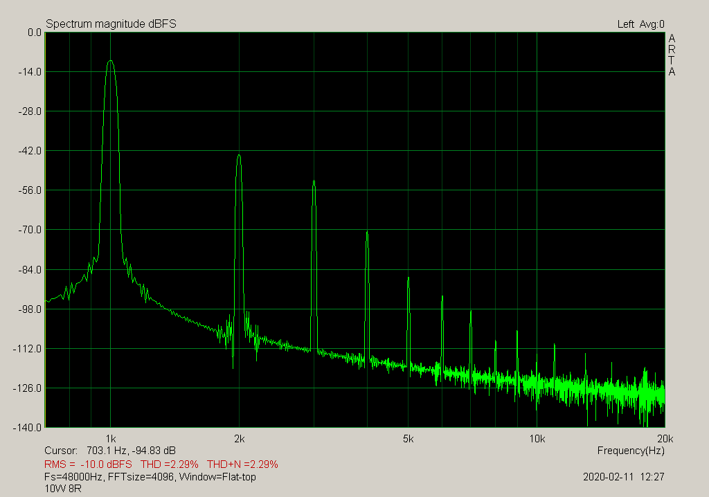

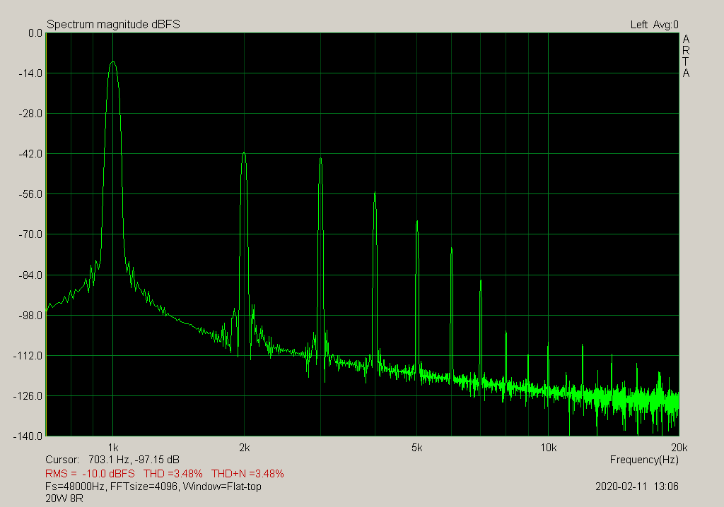

The Singing Bush

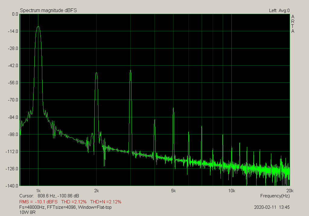

Official Court Jester
Joined 2003
THF51S , Ser. 1X4343, 8R load
same conditions
further Ugs value , Ugs -4V01

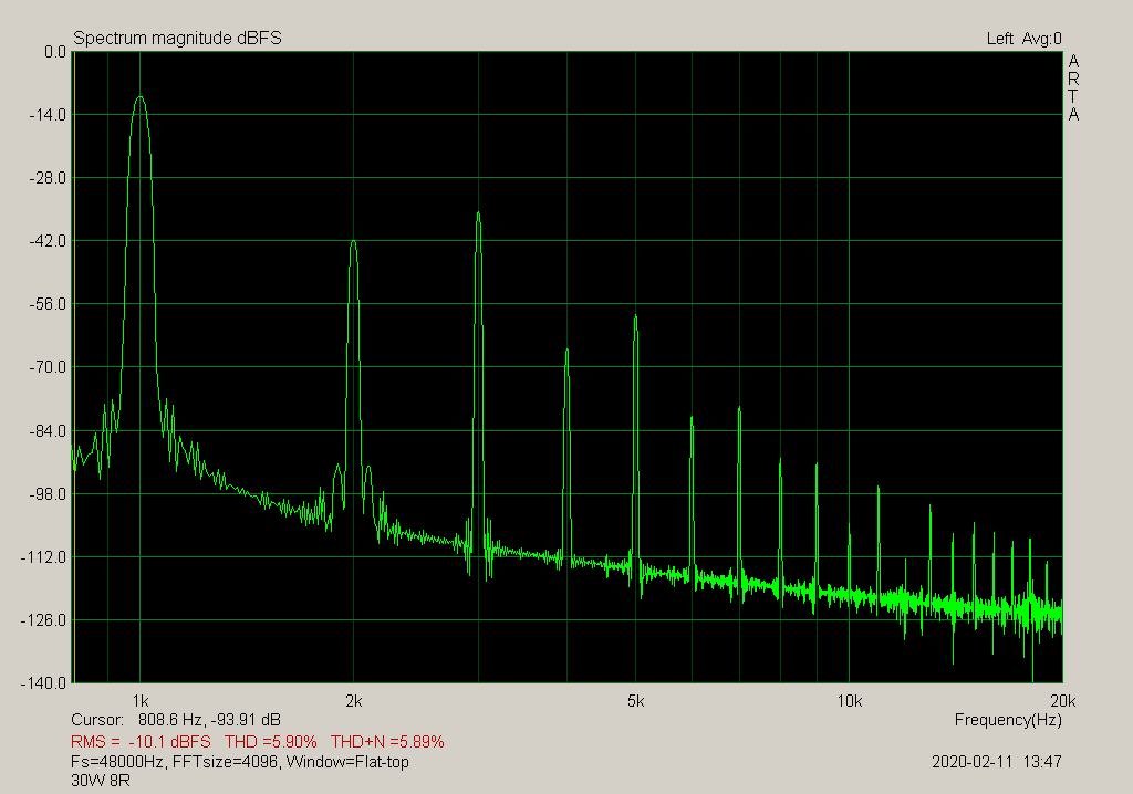

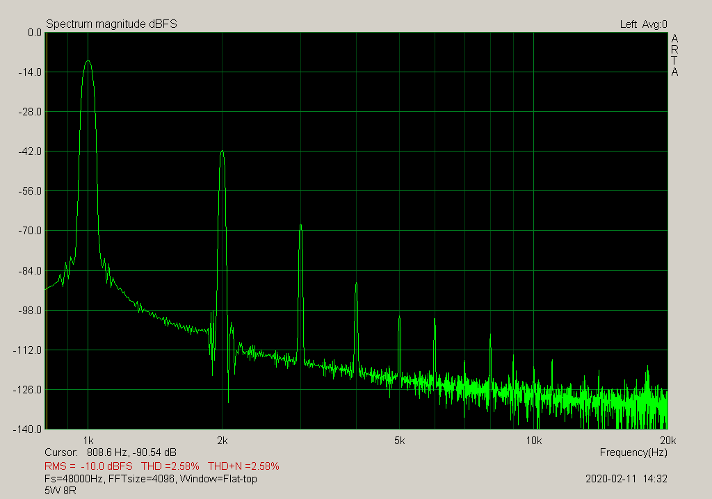

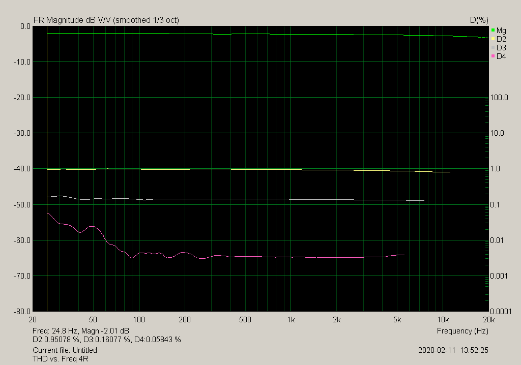

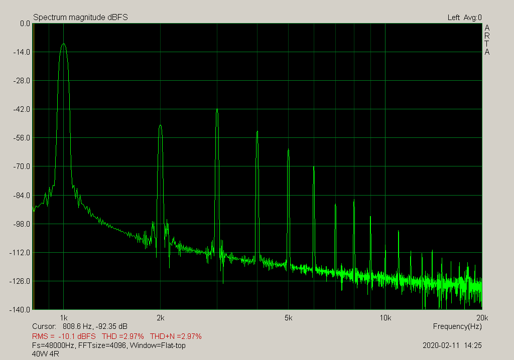

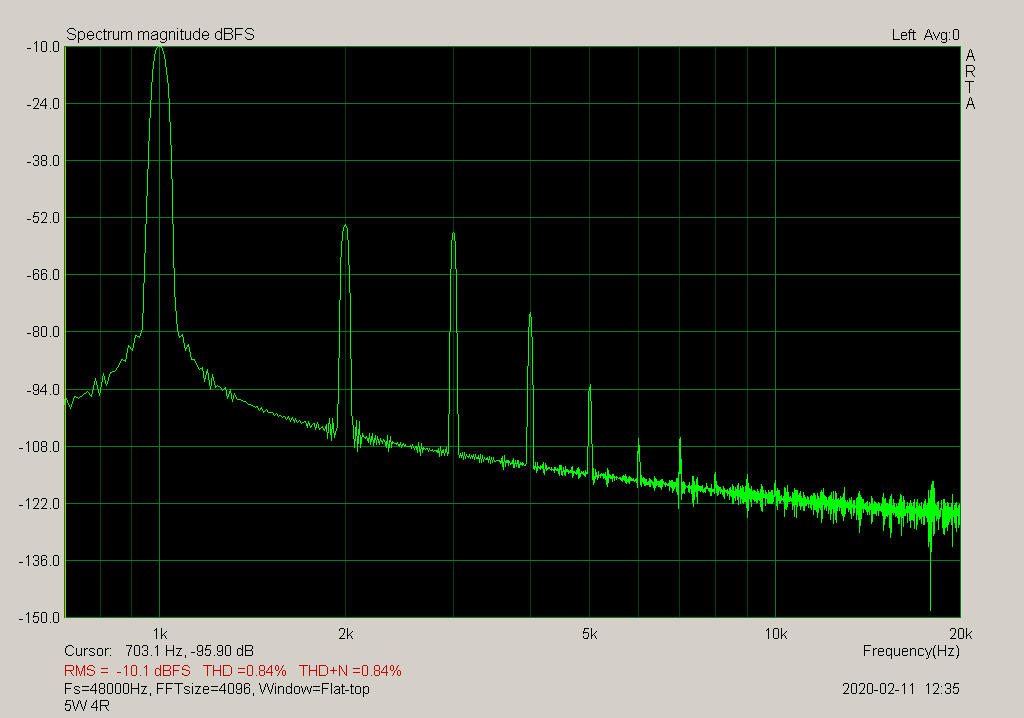

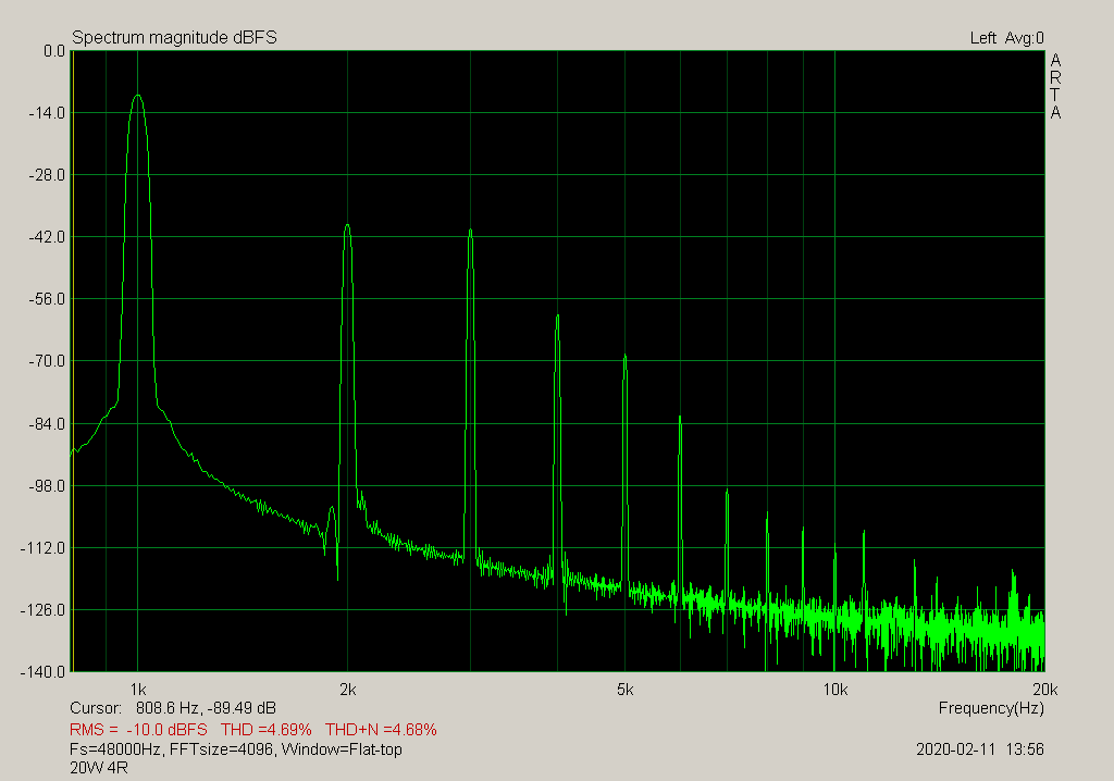

Joined 2003

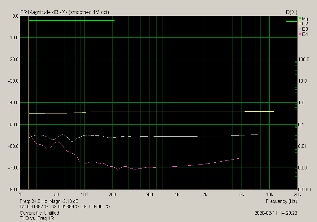

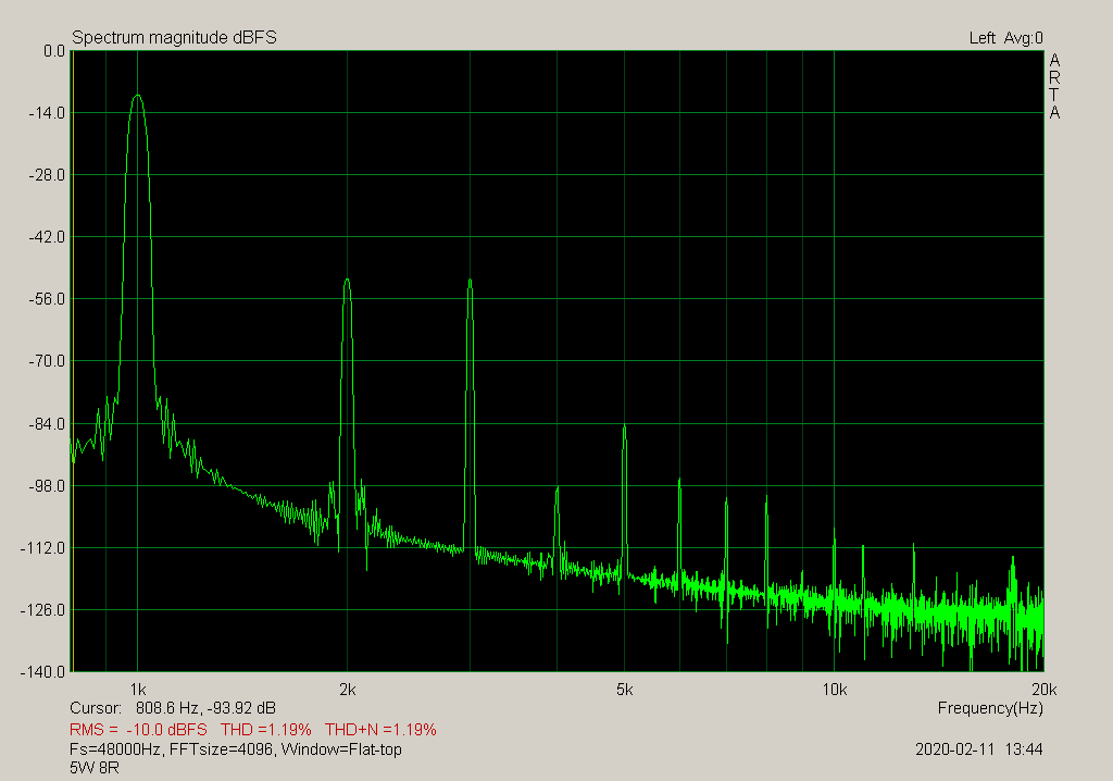

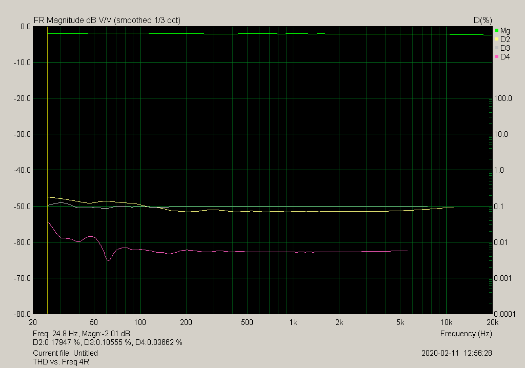

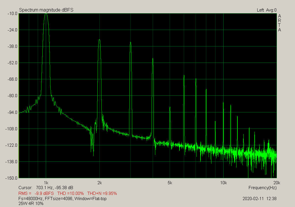

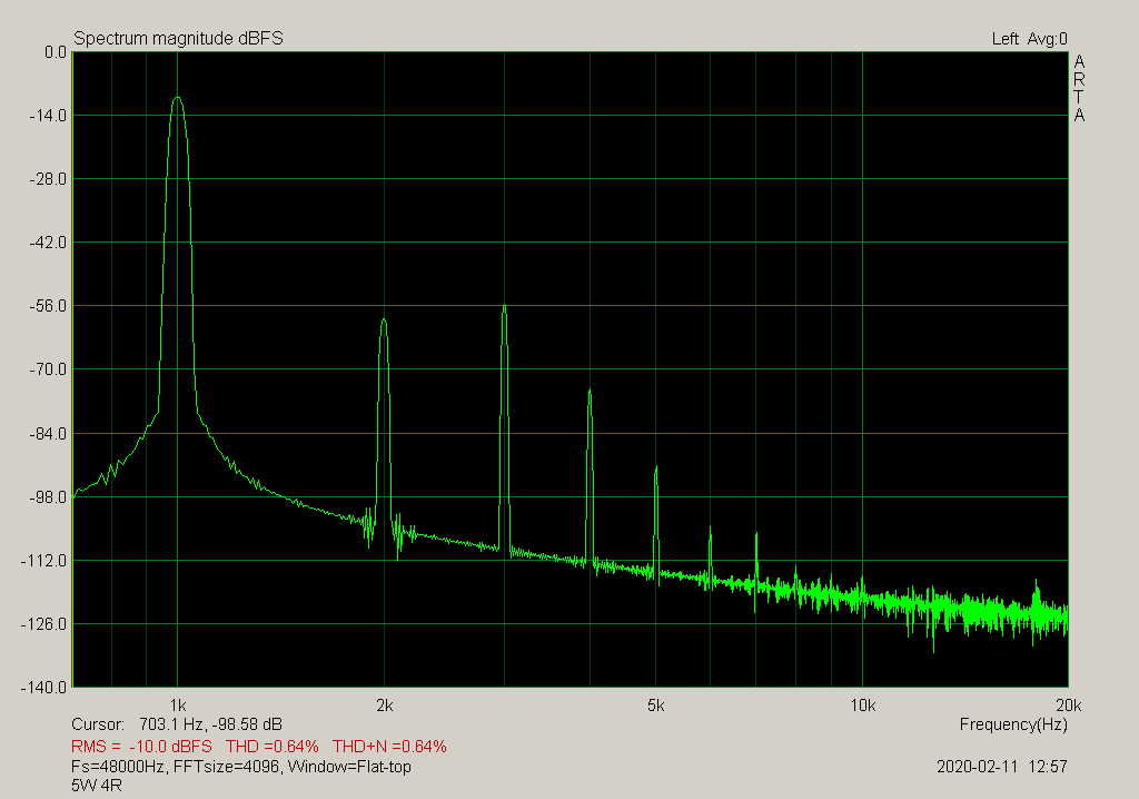

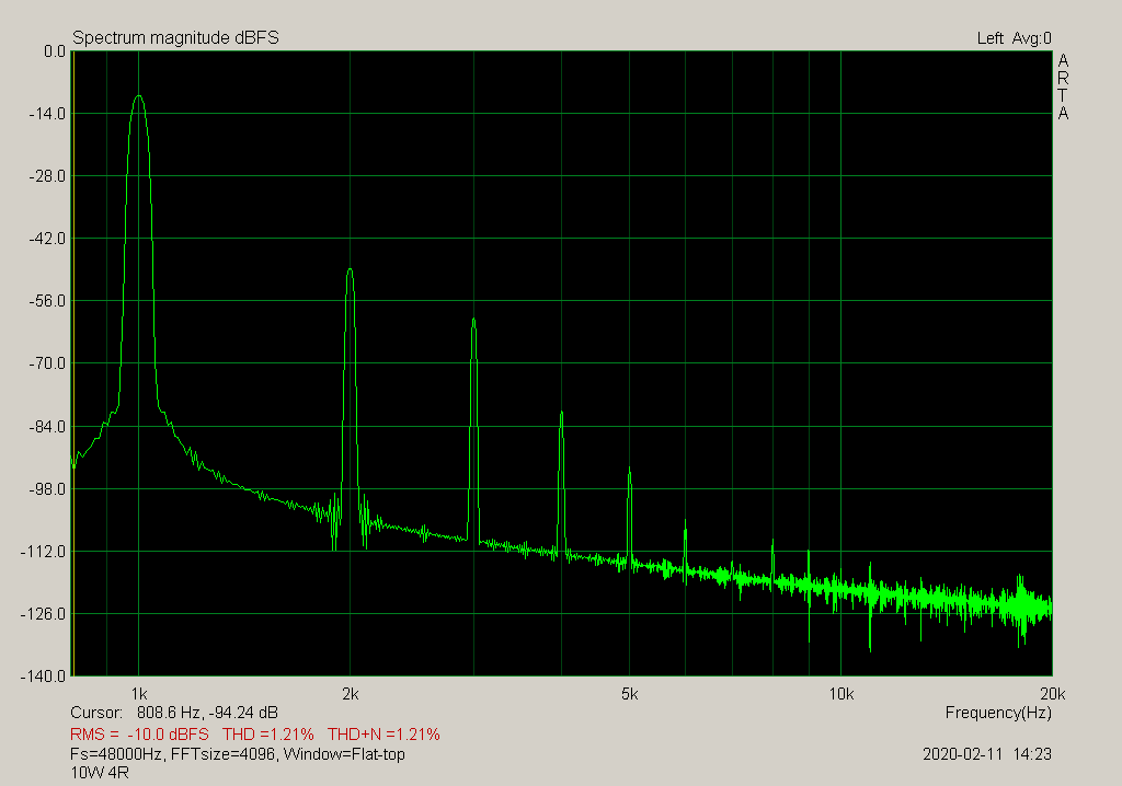

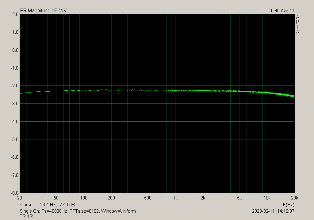

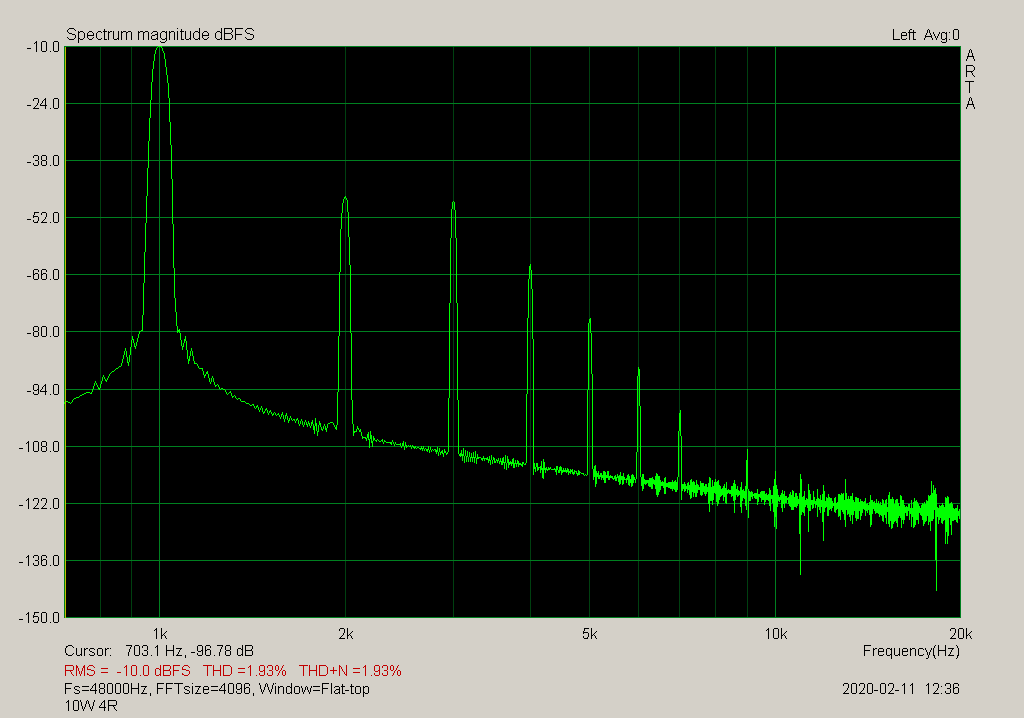

THF51S , Ser. 1X4343, 4R load
same conditions
again, further Ugs value , Ugs -4V01

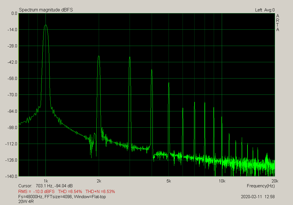

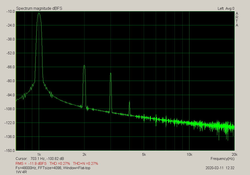

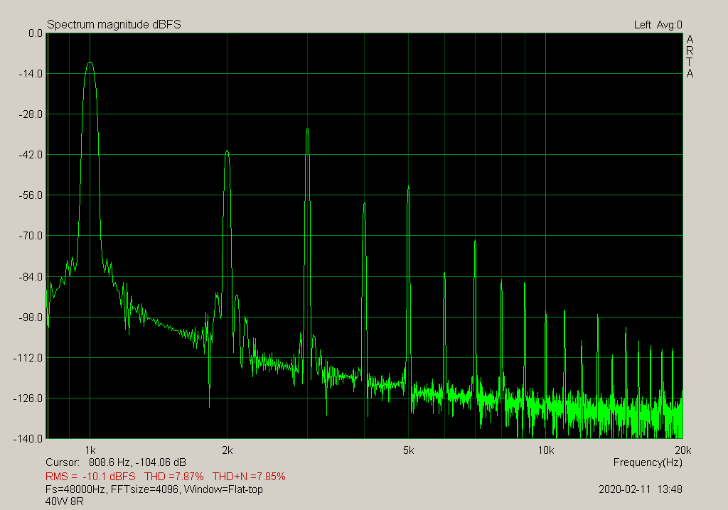

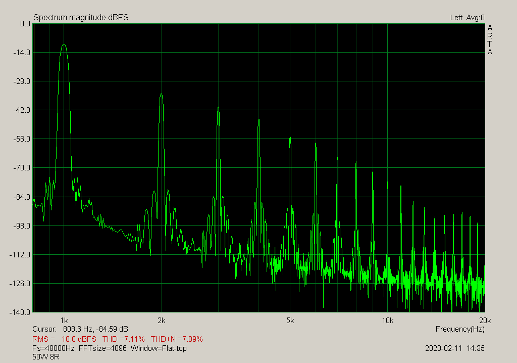

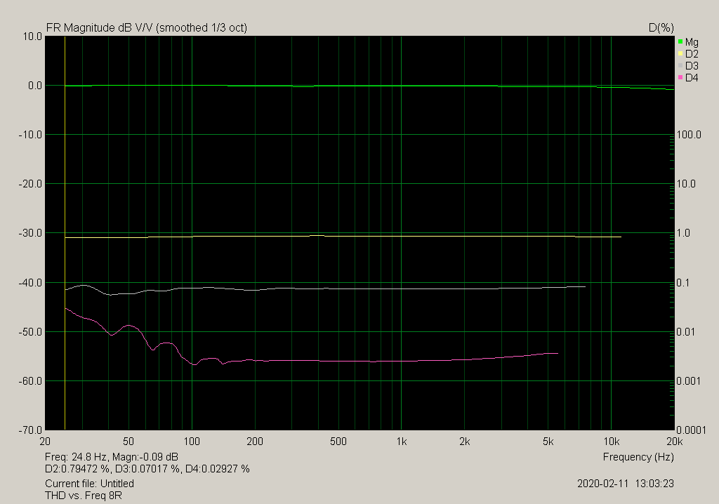

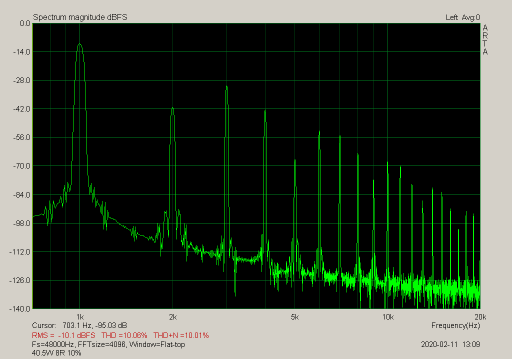

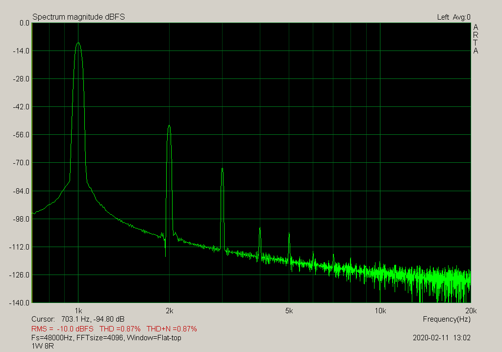

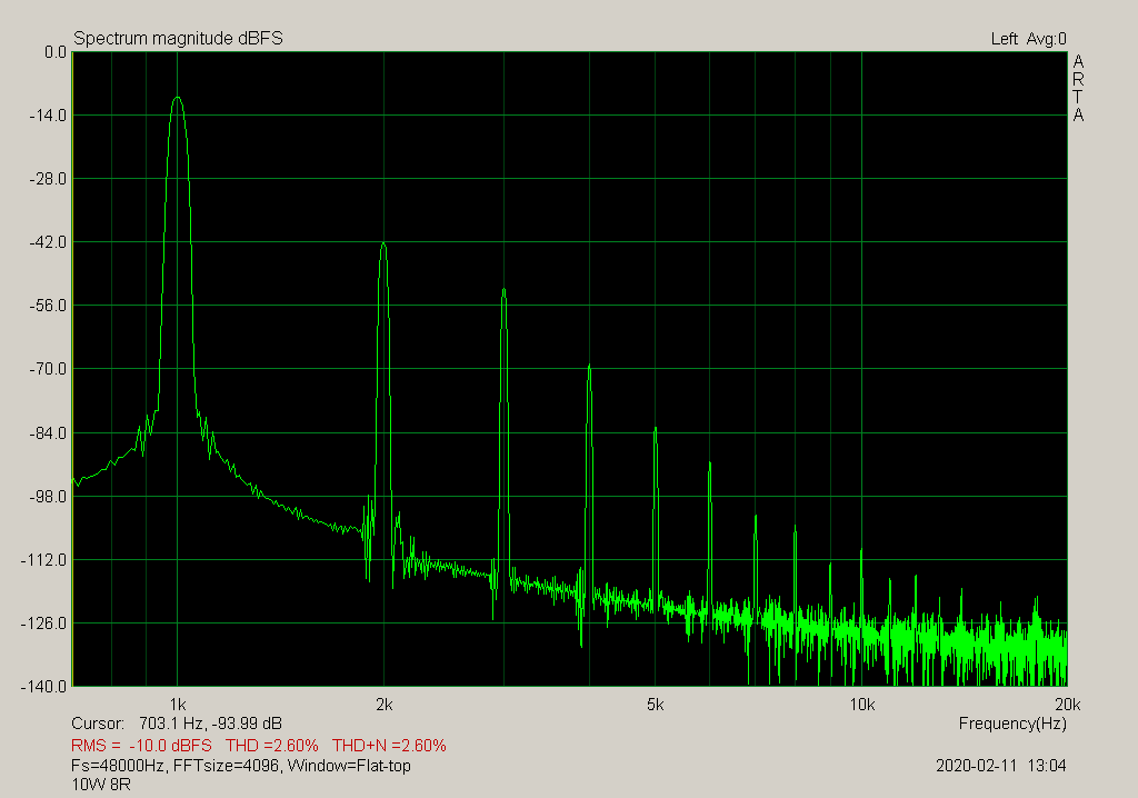

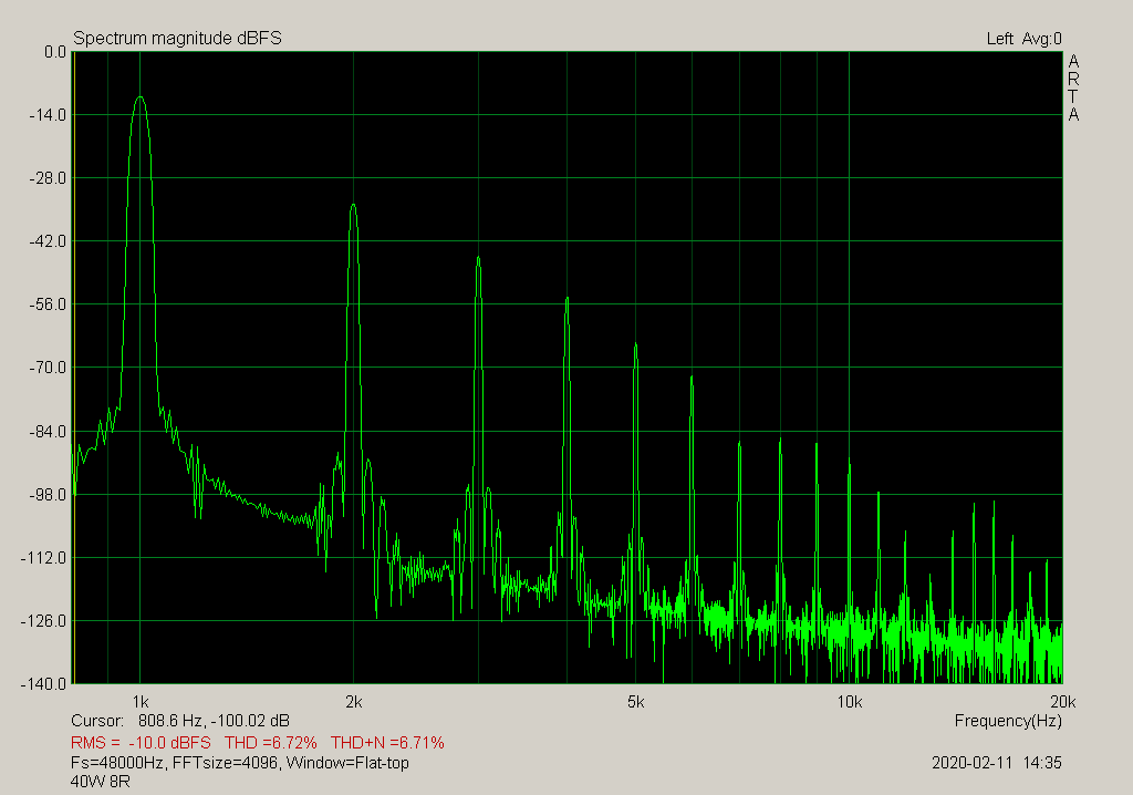

Joined 2003

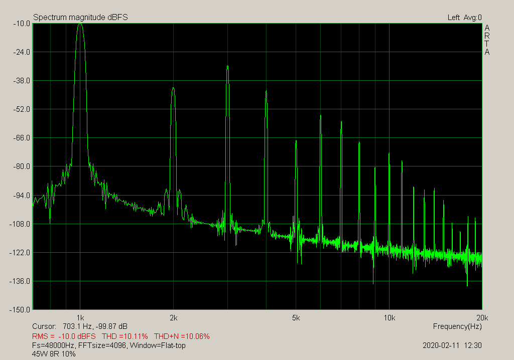

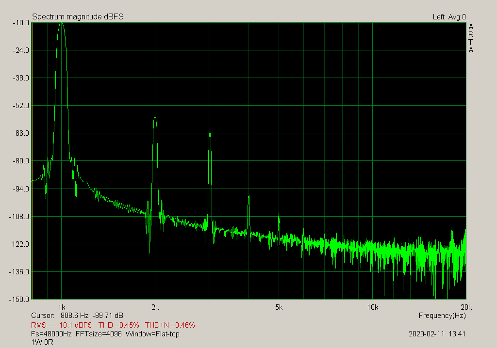

THF51S , Ser. 1X0117, 8R load
same conditions
furthest Ugs value , Ugs -4V41

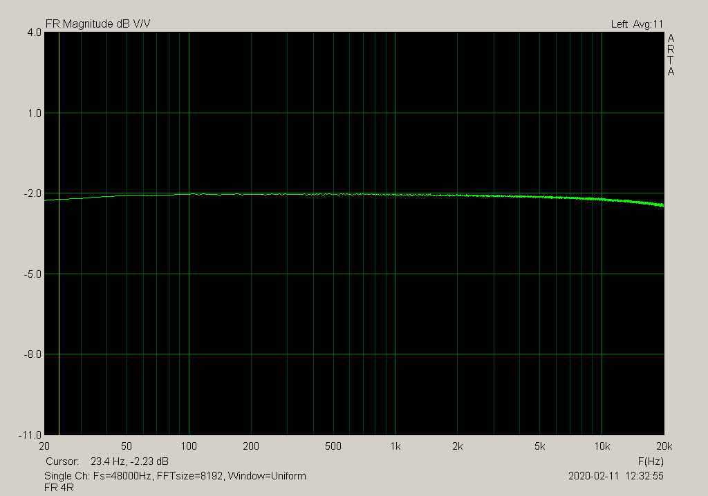

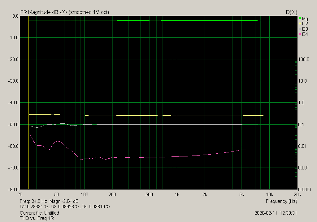

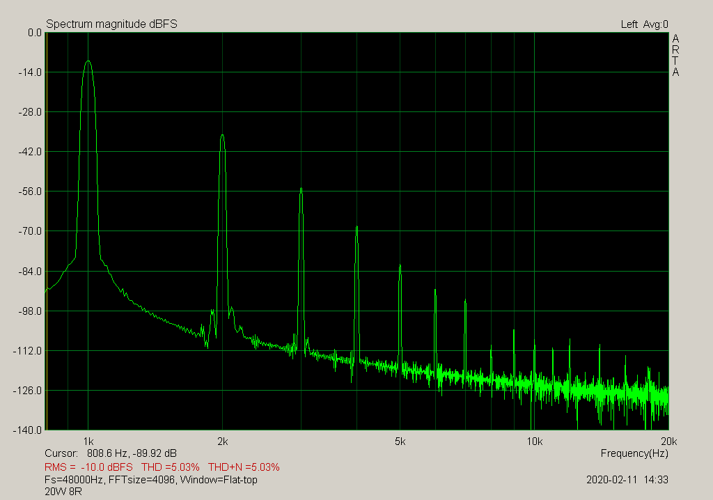

Joined 2003

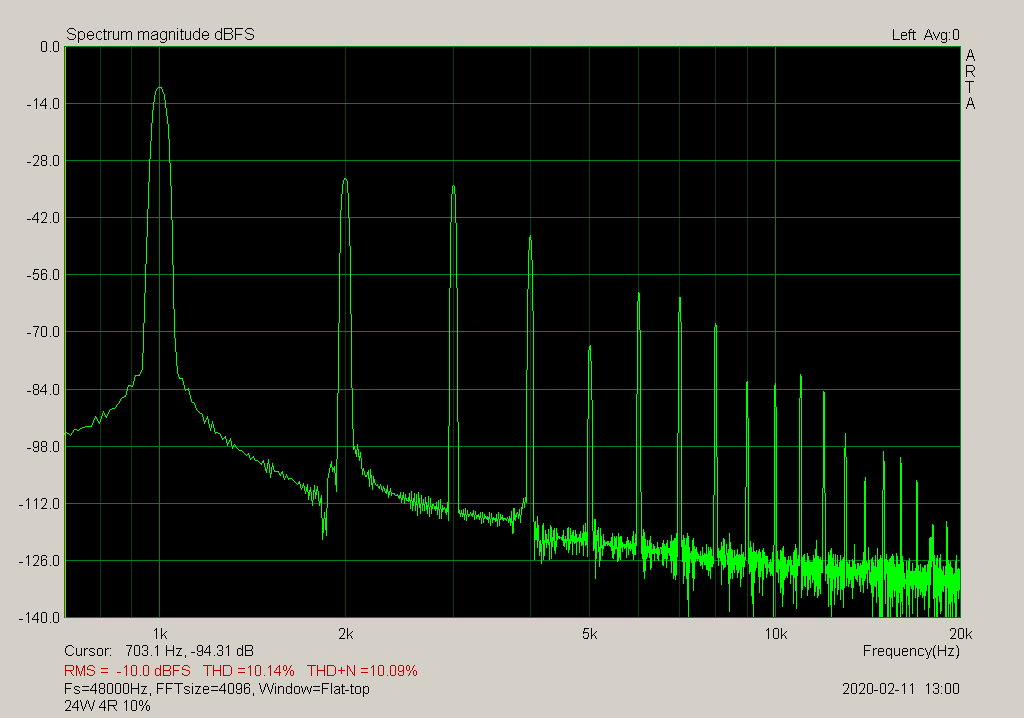

THF51S , Ser. 1X0117, 4R load
same conditions
again , furthest Ugs value , Ugs -4V41

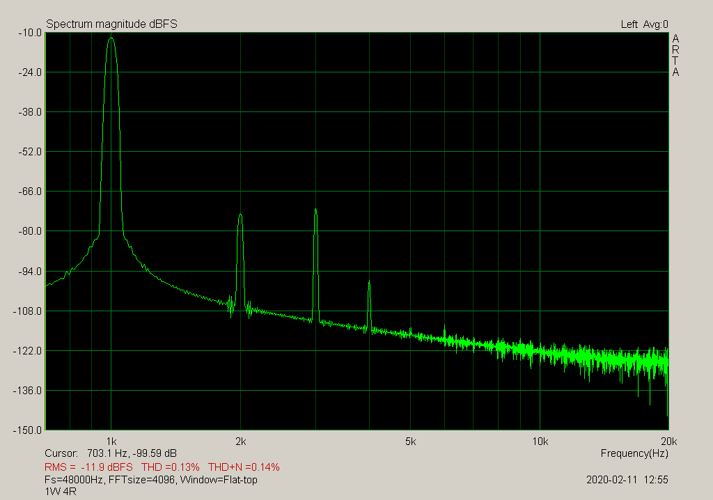

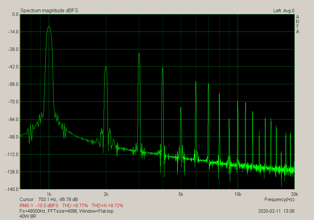

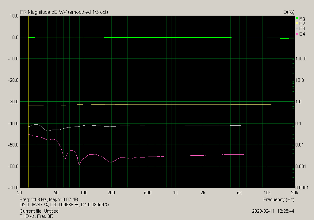

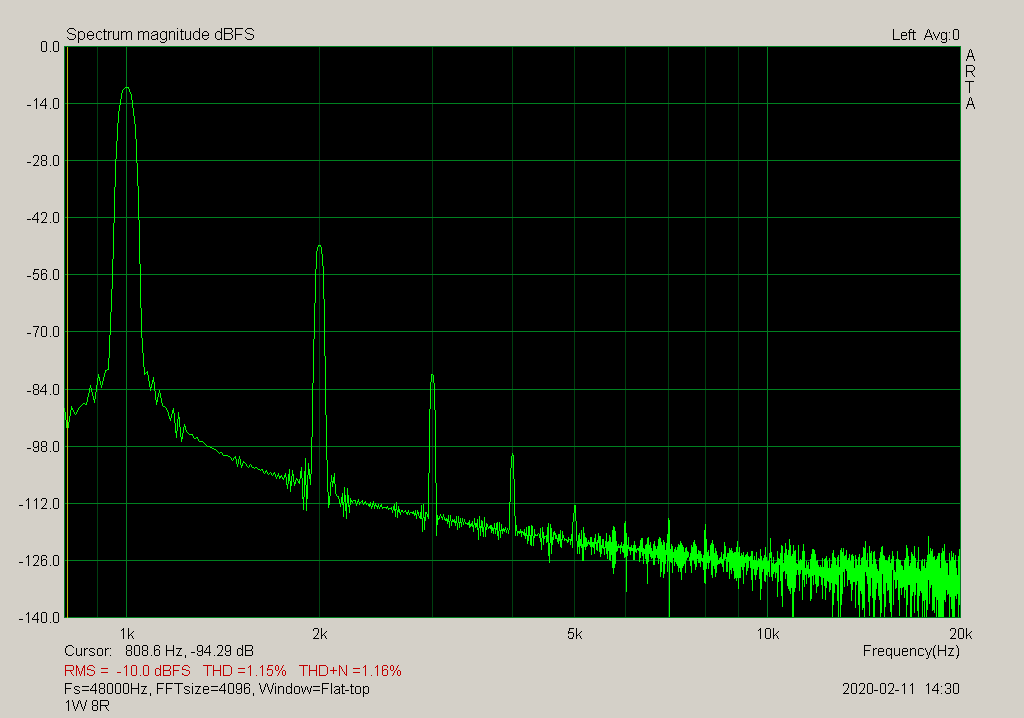

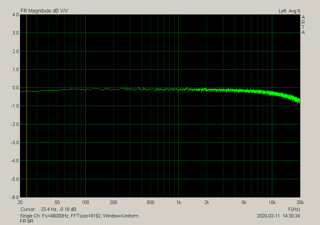

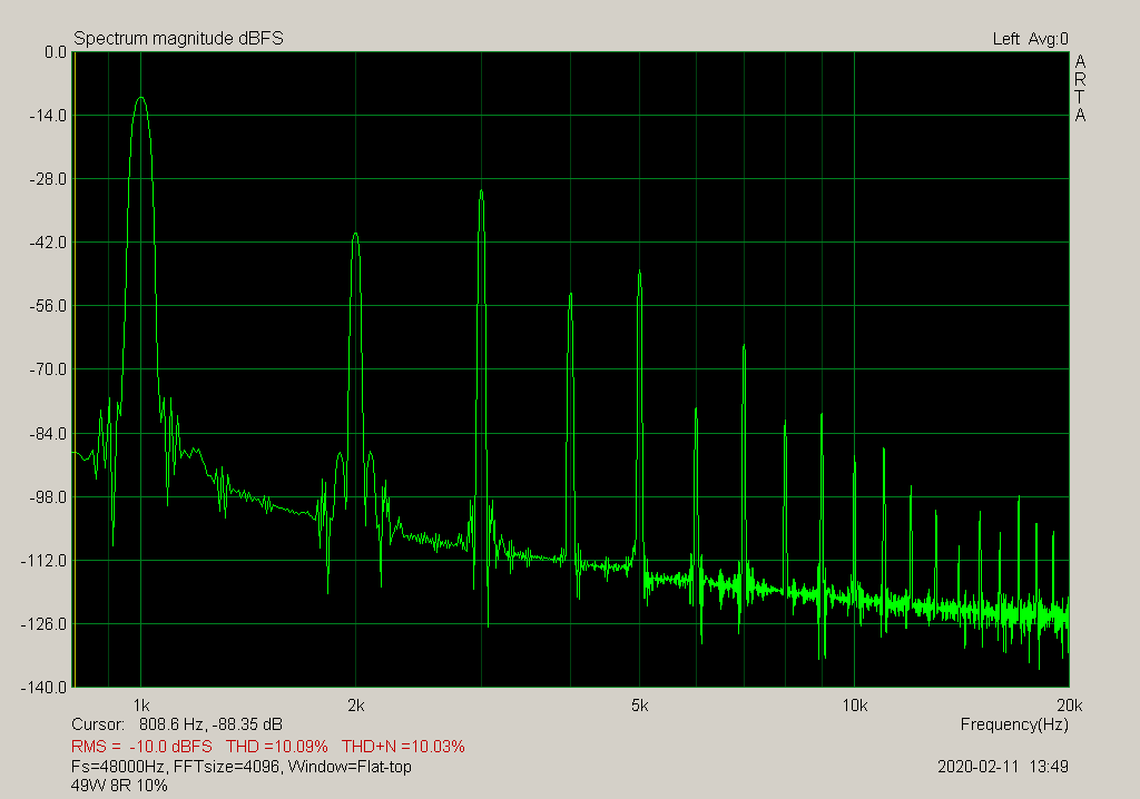

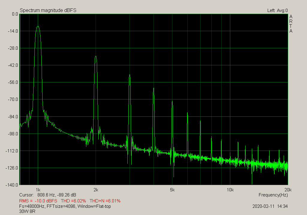

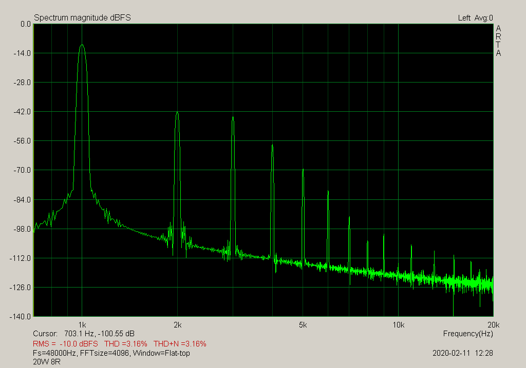

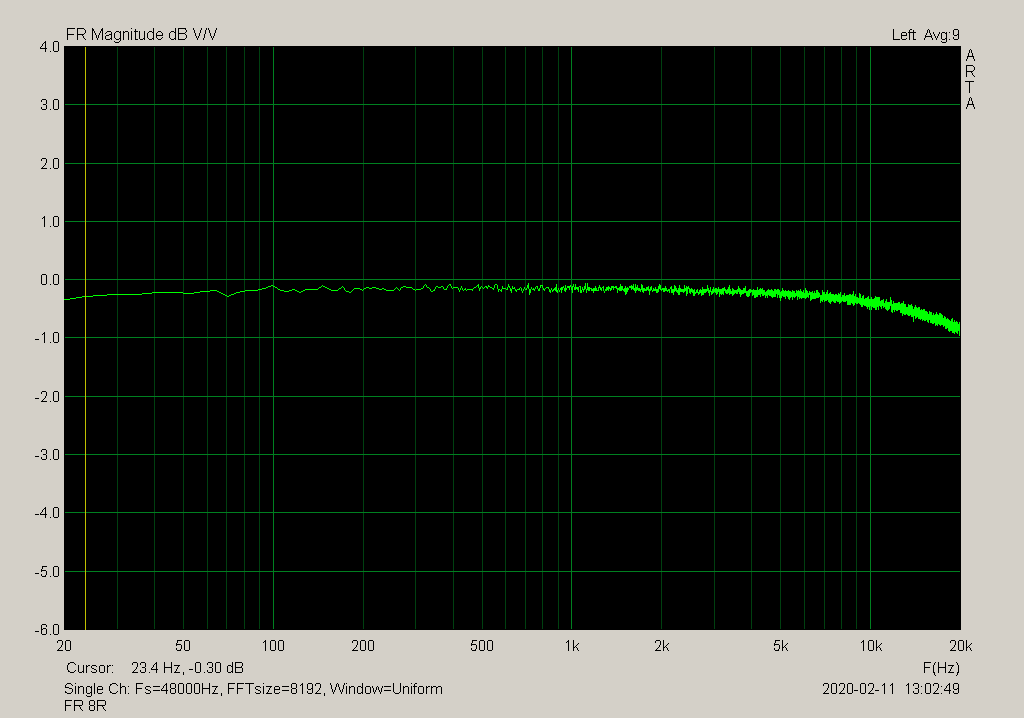

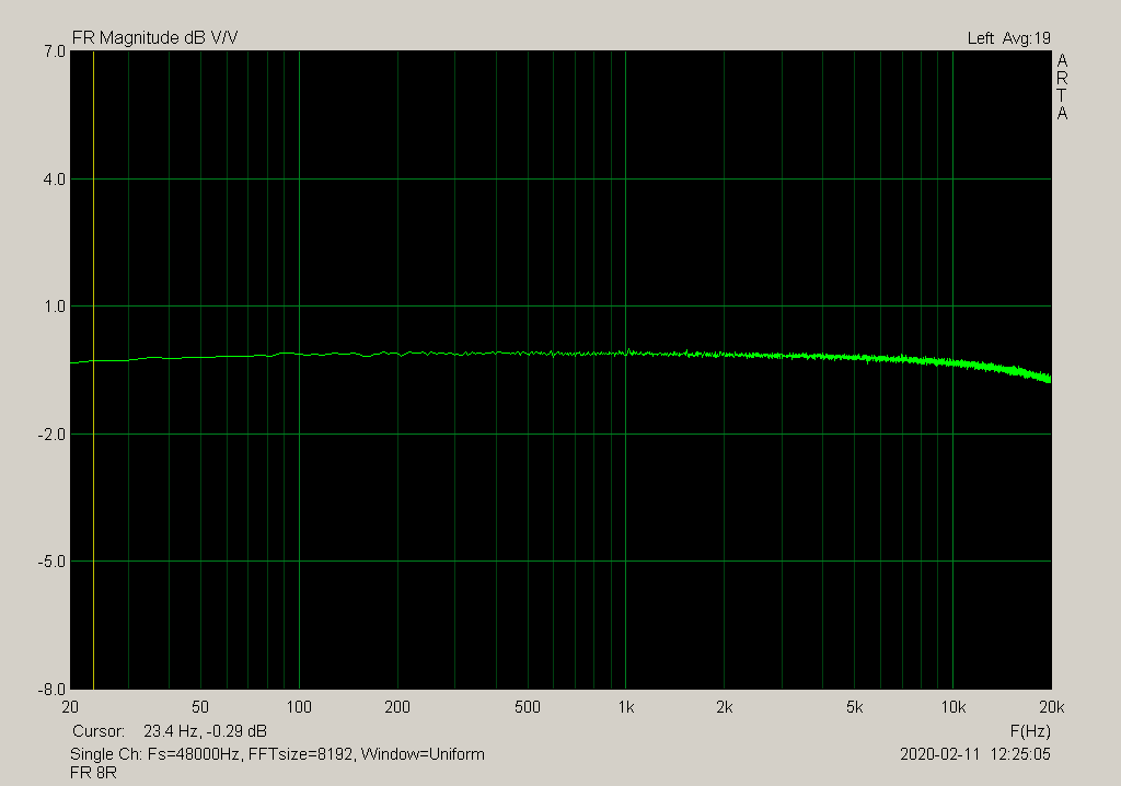

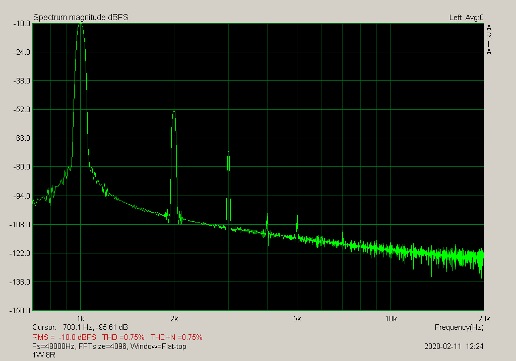

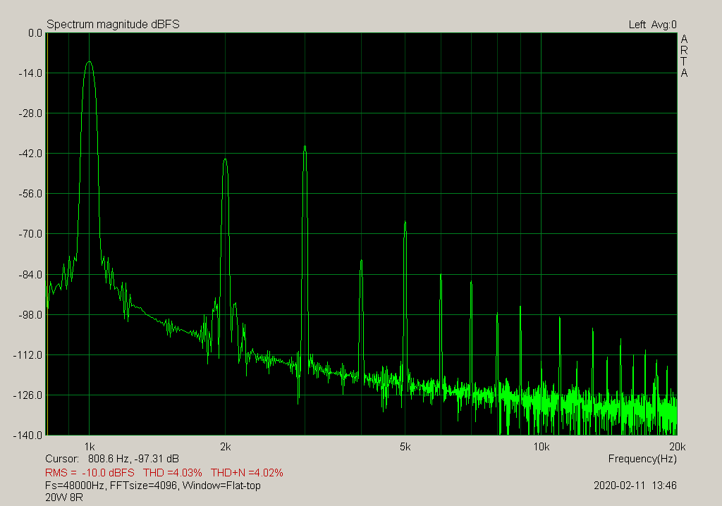

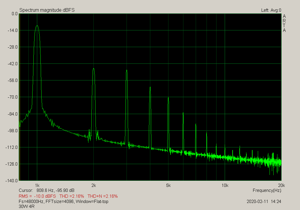

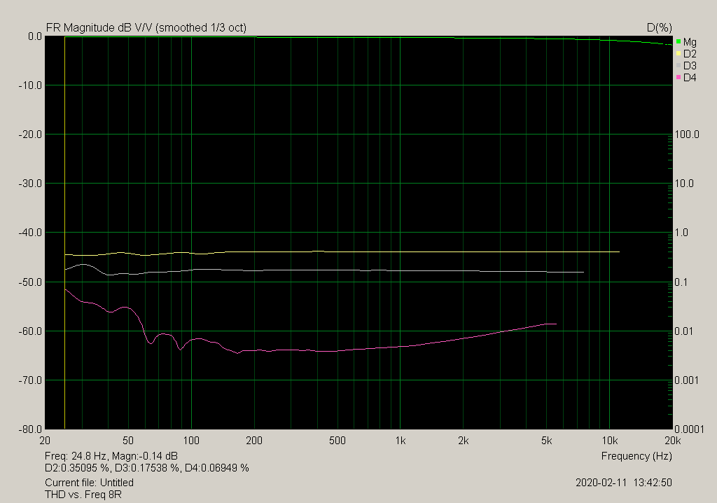

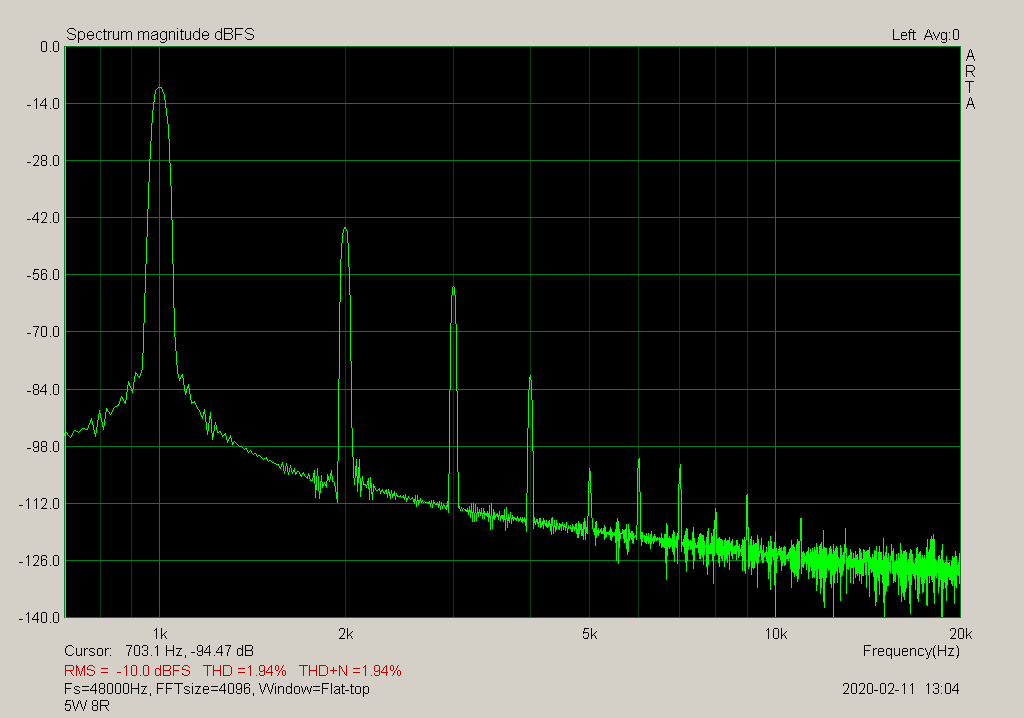

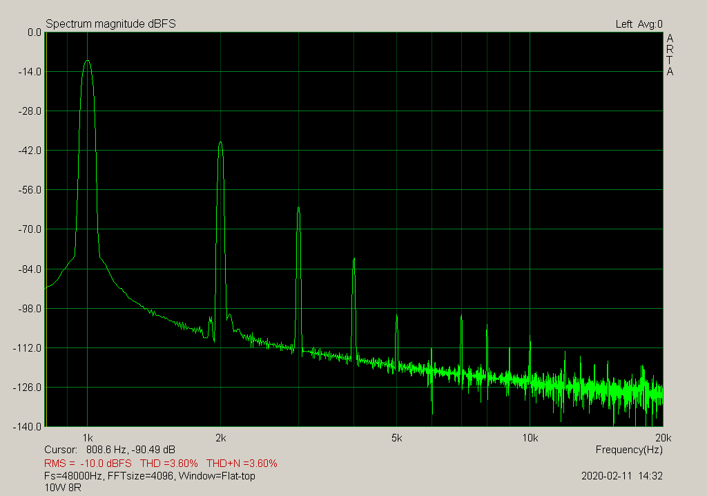

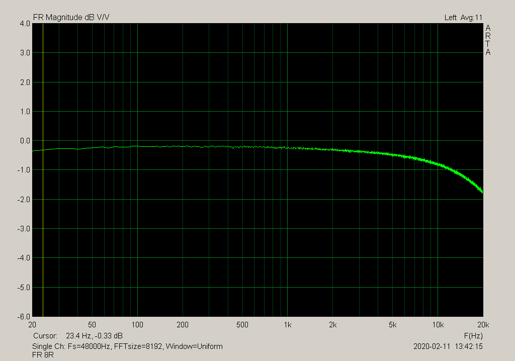

Joined 2003

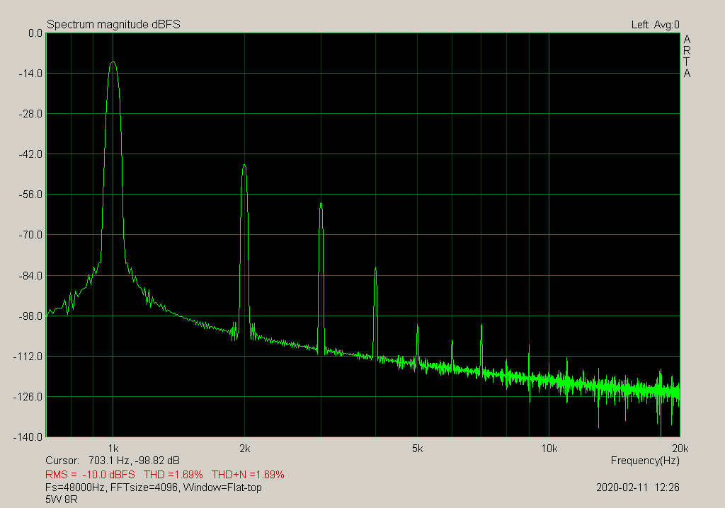

2SK182ES, Ser. 1Y1362 , 8R load
Rail 65Vdc
Iq 2A3
output node 35Vdc
Mu resistor string 6 x 0R1
output taken 02R from top
this one , Ugs -2V02

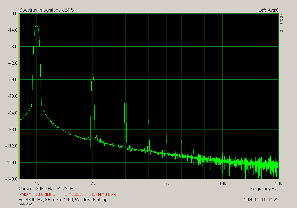

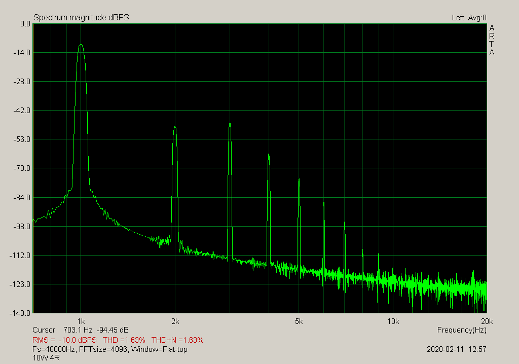

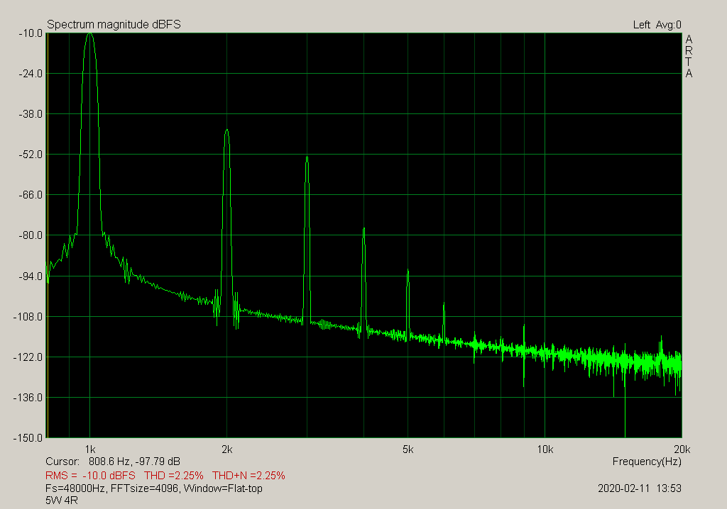

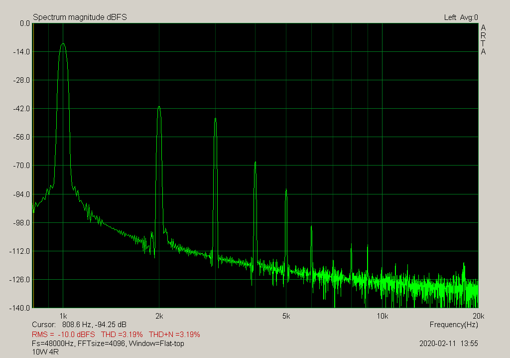

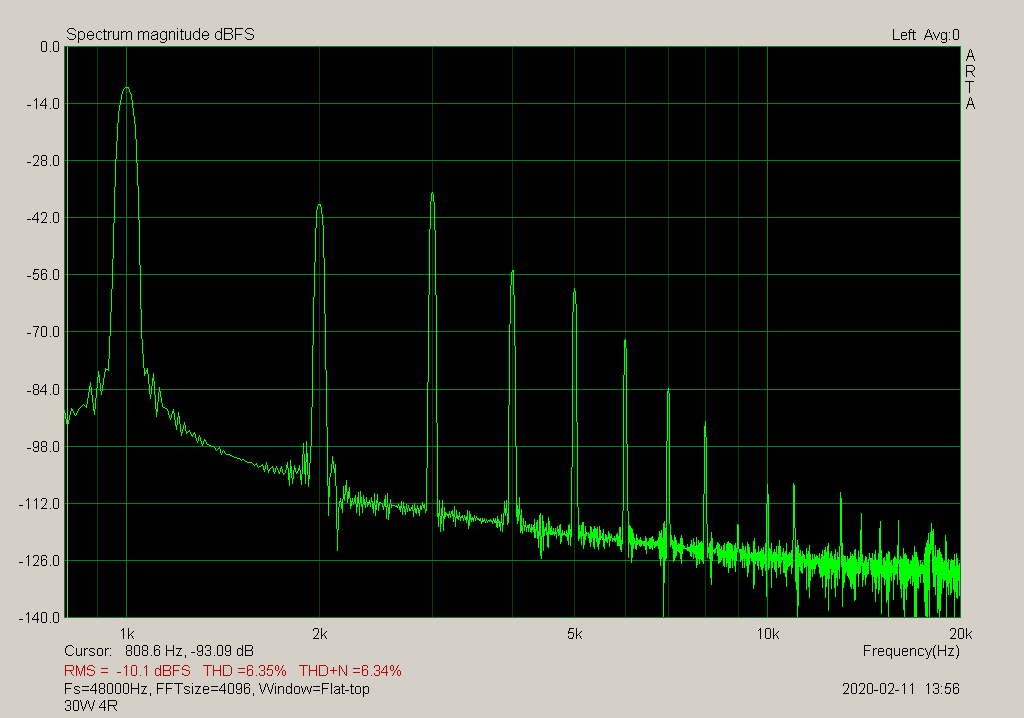

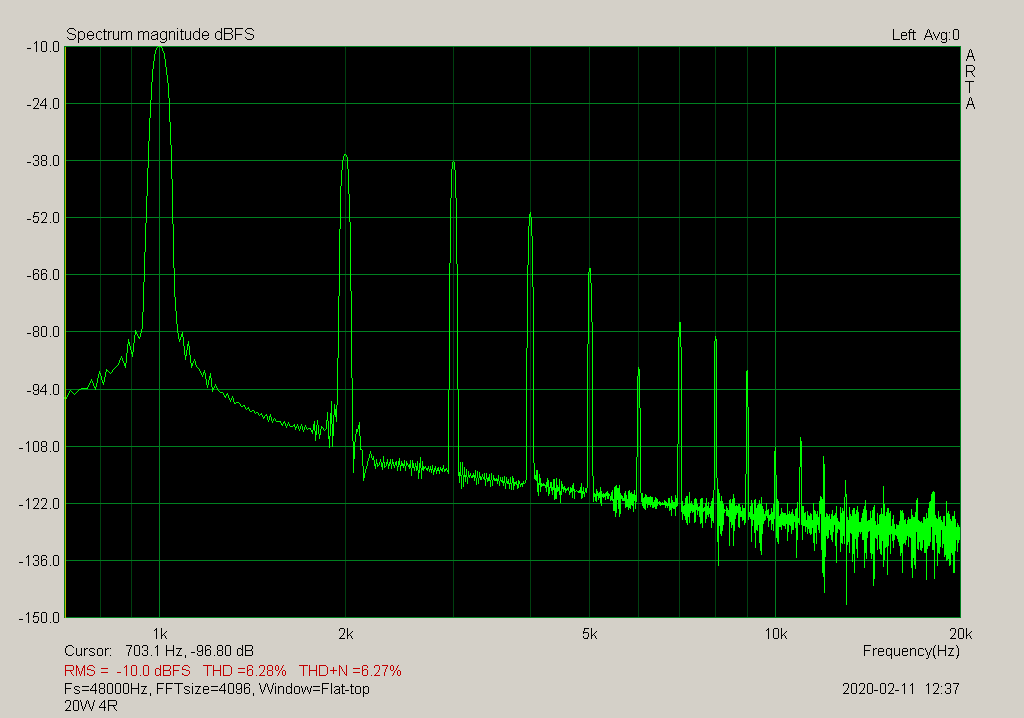

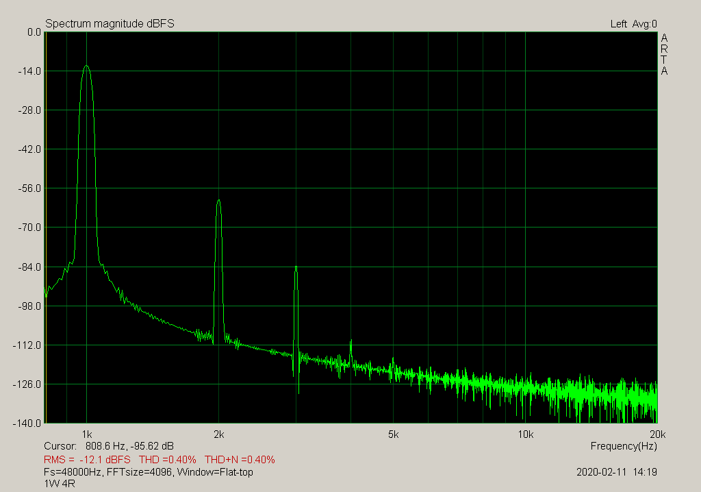

Joined 2003

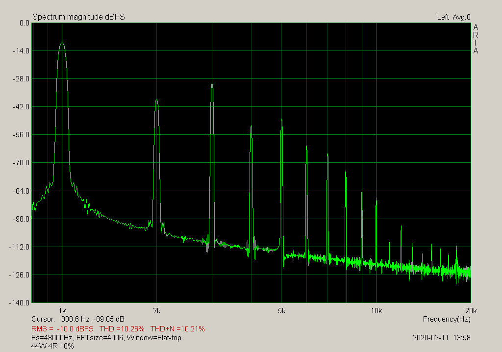

2SK182ES, Ser. 1Y1362 , 4R load
same conditions
again, this one , Ugs -2V02

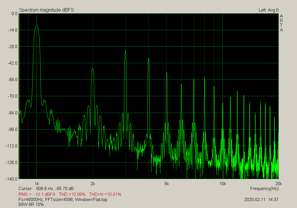

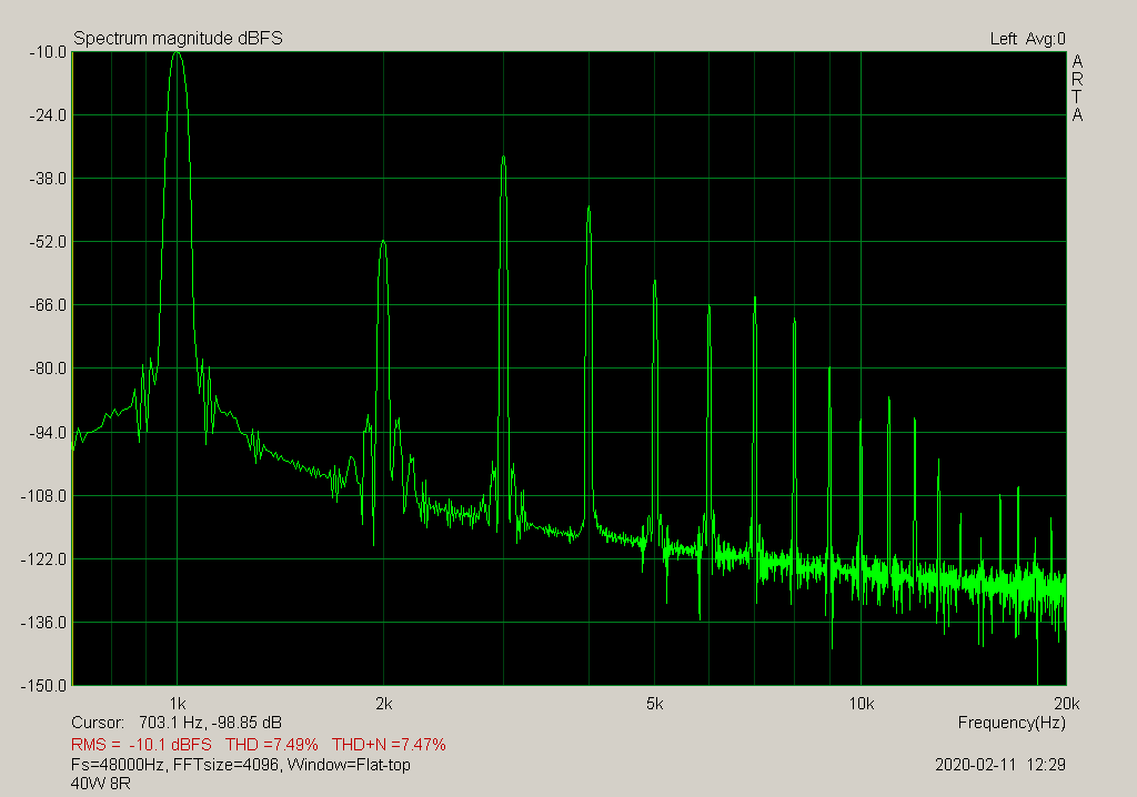

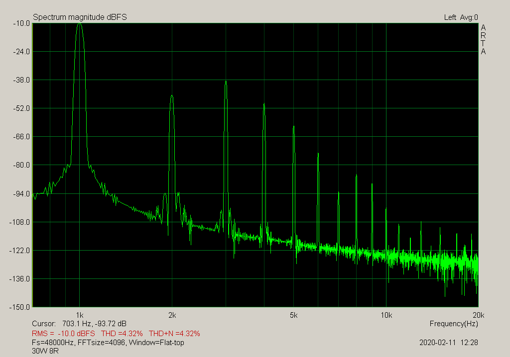

Joined 2003
2SK182ES, Ser. 1Y1363 , 8R load
same conditions
this one, all the way to other side , Ugs -4V97
Joined 2003
2SK182ES, Ser. 1Y1363 , 4R load
same conditions
again,this one, all the way to other side , Ugs -4V97
Joined 2003
Conclusions ........
I'm going to make a little pause here ... to let things settle in my head and to re-check graphs little more
in case that's easier for you to grasp things , find complete measurements in one rar file here : Dropbox - Singing Bush measurements.rar - Simplify your life
I know that I didn't took gain measurements in latest tests , was lazy , but that data is of secondary importance here
anyway , first and most important conclusion is - if you have any of those SITs , and you have way of measuring THD spectra ( if I can , everybody can) , The World is your Oyster - no reason that you can't build it and squeeze last ounce of performance , whatever value of Ugs your SITs have .....

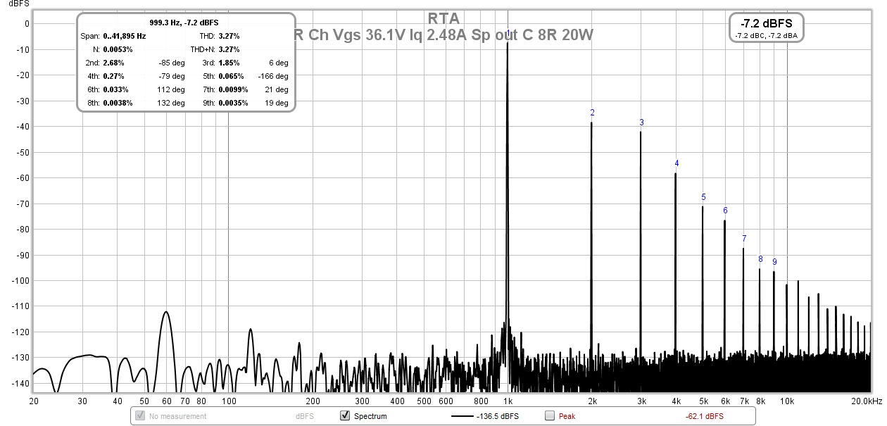

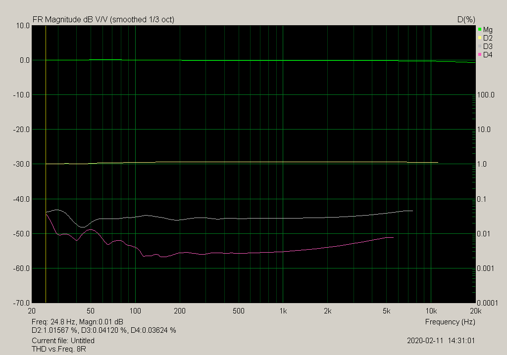

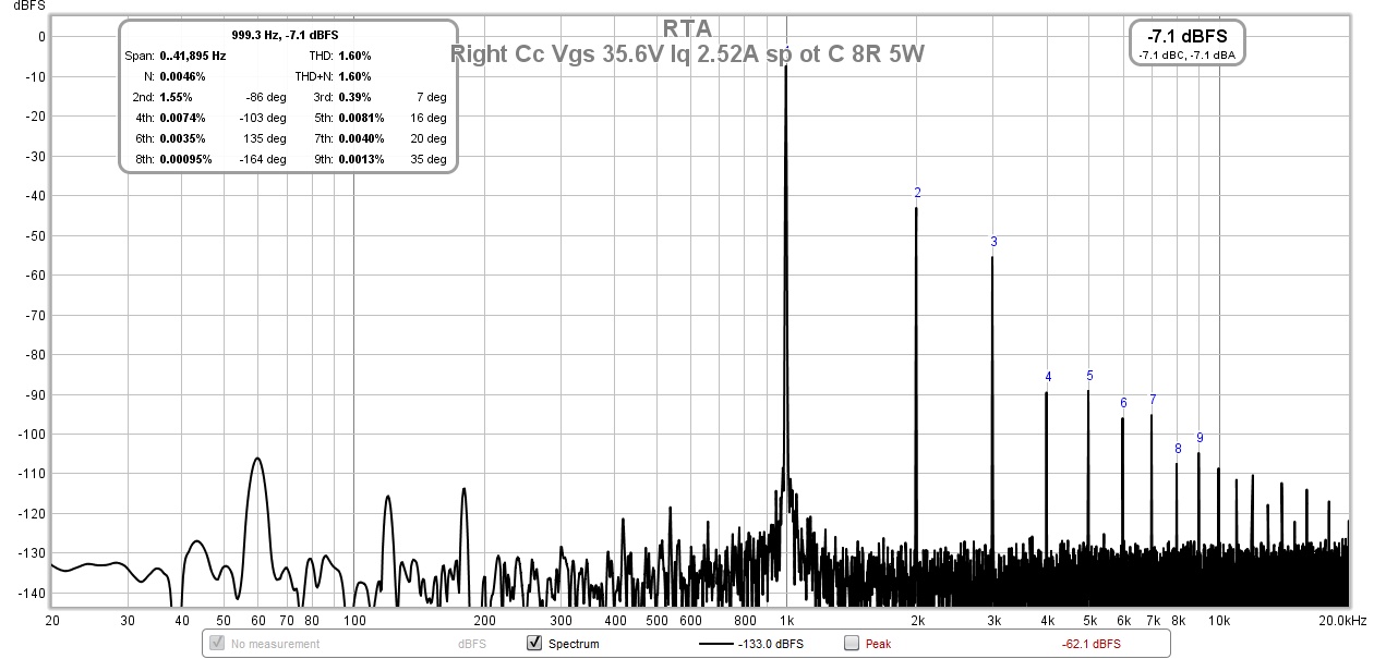

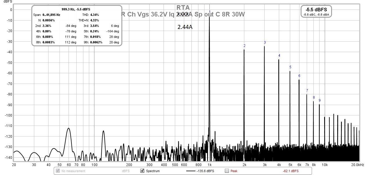

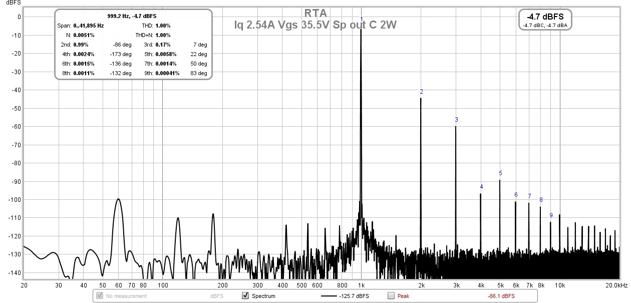

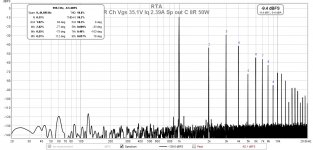

Joined 2012

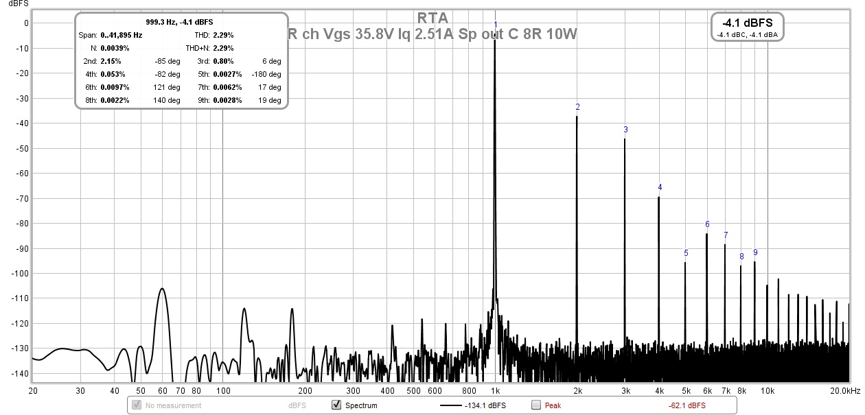

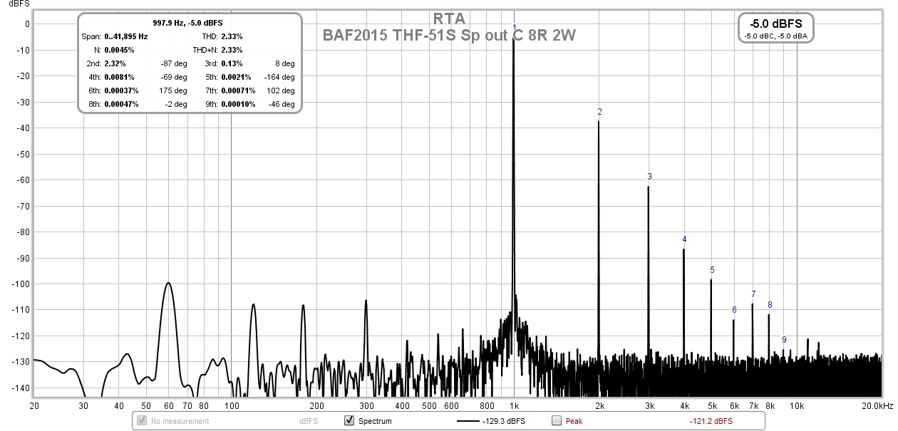

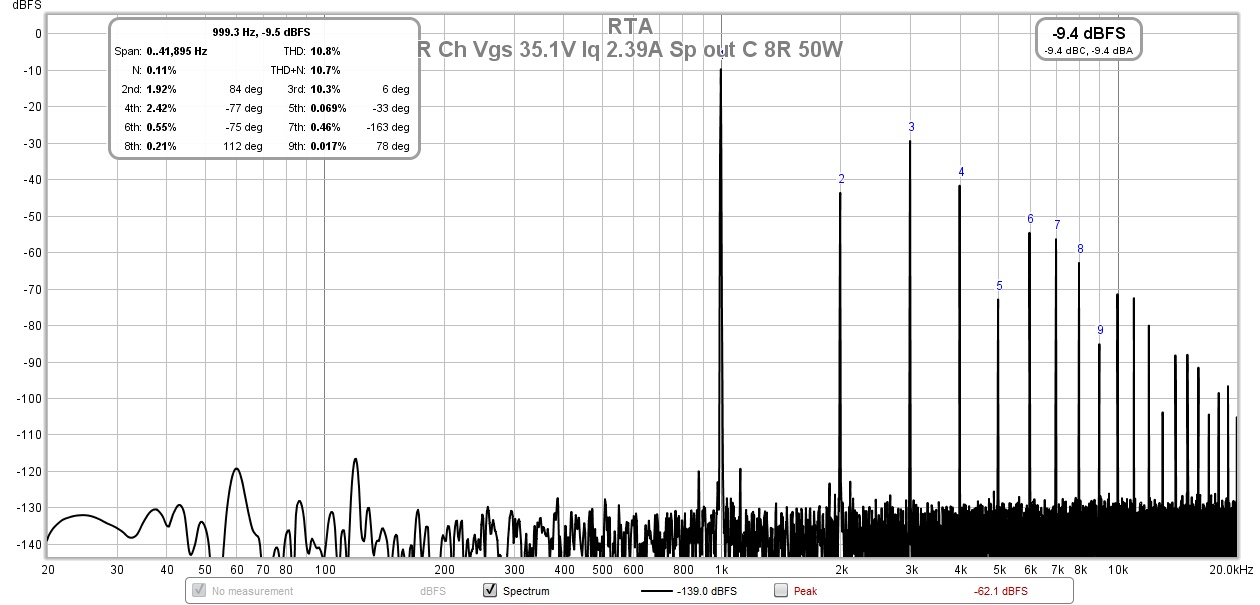

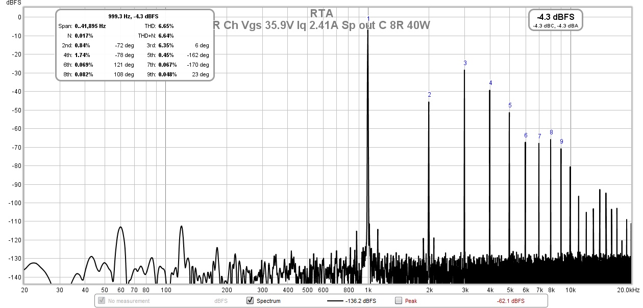

I have modified my THF-51S right channel, which has the higher distortion. I added one 0R1 resistor in the string between the IXFN and THF and took the output at 0R2 above the THF ( total 5 x 0R1 ).
8R load at output
V+=63.2V (at 2W, did not check at other output levels), original was 62.5V
Iq=2.54A at 2W, dropping to 2.39A at 50W, original was 3.25A
THF Vds=35.5V, varying slightly at output levels, original was 29.0V
Measured distortion levels are similar to Zen Mod's measurements.
Below is measured distortion at 2W for original operating point, followed by revised operating point measurements at 2W, 5W, 10W, 20W, 30W, 40W, and 50W.
The original had 2.33% THD and the revised has 1.00% THD at 2W into 8R - quite a difference.
Now to revise the left channel and do some listening.
Edit: Typo in titles of measurements - should be Vds, not Vgs
