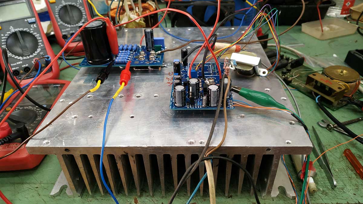

The Singing Bush Schade ......
Ok , that's it
Early morning coffee , then up to Workshop , another coffee in da coffee-maker
lazy finishing assembly of Schade pcb on heatsink , some wiring re-work ad that's it

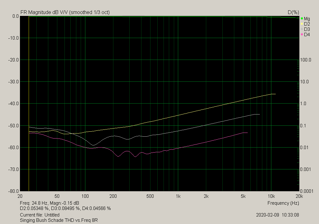

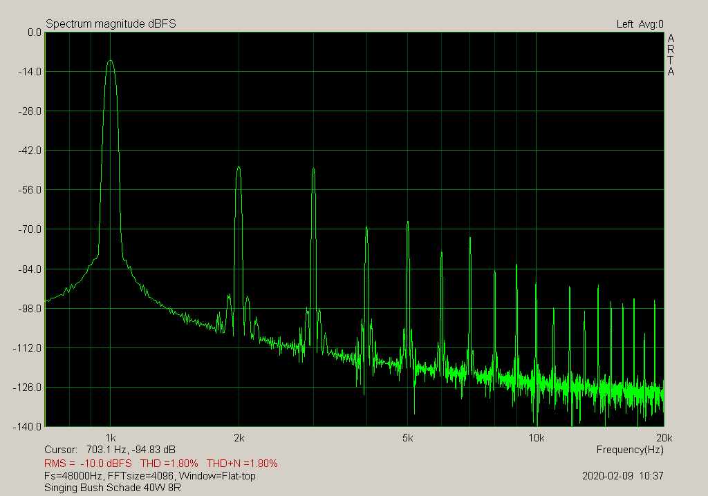

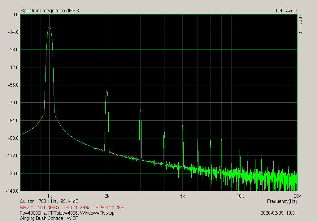

funny behavior - RC constants are sooo big , it biases after few minutes ; output node voltage rises fast to full rail , simply because both mosfets aren't conducting ..... then it goes down softly and slow
besides - output node voltage stabilizes really at temp. equilibrium , and then everything is rock stable
Ok , that's it

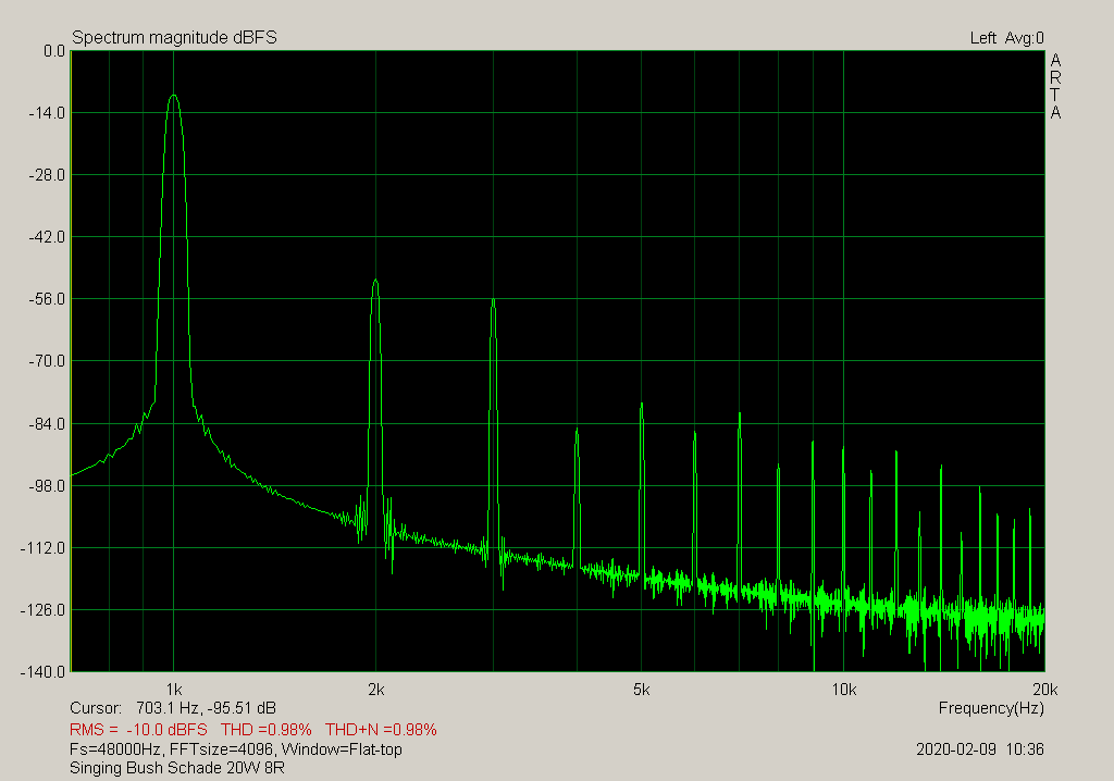

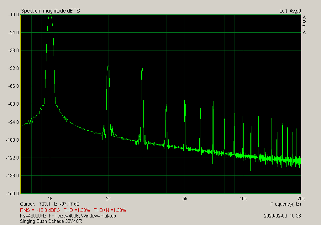

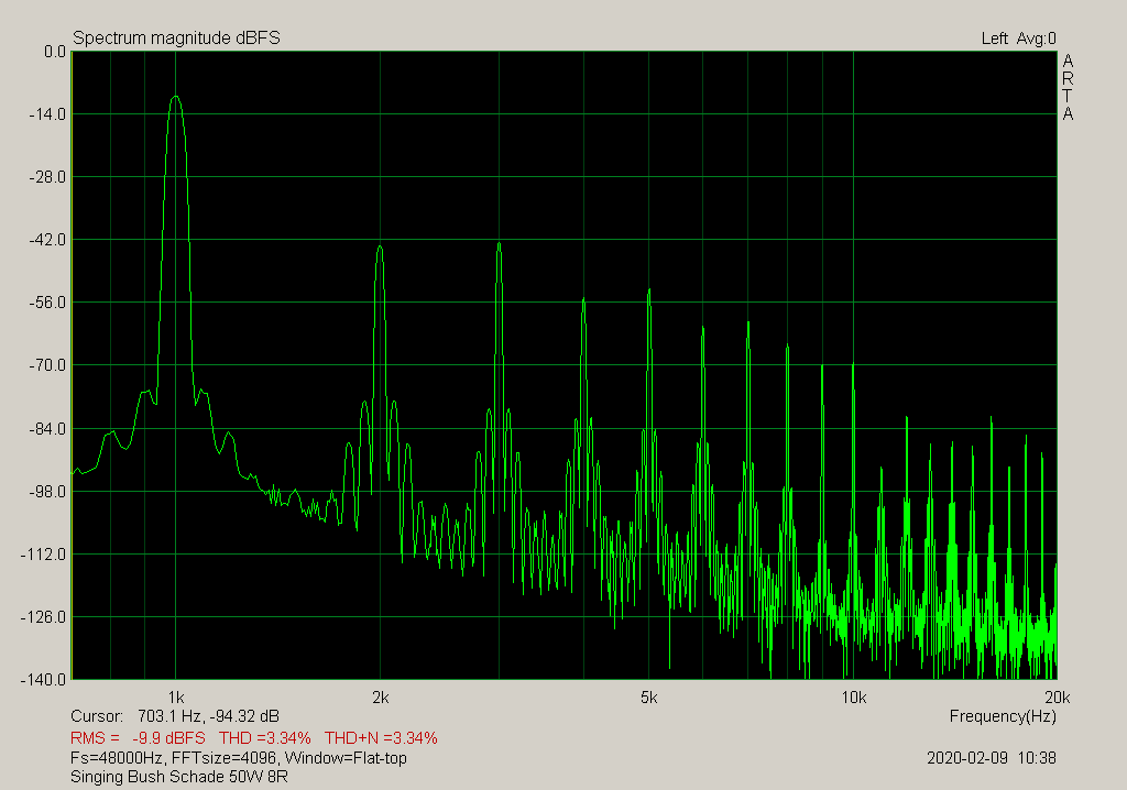

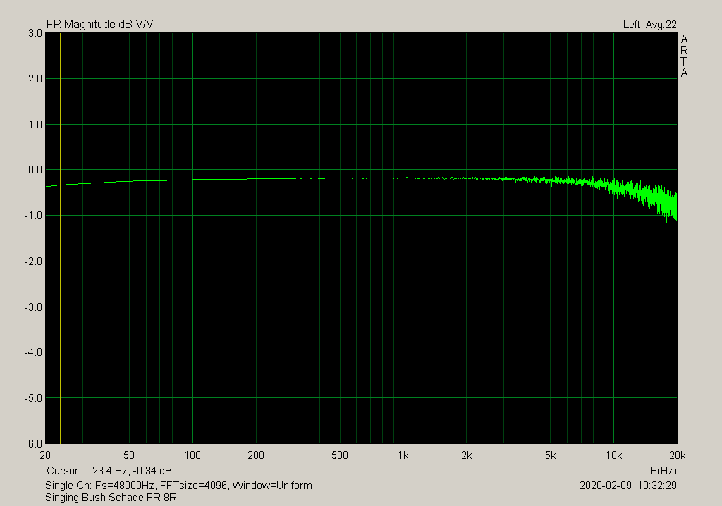

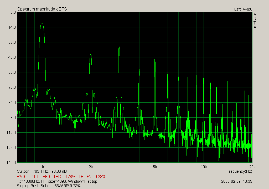

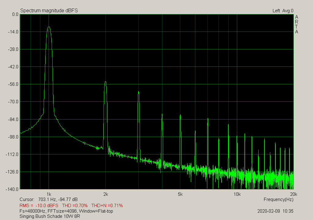

The Singing Bush Schade, 8R Load
Rail 60Vdc
Output node at 28Vdc
Iq 3A2
gain for 5Vrms out
8R load, 514mVrms in ; A=9.72V/V = 19.76db
Rail 60Vdc
Iq 3A2
gain for 5Vrms out

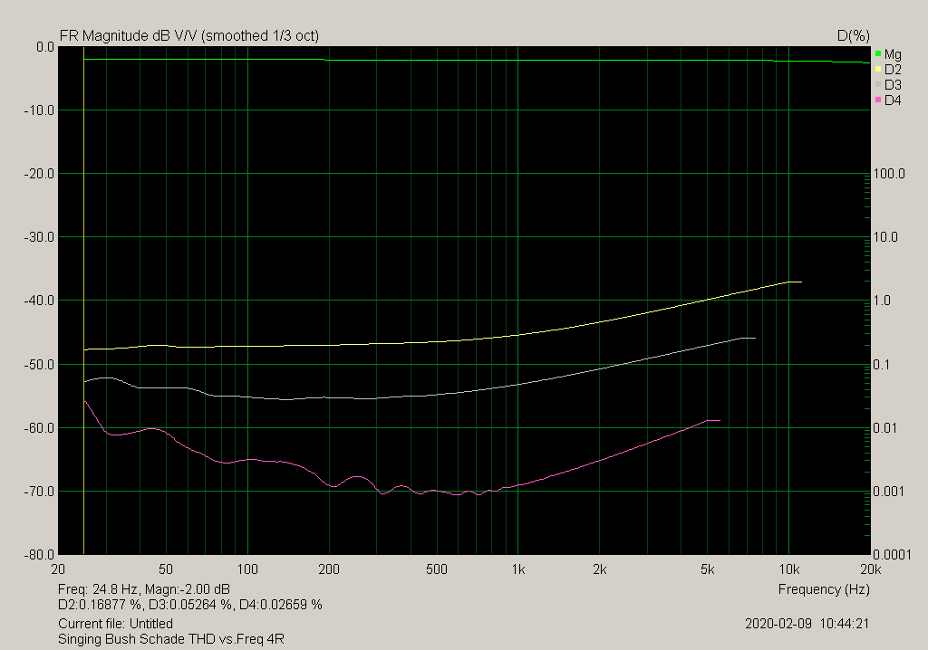

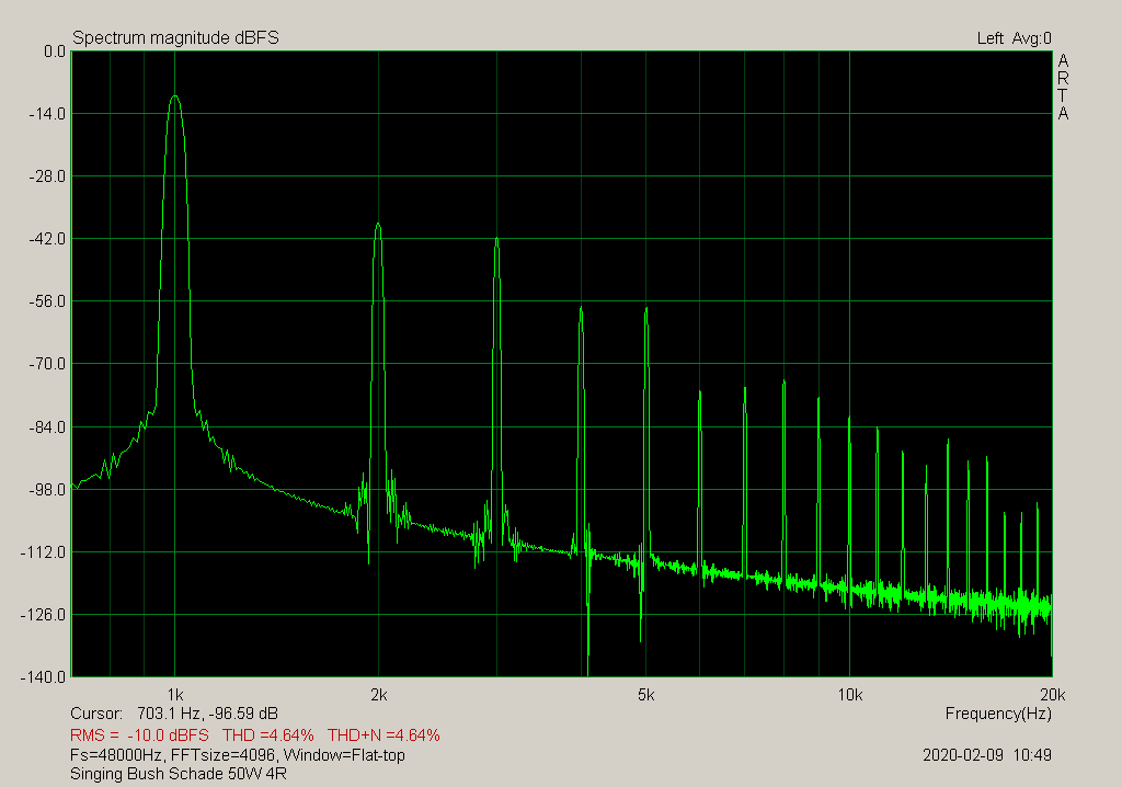

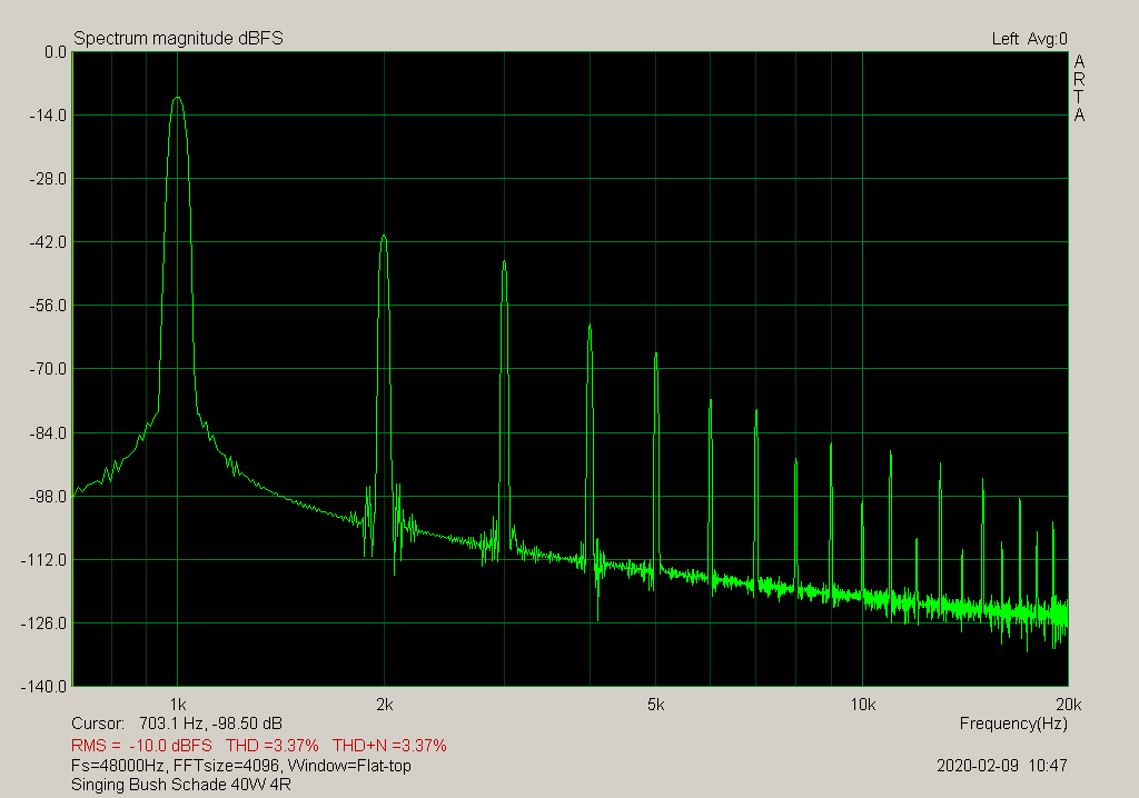

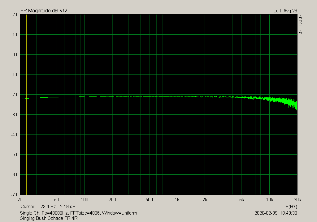

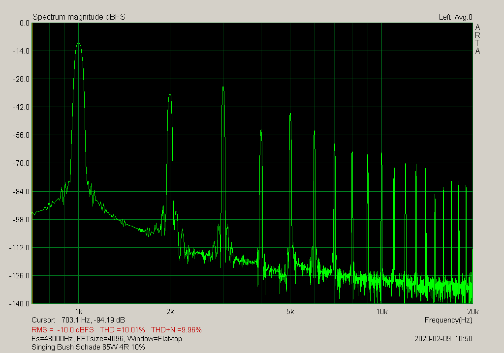

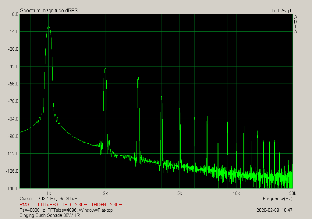

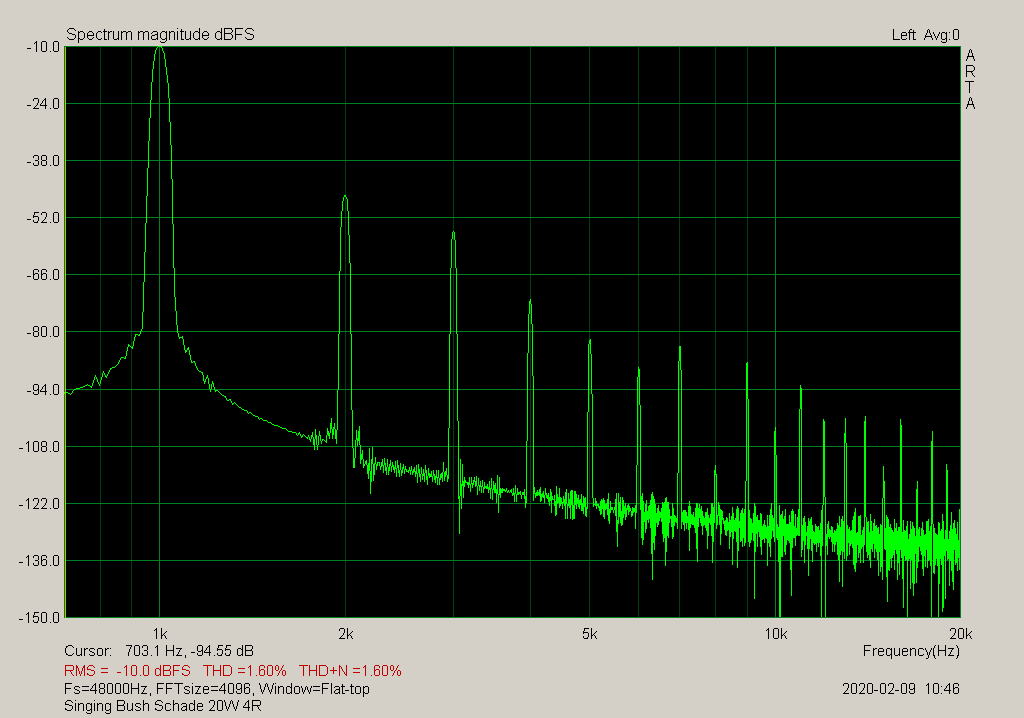

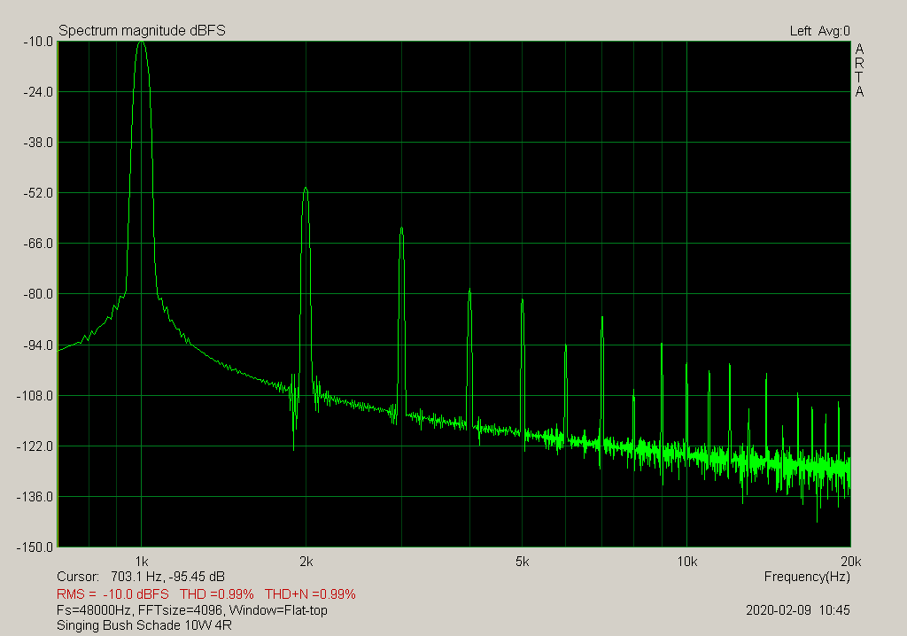

The Singing Bush Schade, 4R Load
Rail 60Vdc
Iq 3A2
gain for 5Vrms out
4R load, 554mVrms in ; A=9.19V/V = 19.26db
Rail 60Vdc
Iq 3A2
gain for 5Vrms out
