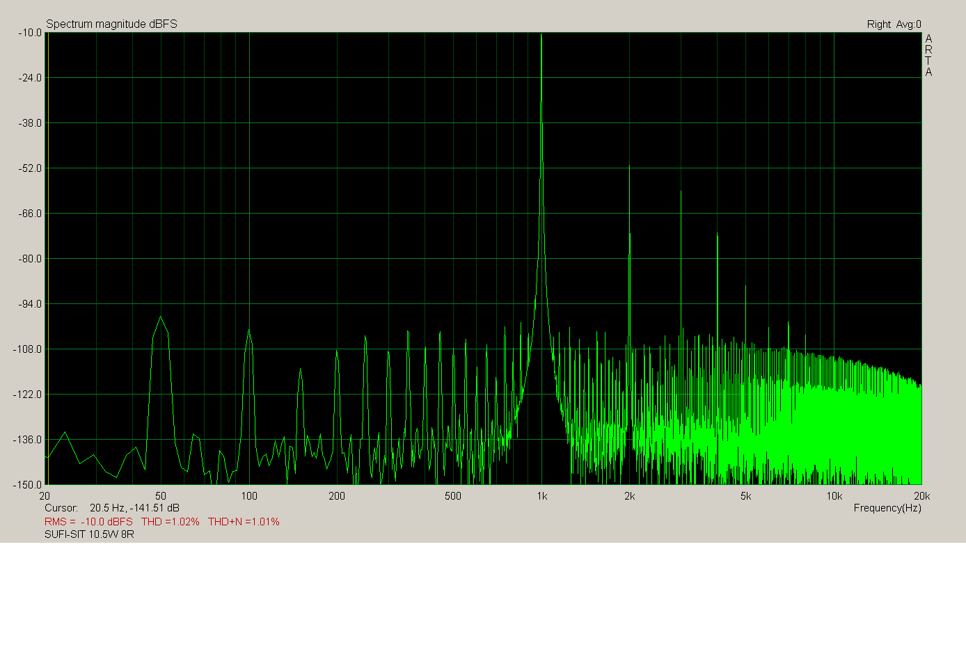

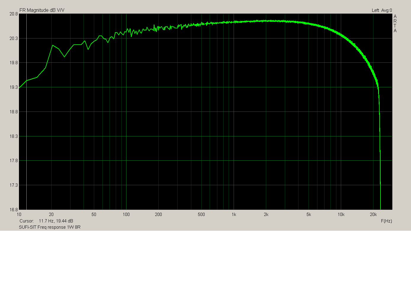

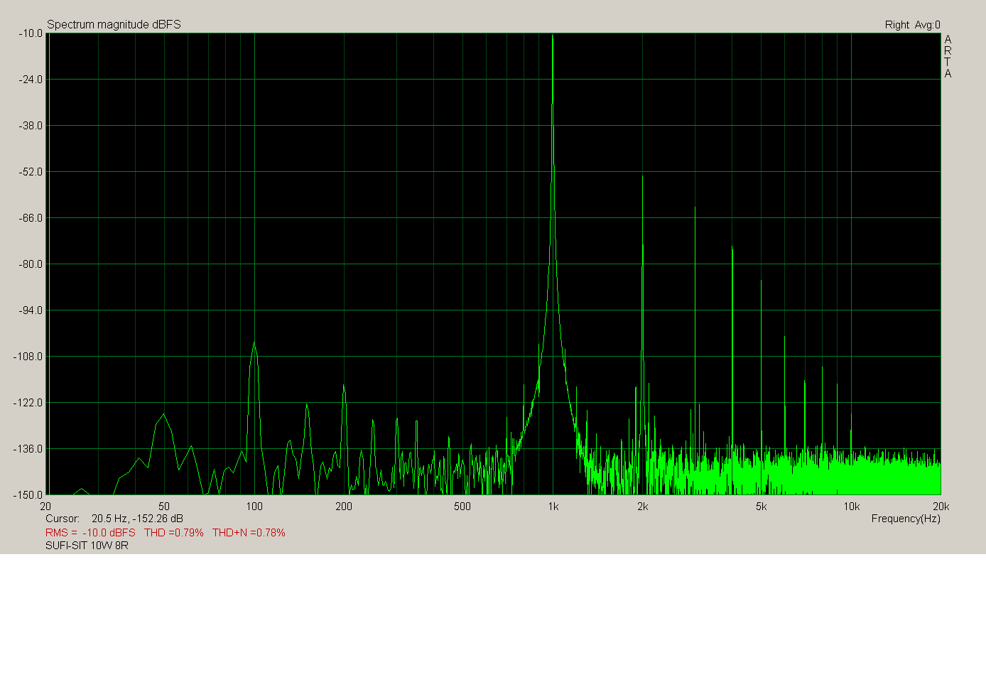

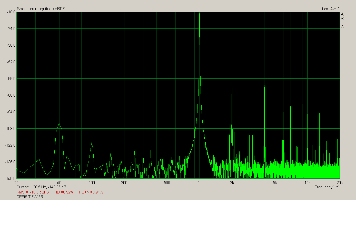

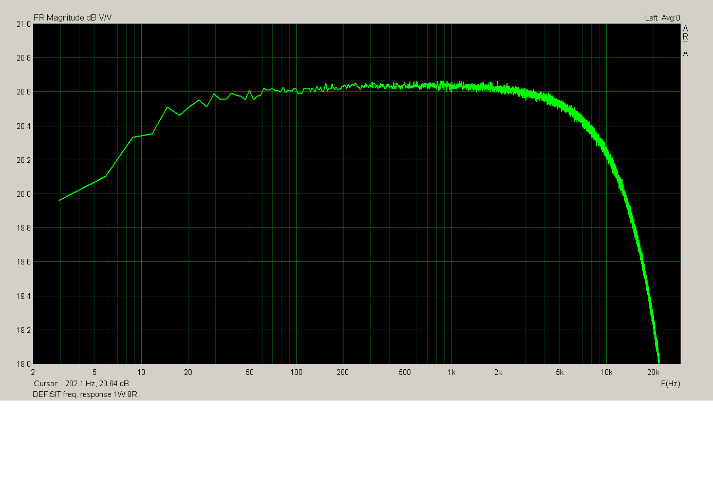

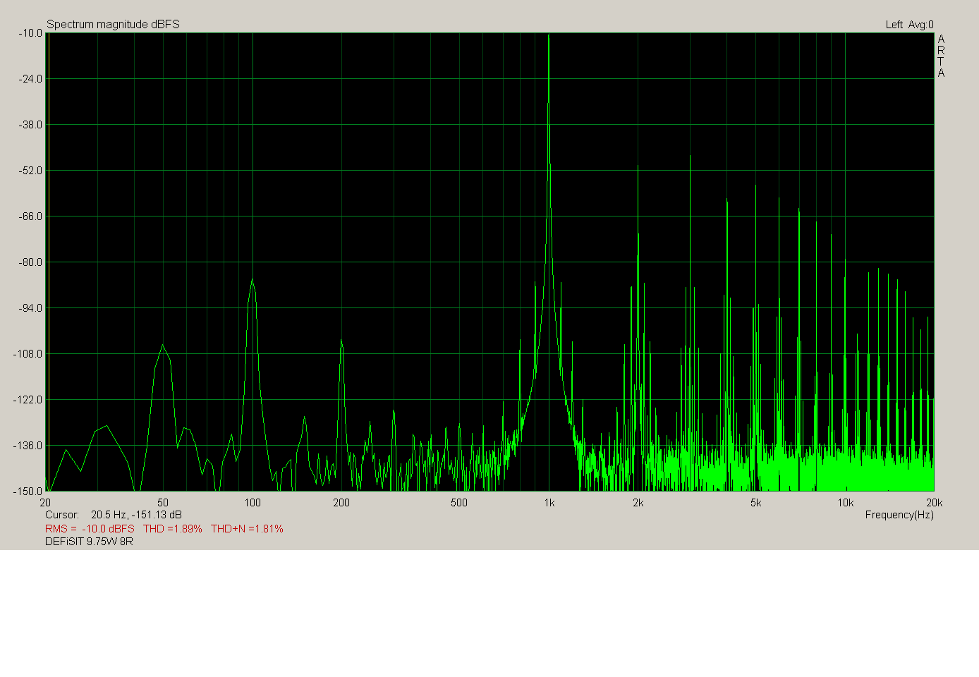

.......... ZM ; but there is nothing new with that ...... - I forgot to take gain measurements , both for 2SK182ES set and for The Larch! Singing Bush
anyway , who cares for exact values, input Volts are cheap .......
