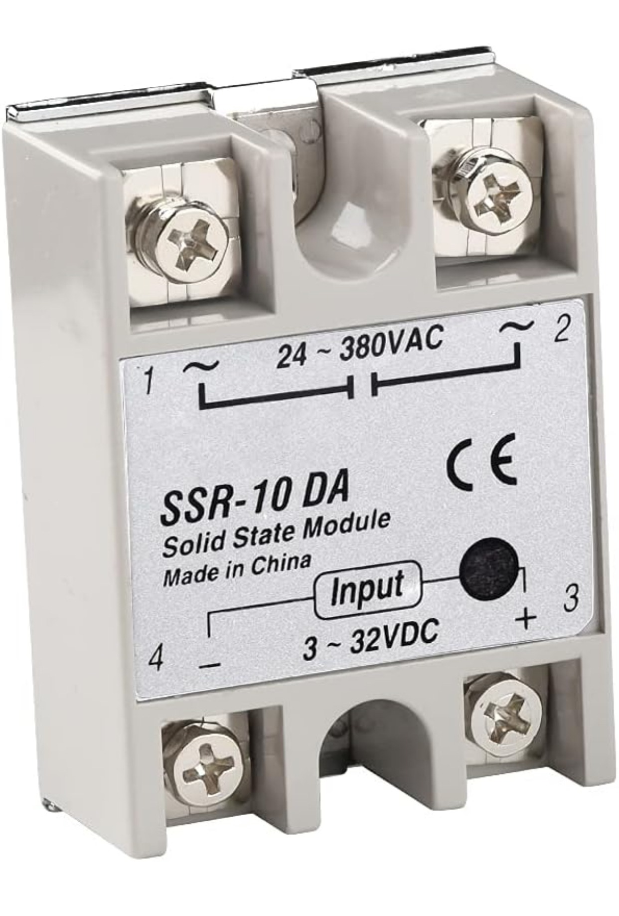

Why do i need the diode and resistor? Would it not work okey just by feeding the trigger side of the SS relay with voltage from C5 after the regulator IC1?
Something like This one seems good enough?
https://amzn.eu/d/6jLqQAa

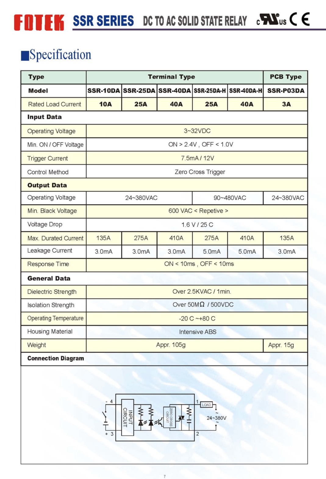

OK, in that case trigger side is already equipped to be fed from wide range of voltages
I was having on mind those without same feature
Okey, sounds good.
Found these with even better price if i order a pair. I need a pair. And these are 25A instead of 10A.
https://amzn.eu/d/4tVDxpV
I used them many years back in time. A big advantage is that they turn-on when the mains crosses zero. So a more gently built-up of the current.
A disadvantage is that there is always a little bit voltage drop at mains side (compared to a good mechanical contact).

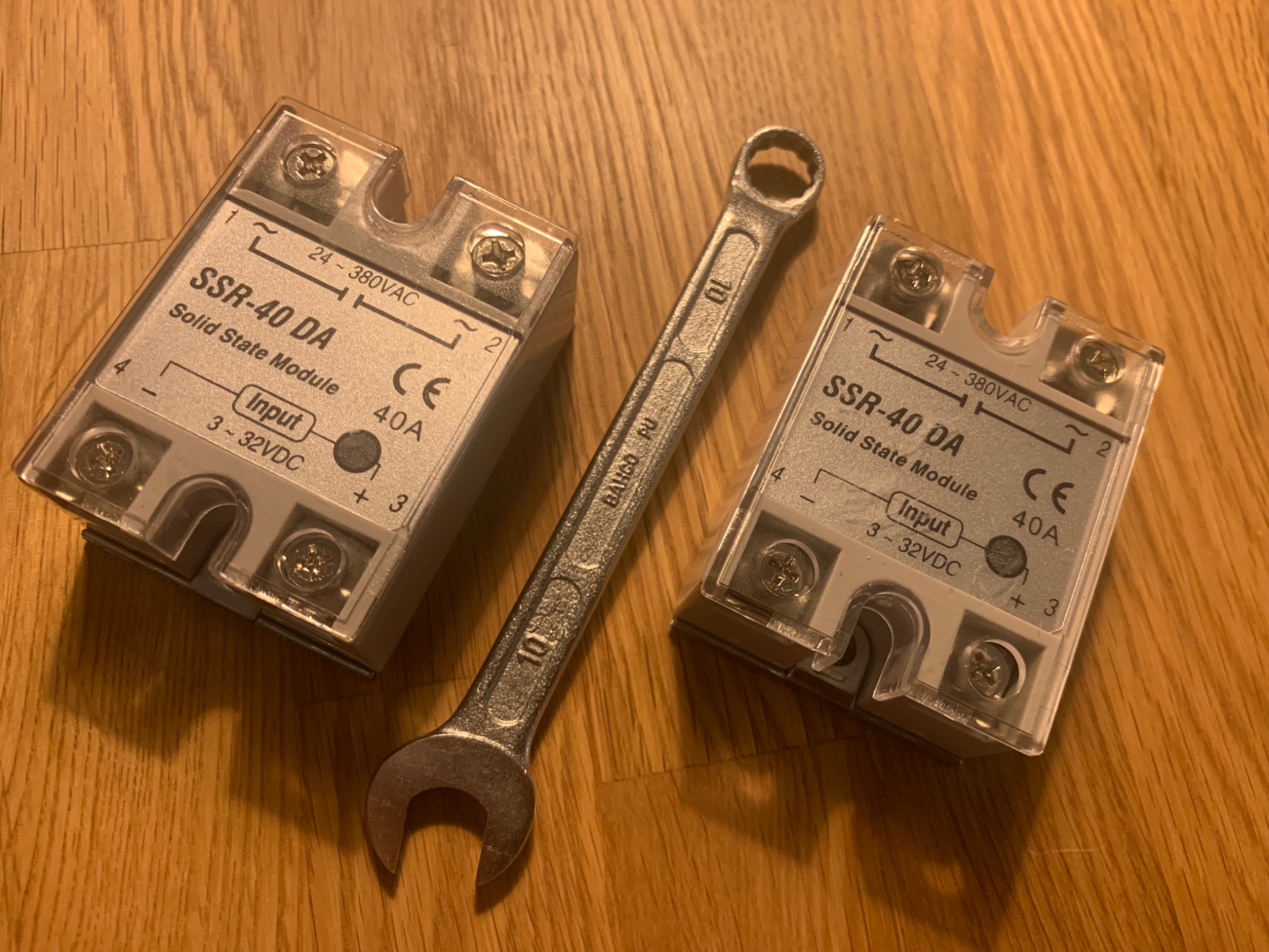

These pieces of solid state bull crap relays cant be used in audio equipment. They are giving off a fairly loud 50 hz buzz...
So. Got to find better ones. Any ideas on suitable good ones (and of course silent) for my application?
Was it mechanical buzz?
When I used solid state relays many years ago I did not recall any mechanical buzz.
Think I still have them in my cellar room 🙂
