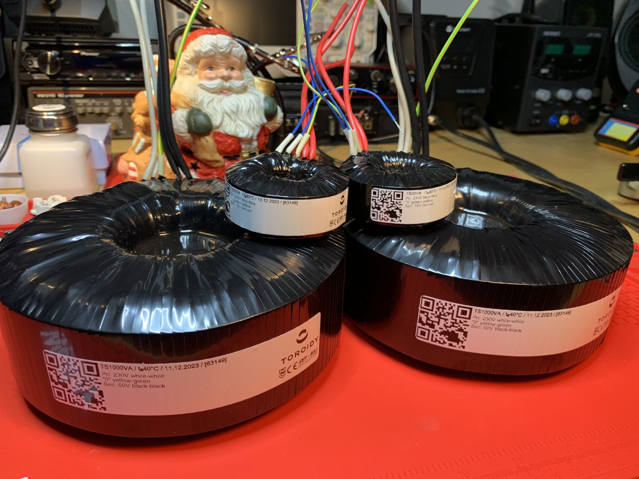

🙂🤚Hey, what you think about this, my latest far more chicken plan than that of the the above:
2x Toroidy 1000VA 60V AC
2x Toroidy 20VA 15V AC
…As twin separate PSU platforms for the 2x mono Lazy Singing Bush and the 2x mono Singing Bush amps. (Both versions not planned to be driven at the same time.)
That would ballpark 60V AC x1,3= 78V DC as i understand it.
Would that be doable without very radical changes in my Singing Bush, and Lazy Singing Bush kits?

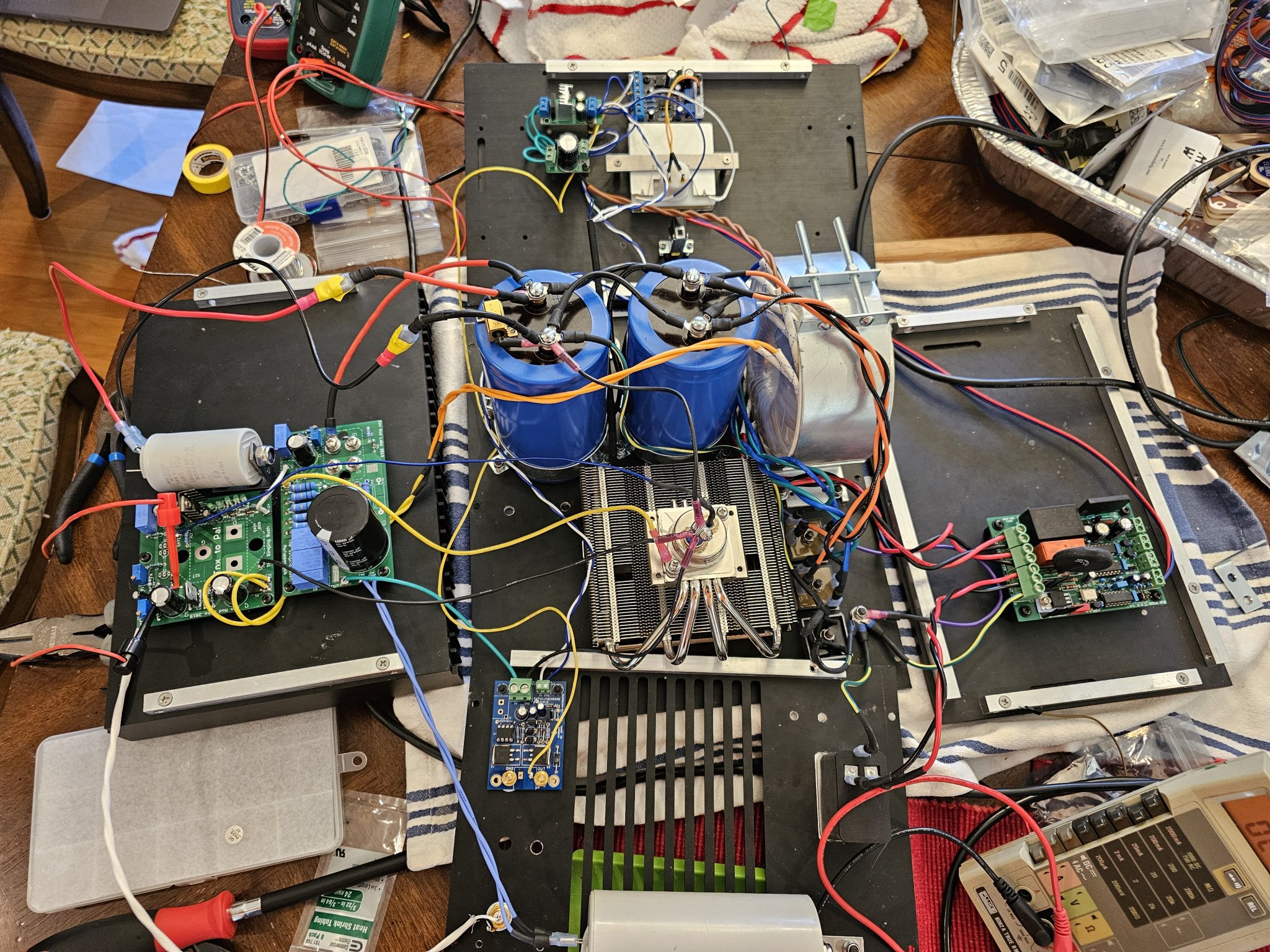

My singing half-bushes (demi-singing bushes? Half-singing full bushes?) have finally come to life! I started this project a couple of years ago, before the diyaudio store carried mono block enclosures, but got sidetracked many times... CLC PSU, motor run caps as needed, and active cooling on the 2sk182ES with a silent CPU fan + heatsink. Biased to 37V 2A3. Enclosures are cheap ones from Alibaba.
They sound incredible with jazz and female vocalists in my 4R speakers (85dB sensitivity). Mark Knopfler and his brother rock. Orchestral / symphonic is a bit muddy - good thing I don't listen to much of it. Would a higher bias point reduce some of the distortions? The heatsinks get to about 42C.
Thank you Zen Mod and Mr Pass for an amazing project!
certainly
