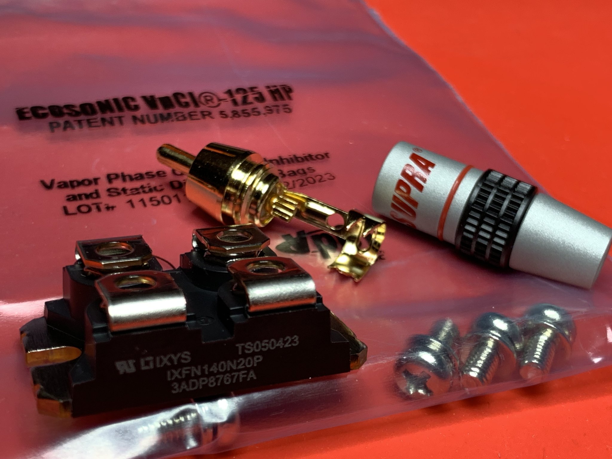

I am also fan of Supra cables and connectors!
High quality and reasonable priced.
Especially I like their "twist lock" RCA connectors 🙂
My mother always warned me about having "bad connections"!

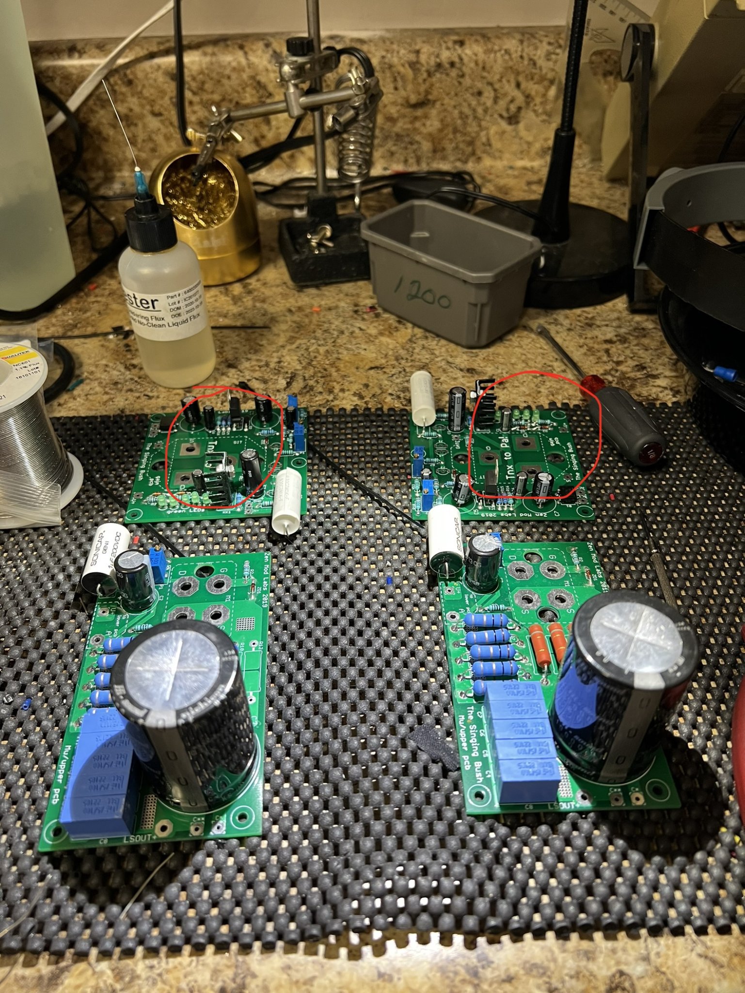

Some progress
1. PSU boards completed
2. Singing Bush Upper and Lower boards completed
3. Get 2SK77Bs ready?
Wait, Alex, where are my 2SK77s! 😂 they weren’t in the kit!
Who’s the greedy boy??😁

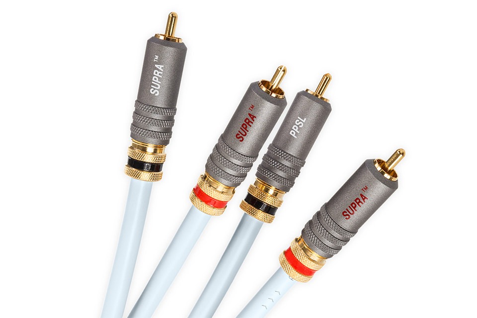

Well, that is actual pure gold plated advice from your mother. 😎
So I am going to upgrade from the base line to the twist lock Supra RCA connectors on your (and your wise mothers) solid recommendation.
It is as it turns out it is Super Sensitive around a MC preamp. I have been experienced actual intermitent no go connections. And thats f******g far from OK. As they say in the classic cult movie Pulp Fiction.
Yes, it was a good advice!
The twist-lock connectors are the PPSL types like these:
https://www.av-connection.dk/?PGr=2...VNgCiAx36Iw2iEAQYAiABEgJaofD_BwE&gclsrc=aw.ds
