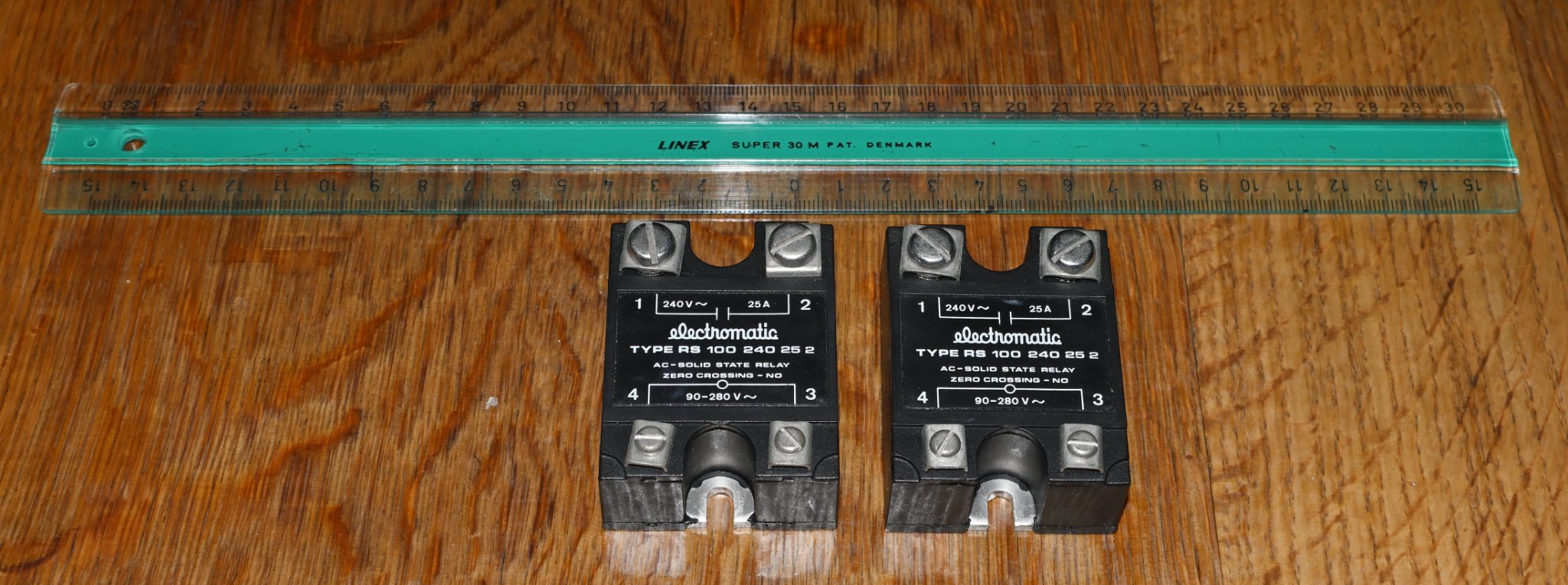

The two from my cellar are these. I used them many years ago in two power amps and I don't recall any buzz.
They are only rated 25A!
They are vintage but they probably work.
Electromatic.......no idea about the quality of this brand. Brand probably gone today......
I considered those a type that turned on during zero crossing but now I read: Zero crossing - No .......so now I am not so sure 🙂
I don't need them so you can have them for free if you want.....but no guarantee that they work 😎
I guess those are 30-40 years old.

I have not looked your application in details. Your China made SSR's and Panasonics trigges using a low DC-input.
My SSR's needs at least 90 VAC......so AC input trigger. They are used for mains in and out you can say.
There's so many formulations of those SSRs! I used them to construct an "inrush tester" for computer power supplies. Those turned on as soon as the control signal was applied. Turn off, however, was always at zero crossing.
Could get some big inrush currents with a cold supply and turn on right at 90 deg... That's what they wanted to see.
Yea, a lowish DC triggered one would be more suitable in this type of application.

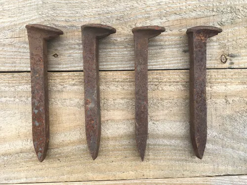

Ah, the slightly more sofisticated version of the fine, classic, old Danish party saving trick: ”Dont use fuses, use rail road nails”. 🙂
If you can clean them so they are not so rusty then they will probably give a nice low impedance 🙂
Some audiophiles will probably claim that railroad nails sounds bad?
