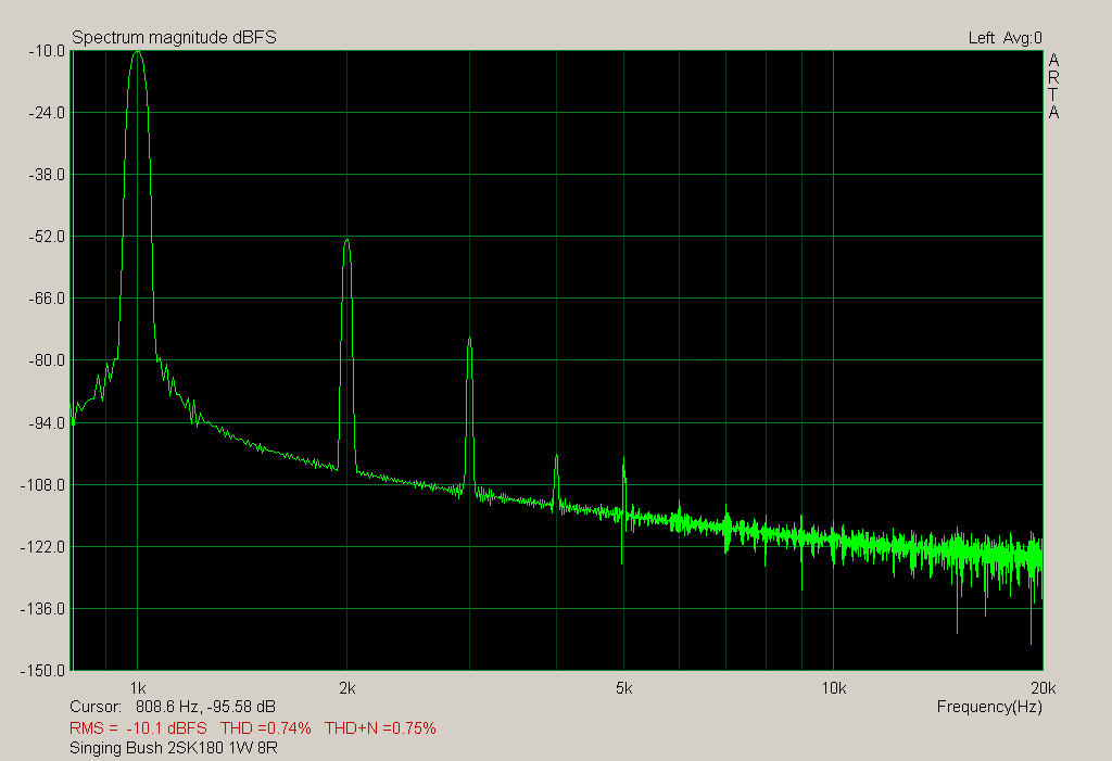

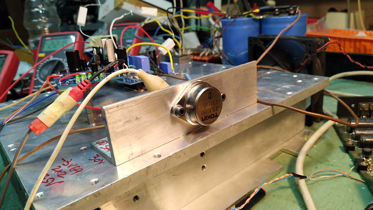

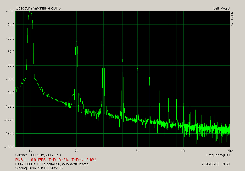

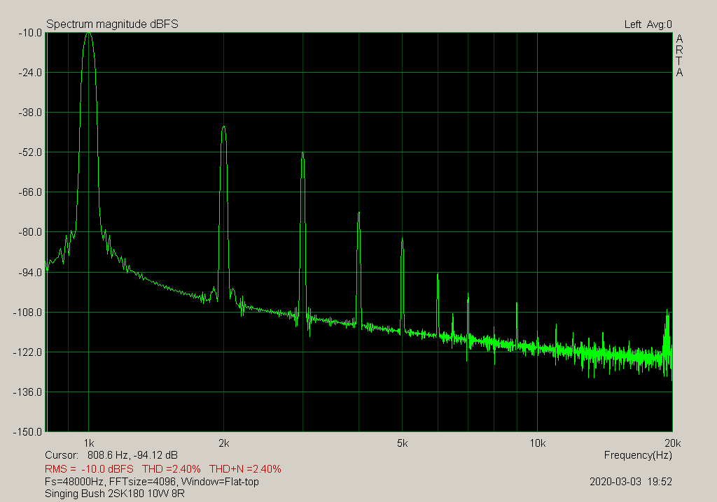

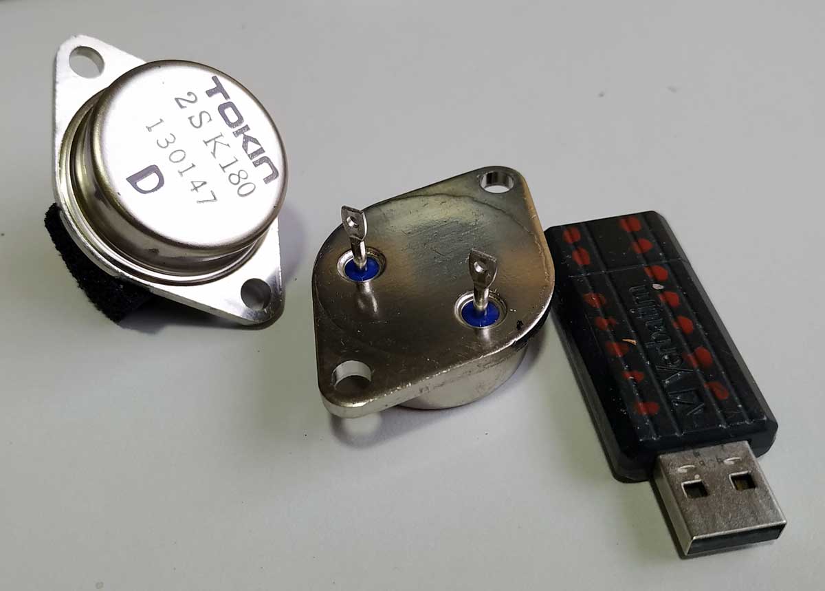

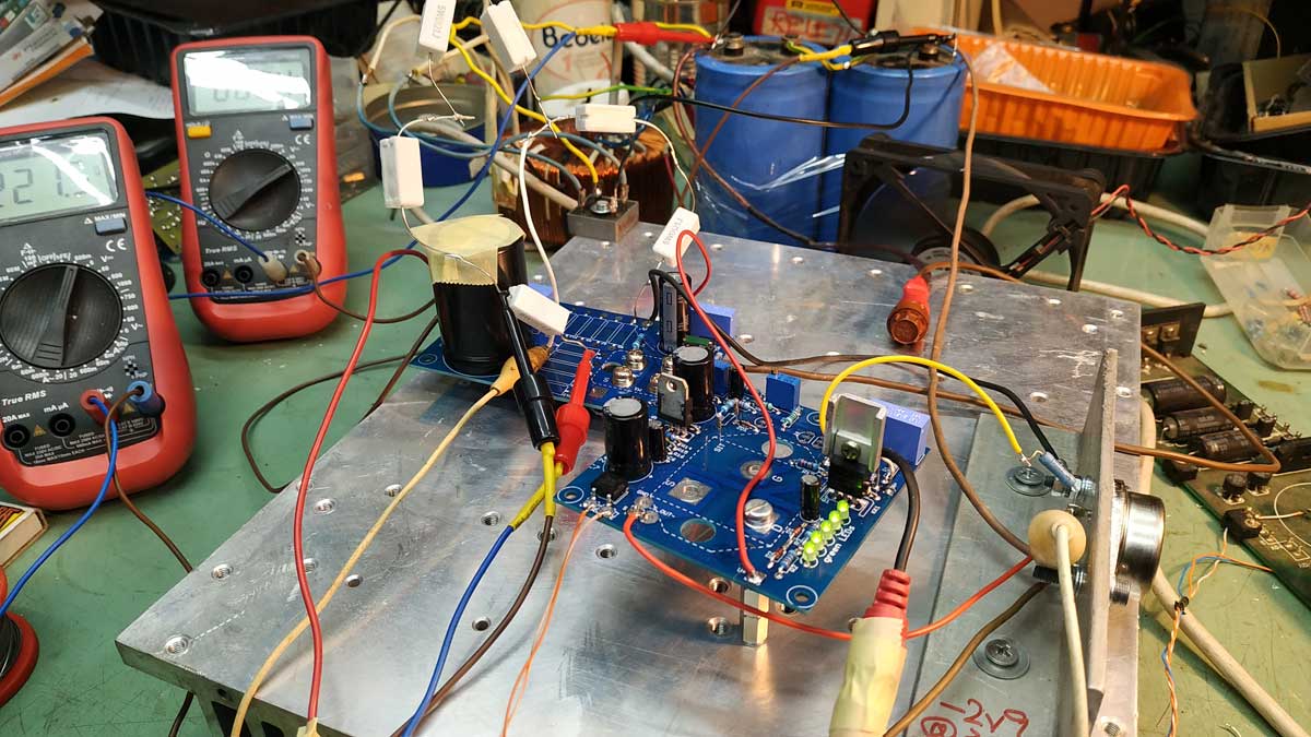

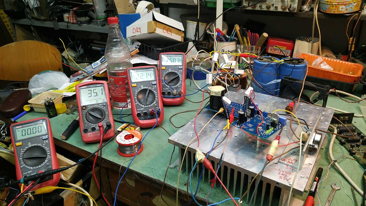

2SK180: Hope never dies ....... but, Oh Boy , how it's Dodo now!!
pair sent by Bubba Flocchini are still Customized , and I did put today first one (of pair) my local Buddy obtained
initial setup , as hope (that it's close/r to 2SK77B) commands , same as ZMighty Singing Bush - rail 60Vdc , Iq 3A, Mu resistor set 0R2 up, 0R2 down, speaker output from middle ,Drain potential smidge bellow 30V
first stint - 1W THD Spectra measurement - damn!! 1.76%
power down , insert additional 2pcs of 0R1 in Mu string , power up , set Iq to 2A2 , Drain at 35V , try THD with 0R4 up and 0R2 down , then with 0R2 up and 0R4 down
THD shows that better option is 0R4 up and 0R2 down
few pics of setup

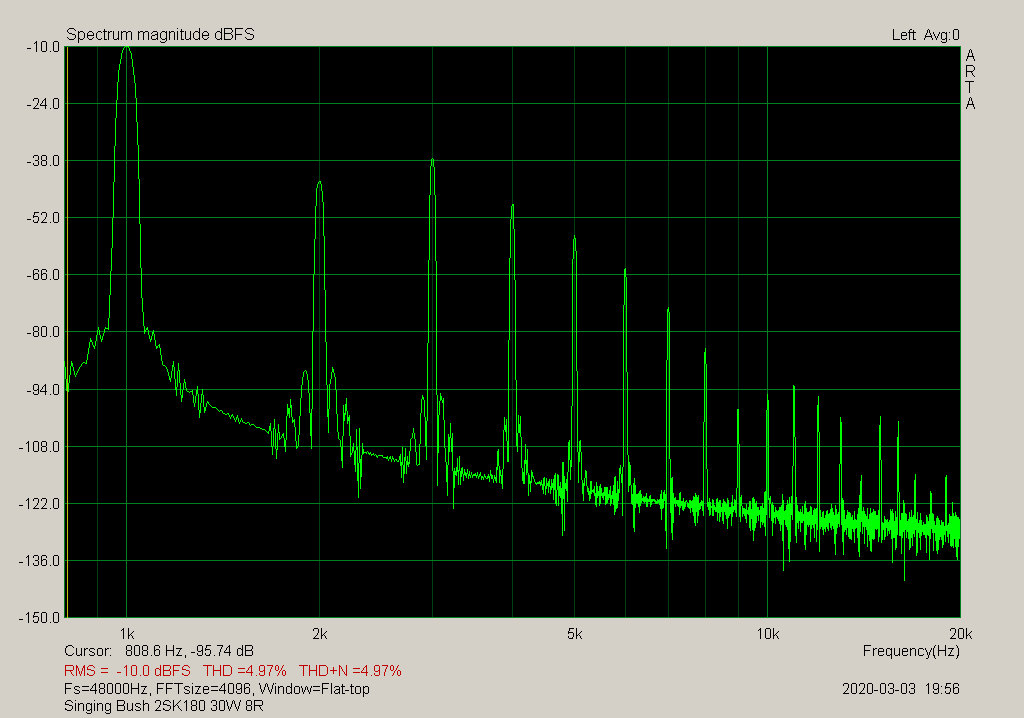

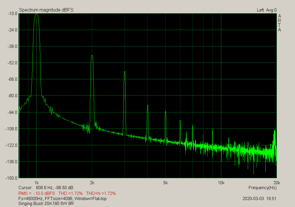

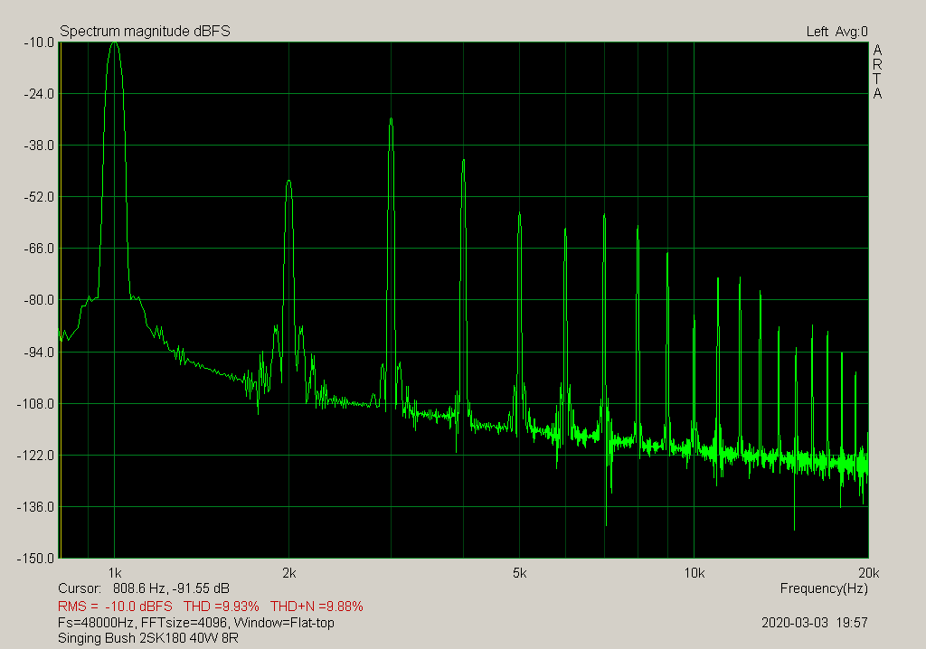

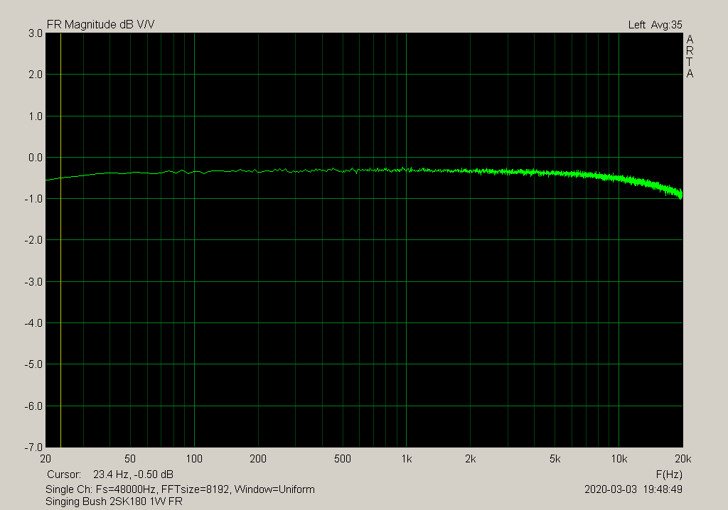

2SK180 Singing Bush , 8R load
gain is 330mV in for 2V828 out , so 8.57V/V , 18.66db

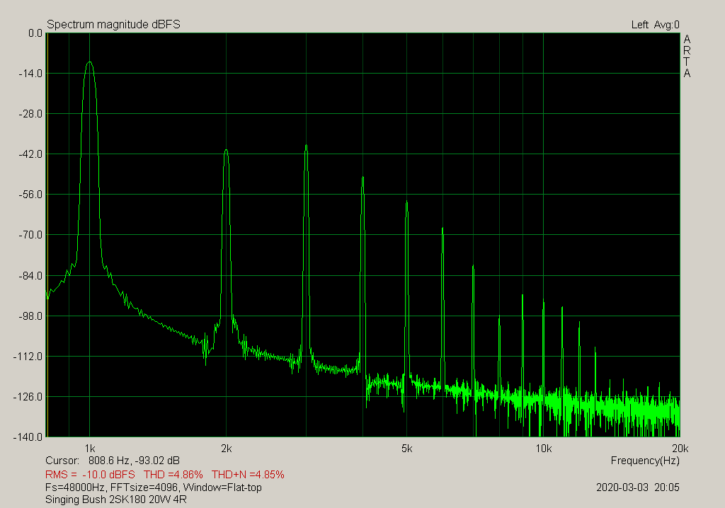

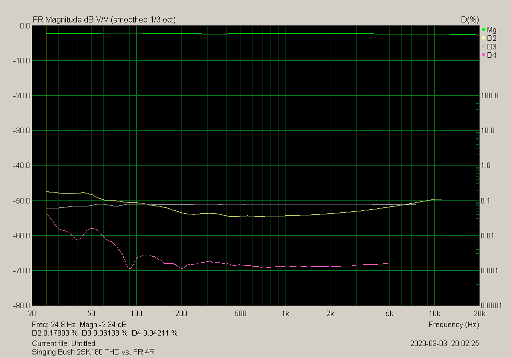

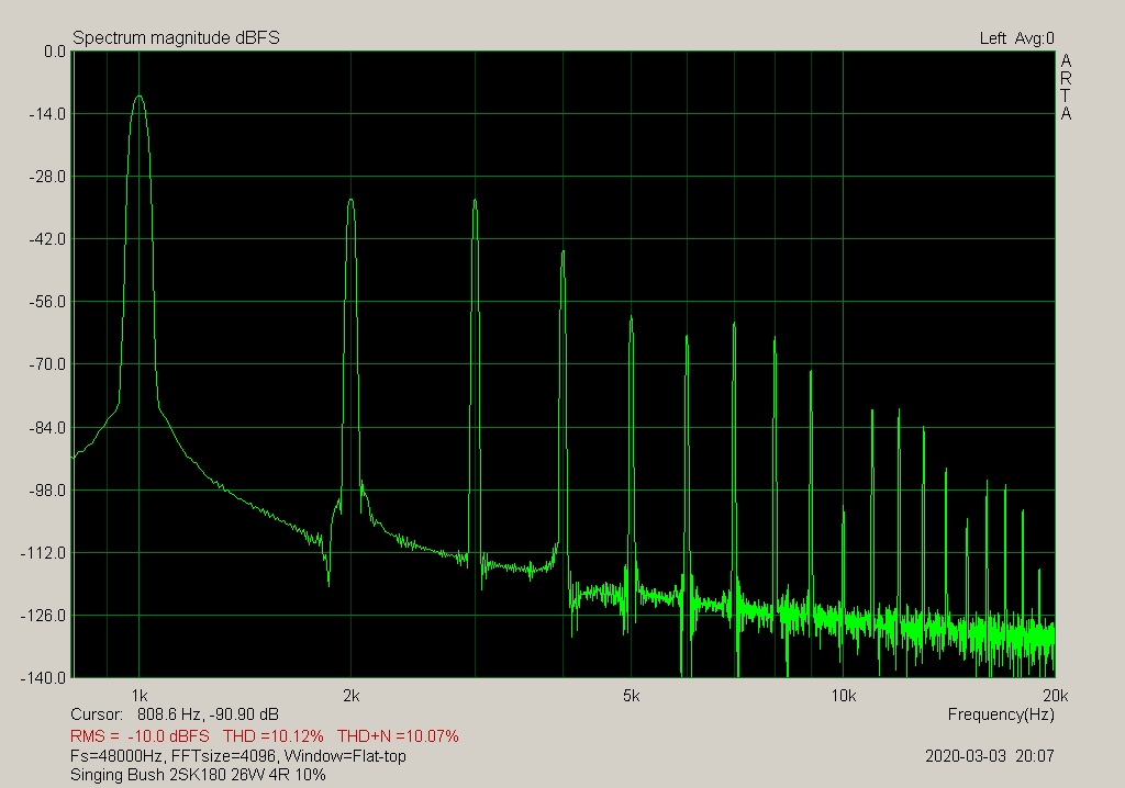

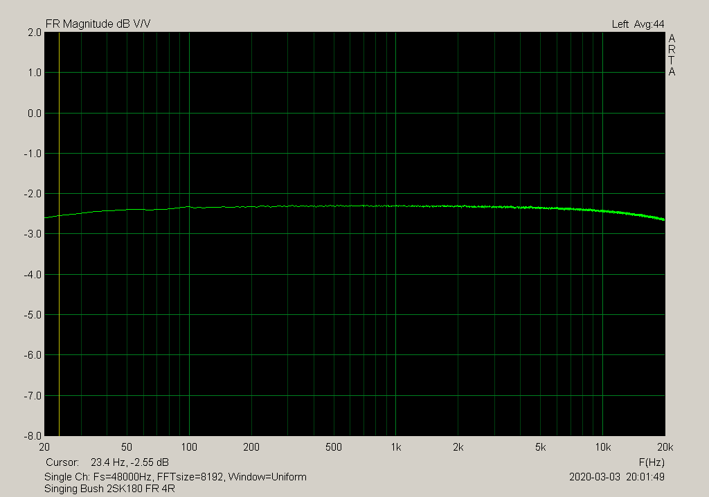

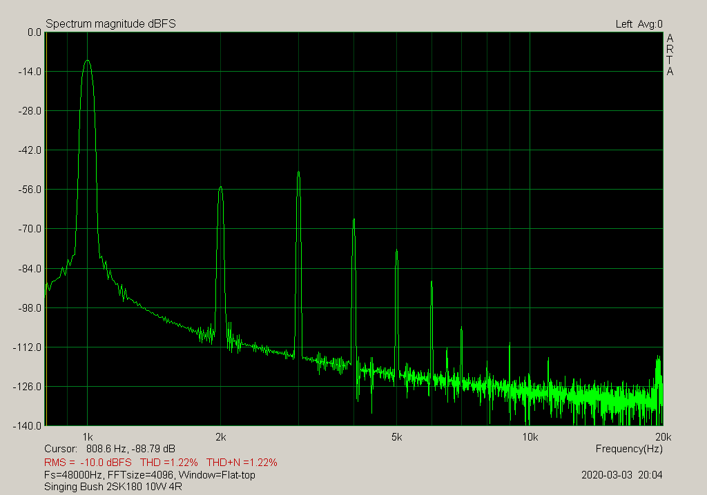

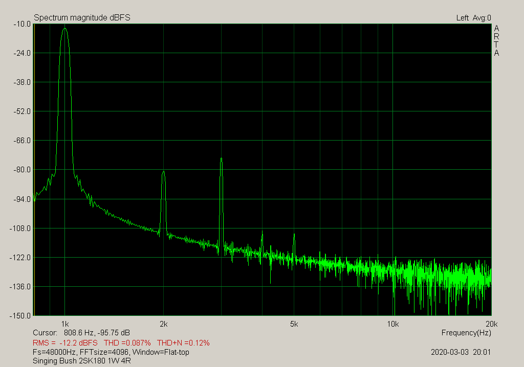

2SK180 Singing Bush , 4R load
gain 338mV in for 2V out, so 5.917V/V , 15.44db
2SK180 Singing Bush, conclusion
well , behavior pretty much the same as THF51 and 2SK182 , maybe little more leaning to 182 side
was it worth spendiong money and repeating all measurements , to find out how hope is mortal?
considering that this time I didn't engaged my wallet, ( as was the case with 2SK182 for SissySIT)first part of question my Buddy and B. Flocchini need to answer
measurements - it was my pleasure , as always is , when I have something to play with
hope is maybe mortal , but we Kids are immortal !
one thing more - if you look back at what's posted in #57 , my fave commercial toob amp - EAR 859 - situation with any iteration of Singing Bush is simply more rosy
and , THF51/2SK180/2SK182 iteration , being slightly scaled down to 132W of heat per channel , is somewhat easier to make , as little bonus to decrease in performance , when looking at ZMighty Singing Bush with PapaTokins
I will repeat measurements , probably tomorrow , with second 2SK180 specimen , but now really not expecting Miracles
