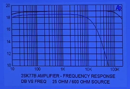

point is - as long you're having enough cojones to drive that big honkiing gate , there will be no problem
SIT doesn't care of which you made those cojones
so . preceding stage with low enough impedance , and you're good

ok i've seen the lecture.
i saw at articles nutube preamp has 140ohm to 170ohm output impedance.
is that low enough to drive hockey puck sit input without any buffer?
short 220R at NuToob output and situation is much better
not ideal , in my book , but much better
