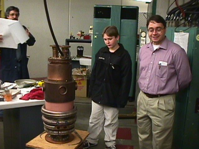

Nelson may have photos of one of those tubes in pieces, when Econco commented that "God doesn't have enough money for us to rebuild that tube!"

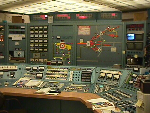

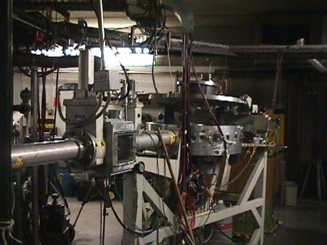

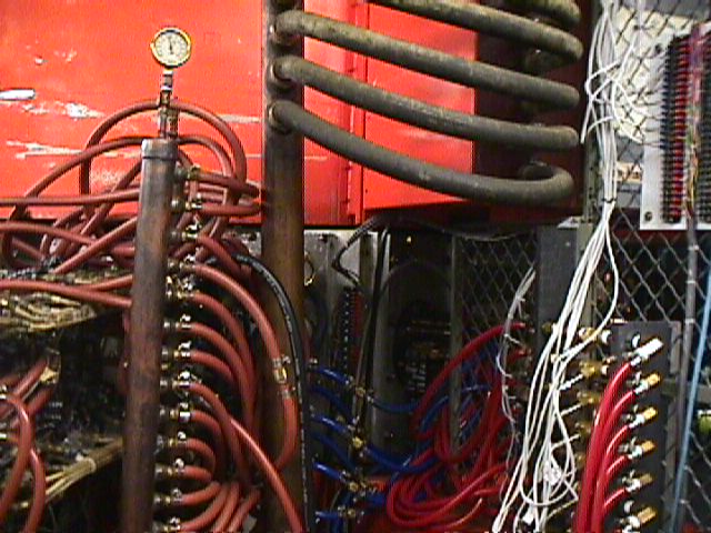

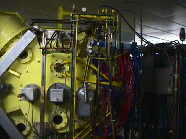

I dug up a few photos from our visit. You will see Cyclotron Guy, and young
Colin Pass and Wayne looking at the big triode.
Also you will see the control room, and other pieces of hardware....

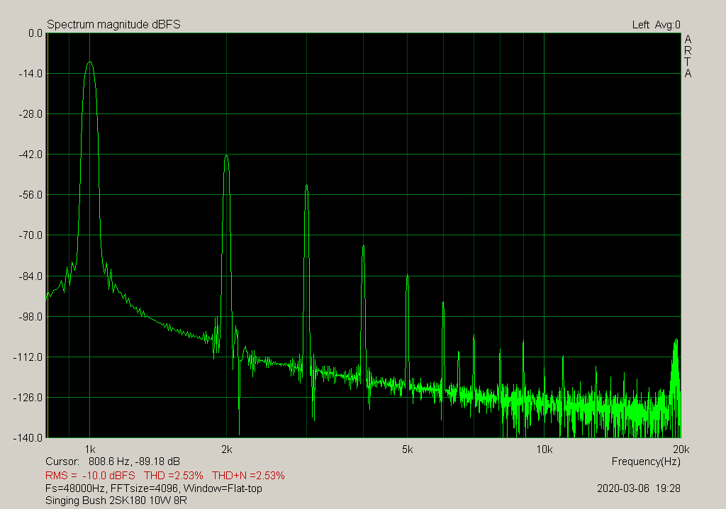

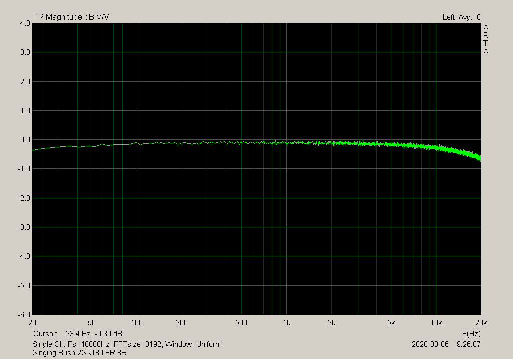

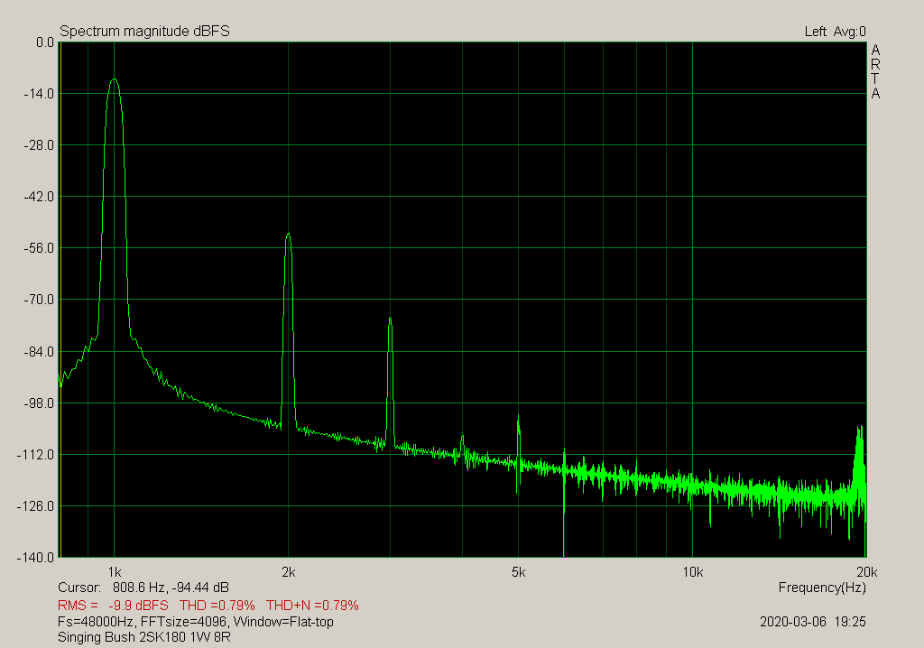

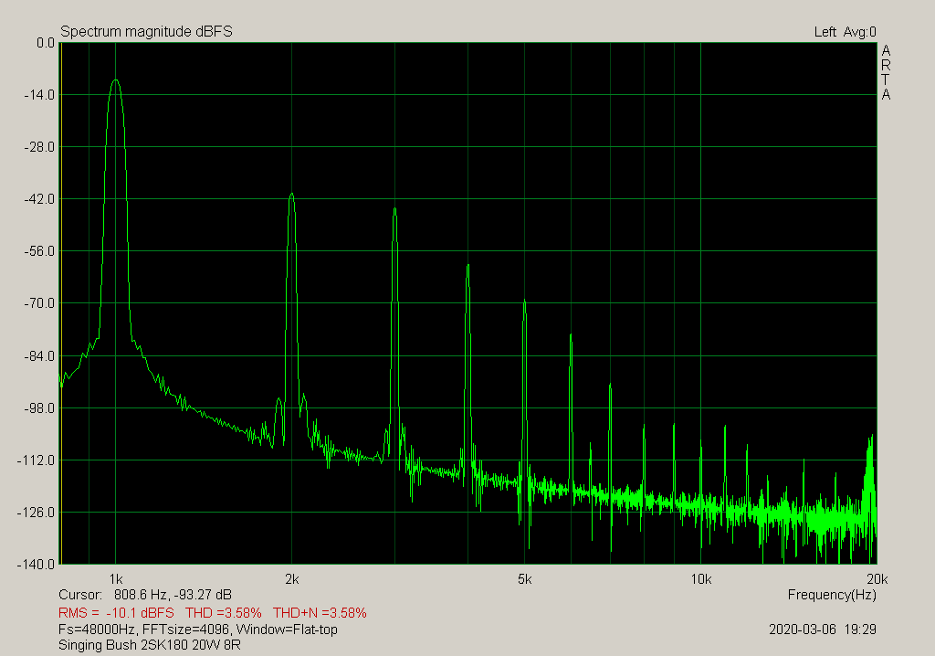

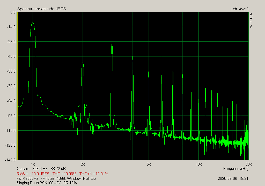

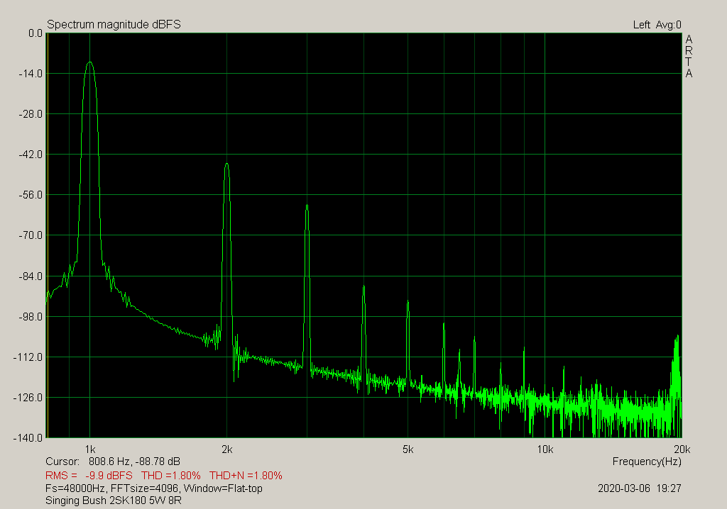

2SK180 Singing Bush , second specimen
I forgot to write down but seen on picture in quoted post, first specimen of pair I have for now was Ser. No. 130130 , having Ugs of -3V69 for Iq 2A2 , with 35V of Uds
second one is Ser. No. 130147 , having Ugs of -3V88 for Iq 2A2 , with 35V of Uds
so , Ugs not exactly matched , but so-so close
graphs following , no pictures of funny setup this time
2SK180 Singing Bush , second specimen, 8R load

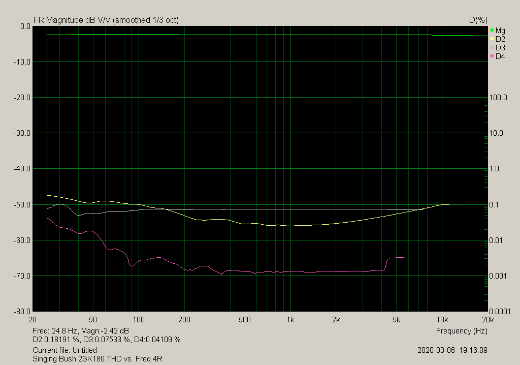

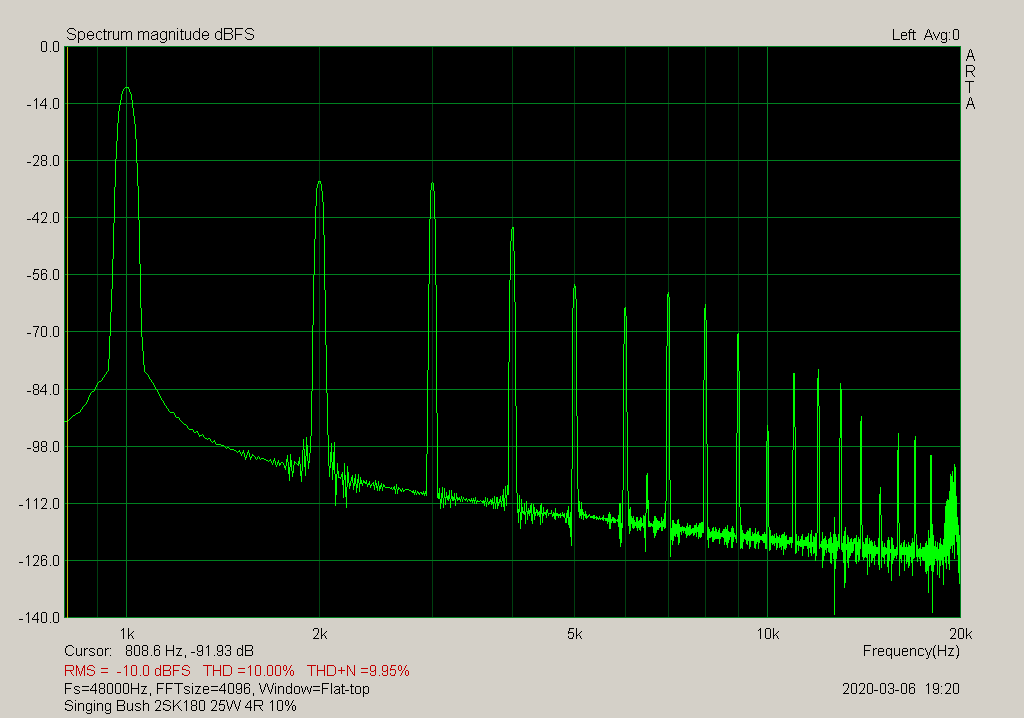

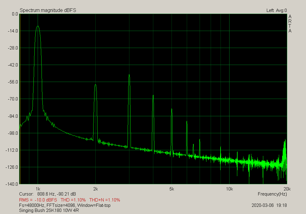

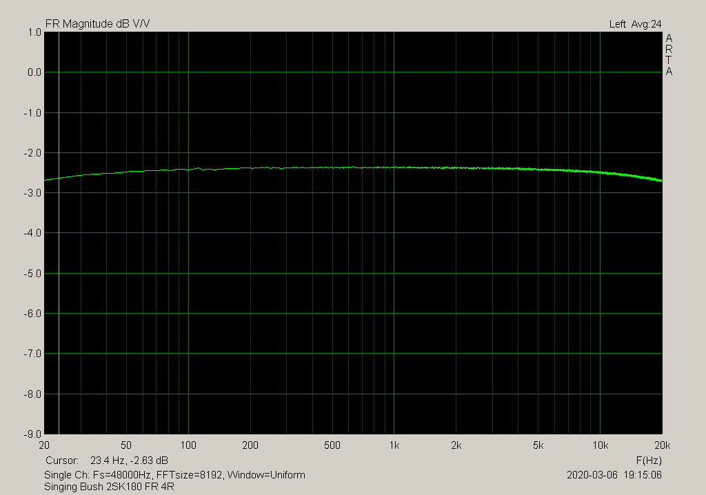

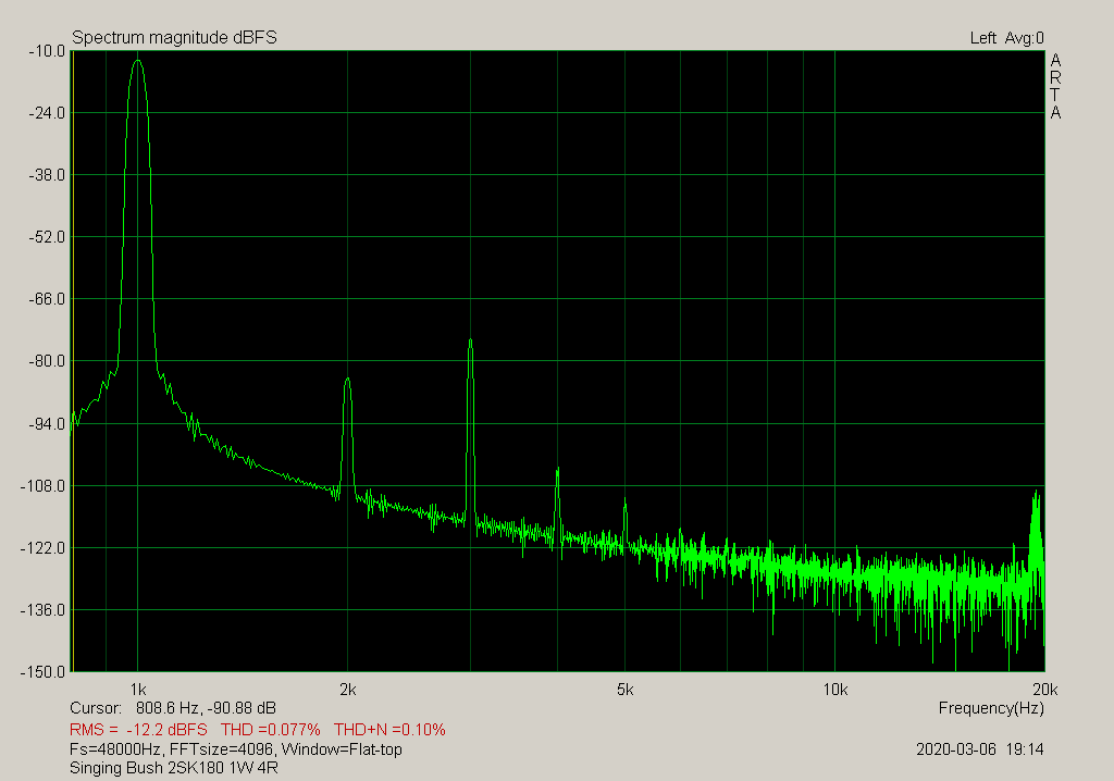

2SK180 Singing Bush , second specimen, 4R load
Note for @ggetzofffffffffff :
for 4R load , not shown , ZM lazybztrd - quick and dirt optimisation is same setup ( as for first specimen , see linked post two posts up) - just decrease/set SIT drain voltage to 31V - that'll invoke 2nd harmonic above 3rd , while still keeping overall THD at bay
of course that for proper setting of Singing Bush , one either needs to have simple THD Spectra measuring setup ..... or to trust own ears - pretty much easy with simple iterative process - start with prescribed arrangement for Mu resistances and drain voltage potential (35V) , listen and write down some notes about sound ; increase drain potential for 1V , listen , make notes ;
go back to 35V , then decrease for 1V , listen , make some notes ...... try another volt down or up , from where you been , listen , make notes
read notes , set to best overall
as soon that pair from my Bubba Flocchini stop being Customized , I'll repeat same battery of tests
who knows , maybe something could happen in a meantime , me suddenly cleverer .......... to try some new trick
but , don't hold your breath
