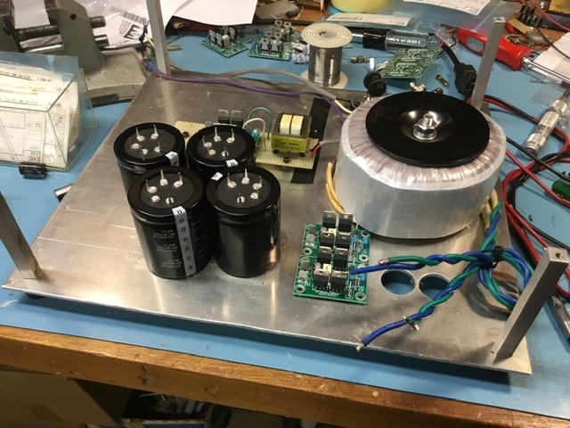

Power Supply for Singing Bush
For all iterations , target positive rail is 60Vdc , plain logic and experience sez that's 48Vac secondary Donut
Schade (Full Mos) is having Iq in range of 3A/ch. ......... say 300VA Donut as minimum per channel
THF51/2SK180/2SK182 - having Iq in range of 2A2 , say 250VA Donut as minimum per channel
caps - 75Vdc rated, as minimum
cap bank for one channel - CRC fashion , 20mF-0R1/3W-20mF , as absolute minimum ; 30mF-0R1/3W-30mF is better ; more , the merrier

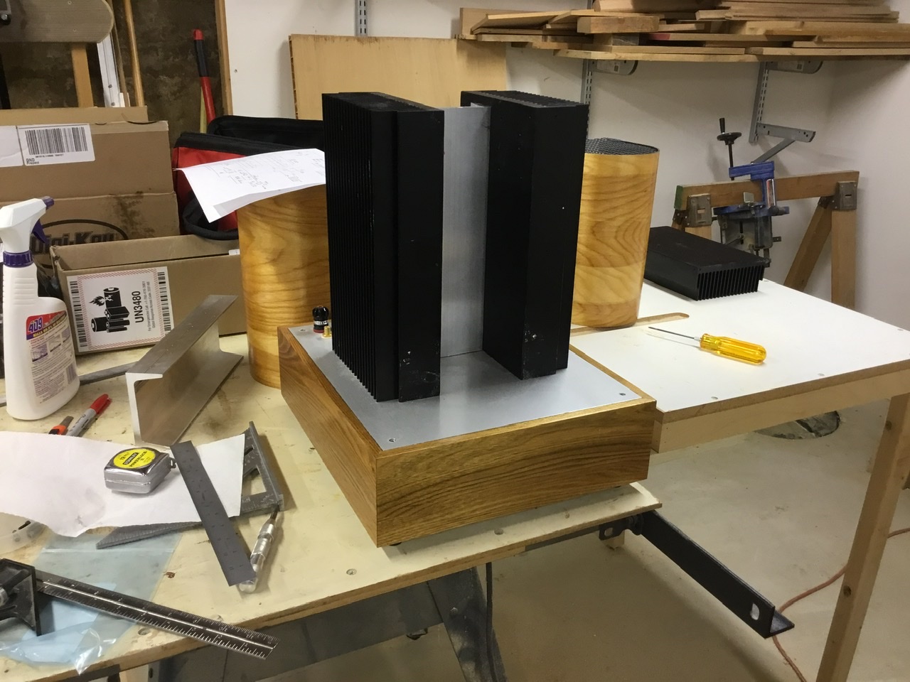

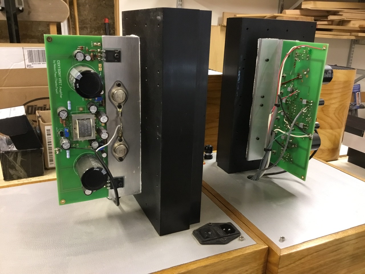

Yes, mono blocks.
Here is the heat sinks.
mmmmmmmmmm ....... Shiny!!

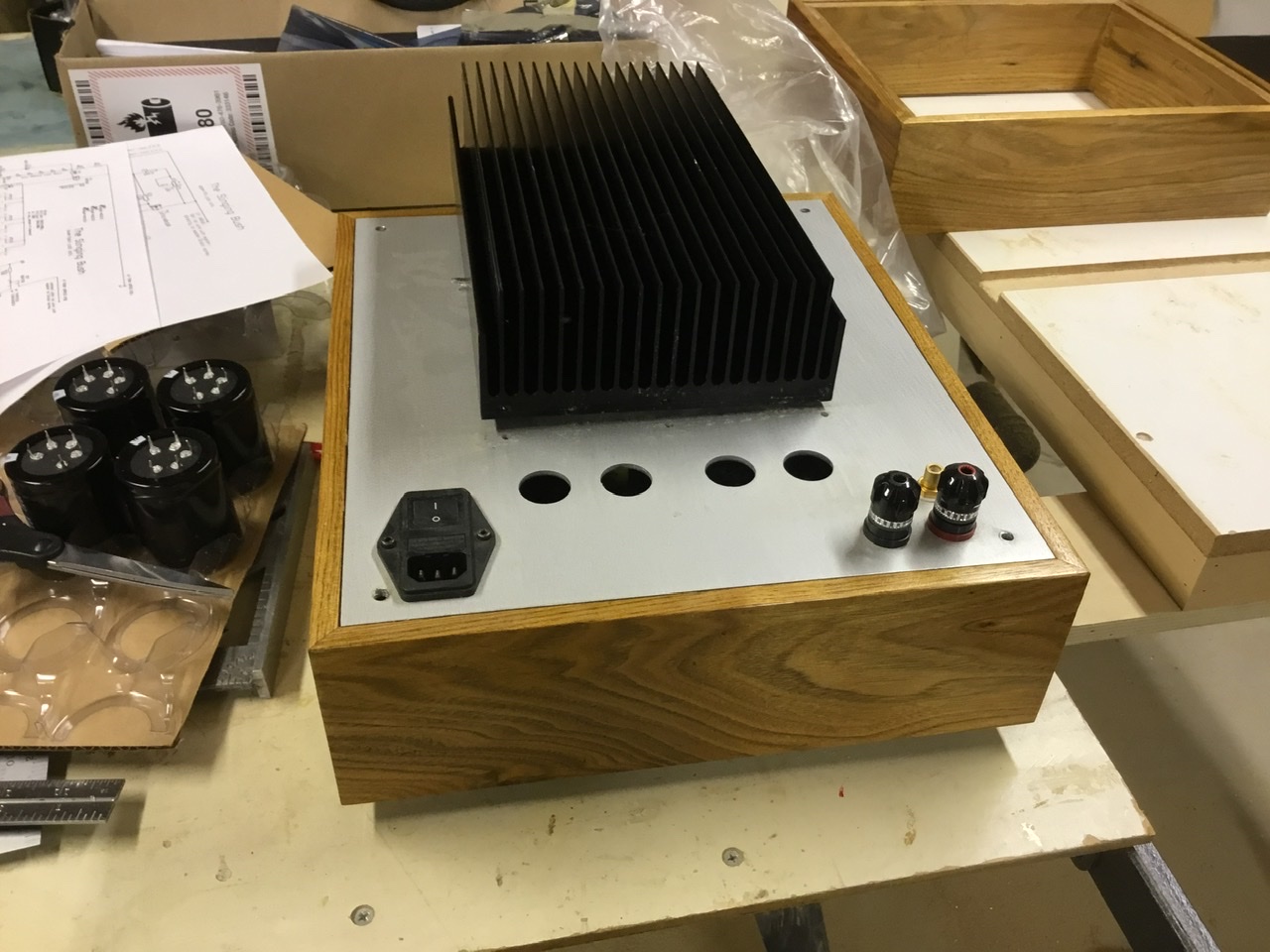

be sure to have some slits under the heatsinks
I heard lately that they're happier having some air circulating

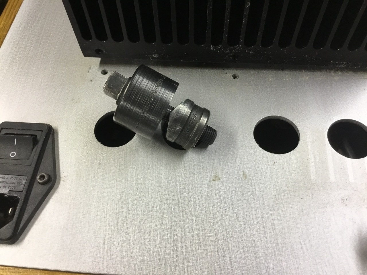

I don't have these , but I'm using stepped drills for years , and sort of Adjustable Circle Hole Cutter for even longer
of course that smaller and bigger bench drills are must
