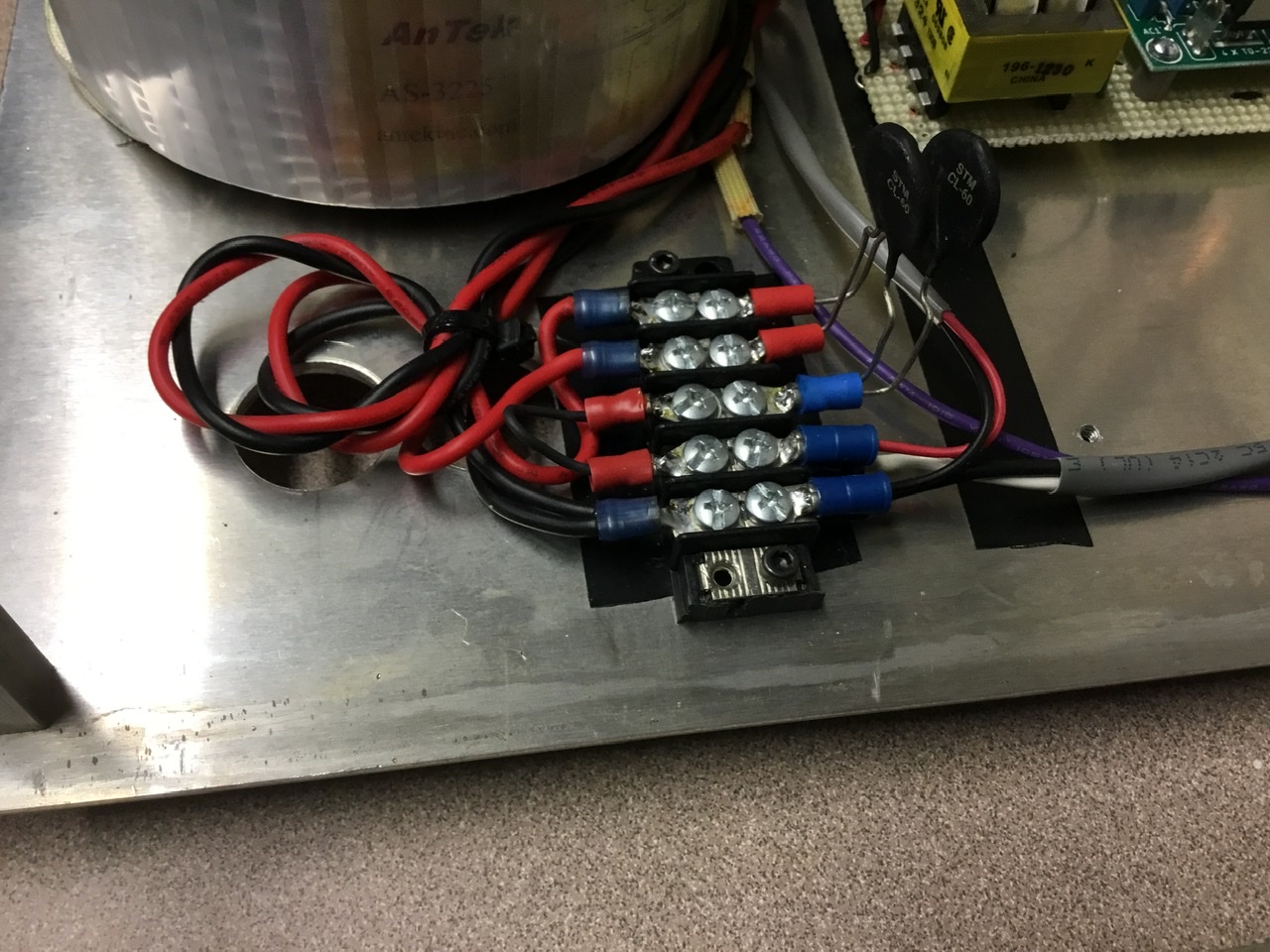

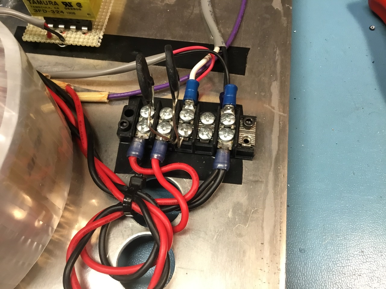

take care of these mains NTCs in lousy plastic connection blocks
better to use black ones , with proper screws , where you must use eyelets for everything , and plastic is much better
well , heat of NTCs itself , from experience - can't melt them ...... but NTC is having solid core leg , while these are having lousy screw connection ( even if some having intermediate metal tab between screw and wire) , where you have potentially bad contact, and you know that results in heating with time
it is really optimized/made for strand wire , not for any sort of solid core , which is simply giving up of pressure in time

solder wire eyelets on NTC legs , then bolt/screw them
cunning to use some silicone isolator tubes there on NTC legs , instead of heatshrink
wtf , what is proper term here - bolt them , screw them ?

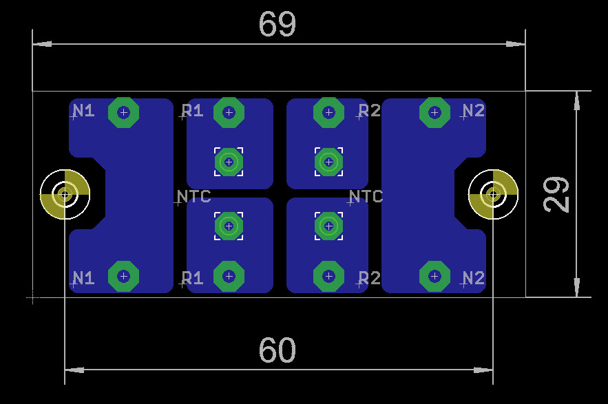

I made pcbs for them
use raw pcb material , all you need is exacto knife and drill
Noted.. Danks
Yes 🙂

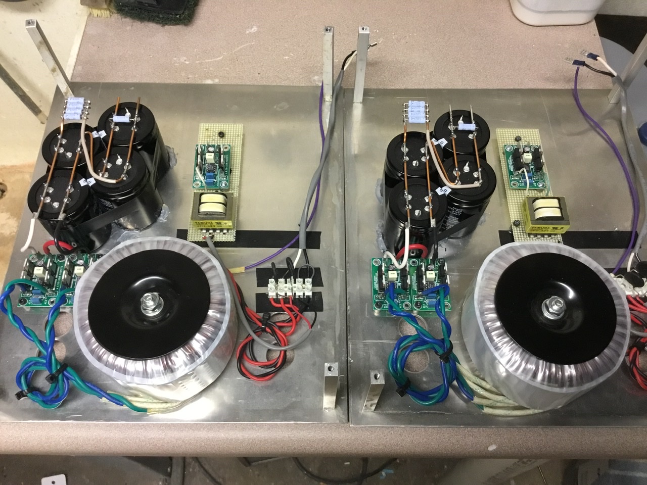

Now I have it proper.
Not that it didn’t work the other way for six years. As long as I have time may as well do it right.
