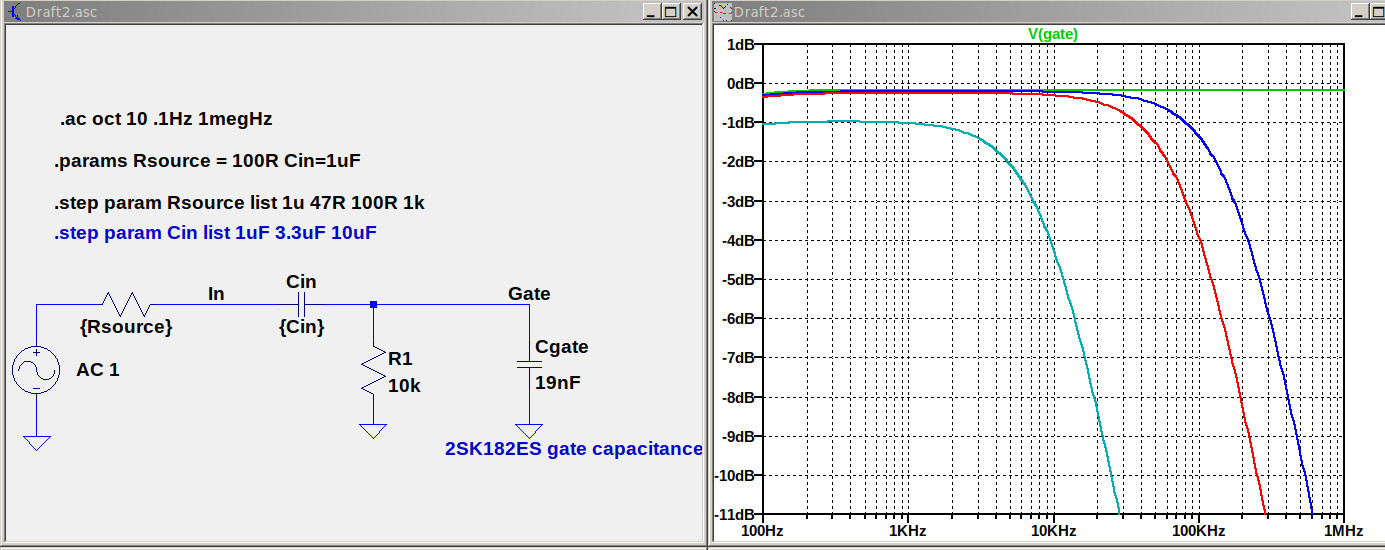

- Regarding the circuit in post #5 (the peasant half), how is the voltage stabilized ad the node A' between the mu-follower and the IXYS M1 drain? The transformer feedback is AC only, thus it seems that node A' could wander around a lot without some sort of DC feedback.
- In post #133 The Singing Bush there was a question about the inp(ut coupling capacitor. My measurements of the 2SK182ES show about 19nF input capacitance of the device, and that capacitance is non-linear. The input and gate capacitors together will become a voltage divider. The bigger the input capacitor, the less distortion due to the non-linearity of the gate capacitance. The input capacitance together with the gate bias voltage resistor (10k?) determine the low frequency rolloff. I will show a simple schematic.

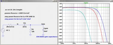

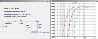

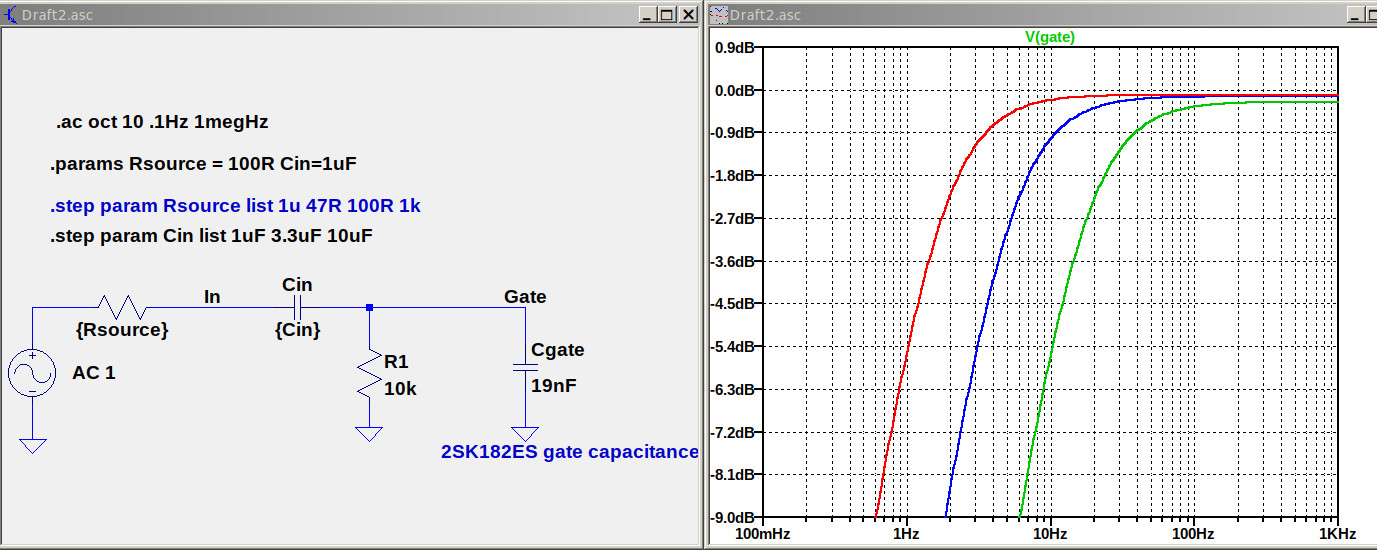

As promised, here LTSpice simulations of the RC circuit characteristics.
The first circuit show the low frequency-off for different values of the coupling capacitor, assuming a 10K resistor to the bias voltage generator.
The 2nd circuit shows the high frequency roll-off for difference values of the input source resistance.
Yes, the best place for the input capacitor (if needed) is before the JFETs.
Alternatively, in the circuit of post #5 (peasant half) is it possible eliminate R4 and P1, and then perform the bias offset at the JFET gates. The lowers the output impedance of the buffer.
'twas a choice of leaving in input cap or going DC couple all the way
I chose this way as better overall
