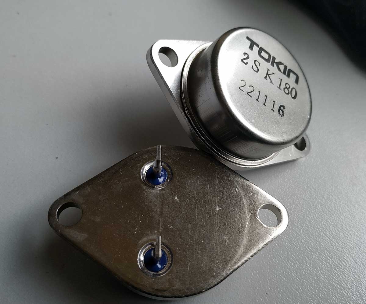

Look Ma, with no hands!!!!!
after being Customized for 40 days or so, I found them on Porch today
who sez that Postmen are insisting on signatures these days .......
(if nothing else, that's confirmation that my PO is working locally, sort of ...)
so, finally , pair of Biguns, sent by my own Bob's Your Uncle, Mr. Bubba Cyclotron Flocchini
who knows, maybe one of these days I'll have enough Vis Vitalis to try them, as comparison with already tried pair
be well, stay safe!!

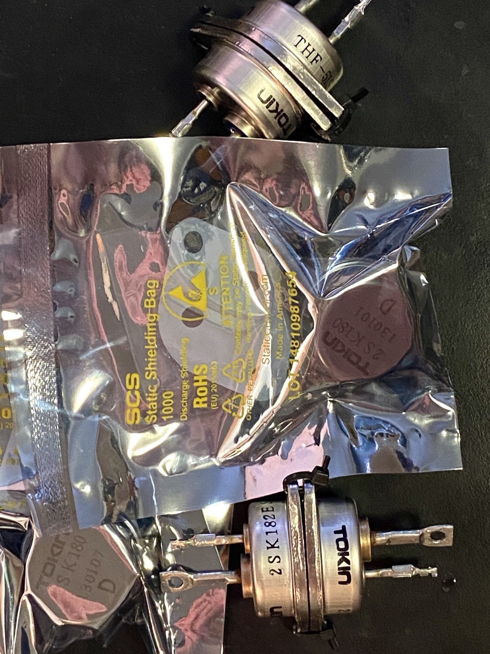

Precioussss...
Need some PCBs to go with. 😉
I see 6 fewer SITs left in the wild.
Supply and demand is understood but then why are 300B tubes so damn expensive? Maybe one day I will be able to trade some Tokin VFETs for a nice pair of Elrogs? 😀
it seems more like 8 , not 6 , presuming there are 2 in lower bag
