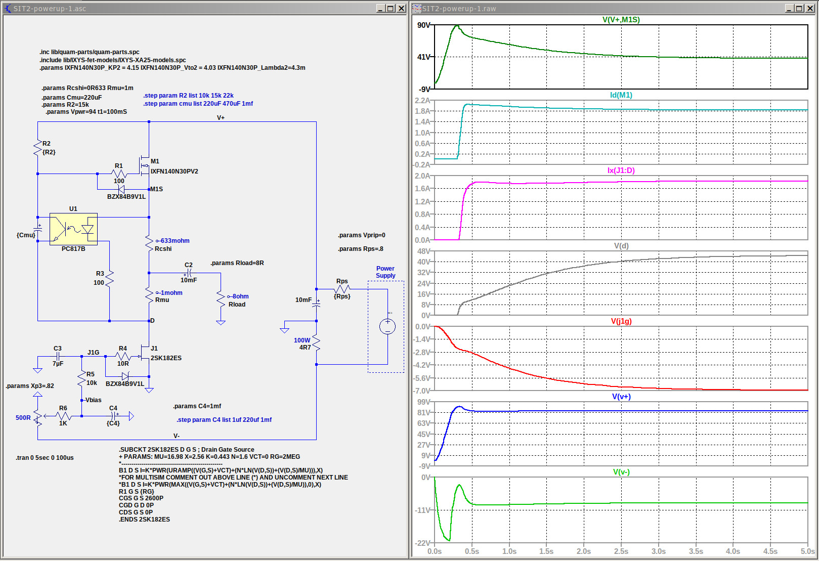

Here is one channel’s power supply...
I like the look of those rectifiers, what are you using?
Here is a simulation of the startup of my amplifier. I will try to verify this with single-trace scope bench tests. The two most important waveforms are Vds(M1) and Id(M1). Unfortunately I do not have a good way to measure Id(M1), or Id(J1). However I can measure the voltage across the 4R7 100W resistor between V- and Gnd.

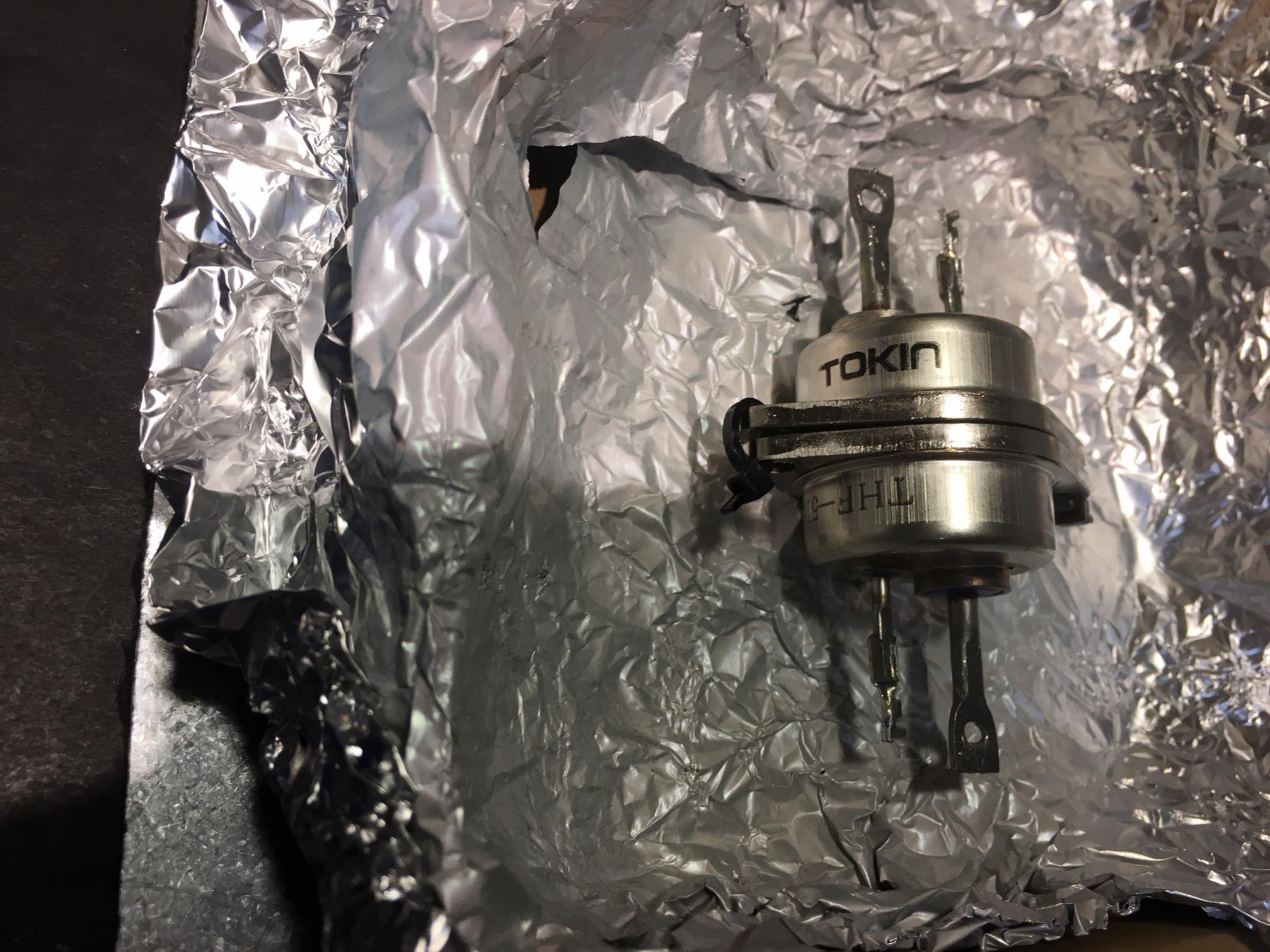

I assume there is no special requirements to the SIT's selection as they are use as singles?
Mogens
Mogens

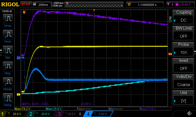

Here are some startup waveforms corresponding to the circuit in post #406. The horizontal scale is .2s/div.
- violet is Vds(M1) at 20V/div
- yellow is V+ at 20V/div
- blue is V- at 5V/div
- cyan is Vs(M1) (M1 source pin) at 20V/div
- Vd(J1) is slightly less than Vs(M1).

I did wrote about that few times,all tests are showing that having them so-so matched can't harm, resulting in similar THD Spectra between channels
The simulation in post #406 agree fairly well with these measurements.

regarding Singing Bush - as I already described - SIT biasing circuit is faster than Mu, so during startup procedure SIT is already biased in moment when Mu is starting conduction ........ so Mu is seeing (almost ) full rail voltage while current being 0 ...... then as current is rising, Mu Puck Vds is decreasing........
so , highest Vds is (almost) rail voltage , while highest current is pre-set Iq, luckily ( 'twas a Cunning Plan) never happening in same time 🙂

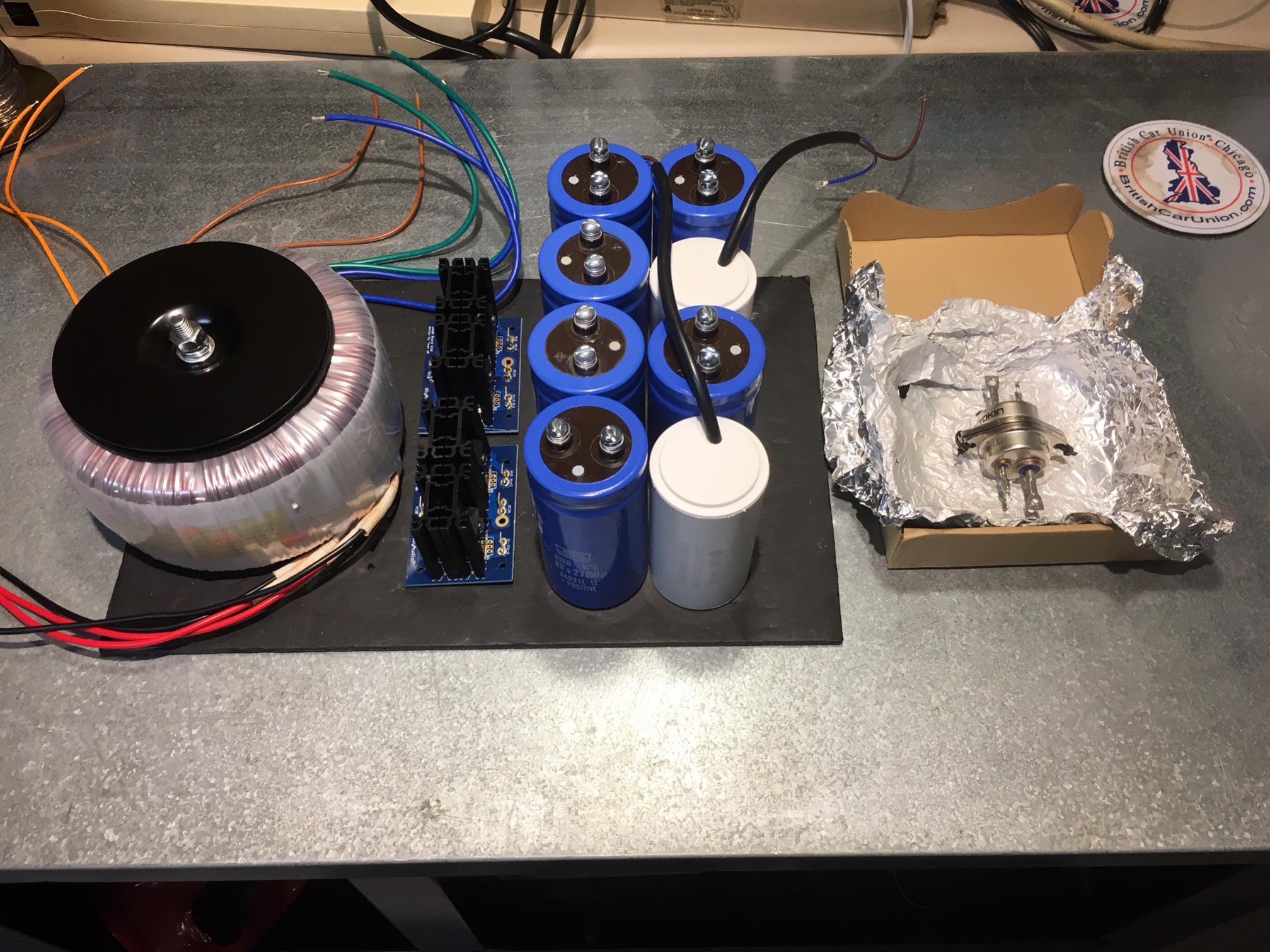

Power supply mock up, and matched SIT's.

Next, test SIT's using Zen Mod method, need to drill and tap a couple of holes to mount the SIT on a heat sink.

ZM - Transformer has 2X 48v, 18v, 12v secondaries. 18v for bias circuit?
18Vac perfect
if you have separate winding on Big Donut, that's practically the same as having separate small Donut
