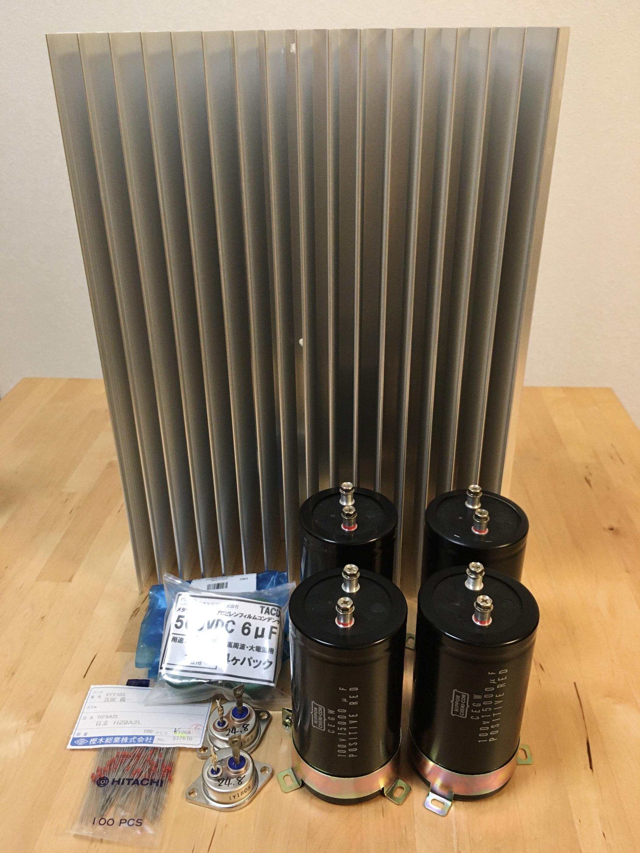

I am collecting parts to build SIT-Singing Bush.
Please advice me about the transformer.
I will custom order the R-core transformer.
So, I can select output voltage and current. I will order two identical transformers, since it is for monoblock.
In my plan, the outputs of the transformer are AC46v / 6A (276VA) and AC15V / 0.1A.
Please advise if it`s better to add tap or separate winding for future improvement/fun etc.
In addition, I plan to build amp with THF51S first and then replace it with 2SK77B.

if you shoot for 60 to 65Vdc , that calls for 48Vac to 52Vac xformer secondary
say that 276VA is absolute minimum I would use
46Vac seems sorta on low side, but it is doable, shaving a little from max possible swing, thus power; if you're ordering custom xformer (as I understood), ask for these few volts more
additional 15Vac/100mA winding is absolutely OK, there is no need for separate xformer

Thank you for your answer.
I will order custom transformers 50V/6A and 15v/0.1A.
The transformer capacity is 300VA, but the core size is for 350VA, so I think there is a margin.
If I want more, I can also choose 500VA size core, but isn't it overkill?

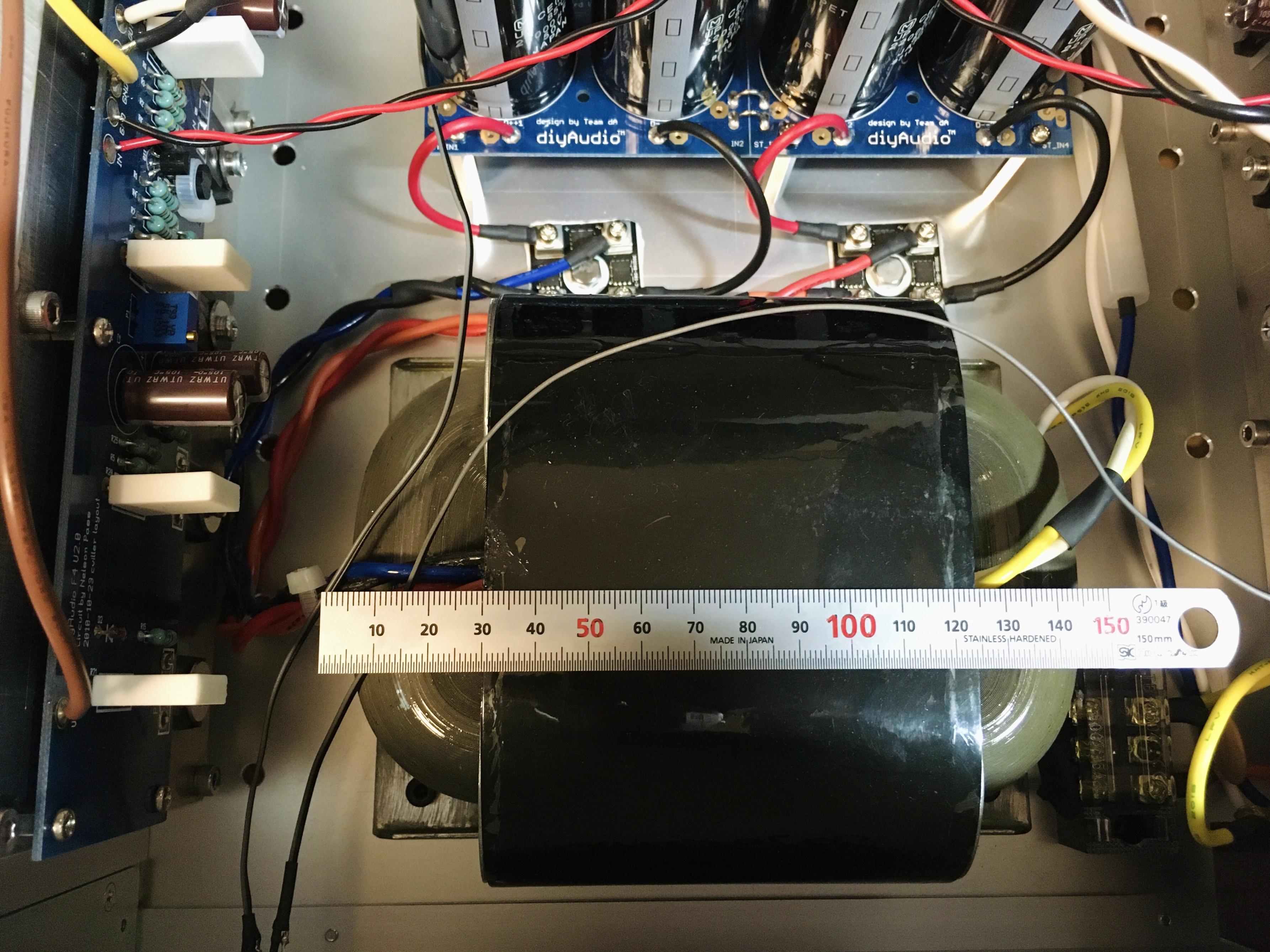

Haha. Attached is the 350VA size R-Core transformer that I used for my F4.
Is it small? Not enough?
OK, I will consider a 500VA size core.
(Although 1000VA is possible ...)

It is interesting to see what a 350VA size R-core looks like. For building an amp like the Singing Bush, the 500VA size would be a good choice for building a pair of monoblocks.
I am still waiting for my boards, and I am saving a pair of 625VA, 50V Plitron toroid transformers for this build.
