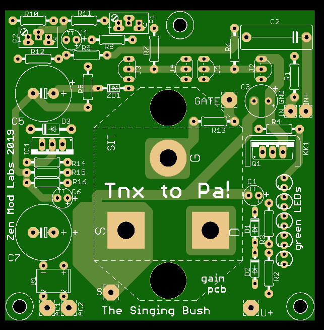

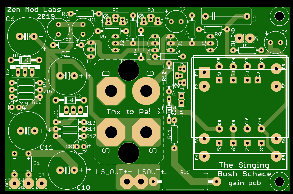

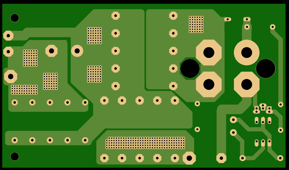

Did the boards you ordered for the GB change layout or size? I’m starting to layout the amp section and I’m planning on using the boards from the start of the thread as a template.

no changes
well , dunno , there maybe are few changes, routing optimization , and I believe that I added pads for additional motor-run cap ( if you wish that) as bypass for output cap , situated on Mu pcb
however , no substantial changes in layout and size
see attached renders from Gerber viewer thingy; no dimensions shown but , as I said , no change ref. what's posted in few first posts in thread

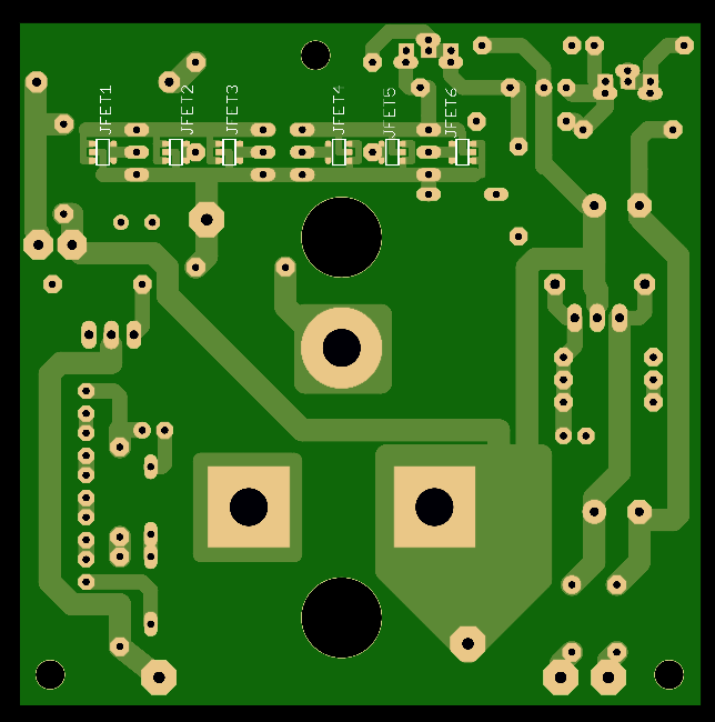

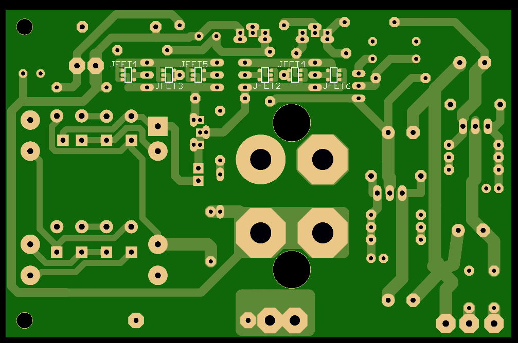

What do you think about me putting a hole for the source pin of a THF-51 in between the existing source and drain pins for the 77B On the board?
That way the THF can go in the same place as the 77B.
think about best routing
speaking of SIT Gain pcb ........ wire going from upper pcb , having proper wire eyelet and bolted directly to SIT Drain
tiny wire going from Gain pcb, soldered to Gate
tiny wire going from gain pcb , soldered to wire eyelet, bolted directly to SIT Source ; same wire eyelet is having fat wire , routed to PSU GND
neither from signal purity side nor from energy transfer side you need that gain pcb being ditto on top of SIT itself ...... practically power transfer wires are ditto on SIT , while you have just 2 (wires) connections between pcb and SIT - one is GND ( Source), second is Gate route - used for biasing and modulation
even in case of 2SK77B - pcb is bolted on , but energy transfer wire eyelets are still bolted on SIT itself with pcb just being sandwiched
incorporating pcb on top of funny THF51 case would just made things more complicated -some special bolts arrangement etc.
in time when kits starts shipping , I'll make proper photo tutorial or decent sketch
hope I'm clear with above explanation .....

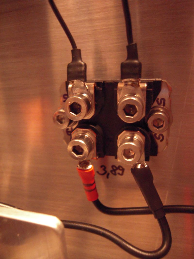

Words of warning - do not over torque the electrical connections! Too much torque will break the plastic housing.

Yep, Ben Mah!
Datasheet says circa 1.5Nm or 13lb.in..
So, please tourque with 'feeling' or 'sense'.... 😀
