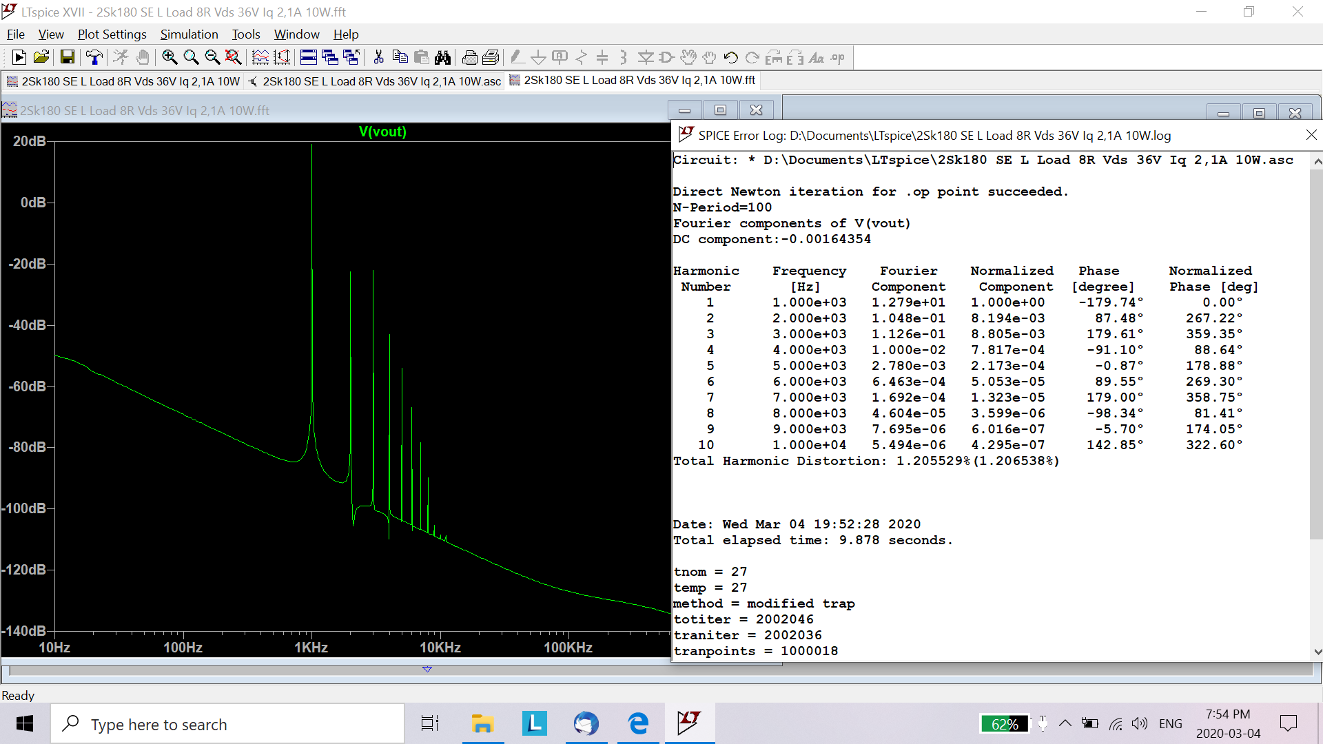

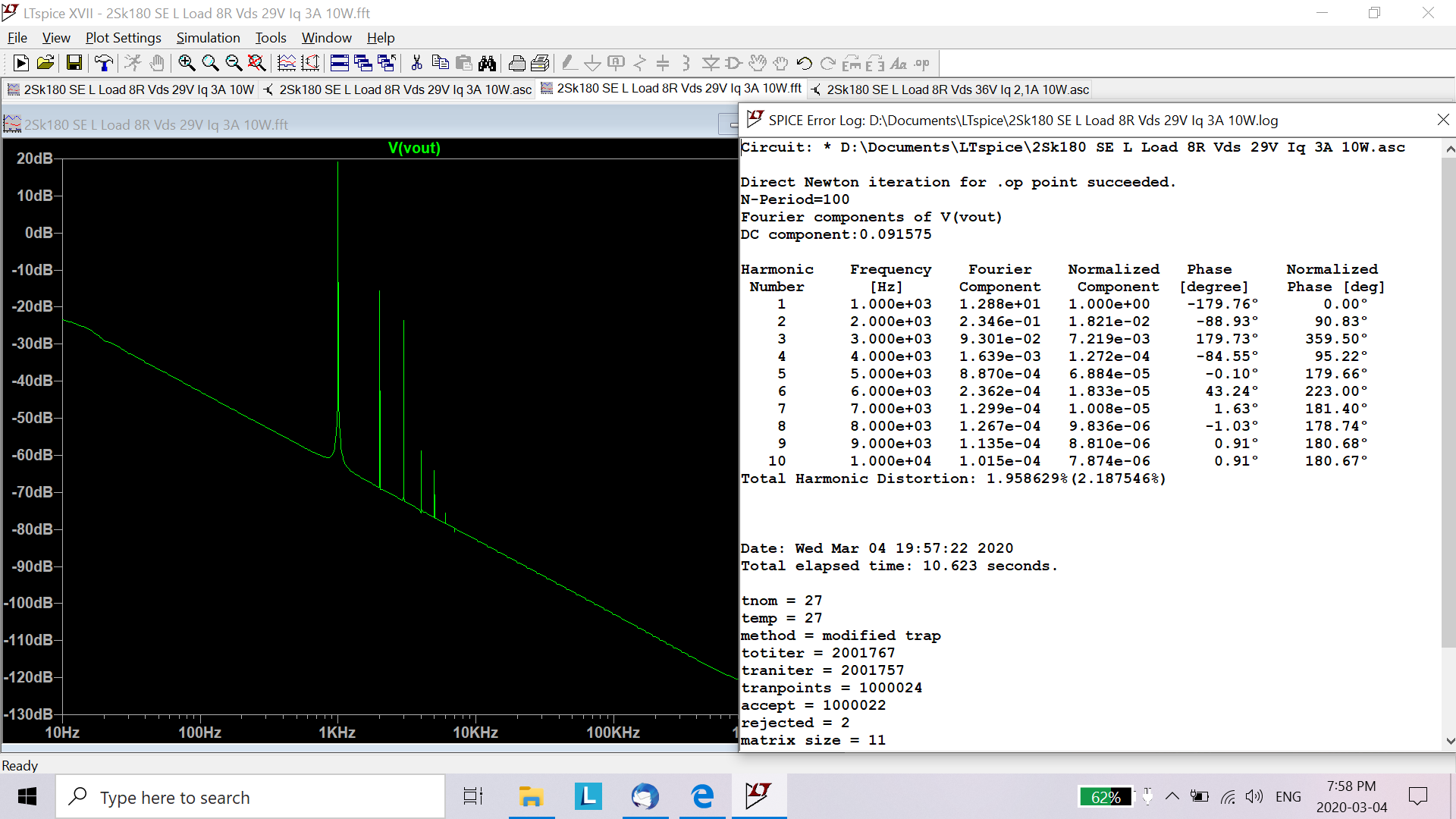

I bought two 2SK180Ds yesterday from an ebay merchant, and I was actually thinking about using them single ended with choke loading. I just can't stop.🙂
I have a Hammond 193V loaded 2SJ28 L'Amp that I am thinking of repurposing for the 2SK180Ds. I will need a new power transformer and more heatsinking but I will be able to use the rest of the parts.
I did some LTSpice simulations, trying MR's operating point from his light bulb L'Amp (Vds 36V Iq 2.1A), and also after some playing around, Vds 29V and Iq 3.0A.
When I get my 2SK280Ds, I will re-rig the amp and do some experimenting with operating points. I have a variac so I will be able to rewire the existing transformer for higher voltage and use the variac to adjust the Vds and do some experimenting.
The LTSpice results for MR's resistive load operation point used in choke loading at 10W had 3rd harmonic slightly higher than the 2nd harmonic, and also had a lot of higher order harmonics. The other operating point gave THD that was a bit higher but the 2nd harmonic was dominant.
In-situ measurements will be done when I get the 2SK180Ds and hopefully I will then be able to decide on Vds and Iq.
