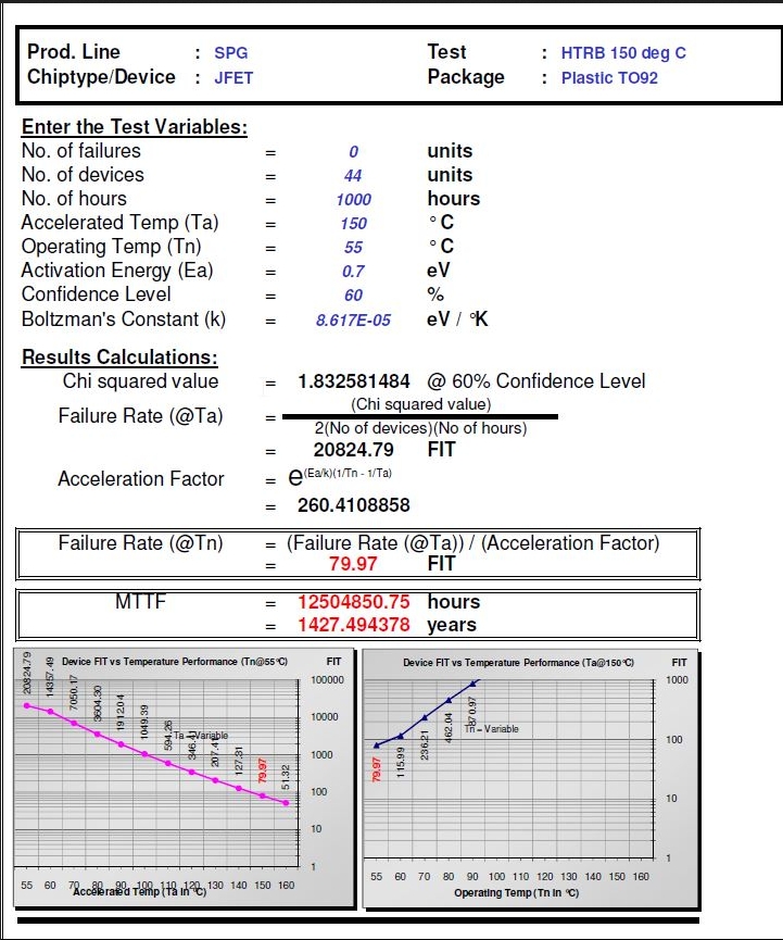

maybe some you remember a discussion concerning semiconductor reliability relative to operating temperature
i sent e-mail to a few manufacturers for j111 jfet and fairchild responded to me with the attached.
maybe there is a chance it may contribute to the subject.
this link may also help to understand
http://www.hp.woodshot.com/hprfhelp/4_downld/products/xrs/at41511_r.pdf
