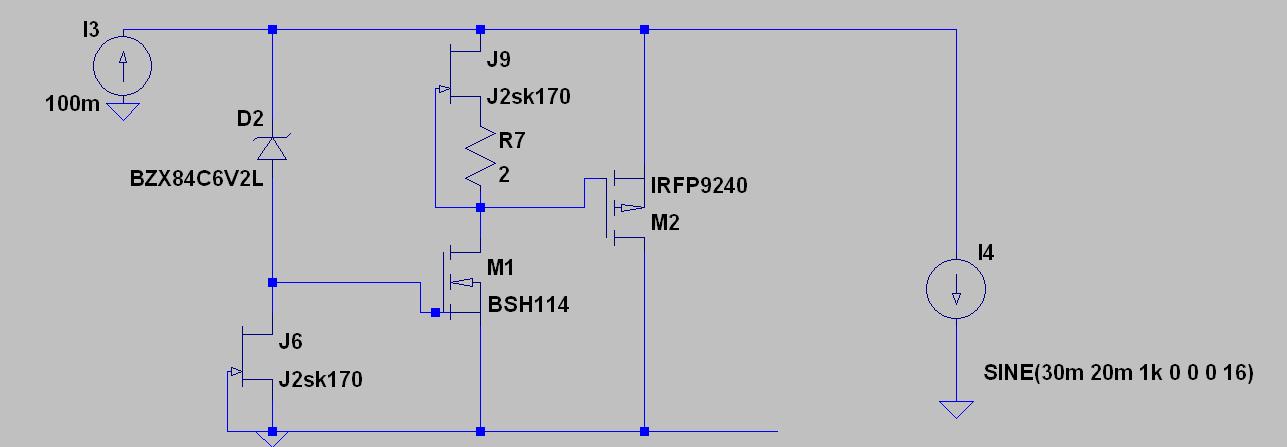

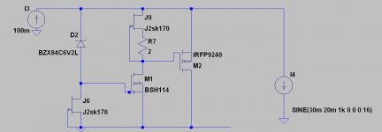

is something like this a good idea?
mosfet instead of bjt...
D2, M1, noisier stuff.is something like this a good idea?

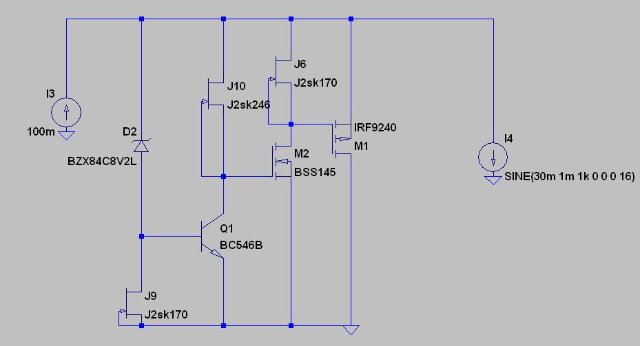

zener is for simplicity, i never thought about using it...
as for mosfet:
m1 much noisier?
thought bjts were noisier...
i thought j6 on my schematic would sink a bit of noise...?
not sure about that one lol...
That one's better. MOSFET is the noisy 1/f guy. Seen any phono stage with MOSFET input stage?

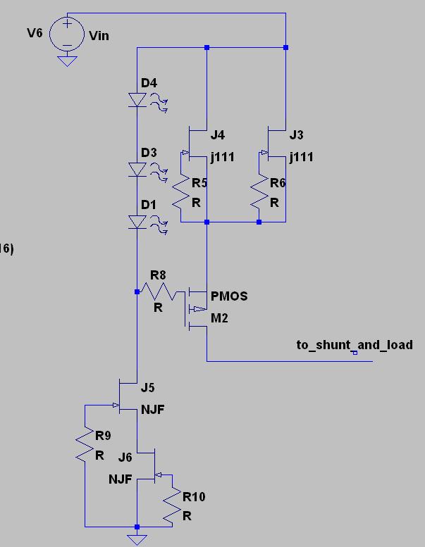

you want to try a b1 style buffer if i remember correctly?
how is that for a ccs for around 100ma?

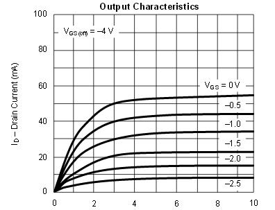

graph is j111...
graph is j111...
Pushing J111s thermally maybe. (J3,4).
P.S. VfLeds-PMOSvgs must be > J11s Vgs (off) so to work as CCS well.
yes...one would have to watch for a nice Vds without overheating...
still i like the idea very much and will probably be my next regulator CCS build
