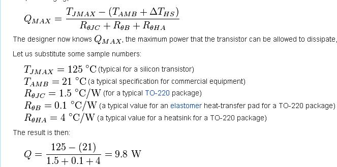

is that surface temperature of jfet, or nodes of actual circuit temperature? kelvin or celsius?
at 1 W, the jfet was barely warm at all...but 1.2W was getting on warmy-hot side
1.8W my thumb felt a bit on the uncomforble-pain side.
fairchild j111:
-max temp:150 degree celsius
-R theta junction to case:125 Cel/W
-case temp estimate 40 Cel
(150-40)/125=a bit less than a Watt recommended as maximum power
1 watt gives core temp of 165 Celsius.
picture is from Wiki

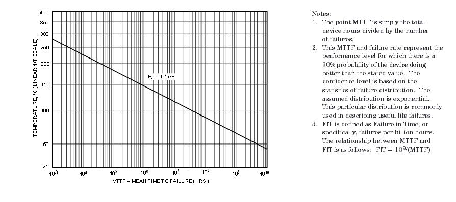

Looks like ~20Cdegrees to ~30Cdegrees cooler/hotter results in ~ 4times longer life.
In the middle of the plot, a reduction from 150°C to 100°C gives ~ 50times longer life. A further reduction from 100°C to 60°C gives ~100times longer life.
Running at 60°C, instead of 150°C gives ~4000times longer life !
This will vary a lot depending on plastic package, or metal package.
Salas,
I think your "double" is quite misleading.
Especially in view of the post that followed asking C or K
A more often seen estimation for longevity is:
double the life for a 10Cdegrees reduction on operating temperature.
An old military applications engineer told me that a long ago for finished products. If its too rough, then it is, but that is what he told me. "Each time the operating temperature doubles son, products come back for service four times sooner."
Depends on what he had in mind, if he meant a doubling due to natural ambient temperature, say field equipment moved form a moderate to a hot country military base, then 15-20C to 30-35C is ~two times ten dif, roughly four times less life expectancy.
"The life of an electronic device is directly related to its operating temperature. Each 10°C (18°F) temperature rise reduces component life by 50%*. Conversely, each 10°C (18°F) temperature reduction increases component life by 100%"
Temperature vs Reliability | FirePower Technology
But what is a sensibly reliable threshold? Maybe no more than 80C junction temperature in max ambient is logical.
"Typically a problem in avionics and military equipment, excessive heat can wreck havoc in an electrical system. Component parameter values usually vary with temperature and it is important not to exceed the manufacture’s temperature range. Above such temperatures, parts are no longer guaranteed to be within specification. Typically, this can range from 80C to 150C"
