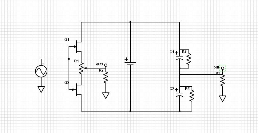

actually i did tried it directly to my sennheiser 52 ohm-ish and signature was AWESOME...even though noise may have hampered the sound
what is nice with phase split is that you can trim resistor values to achieve desired signature...

How high an offset? Hearing hiss on headphones might be a sign its non suitable for line pre though.
i used the attached
You did not use the bottom one as a CCS to be b1 like? G+S I mean.
with this topology, you have zero offset...at least it is what i measured.
but VDS can vary
Voltage supply= Vds top bsp+lower bsp
yes the bottom one is a ccs G+S connected

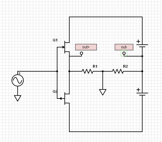

The schematic is misleading, that is why I asked.
sorry wrong schematic... i m a bit tired 🙂
so...replace jfets by b1 style bsp129 and r3 by ZERO ohm
to make a simple buffer

Not sure I got your schematic explanations 100% but when I will breadboard those BSPs I have around I will try a couple of configs, FFT also, and I will let you know my findings.
you mean what is connected to what?
OR how it could possibly work,how i can get relatively good sound from it?
you want me to redraw exatly how i soldered it?
anyway...i m enthusiatic to know your findings 🙂
Better redraw exactly what you soldered and how tomorrow when not tired and I will save it to test it for you at a point.
no garanteed i will get better.
