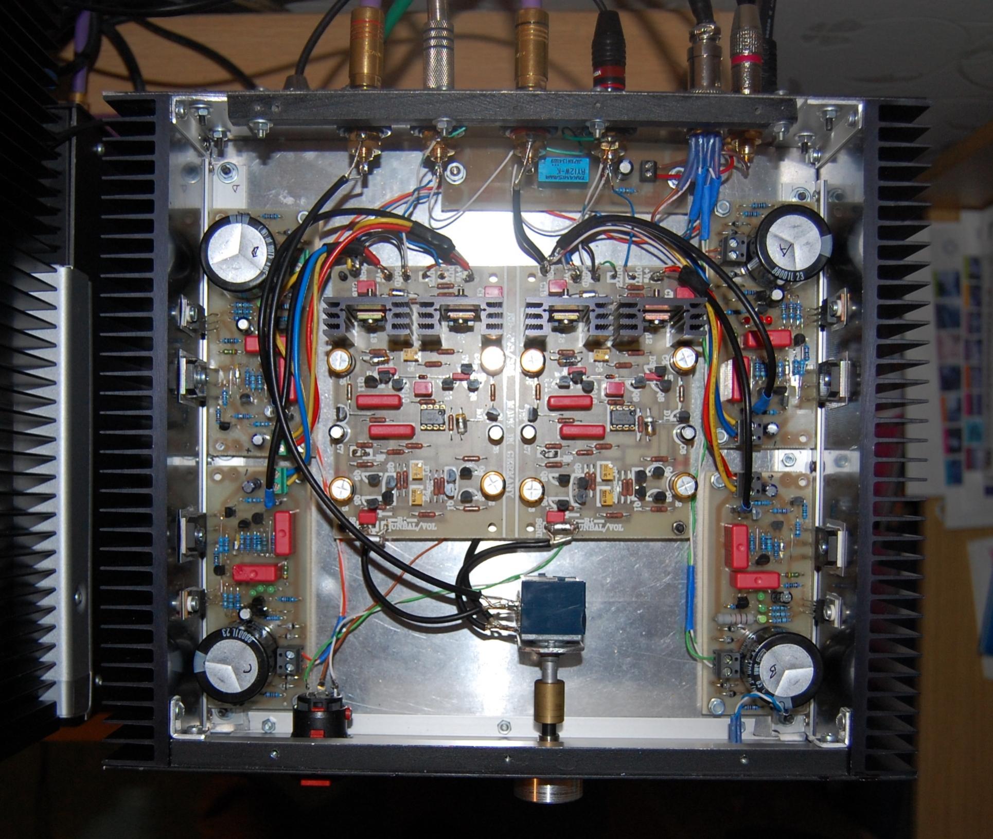

I have been using Salas original version regulator since 2010. The preamp itself is original kit EB 325 from Erno Borbely. I was very satisfied with the sound. When I was doing listening tests does not matter the blind test or not, it was allways my prefered preamp.
This year I decided to build up v1.2 version of the reg. I have made dual mono preamp, so 2x Salas modules for each channel. Current sources are 300 mA each, preamp channels are asking for some 80 mA each. Two transformers are in another box and since I am not using another source than CD player Audiolab 8200CD, I decided not to use the switch selector. The result of my work is on attached picture.
After listening test with the new regs it seems to be a bit better, esecially the sound is more full. The details and overall character of the sound it is still the same as with the previous Salas reg (not dual mono). I am very happy that I was able to finish this work with such a success. Thank you Salas for the great work you have done.

Looking good. Congrats & Merry Christmas.
Ladislav did you used other regulators?
I did not try other regulators together with EB 3325 preamp. I was trying other regs in my previous projects e.g. Balzen from NP, or Dispre from PMA. I consider Salas + EB combination best. Even comparing to other commercial products this is really good choice.

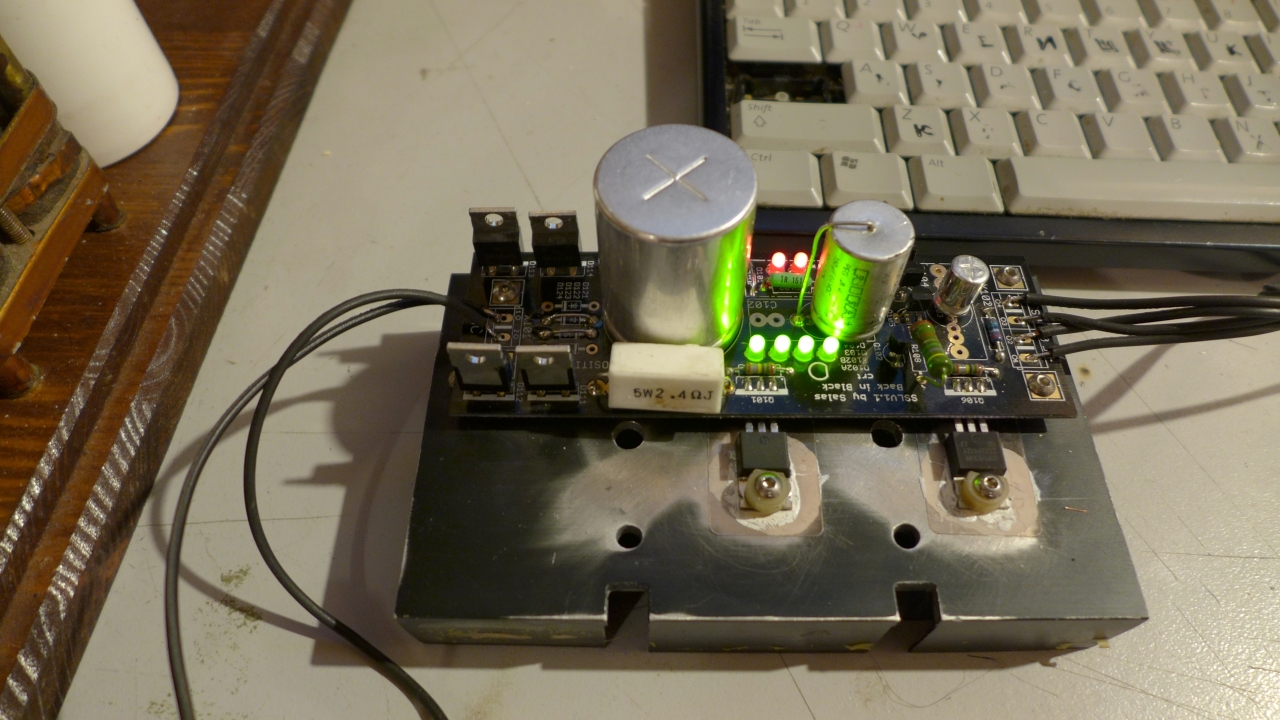

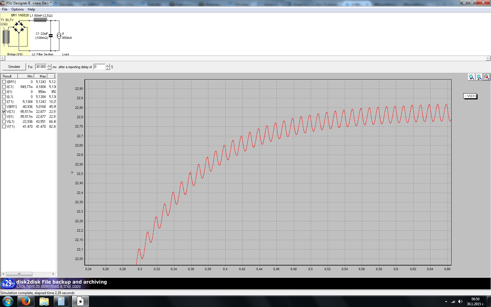

Some pics of working 8,5V/0,95A positive board with no oscillations. Choke input power supply. The scope photo shows the ripple on the first capacitor, after the choke.
The board is made of:
C101 - Kemet 2200 uF
C102 - Rifa PEG 150uF
C104 - Elna silmic 2 47 uF
SK117 with Ids between 8 and 12mA
Philips and Draloric NOS MF resistors
R1 cheap wirewound (to upgrade soon)
diode bridge not very hi-fi for now - P600M
