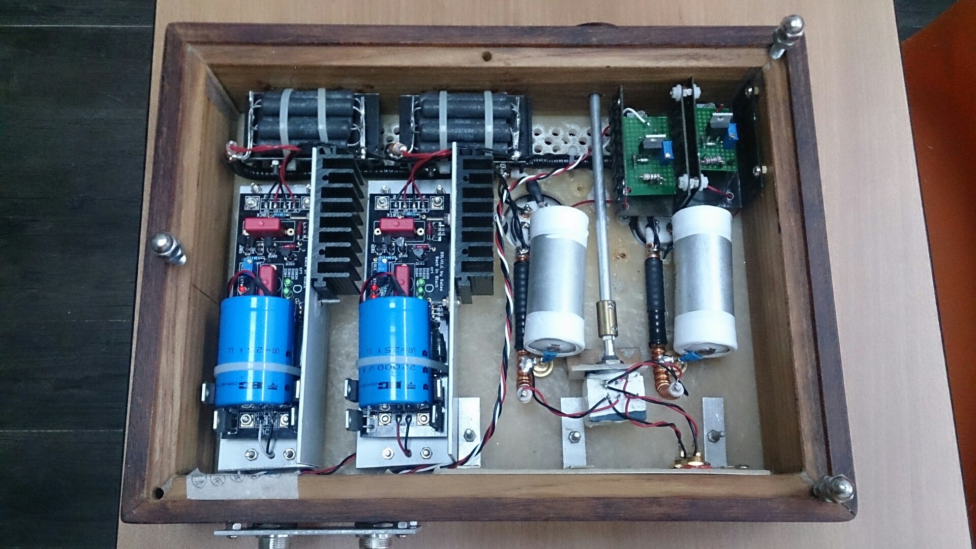

With helps from Salas, I am using the SSLV 1.1 to filament bias my 26 line amp (DN2540 CCS loaded and telfon cap output).
The board is super stable in this application.
Heat from semi's manageable, quite a lot of heat from the rectifiers though, will try to move the rectifiers to the PSU box to share some heat there.
This 26 amp is super quiet!!!
Soundstage of this 26 amp is super wide, but not much depth though, and the separation of instruments is not super. The vocal (especially female vocal) from my 10 line amp is still more super than this 26 yet.
Any suggestions to improve the performance of this amp with the SSLV1.1 board in this application will be most welcome and will be tried in the very near future.
(please PM me if you think the suggestion may be out of topic here)

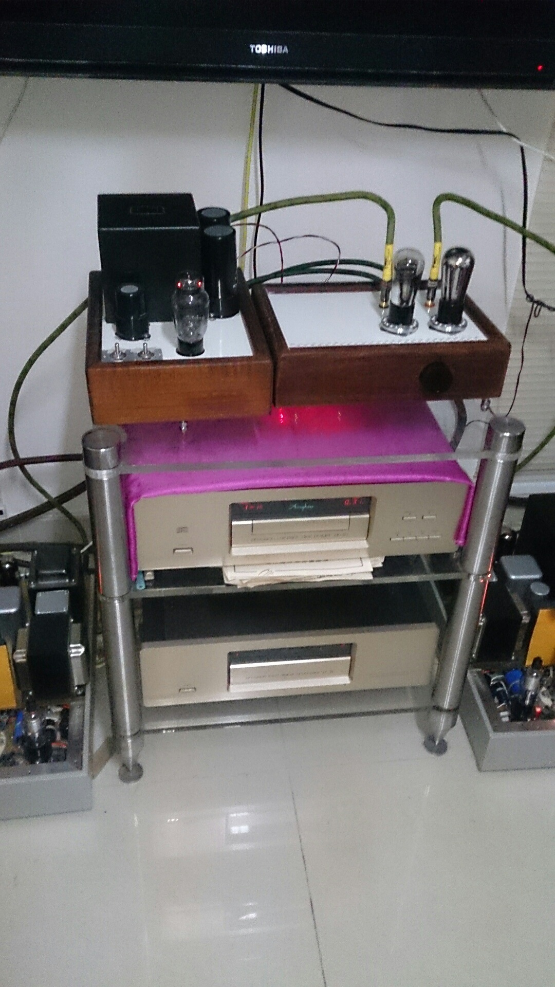

Photos show 1) the pair of board inside the 26 amp, and 2) the 26 amp at my friend's place.

You could try and put small to-220 heatsinks on the rectifies diodes.
Regarding #26 sound, you could try some coke bottle tubes. Sylvanias are nice.
