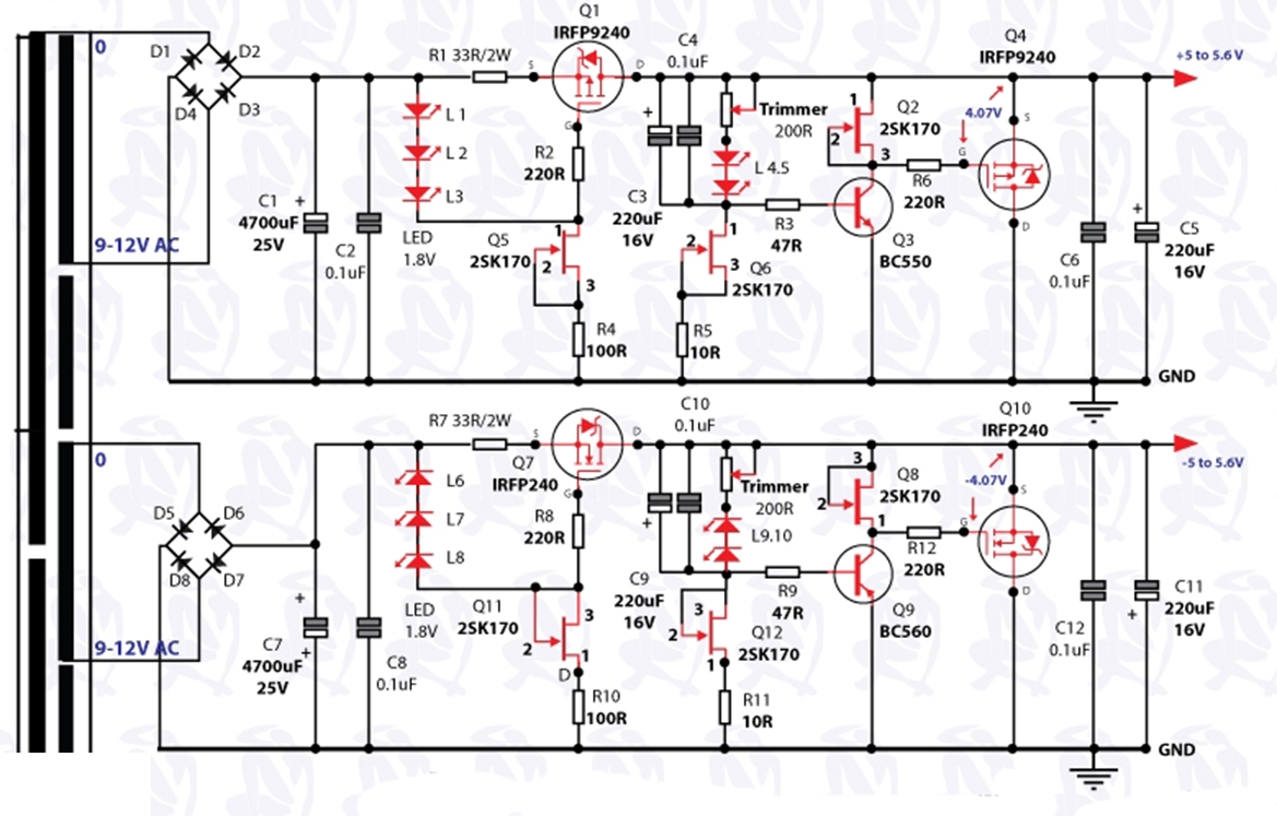

Probably should do more reading but if someone could tell me where to find a BOM and preferably a build guide for this version :
http://www.diyaudio.com/forums/atta...tage-shunt-regulator-salas-symetric-5v-2-.jpg
Looking to make a +/-5V regulator @ 100ma running off 12V or 7V AC CT transformer. It needs to be a significant upgrade on a 7805/7905.
Make sslv1.1 bib or some of its predecessors (bit worse) but give at least 7VDC Vin-Vout drop.
Sorry here it is from post xxx. Thanks Salas. I will do more research on sslv1.1 bib.
No reason to make that, its older plus it has precarious bypassing in that drawing. See the builds thread of 1.1 and Reflektor-D. R-D you can stack symmetrically with virtual ground.
