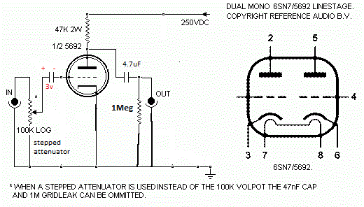

It should adjust and you can't, or there is no way to adjust as it is now? i.e. the circuit could use/uses a bias trimmer/pot.
Maybe you use them in series? See what happens if you put another 1.5V cell in series to go -4.5V
Yes I use them in series to get -3V, good idea, I will try later, now time to have lunch, today italian food: spaghetti with tomate & meat.
If I were you I would have set the battery between the pot and ground instead (given that the devise feeding it has an output cap). The fewer batterys you serial the higher the tube bias current, which you best measure over 47K.
The stepped attenuator (ladder always the source sess 100K) is in other box, the batteries are in series between the pot & the grid.
I'm using two 1,5V battery in series
Salas I adjusted SSHV2 CCS for 35mA, is enough?
35-(8+8)=19mA spare. Alright, almost 20 as we use for minimum. If its cool enough now, give 40.
