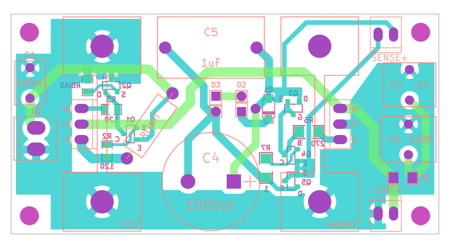

Hi folks,
I've laid out a 70x36mm SSLV 1.1 PCB for 5V@20-40mA duty (~200mA CCS). Would appreciate another pair of eyes on it. I had to settle for 4.7uF MKS2 + 100nF MKP1837 for the Zobel due to size limits. The references are bypassed with 1uF MKP416.
Thanks.
Thanks.
The loop areas aren't tight and long distance bypassing isn't productive, but it should work electrically. As for correct routing I am not sure, can't be following it in detail with a fast look. Just check everything twice.
P.S. Where are the Leds for CCS? Using one Vbe transitor current control voltage?
