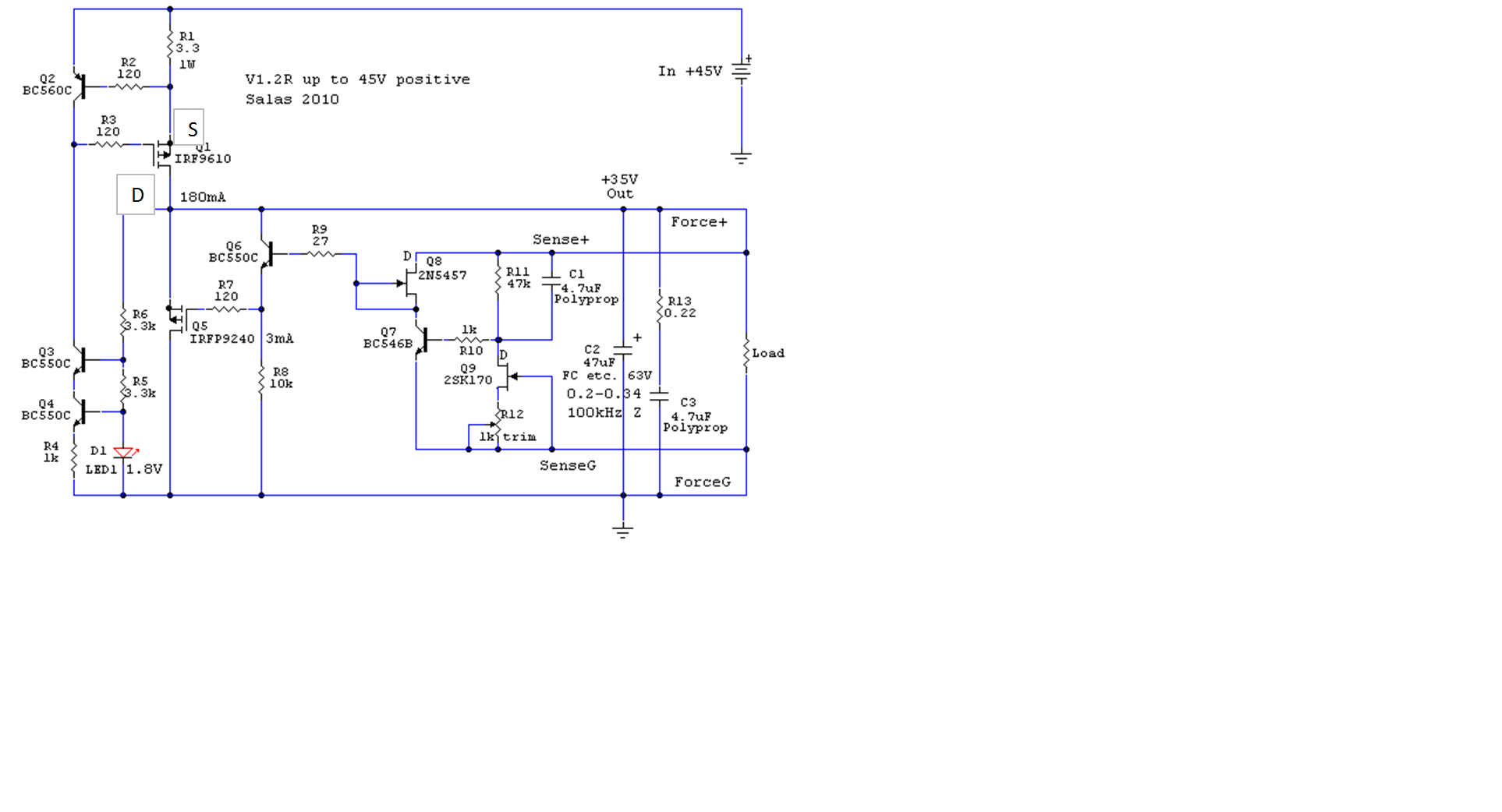

Hello Salas
I am revisiting the V12R shunt because I do know it's potential and would like to push it a little further.
The initial schematic is below and I would like to drop C2 (47uF EL).
I know the BiB and the folded shunt can both work perfectly without that output EL.
The différences I see are related with the resistor value in the output zobel that in the BiB is 1.2ohm and in the V12R is 0.22 ohm.
Can I take the V12R schematic, drop the output EL and raise the zobel resistor to 1.2ohm and expect it to work without oscilations ?
