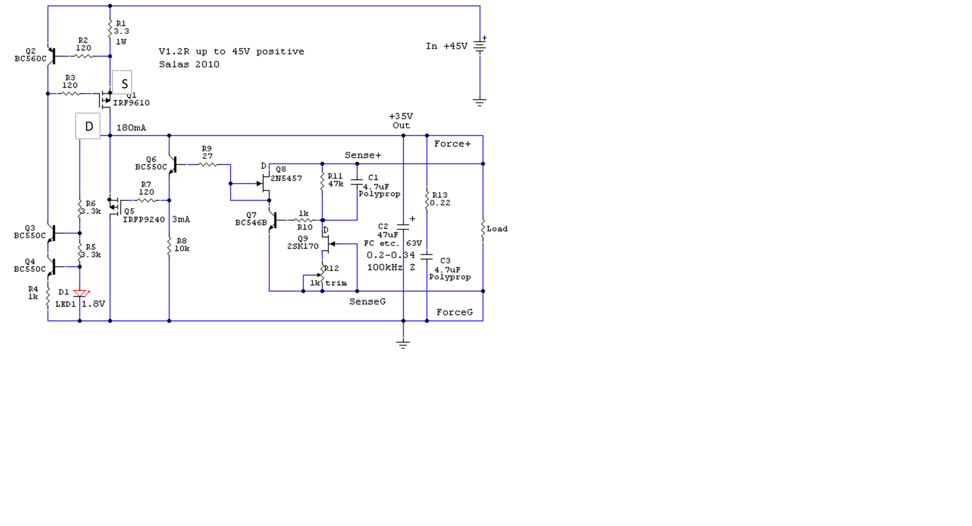

BTW---does the last posted regulator schematic have a starting problem? I conjectured, looking at it, that it might, and simulations seem to confirm that.

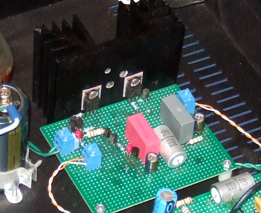

I remember that the 1.2 Version (which has the same cascode tail CCS governed by 1 Vbe/R current set as the V1.2R) prototype (green matrix board) needed a compact layout for the whole CCS portion of the reg not to fail starting. http://www.diyaudio.com/forums/powe...-voltage-shunt-regulator-190.html#post2103488

You see the issue though? I can't believe it pertains to delay in a layout. In the others the JFETs pull current immediately, which then turns on the PMOS until the Vbe of the local transistor Q2 turns on to limit the current. With the bipolars and LED, fed from the +35V output, once up it works fine. But otherwise the bipolars don't turn on without something to bring up the +35V output at least a little, or something to turn on Q3 and Q4. You could provide a voltage divider from the +45V that goes to the base of Q3 through a diode, which then as the +35V comes up, gets reversed-biased and therefore out of the circuit, and get your advantage of improved PSRR. It should only take a few volts, although the impedance of the added divider will need to account for the loading of the 3.3k's.I remember that the 1.2 Version (which has the same cascode tail CCS governed by 1 Vbe/R current set as the V1.2R) prototype (green matrix board) needed a compact layout for the whole CCS portion of the reg not to fail starting. http://www.diyaudio.com/forums/powe...-voltage-shunt-regulator-190.html#post2103488

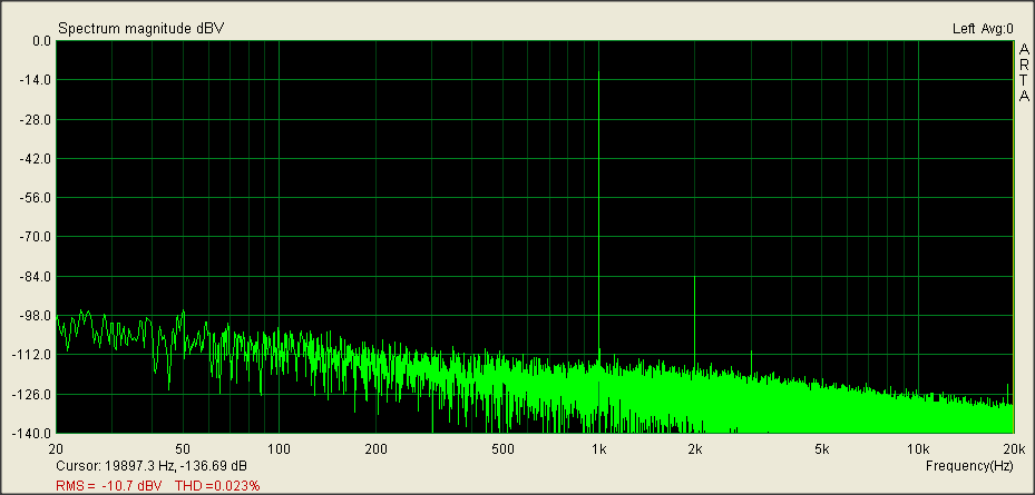

Here is a later photo I just found of how it got closer together. Never ever missing a start up. Since that was converted to 1.2R also and we had its noise analysis discussed you can see an FFT (1V=0dB) of an FSP (Folded cascode input stage single ended no loop feedback JFET phono at LMC 63dB gain) it powers (one PSU for both channels).

There was something like that we had done with a diode also back then, or a zener, can't remember exactly how now, but interestingly when I brought everything input CCS very close together it never failed to start again in the prototype. Still works in that phono build.

Further reflection and modeling, I see how it comes up now: with the shunt section low, thus no bias on the voltage divider and LED, the transistors in the current source still have collector leakage (my model says something in the vicinity of 50pA). Only if the PNP has a good deal larger amount (unlikely, particularly at an initial low voltage) will it dominate the determination of the voltage at the gate of the PMOS, and have it be a small magnitude gate-source voltage, thus keeping it off. But almost surely the NPN leakage and the PNP leakage will start to reach an equilibrium at that junction of collectors and PMOS gate, which will also, almost surely, be a larger magnitude than the required gate-source PMOS threshold. So PMOS will turn on, and then everything comes up. Initially, for a short time the shunt regulator output sits at around 3V while the 4.7uF feedback cap charges, but then the shunt reg voltage ramps up to the desired output voltage.
Good explanation. There was a faint glimpse of light in the CCS Led when the layout was wider and once in a few power ups it did not start but a touch with a DMM probe to Q1 could kickstart it.
