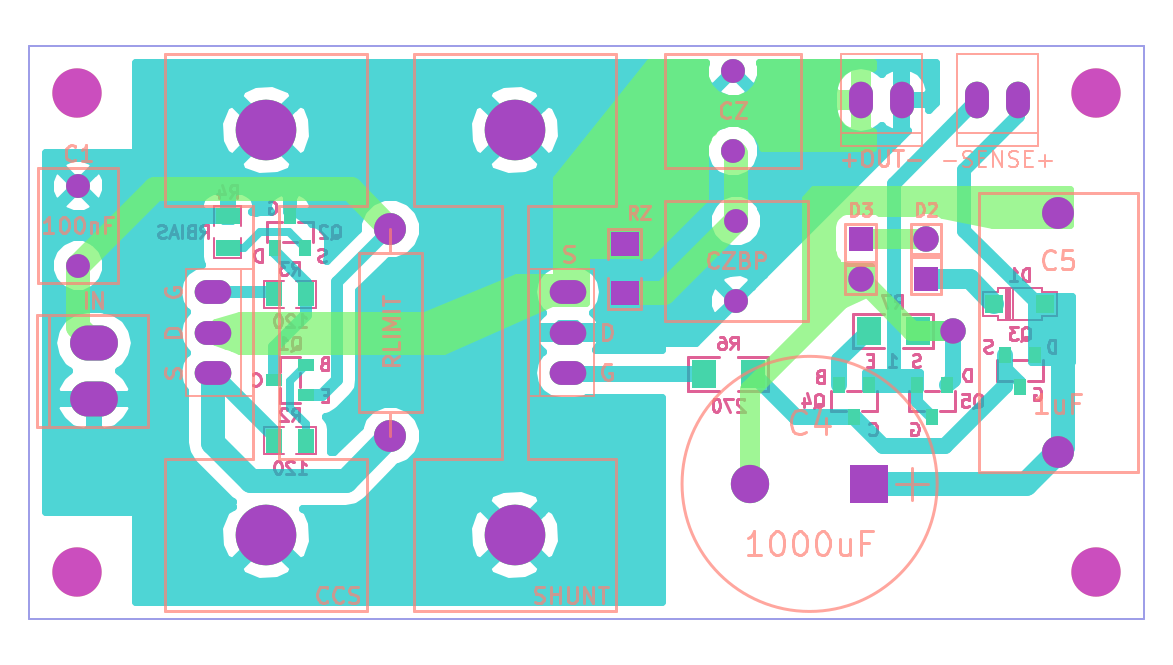

The loop areas aren't tight and long distance bypassing isn't productive, but it should work electrically. As for correct routing I am not sure, can't be following it in detail with a fast look. Just check everything twice.
P.S. Where are the Leds for CCS? Using one Vbe transitor current control voltage?
Thanks for the input. Do you mean that the trace between the two MOSFETs is too long? Yes, I've borrowed the CCS section from the Reflektor, as it is more compact.
Sense and force pairs could be running closer in general having narrower loop area. Q1 under RLIMIT is not a thermally good place also.
OK, would this be considered an improvement?
Looks better now, yes. Are you using a Zener reference?
No, D1 is a 1N4148, D2 and D3 are WP2773 LEDs.
Better use green ones because the current won't be much in the ref.
That's the plan. Can't the current be upped by selecting a Q303 with higher Idss though?
Up to a point that it must not have Vgs(off)>0.6V. Loses much Idss in circuit's VDS=Vbe. Can always replace the diode with a proper resistor if it will end up <>5V out.
Got it. Thanks for the tips, Salas!

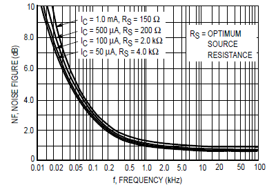

Salas, how critical is the noise figure of the transistors used in the Reflektor's current mirror? I'm tempted to try http://www.nxp.com/documents/data_sheet/PMP5201V_G_Y.pdf to avoid matching and thermal coupling (not to mention the smaller package), which looks a lot like BC856B, except for higher typical NF@1Khz (3.1 vs 2dB). Can't seem to find the noise data on modern 2N4403/MMBT4403, an old Motorola datasheet specifies ~2dB.
2N4403 are circa 50 Ohm Rbb' low noise transistors. Although not champions, certainly very good for cheap & common to get. A BC550 has triple the base spreading resistance. As for how critical in the reg, well, they are the main non filtered contributors. Nothing is left to chance in this apparently very simple Reflektor.
