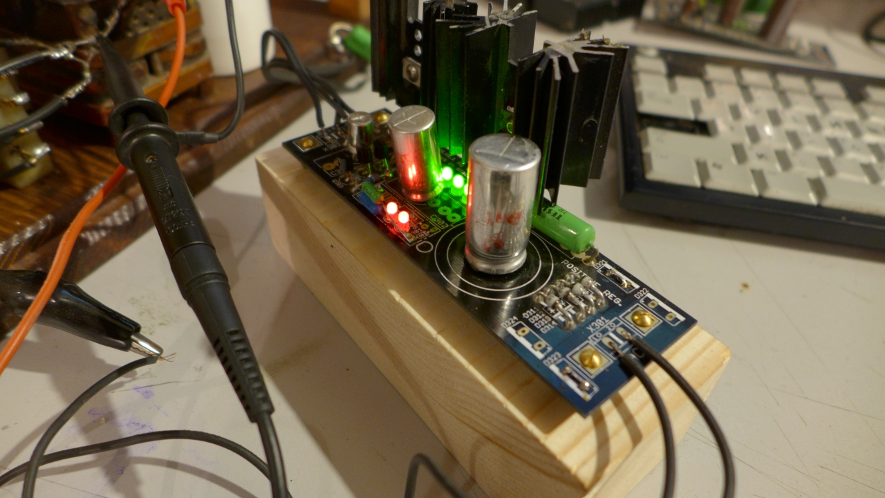

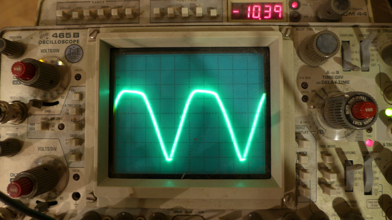

The scope probe is connected parallel to the choke here (voltage ripple on the choke). This is the BJT regulator for the digital 5V.

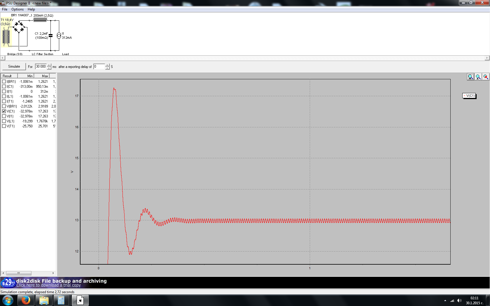

The right pic shows approx 75mVpp of ripple in the psud2 simulation.
How does that compare to the measured ripple of the actual PSU?
What is the ripple value in the middle pic?
Note how "rounded" the bottom of the ripple is. This is the effect of more HF filtering due to the choke/Inductor.

The LF oscillation is poor and in my view needs attention.
By the way, is high Q (ringing at start up) LC PSU filter harmful for sonics, considering, the shunt draws a constant current?
I don't like the overvoltage on start up.Better damp it with some resistance in series to the choke I would think.
I dampened the choke with 10R in series. There is no further ringing now.
Andrew, the scope readings match the PSUD simulation with 90mV p-p ripple.
Regards, Alexander.
Regards, Alexander.
That's good agreement with what I could read off your Psud2 pic............... the scope readings match the PSUD simulation with 90mV p-p ripple.........
It's nice when sim = actual.

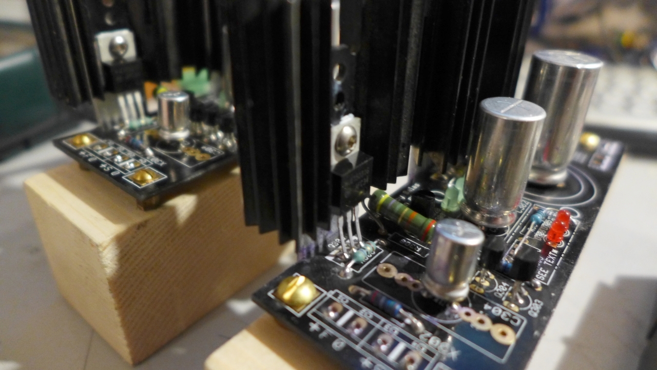

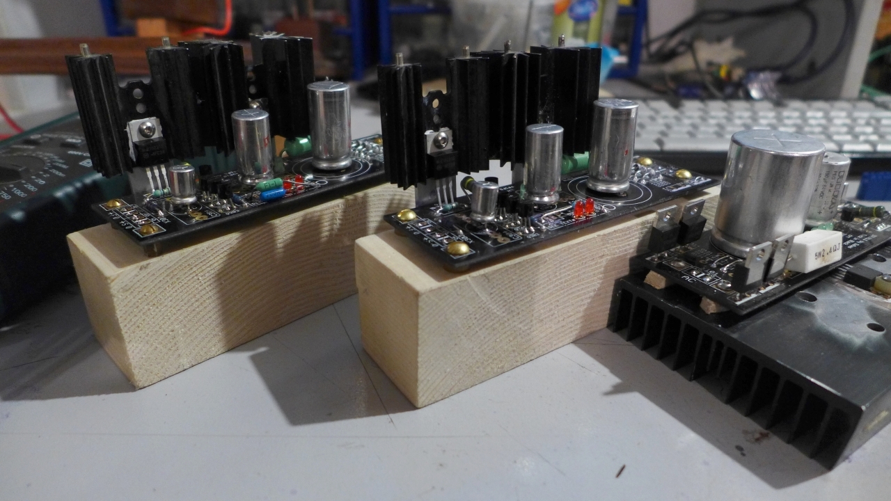

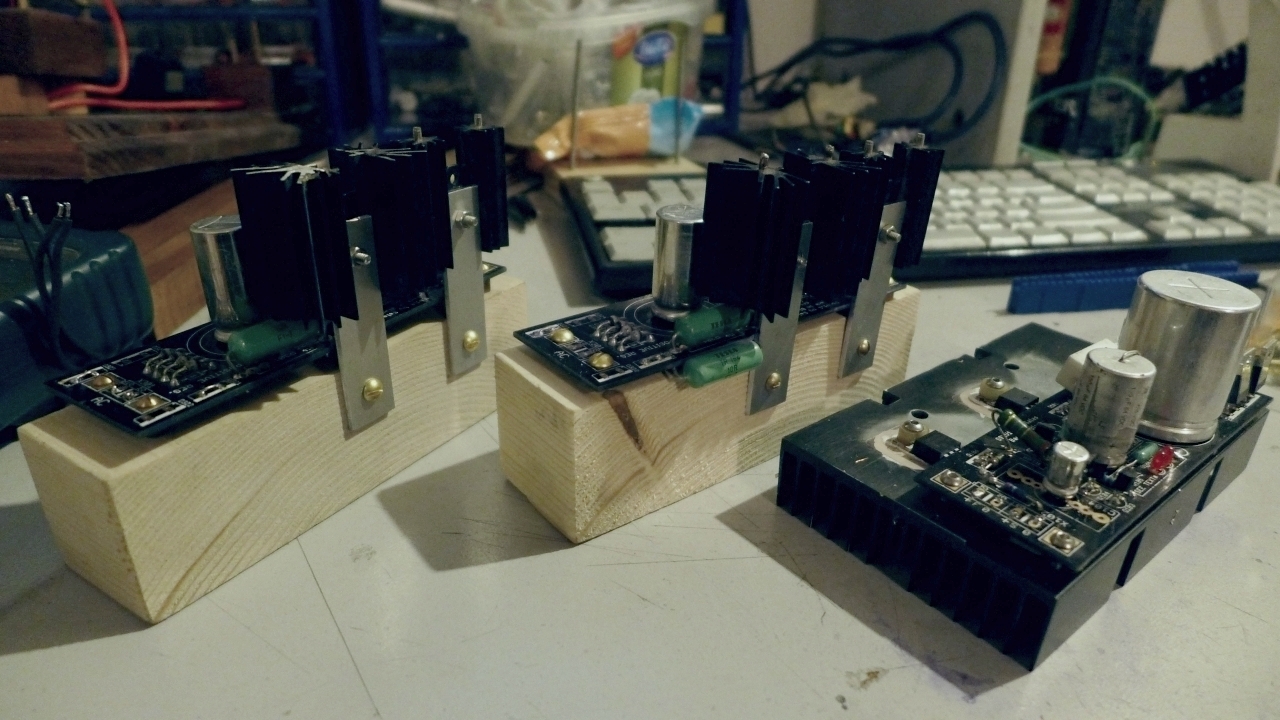

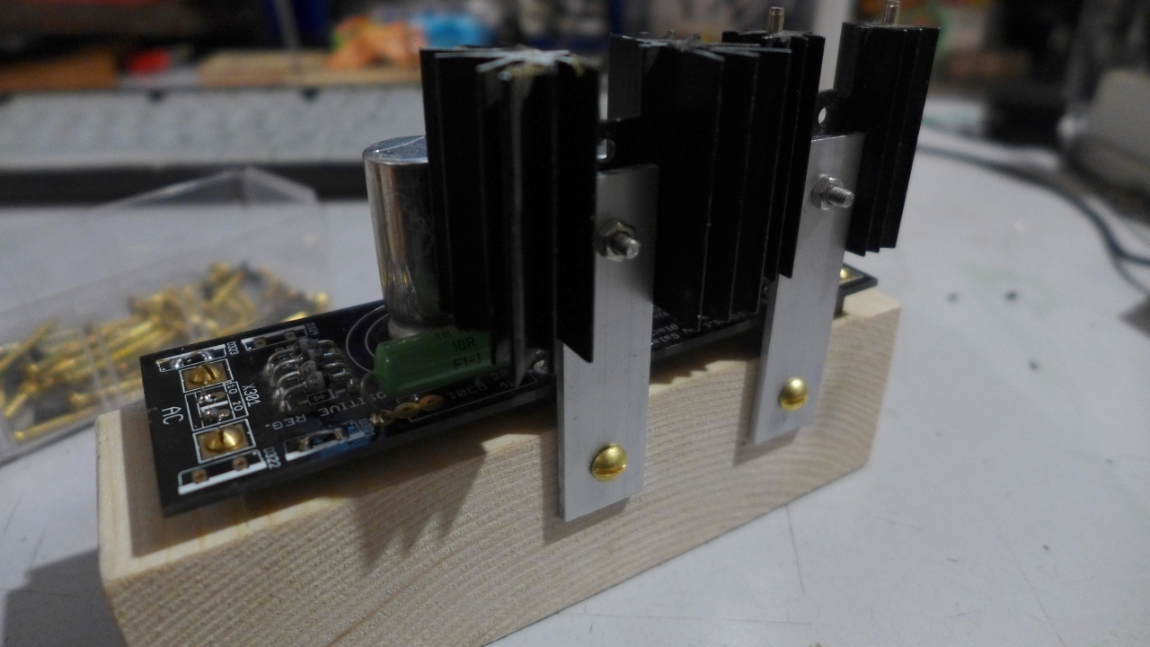

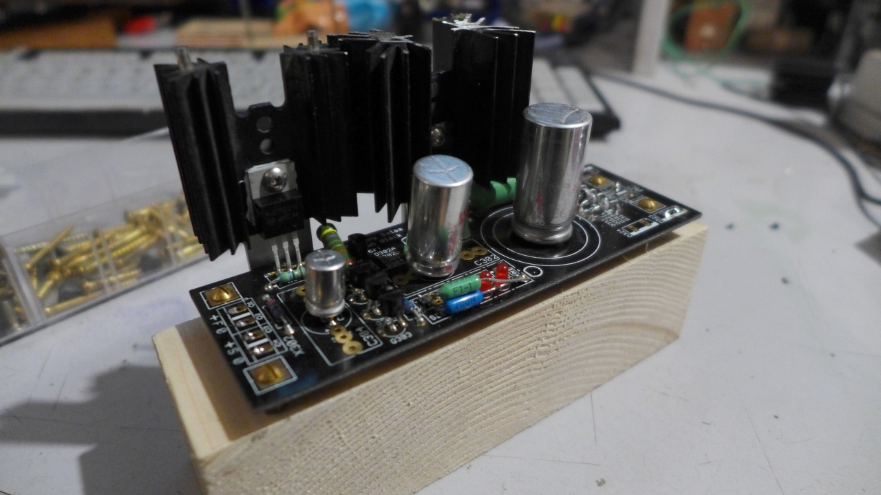

Here are some photos:
I will then try the Zobel after building the DAC and listen a bit. My system's a bit on the sleep side, it needs some kick.
Did you buy those capacitors without any insulation/damping/thermal conductor?
Or did you remove the coating yourself?
Put the wrap back on.
