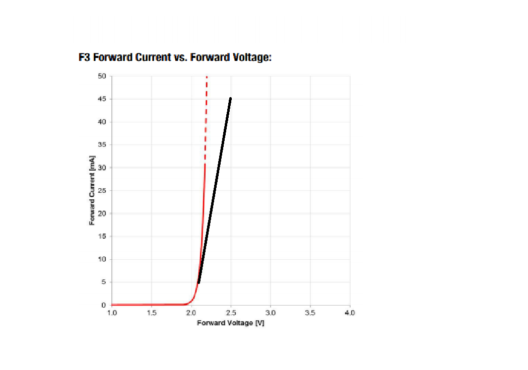

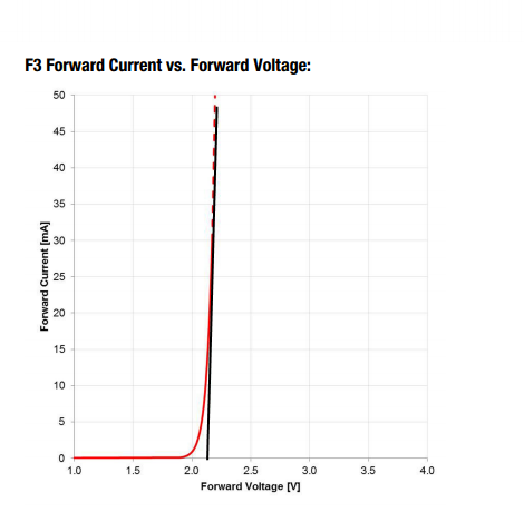

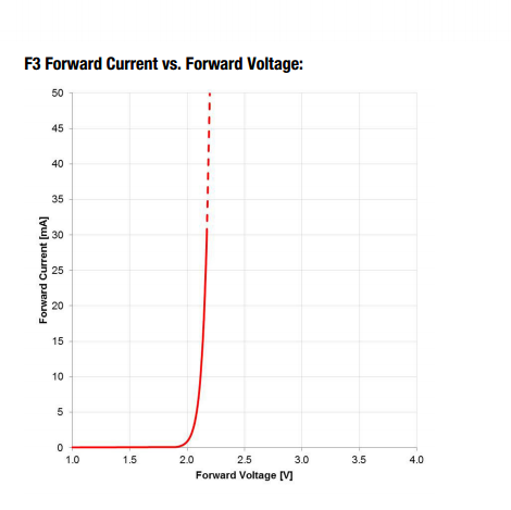

Is it possible to estimate the dynamic impedance of a led by looking at the current/voltage chart in the datasheet?
I found a round 5mm led with a rather good looking graph: WURTH ELEKTRONIK 151051RS11000
http://katalog.we-online.de/led/datasheet/151051RS11000.pdf
The forward voltage of this led is 2,1V. I was thinking that 3 chains of 5 leds could work; 10,5-10,75 volts and ~25-27mA per chain.
Thanks! Then I guess this led is ok with more current per led. At 25mA the tangent line is much steeper and the impedance is close to 2,5 ohm. Put 5 in series to get 12,5 ohm and 3 chains in parallel to get to ~4,2 ohm.

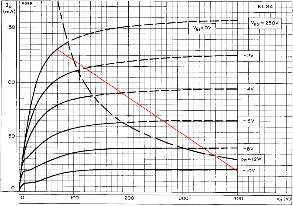

Now after browsing trough more of this thread I have found out that it's possible to run the EL84 plates up to >400 volts as long as the screen is below 300 and dissipation within limits. Now with a 400 volt B+ it could work to run both stages from the same transformer. Right?
I realize that a higher B+ will make the screen supply dissipate more and the voltage rating of the transistor may not be enough. Anything else to think about?
I usually build my projects in too small enclosures so it will be difficult to add another transformer later. 🙂
That's running them uncomfortably close to their limits. You might get away with it, but I wouldn't guarantee it.
Many thanks for the responses! I think I'm beginning to understand more of this now. This is a learning process for me. When the amp is overdriven a lot and the waveform approaches a squarewave the tubes will take turns pulling about 130mA. The Wurth leds I was looking at are rated for 30mA continuous so 3 chains of leds can indeed bee too little. At least 5 chains would be better.
Also I have been looking at the EL84 datasheets and drawing loadlines. If I have 400V B+ it seems like the output transformer needs to be 10-12k. In the picture below I have plotted a 3k loadline (=12k transformer). Most of the load line is above maximum dissipation but the operating point is at only 20mA so I guess it should be fine...
