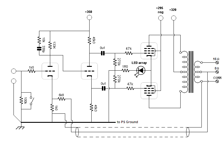

I've got a more complete write-up appearing in Bas Horneman's diy magazine, but wanted to put up some schematics for those who want to get a head start. It's easy to build, sounds great, and is a good answer for the common question, "Does anyone know a good 15W amp I can build...?"
First, the basic signal circuitry. Input stage is ECC81 (preferably JJ). Output stage is EL84 (again, JJ is a good choice).

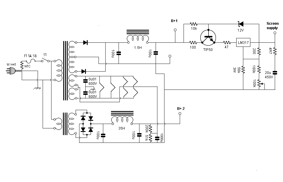

The power supply. B+1 is for the output stage and runs 300-350V. The regulator is for the screens (idle current adjustment) and runs from 250-300V. Adjust idle current to 85mA per EL84 pair. B+2 is for the driver stage and is 350-400V.

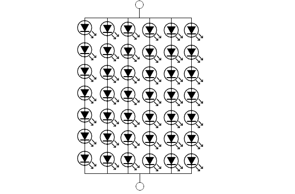

and for the more "creative & artistic" you could change a couple of the red led's for another colour and spell something out... EL 84 POWER
or whatever floats your boat. Why worry about a few milliamps one way or the other for the biasing, whats the worst that could happen?
It may stop working, distort, a runaway tube...
:devilr:
Ex-Moderator
Joined 2003
Even with 84 LEDs between the channels, you need five more LEDs to do the job. No great problem; use the extra five in the vertical line on the left character and power them from somewhere else...
Edit: Just realised I'd made an error - it actually needs eight extra LEDs. Perhaps the four either side of the left hand character?
