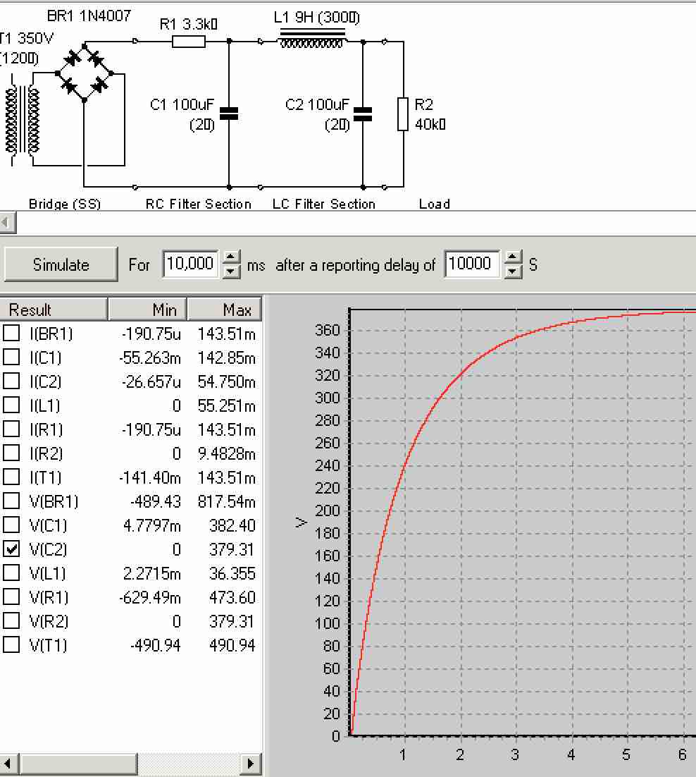

Hi All,
Yesterday I set up the 400 V supply to the 12AT7. 350 V Txr to Bridge to CLC (100 uf/9 H/100uf) into a 40K dummy load. I was getting 450 volts, so I put a 3300 ohm resistor in after the bridge. This brought the voltage down to 390.
My problem is when I model this in PSUD2, it takes 5 seconds to reach voltage. See attached photo. Is this OK, or what should I change.

That's absolutely no problem. You could even use a tube rectifier, if you're feeling particularly perverse. 😀
I should add that the main thing is to not have the screen come up to voltage before the plate does, otherwise, the screen will think it's a plate and start drawing excessive current. And there's no issue I can find with having the plate voltage higher than normal- in fact, I've found some advantage to that.
Sorry, SY, I don't follow. Are you talking about the first stage or the second? (Assume I'm Kofi's other brother Darryl.)
