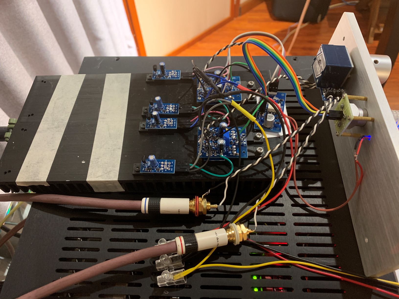

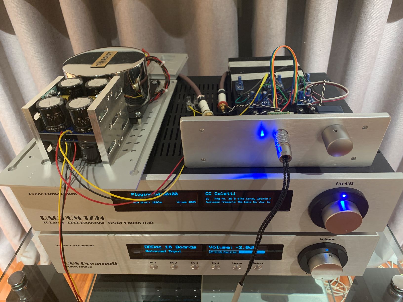

You should listen first, even with lab supply. 🙂
Patrick
I get something better than lab supply 😀
Everything works beautifully... really a piece of art!
I started to listen and the HD800 simply disappear... awesome! I can't imagine what will be the DAO!
Thanks Patrick to share with us your refined knowledge and... for your patience 🙂
Enrico

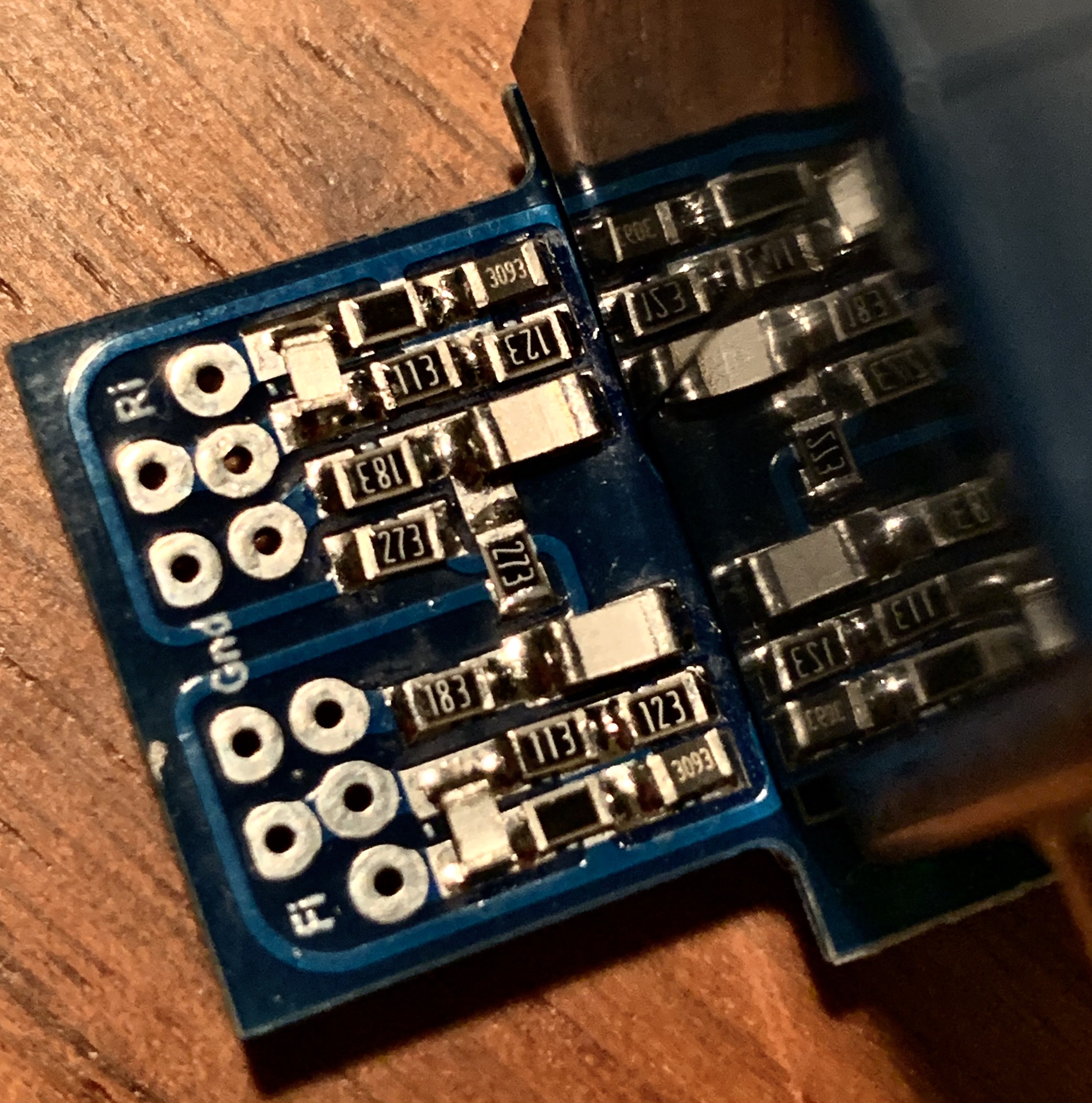

I‘m just about to finish the SLHPA from the 2nd GB. Can anybody please point me to a wiring diagram for the SMD Danyuk Cross Feed PCB V2. View attachment 818031
No diagram needed friend,
RCA input R/L to Ri / Li & Gnd, then take the outputs (middle pins) from under the pot/board pins to the amp inputs.

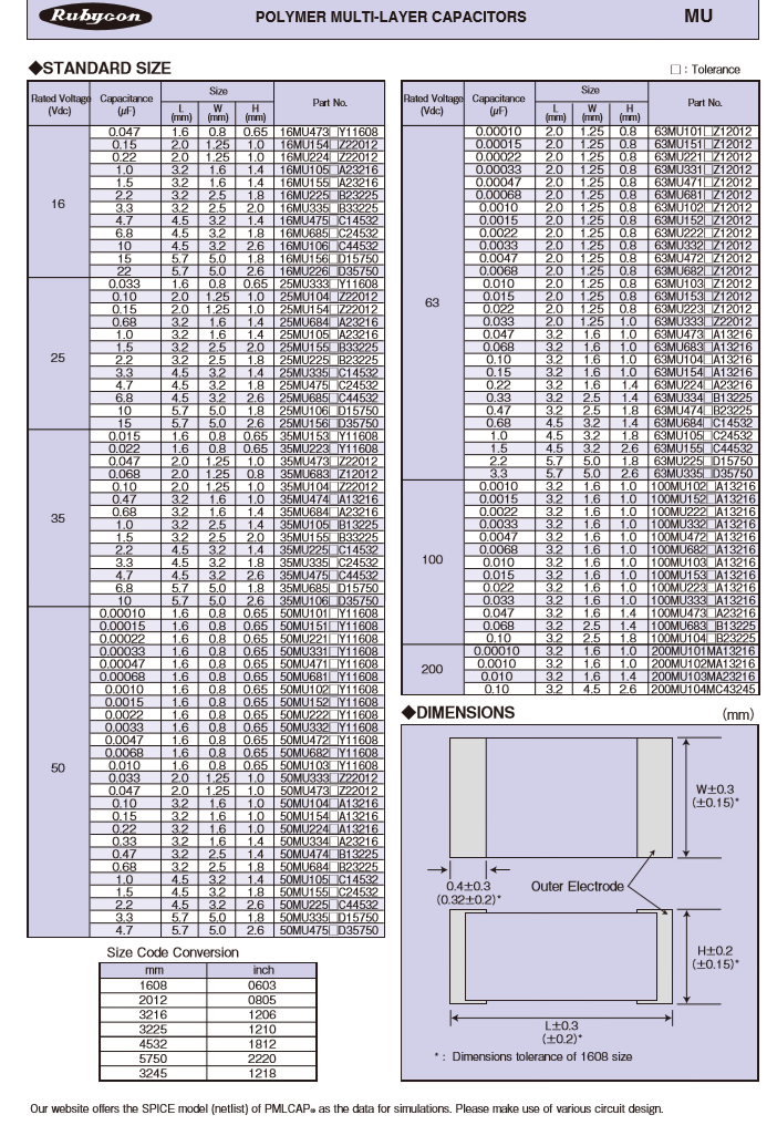

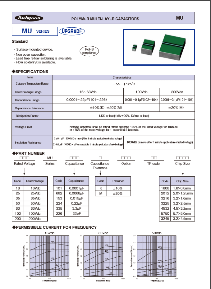

Yes, in the SMT world metal film is called "thin film" and metal oxide is called "thick film".
Thin film are best whereever low distortion matters, such as feedback networks, active filters.
For SMT caps you won't find PP (polypropylene) as it melts well before solder does, but PPS types (polyphenylene sulfide) are a great low-distortion substitute.
These are some variation on acrylics I think, high energy density, good temperature resistance, not as good performance as PP or PPS I believe, all the Rubycon literature compares them favorably to X7R MLCC, and I think they are a good all-rounder, likely to surplant mylar and even MLCC in the long term.
