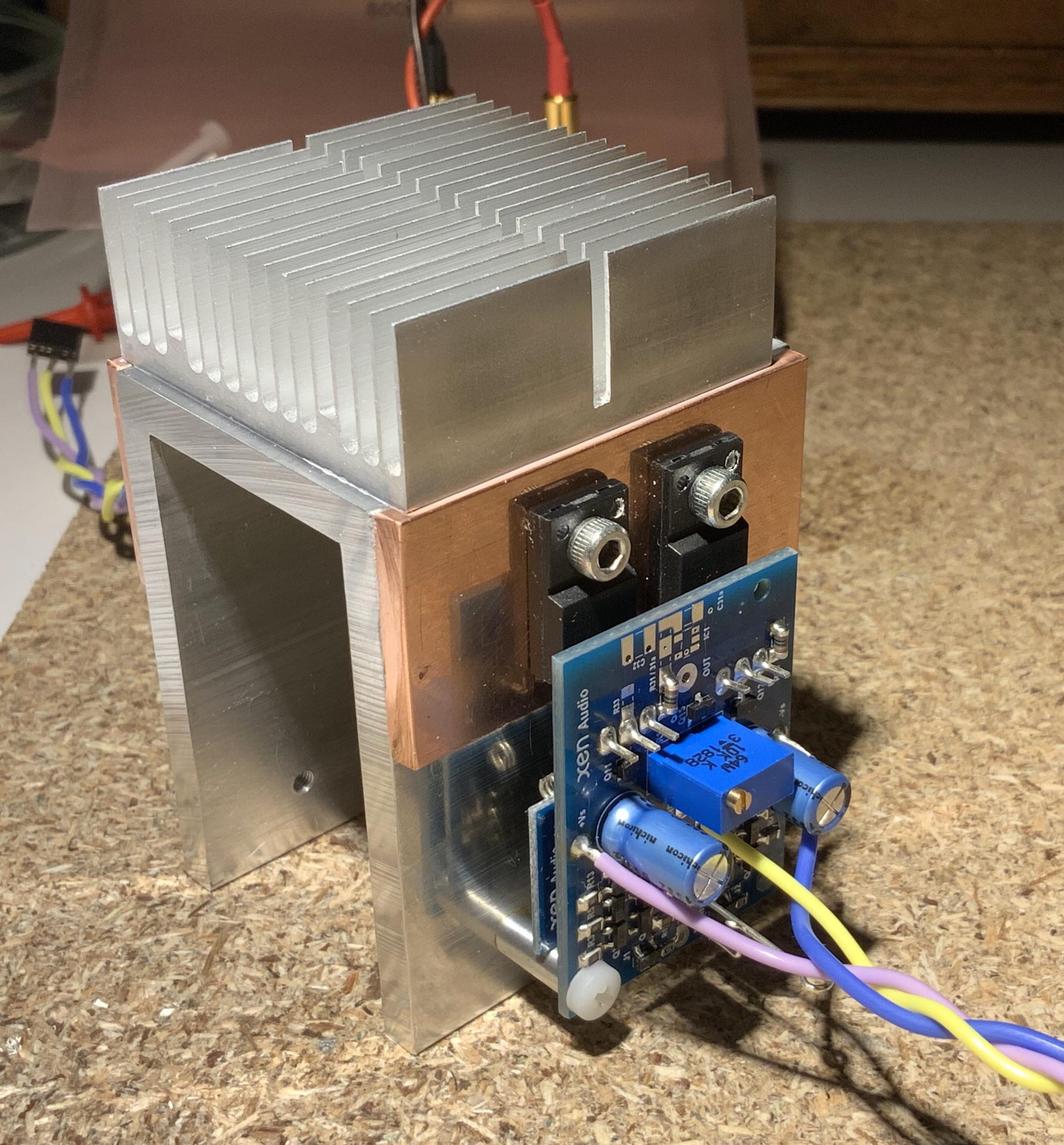

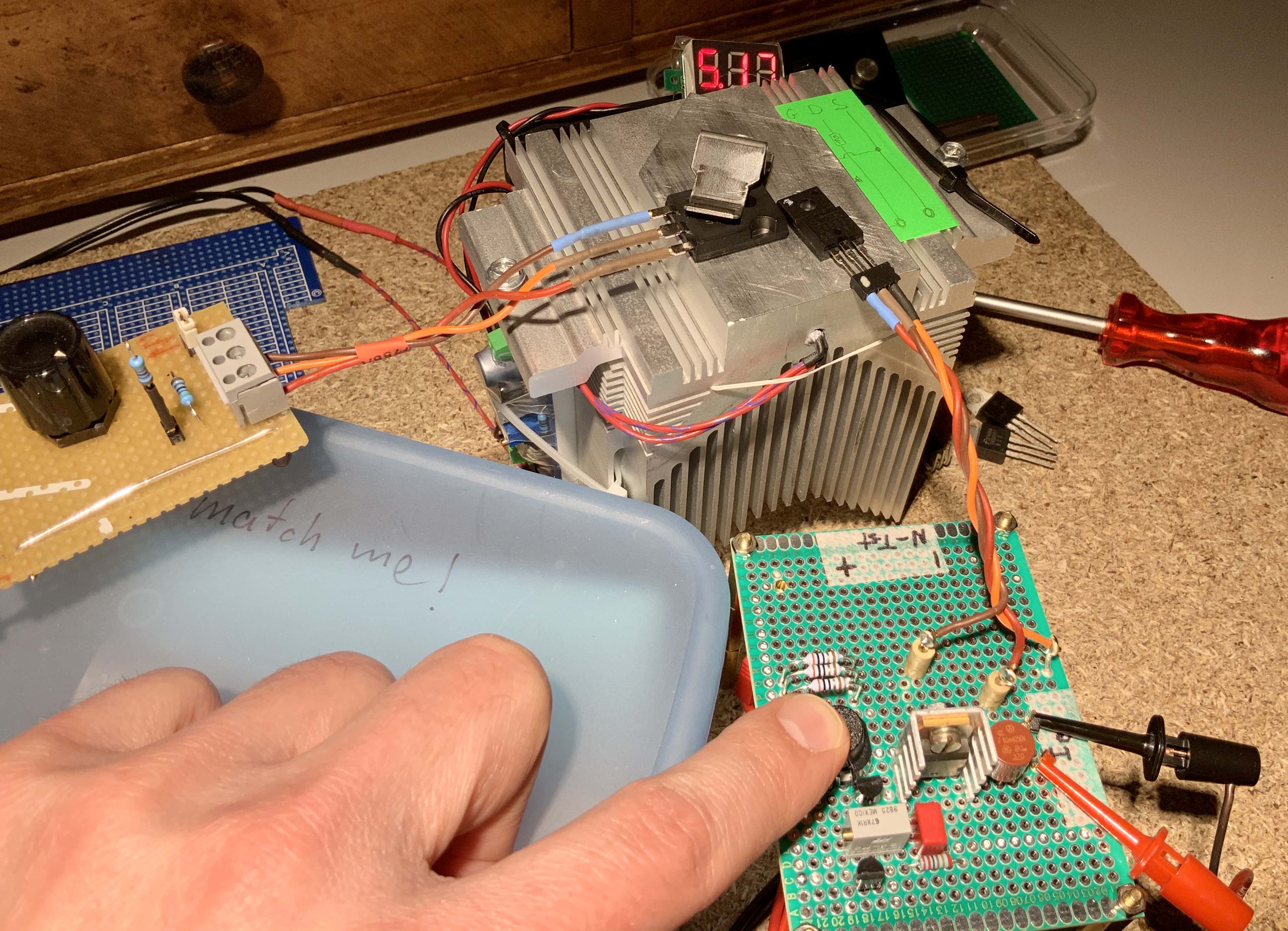

How did you attach the heatsink to the U-channel ?
Aluminium solder ?
Great matching, by the way.

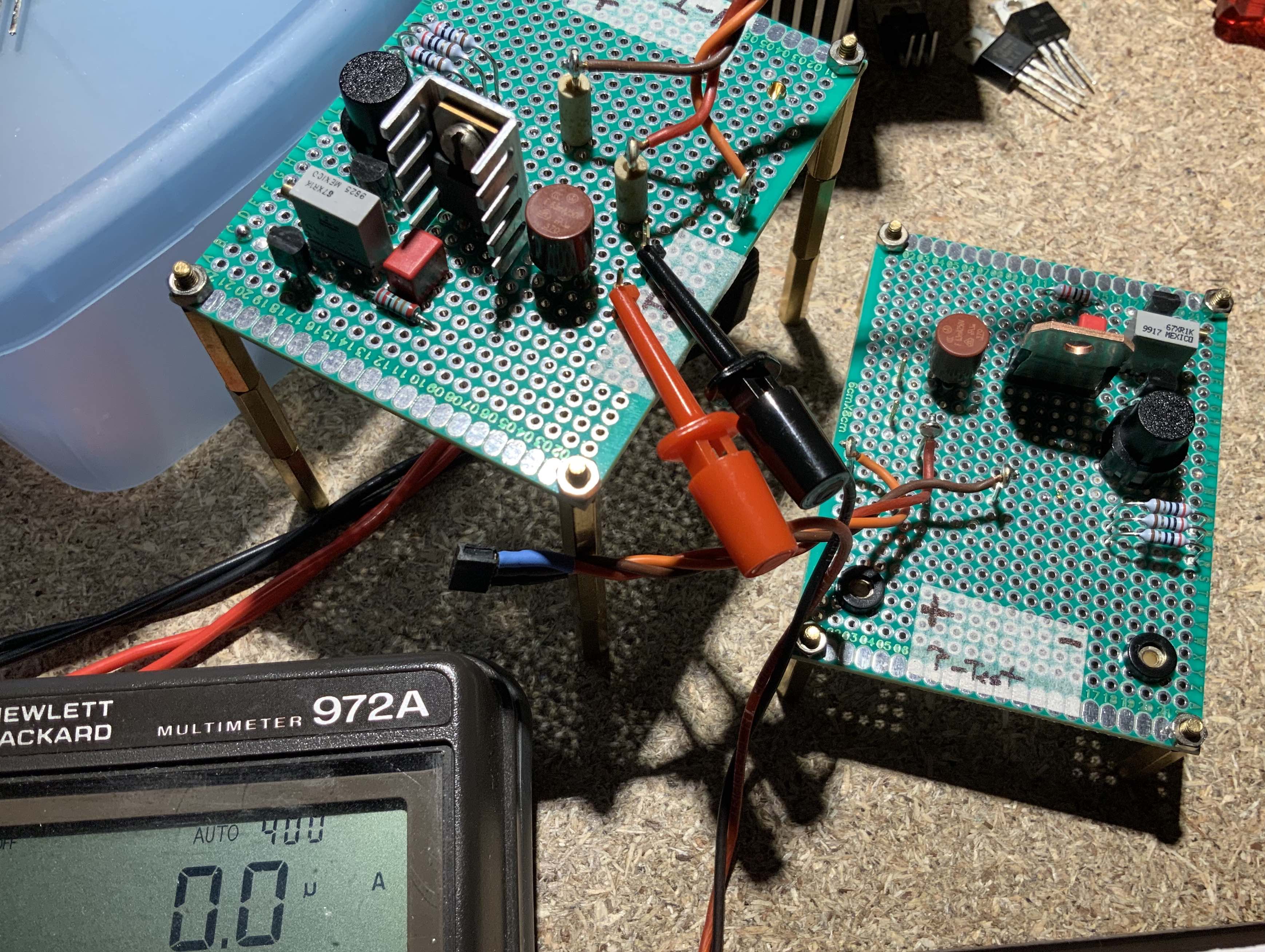

Thanks🙂 That was the most time consuming part of the build. But it is definitely worth the effort.
The little CPU heat sink is attached with just one screw and some Arctic MX-4 thermal compound. The copper bars are glued to the U with arctic 2k thermal glue.
But at this point the sink is just experimental. I wanted to check the temperature @ 150mA bias and maybe it will be enough to bolt the assembly to the aluminium lid of the final amp.
They won't get warm even with a normal size aluminium case large enough for a desktop headphone amp.
But low working temperature not only means long life, but also minimum DC offset and bias drift.
Which is why I normally use heatsinks.
And it allows me to wind up the bias if I want.
(not that it is necessary)

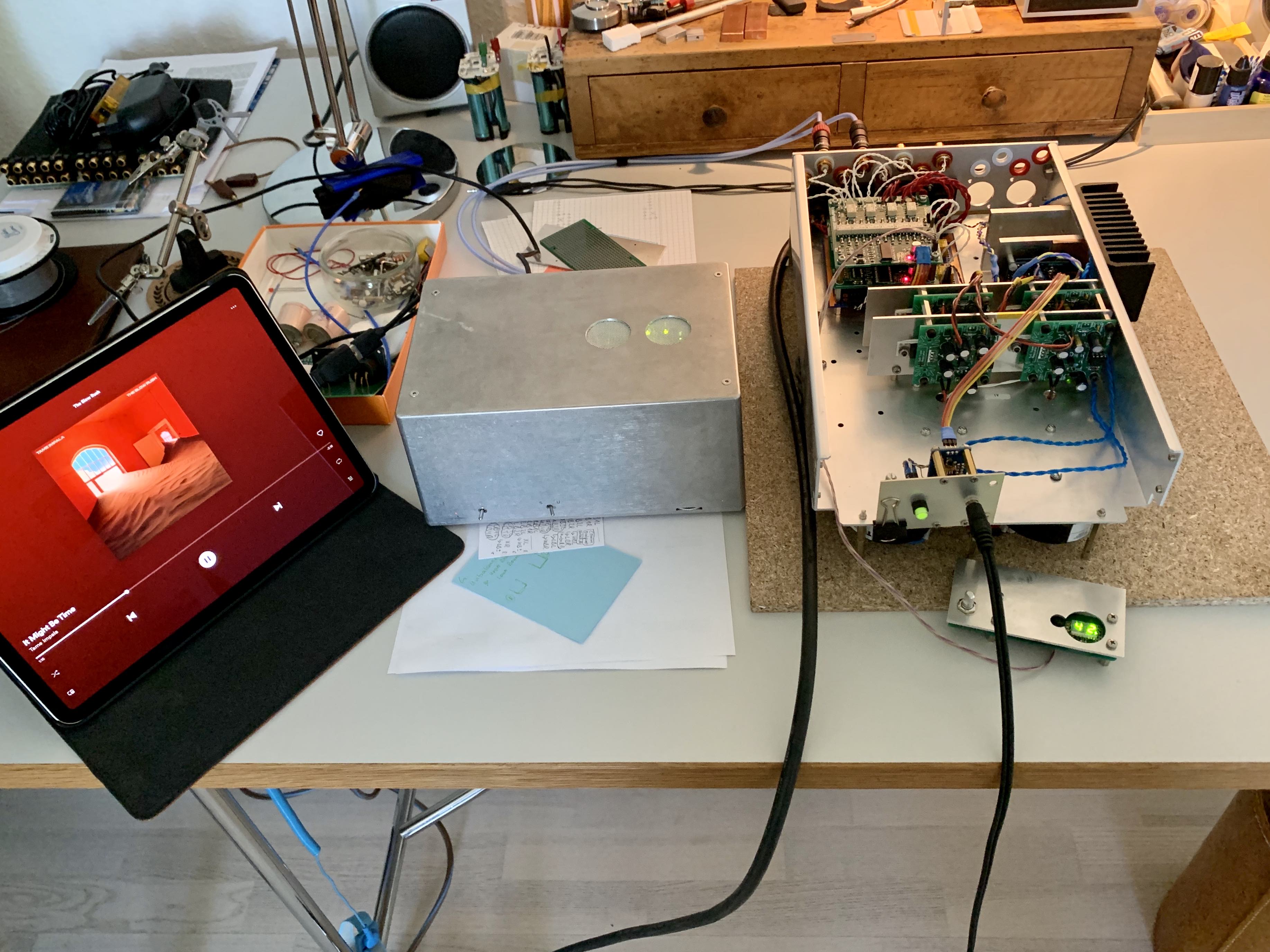

So the SHPP is ready and I have first music [emoji106]
I tweaked the SHPP a little towards higher sensitivity.
R2,4 is 90k in this one and the trigger point is 55mV as predicted. I also used the reset function.
Big thank you to all the people involved in this project here on diyaudio [emoji120]
I have to say that none of the other HPAs sounded so right from the first moments.
