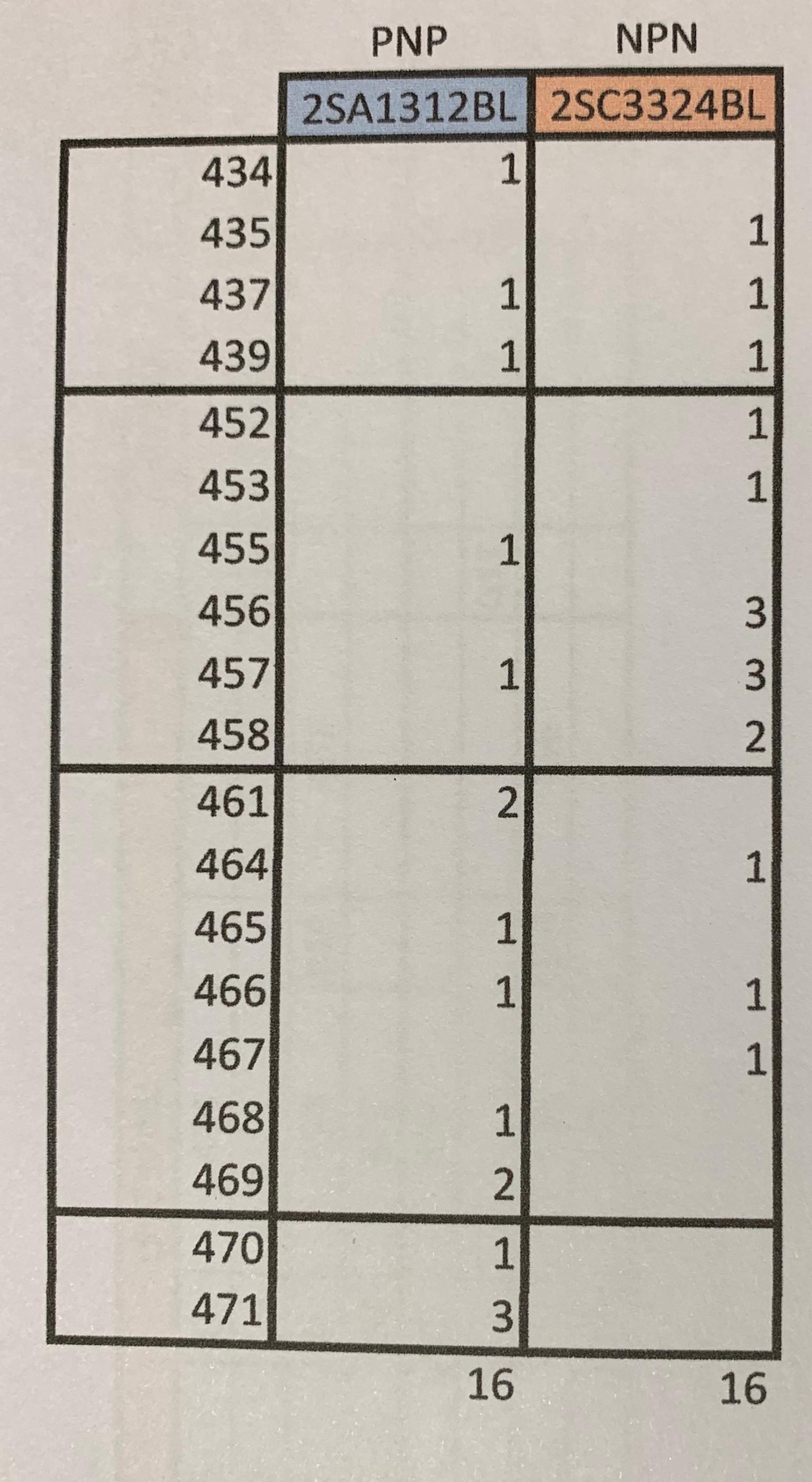

Patrick,
Please give a look to the table below, that is the best that I can get after matching 100 2SC and 2SA.
Not really lucky, I just have 16 2SA that can be somehow matched.
I think that they are matched enough (the worse are the CCS ones that are ~2,5% unmatched between NN and PP) but please let me know
Thanks and Regards,
Enrico
Thanks and Regards,
Enrico
Your best N-P matched pairs should be used for Q1,2 and Q7,8.
Then next best N-P match for Q11,12 & Q13,14 (Sanken).
Then NNN & PPP for Q4,6,10 & Q3,5,9, not must for perfect N-P match here (5% is OK, 2% is perfect).
And then next NN & PP for Q41~44.
But already mentioned in the PDF P.5 ??
Patrick

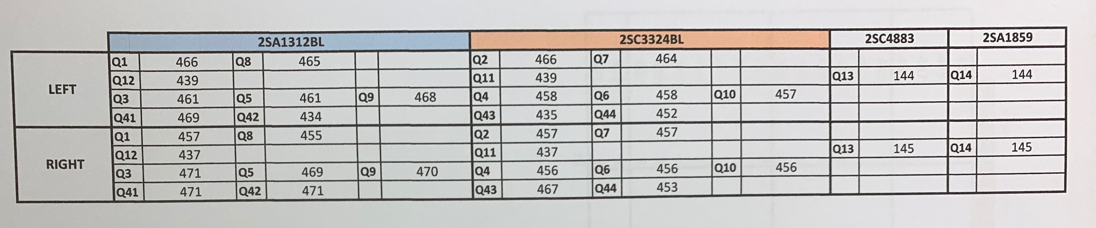

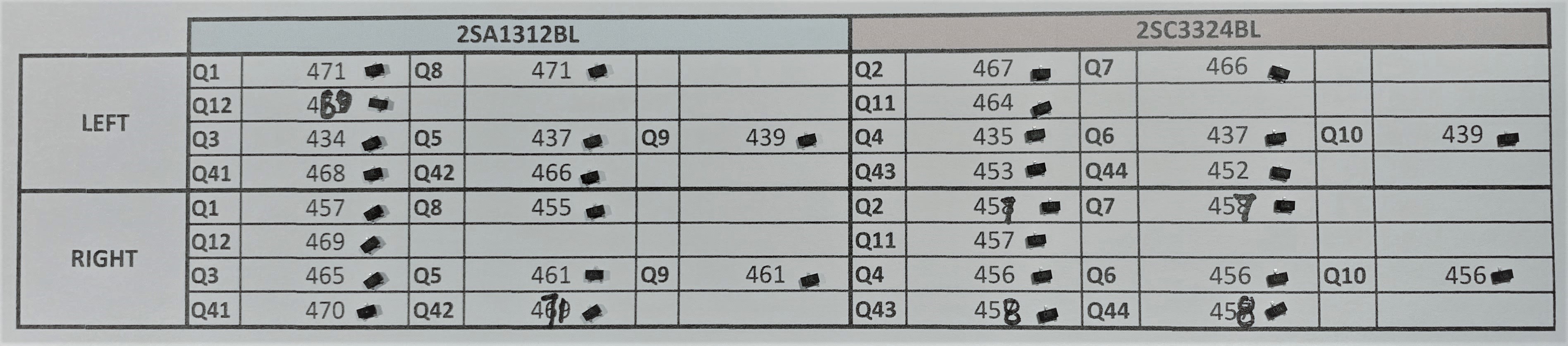

Swap Q1,2 of left channel with Q7,8 of right channel.
Move Q43 of R Ch to Q43 of L Ch, Q43 of L Ch to Q44 of L ch.
Move Q44 of L ch to Q43 of R Ch.
Patrick
Patrick
Patrick,
It’s clear for Q43/Q44 moves
Not really for the first proposal “swap Q1, 2 of the Left with Q7, 8 of the right.
As far I understand Q1, 2, 7 and 8 should be matched as NN and PP as well and I was sure that my proposal was correct... what I miss? 🙂
Thanks for your patient 🙂
Enrico
Enrico
Yes, that’s true... I was more focused to the NNPP matching.
Thanks for the clarification
Enrico
Enrico

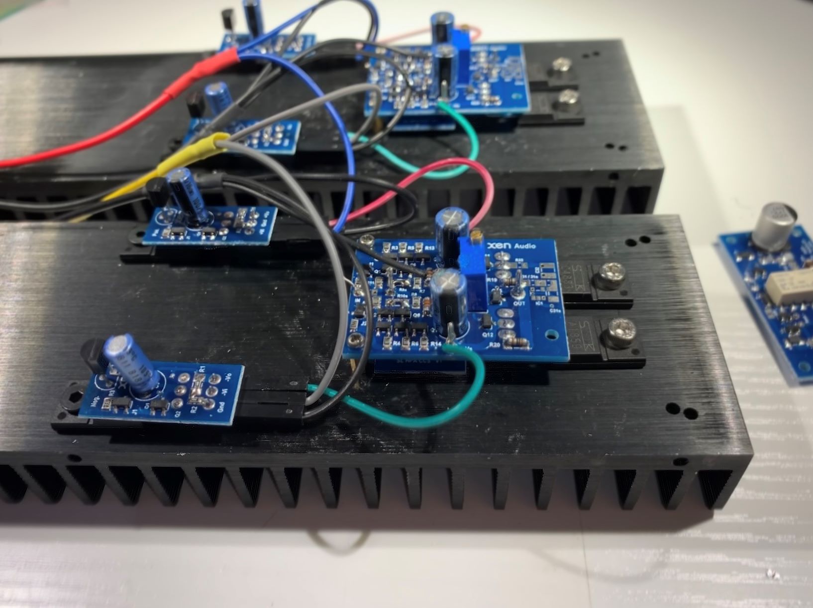

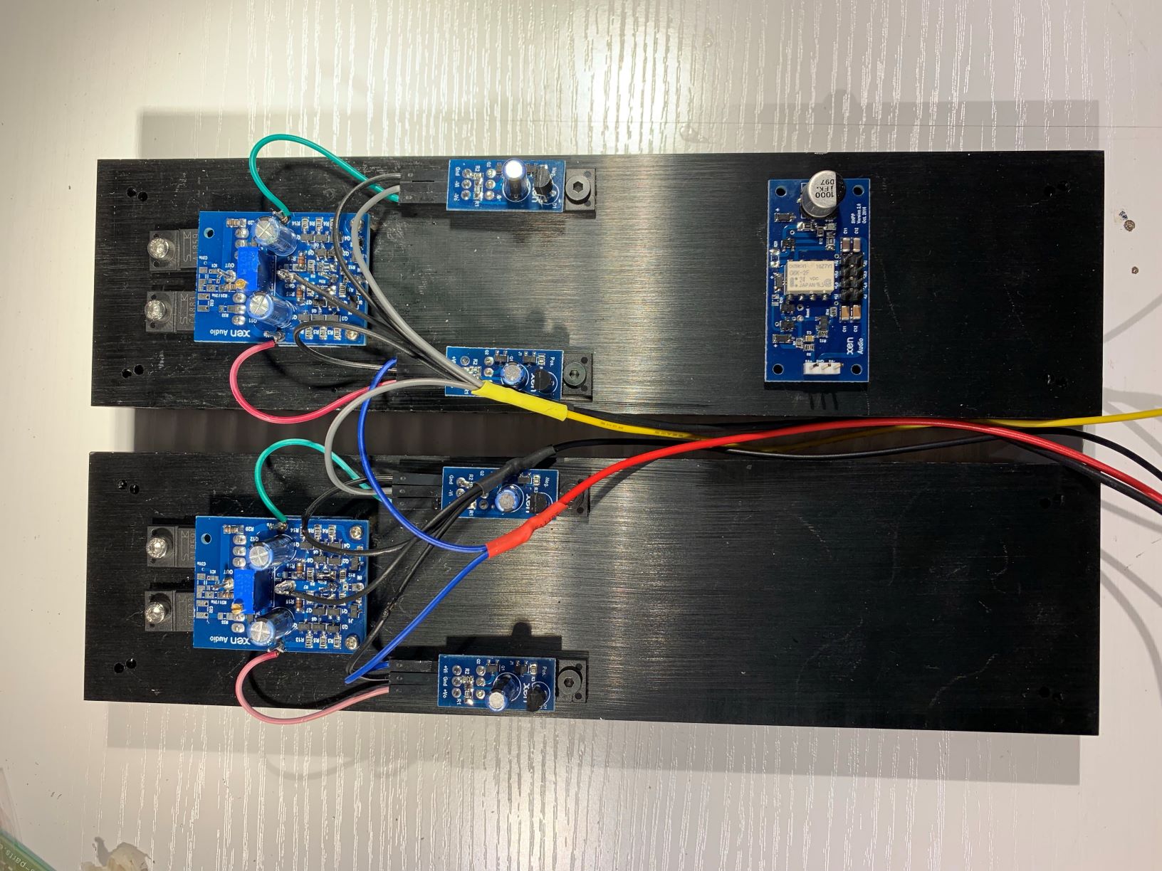

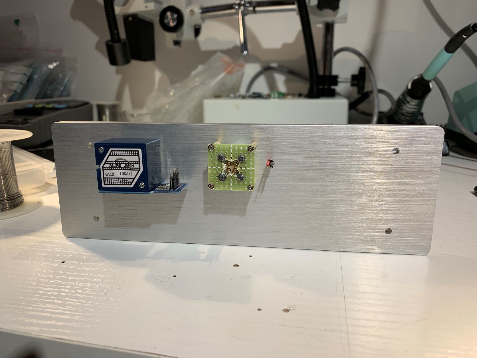

Patrick,
I took some time but I am there...
The 4 regulator are done, tested and trimmed the R1 to get:
+14.995 V
+15.006 V
- 14.934 V
- 14.973 V
The 2 main boards are tested:
- without CCS I get +61 and +42mV.
- with the CCS AND the 2 R44 trimmed I can get +4~+7mV and -3~-6mV

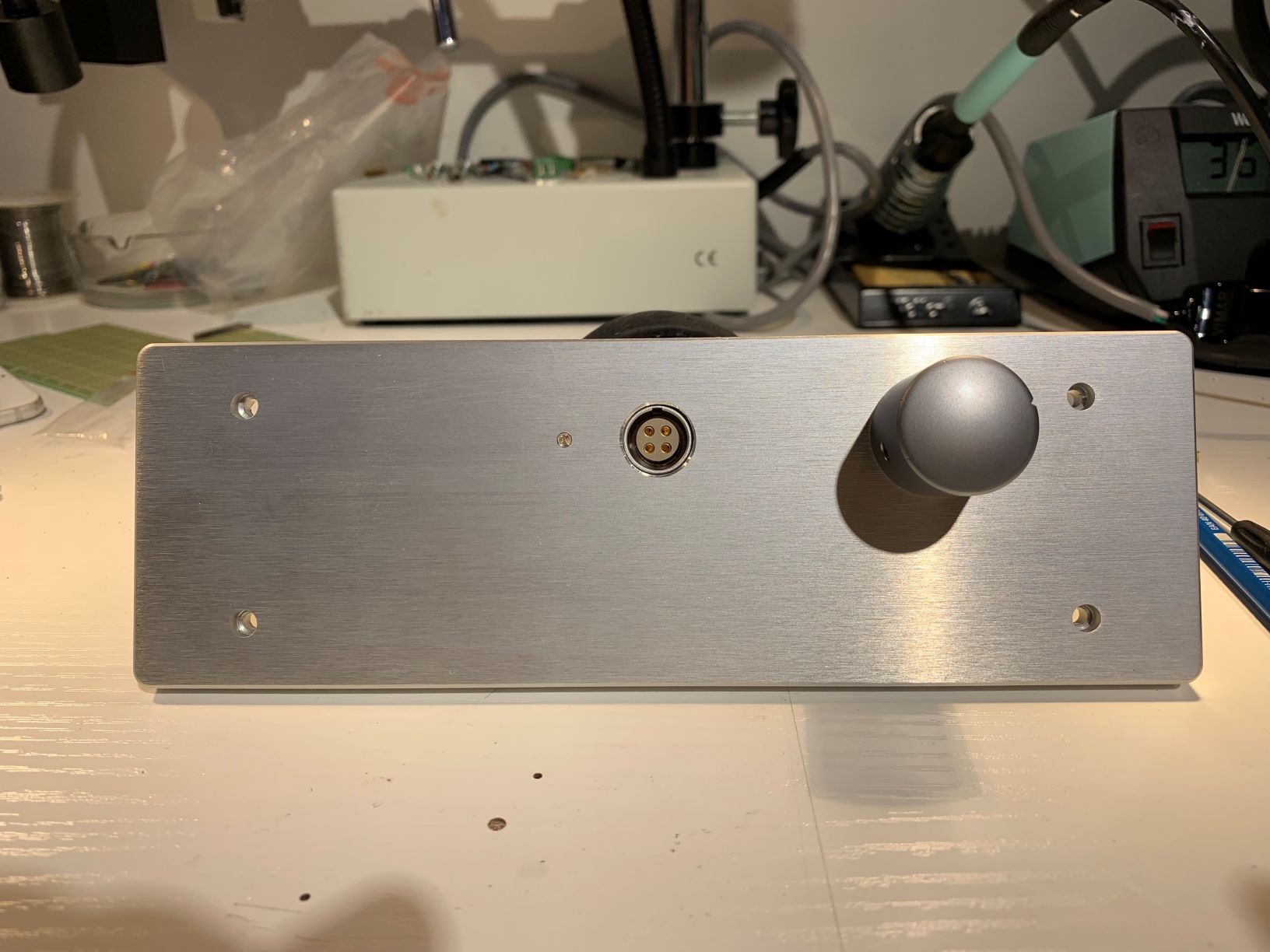

The SHPP is completed (and tested) and the chassis is work in progress 🙂
Regarding the passive Xfeed, if I am not wrong the 2 310K should should be installed. Can you please confirm?
What I need now is the motherboard to complete the PSU but I think it will take some weeks 🙁
I attached some picture... as you can see I was provident to buy the 2nd LEMO 😉
Enrico
Correct, if you are using 10k pot.
I doubt you will hear any difference even if you did install them.
You should listen first, even with lab supply. 🙂
Patrick
