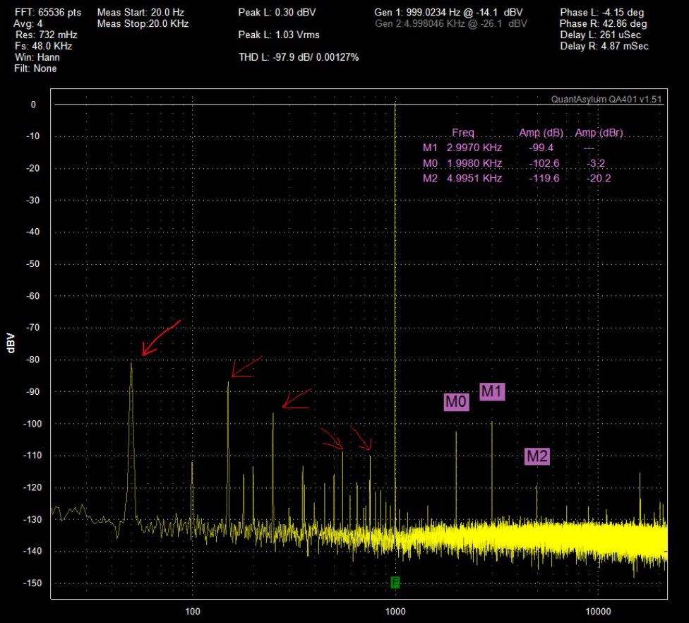

OK... Are you thinking that this crap (-80 db on 50 Hz and others up to 1 kHz) is normal, really?!! 😡
This isn't bad PSRR, it's a full aberration of PCB.
p/s: another junk audio with amazing hum.
Not sure I get your point here.
Are you blaming an audio circuit for a junk power supply?
The write-up mentions the source of the hum.

The measurement was made with a lab supply and no enclosure or shielding for the amp.
No doubt you know how to check with the spice model published what the PSRR is.
And the circuit only has current sources and emitter followers connected to the rails.
And of course none of those who has actually built has heard any hum from their phones.
