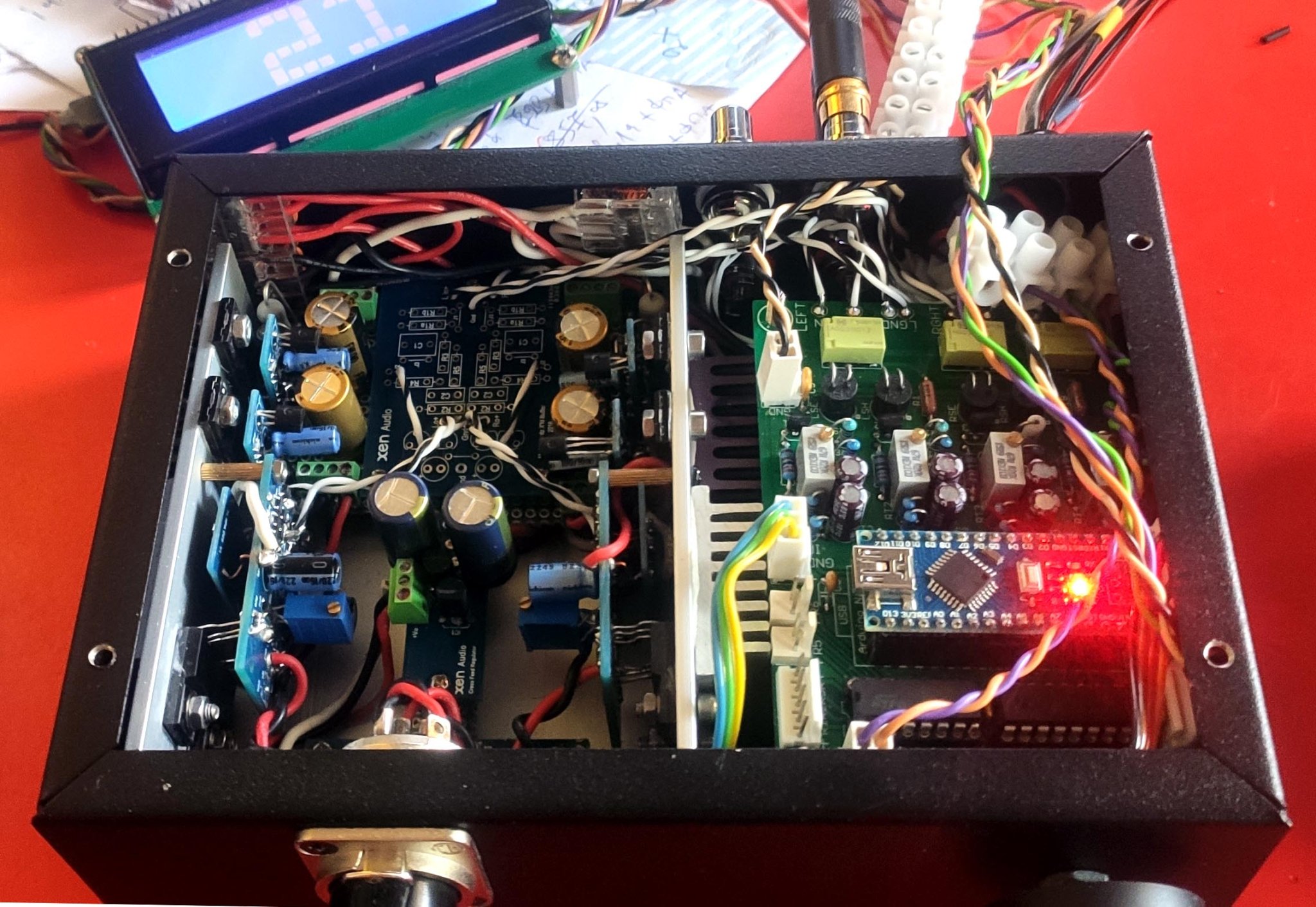

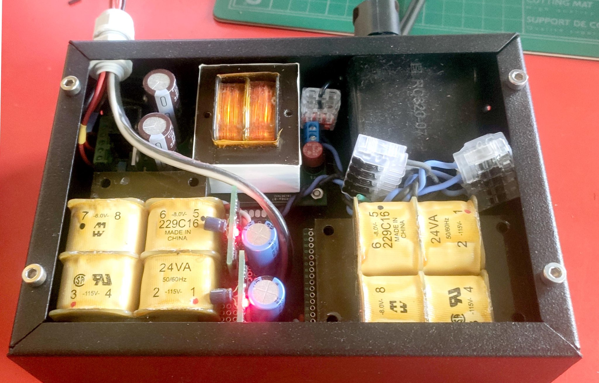

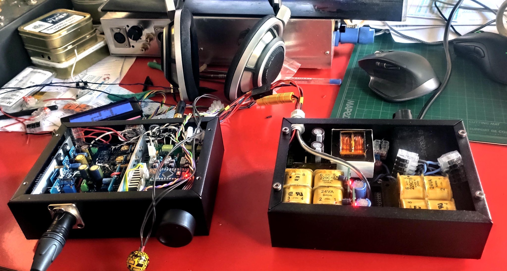

At last, after 3 months of work on the project I can hear how does it sounds and it is really good.
The most difficult SMD I have built so far, especially the SHPP.
Thanks a lot Patrick and Xen team for making it possible and sharing it.
Periklis

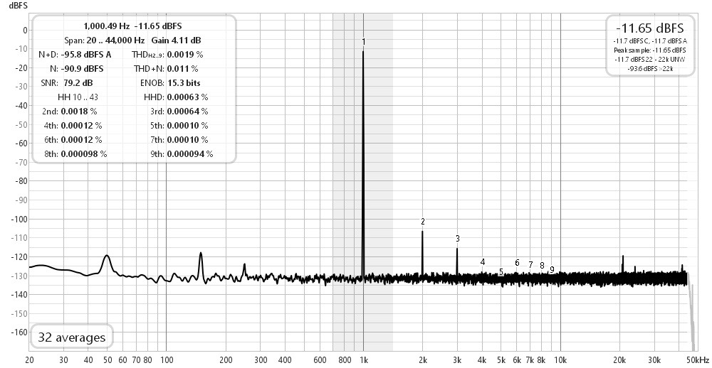

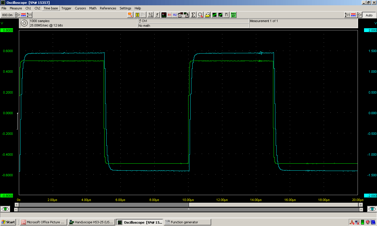

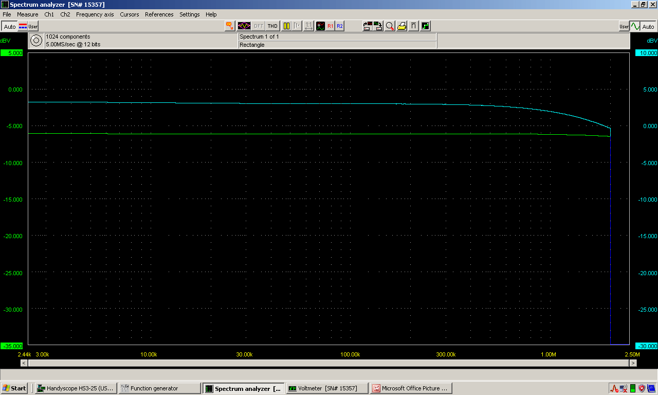

Here are some measurement results.
As you can see, bandwidth is almost 2MHz -3dB.
And H2 0.002%, H3 0.0006% 1kHz 1Vrms into 32R.
Only H3 rises to 0.0015% at 10kHz.
And you can build this with all (still) existing components.
No unobtaniums.
Patrick
