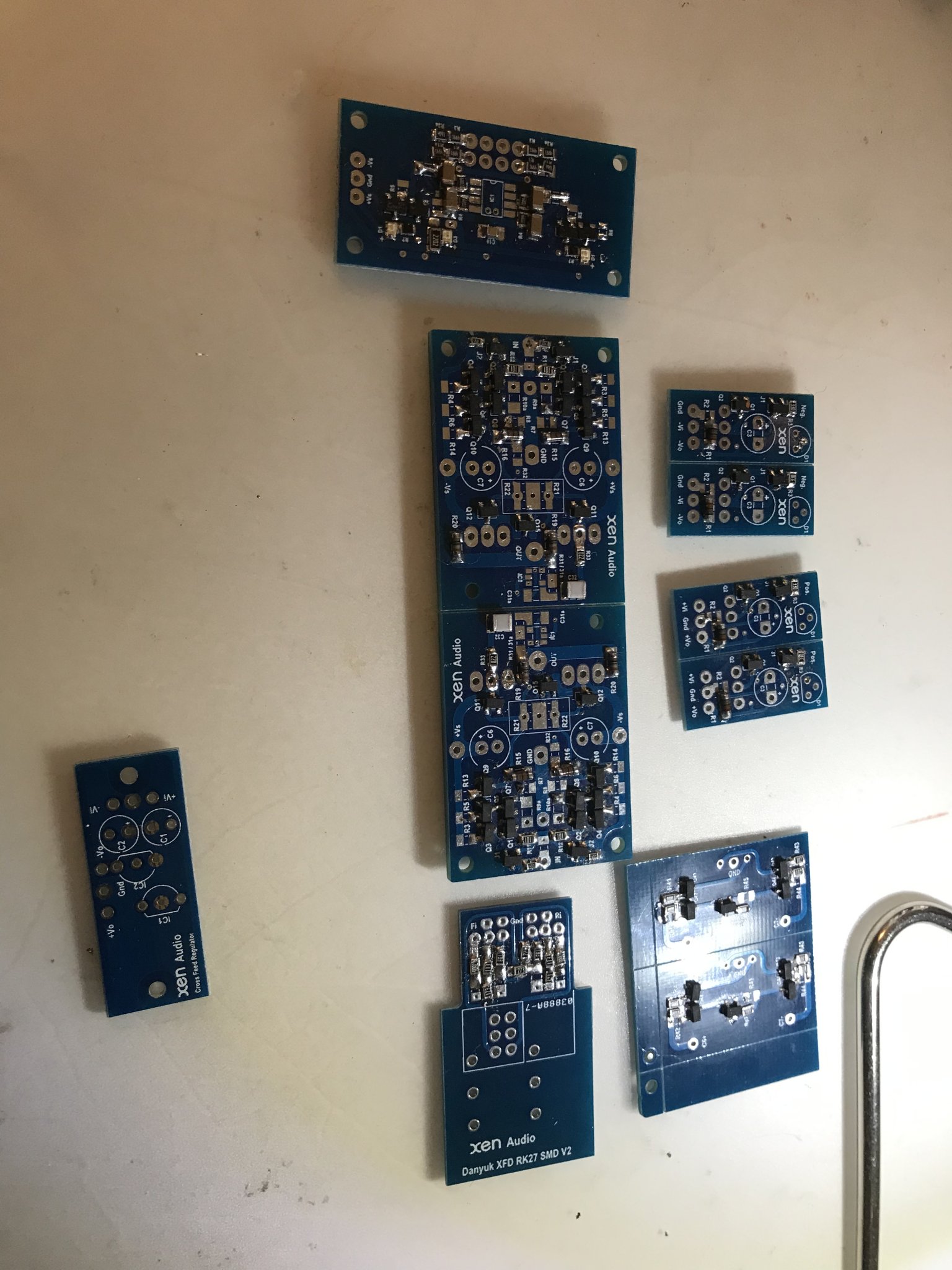

I finally started assembling SLHP amp!
I normally consider soldering as a therapeutic activity after a day in the office.
I have to admit that this time I got pretty stressed with those tiny little buggers!
Now the questions.
I see that for R21,22 which set the bias through the output stage Patrick suggests to use 10K trimmer and then replace it by smd resistors.
There seems to be not enough space for a 3296 series trimmer. Is the PCB made to fit any specific SMD trimmer package?
The other Q is about the output transformers. I have some D4H11/D45H11 probably enough for matching. Still they are listed as alternatives. Shall I go for the ones listed in the first place; 2SC4883/2SA1859?

I finally managed to find some time to continue with the project.
I know it takes me a really loooong time.
Anyway I got CCS tested - works fine.
I got the main boards tested (but I have forgotten to check the current trough the output stage - D44H11 / D45H11).
I have checked the voltages around current sources all looked fine.
I have removed R9/10,R9a/10a , shorted R9a/10a, connected the CSS boards. Rechecked the voltages again around Q1-Q9 and their negative counterparts.
Looks good.
The only issue is it looks like I cannot turn on the output stage transistors. I get around 70-80mv at the base of Q11 and opposite at the base of Q12.
I have 10K trimmer for R21/22. Shall I replace it with a larger value to get higher voltage at the base of Q11?

No, changing the 10k trimmer will do nothing.
As you adjust the trimmer, the voltage across the trimmer (or R21+R22) should change.
And you should be able to adjust it to at least 2.4V to turn on the output stage.
If turning the trimming does not do anything, then try 8.2k / 2k fixed resistors instead and see what voltage you get.
If you worry about burning your output transistors, remove R19,20 first during the test.
If all fails, then something else wrong with your build.
But if it works without the CCS before, then just use it without CCS.
